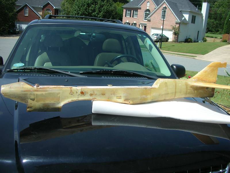

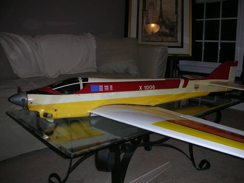

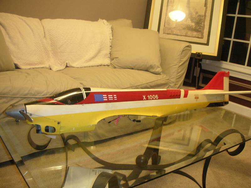

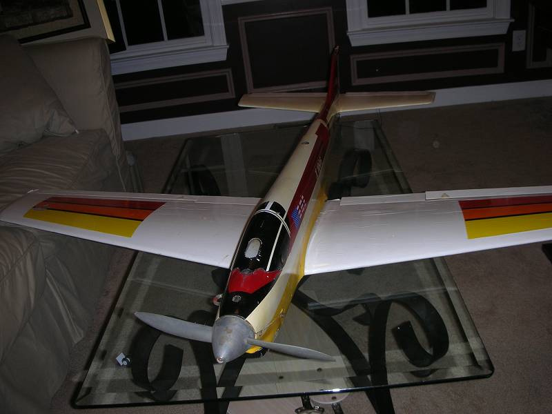

The Skymaster has arrived! showing all of it's 20-30 yrs, i have finally received the Skymaster 60 that i bought off of Ebay for $56. The fuse is full fiberglass (nice) and the wings are sheeted foam. it's a little rough around the edges but with a lot of tlc and expert advice from this forum i feel certain she will shine again. first, i will post overall photos, then i will post a few photos showing the flaws and wear.
david

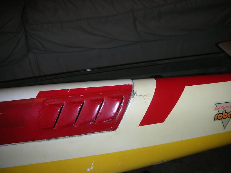

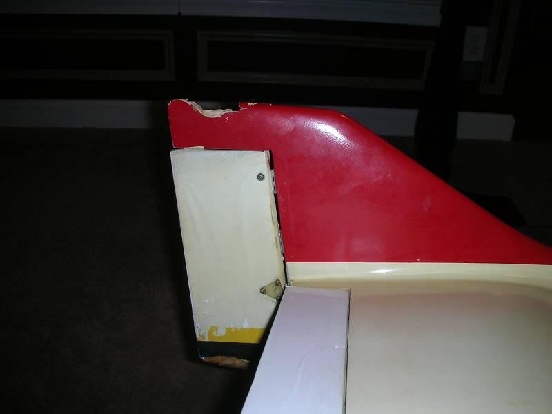

here are some photos showing the wear and tear. there are a couple of stress cracks in the fiberglass fuse, along with other areas that need attention. the wing has only 1 hard scuff on the end but mostly just needs to be recovered and have new retracts and servos added.

how would one go about stripping the paint off a fiberglass fuse? this will need to be stripped, repaired and repainted.
david

Looks Great!! Nothing too tough on that puppy to fix at all!! Is that part on the vertical which is chunked out foam with glass over it??
As far as stripping the paint....Ye-Ole Sandpaper... (If your careful..a DA sander comes in Really handy for this process!!)
As far as fixing the cracks, chips and delams:
First you'll want to identify the resin used in construction of the fuse (ie: Epoxy, Vinyl Ester or Polyester)...You will need to repair the fuse with the same material it's made of...You can't mix-match resins..Epoxy is not compatible with polyester and the repairs will not hold up and vice versa...
With a little experience..Vinyl Ester and Polyester are pretty easy to differentiate from Epoxy due to the Styrene odor present (ie: New Boat Smell)...You can usually smell them and tell weather it's polyester based resin or not (Wierd Huh)...If the fuse is old enough that the styrene odor has gone away...A light scuffing of the fiberglass with sandpaper will usually rejuvenate the odor enough to tell...
You want to remove any of the "Bad Glass" via cutting, sanding or grinding...Ultimately you want to remove as little material as possible..But it's important to get all the bad stuff out of there...If it's "white, loose or cracked" it needs go bye-bye before you go any further...Patching over a bad spot will result in a weak repair...
In the case of a "crack" you should stop drill at the end point of the crack prior to grinding...This will relieve stress and help ensure the crack will not go any further (Just like working with Aluminum)...
Then you want to "scarf" (taper) the surrounding fiberglass so that your repair glass can "feather" into it...You'll start with a smaller patch and then each additional patch will be slightly larger as to eventually blend into the parent material as necessary...How may layers will depend on the thickness of the original laminate and the material used for repair...(Probably at least three layers of .75oz cloth )
Aside from very small cosmetic type "dings"...Attempting to repair with just resin is not good...Fiberglass resin without cloth it has no structural value and will be weak...To fill a crack with resin only will result in a substandard repair which will be prone to failure...Also...Attempting to glass over a crack or delaminated area is no better and will be prone to fail...You must remove the bad material first...
If your planning to repaint the whole Airplane...I'd suggest first stripping the paint completely before you do any glass work...Paint can hide fiberglass damage...Once it's completely stripped then you can assess your airframe and put a game plan together for the necessary repairs...
It should be a fun little project!! If you have any questions or need any help just Hollar!! If it's more than you wish to tackle...Bring it to me and I'll take care of the glass stuff for a small fee (you let me fly her once or twice!! )

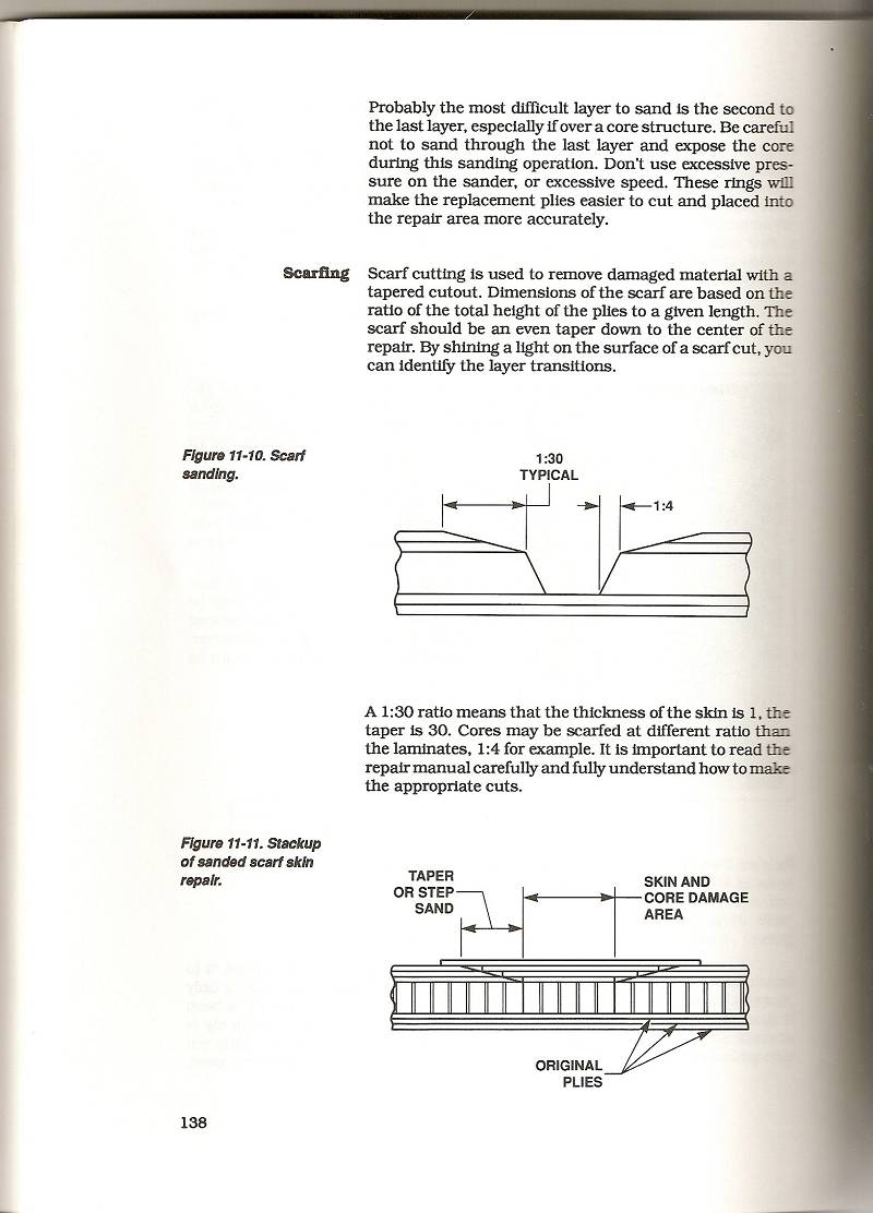

Attached is a photo of some tools that make life much easier when doing this sort of stuff!! (note: forgot safety glasses.. )
Note: I disagree with the pictures of the fiberglass patch's as they are in reverse order...You first start with the smallest diameter patch and go larger as you work your way out...

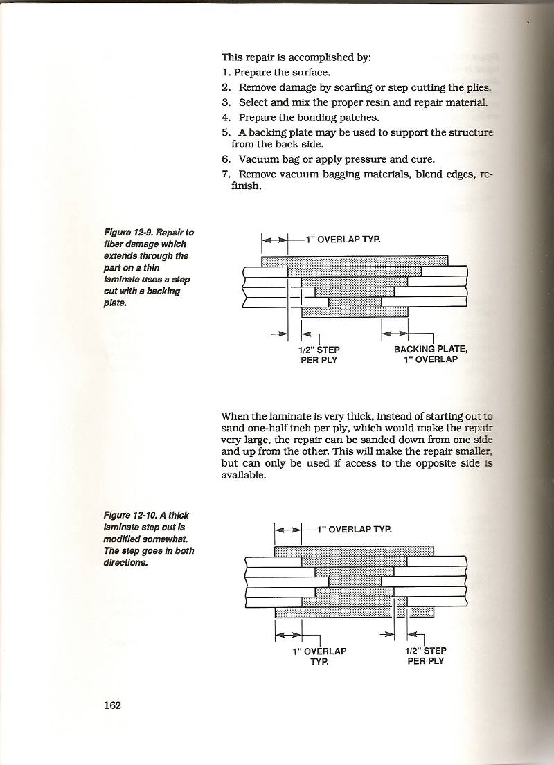

Preface: I often have a tough time differentiating between home and work...I do stuff at home the same way I do it at work...Some may consider this overkill (It May Be for these Toy Airplanes??)
ORIGINAL: flywilly
The rational for using the largest patch first is to get maximum contact around the damaged area to reinforce the fiberglass, then fill up the hole. I was told this years ago by a boat builder. Of course we don't need to be waterproof, but those holes can make some pretty interesting whistling noises...at speed
-Will
I suppose that's OK for boats...But it ain't how you fix Airplanes...
Using the largest patch first in effect reduces the strength of the repair to only one ply...The rest turn into "body fillers" and have reduced or no structural value...
As for a structural repair on an Aircraft component...All efforts are made to match the original density of material and then also matched in ply orientation from a stress/loads standpoint...All repairs are scarfed or stepped per ply with a minimum of 1/2" overlap (or per engineering)...It is accepted that a secondary bonded repair will not be as strong as the original laminate...Which makes it more critical that the repair be done in such a fashion to maintain the original integrity...You start with a small patch and grow in size on the way out...
Again...A secondary bonded repair will never be as strong as the original laminate...But if done correctly you can gain a large percentage of the original strength back...Workmanship and attention to detail are key elements in a successful bonded repair...

The one that would bug "me" is the crack on the side of the fuse...The rest are pretty minor and I'd consider cosmetic repairs...But the one on the side you might as well say the fuse is cracked in two (note: I havn't seen in person...Just judging from the photos)...This one **I'd** wanna treat as a load bearing structural repair...
If your familiar with the SkyMaster (or you might be able to tell from the photos??)...The upper portion of the fuse (Turtledeck) is removable for access to the tuned pipe...So the crack on the side is actually through the Fuselage portion of the Airframe...The Turtledeck is not effected...

Edit: FYI..Here are some better scans of some typical Aircraft Composite repairs...

the crack on the side is the major problem, the existing patch on the back side did not work. the other issues are just cosmetic. fortunately i am willing to invest the time and money to do this the right way. in effect this will be a rehab thread vs a build thread. hopefully this will be a showpiece one day. and as for the crack being in the main body, not in the removable turtledeck, chuck is exactly right.
