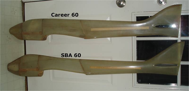

Hi,
I bought several fiberglass pattern plane airframes and would like to know what they are so I can match up the wings and stabs. I used my [link=http://www.trentonrcflyers.com/pattern/pattern1.htm]Image-base[/link] to see if I could match them up with a plane there, but I could not find a definitive match.
I have two of the first image. The second image has two different fuselages that had a page with a three-view and a name. SBA 60 and Career 60. Does anyone have any more infomation about these planes? I believe have wings and stabs for all these fuselages.
Thanks!

Career 60 looks like a curare, SBA 60 looks like an intruder

The photo of the single fuselage looks like a Summit II or III designed by Ivan Kristensen. The SBA is a fiberglass 'knock-off' of the Blue Angel. The Career is a fiberglass 'knock-off' of the Curare. I can't remember who kitted the SBA and the Career but they were sold by Mutchler's hobbies in Indiana (i think??).
My best guesses anyway
will B.

I wonder if the Career 60 and SBA 60 you have in the photo is Larry Philips glass work?? I just see some "techniques" I recognize that make me think it's a Philips Aircraft..

These were imported copies with different names from Fun key I believe. I did have the Career, LATE 1980'S, which was basically a copy of the Curare. The kits were fiberglass fuselages with sheeted wings, stabs, and rudder.

The SBA is a Blue Angle knock-off. Super Blue Angel. Great Plane.
