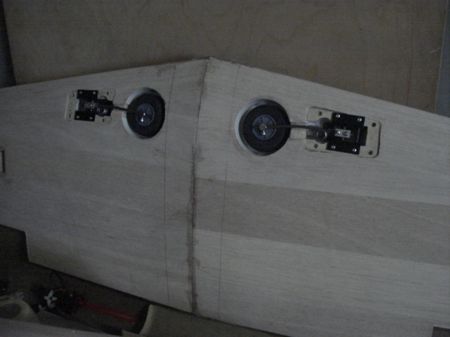

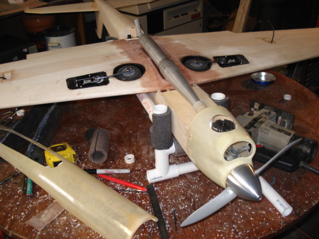

Back to the Saphir: Retracts are Dave Brown - servo is a Hitec. This is my first go at mechanical retracts. The instructions both in the kit and with the gear are a bit sketchy, but I worked it out.
The rest of the gear going in consists of 6 Spektrum 821 digital servos (2 on ailerons, 2 on elevators, throttle and pull-pull on the rudder) JR R921 receiver, 6v 2000 mah pack.

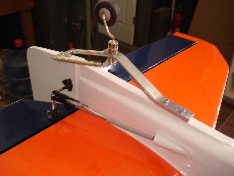

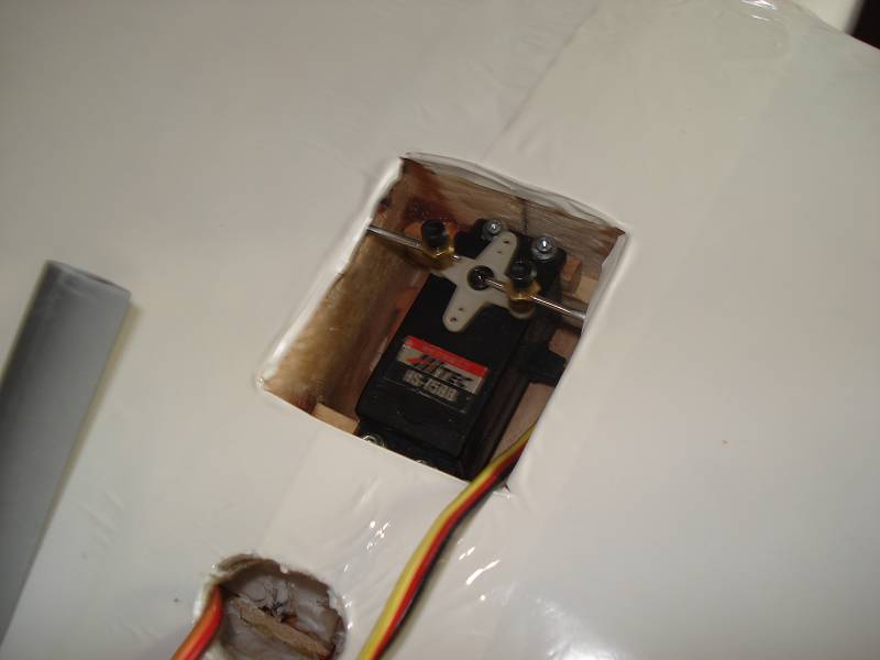

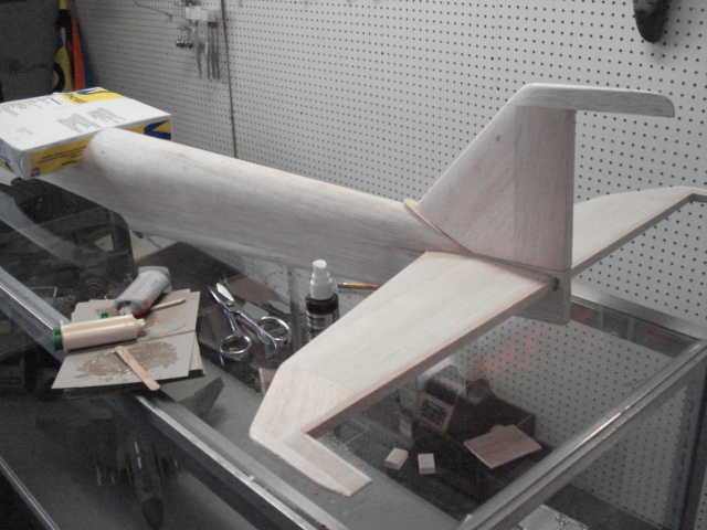

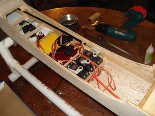

The biggest problem with ARF-ARC in my experience has been that sometimes the installation of the control linkages the tail can be challenging.
This is a long, thin fuselage and getting nyrods in is a pain. Had I built it, I would have installed them before I applied the sheeting.
I hate elevator connectors and "Y" pushrods, so I'm using 2 elevator servos. I can't put them in the tail because I'm using a 2 stroke and don't want to have to ballast this already heavy plane. Anyway, here's the radio installation. Rear servo is for the pull-pull rudder, throttle is in the middle front. I would have liked to have my nyrods anchored more than 3 places but each is only responsible for half the elevator and they feel really positive.

I've cut 'hatches' into the bottoms of a few ARCs to make pushrod installations/supports/exits easier. Just glue the hatch covers back over the hole and finish to suit. Also like the way ARCs allow for personalization with mods/color schemes. Thank goodness I still have a few unbuilt.

I thought about that, but the Saphir has thick foam in the top and bottom so the only place you can really go in is thru the sides. The sheeting there was just so smooth and nice I just couldn't bring myself to cut it.

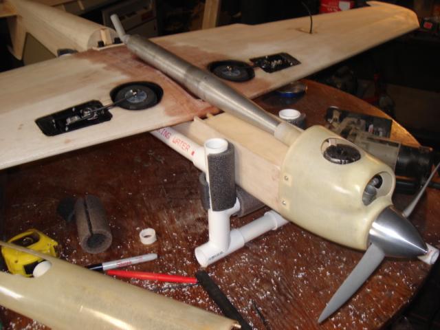

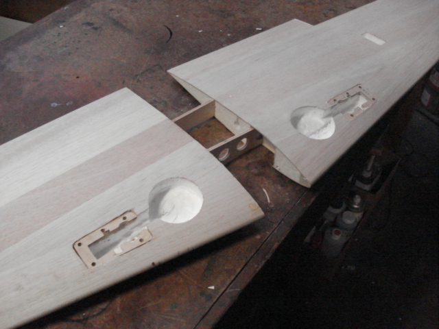

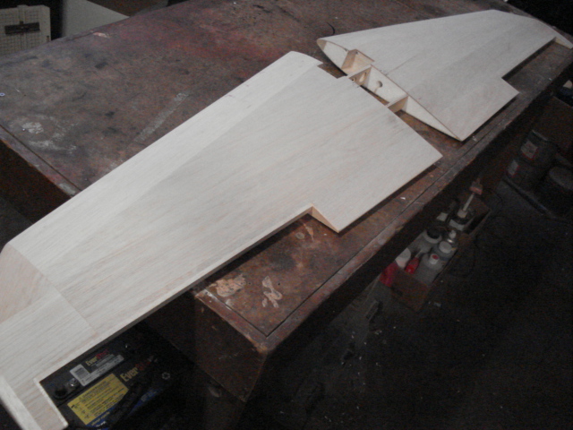

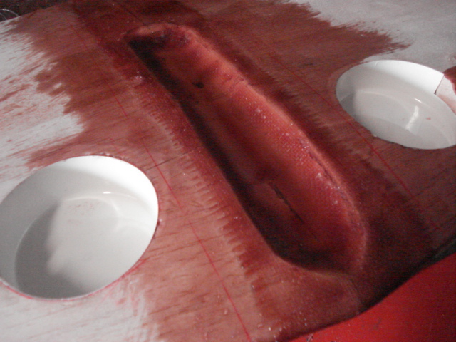

Had to dig out the tuned pipe tunnel in the wing bottom. I cut out as much of the sheeting as I thought was needed and sanded out the channel with a piece of 80 grit wrapped around a pipe. I glassed it with West System epoxy. I've had this stuff for years and the hardener takes on a reddish tone after time.

I would be a bit nervous to cut the wing center to such a thin section. In positive "G" maneuvers, the bottom of the wing gets to see 10+ g-forces. Like an I-beam, the separation of the top & bottom lends a lot of strength, F'glass or not, that is a thin center X-section.
Then again, the pylon guys have been getting away with this for decades.......

That is actually exactly what is shown on the plans. It is deceiving. It actually leaves probably 80% of the contact surface between the 2 halves, plus of course, the 2 plywood wing joiners. It is fiberglassed top and bottom and about as rigid as a surfboard.
It looks like it's almost thru the wing (optical illusion), and I forgot about the ply joiners.

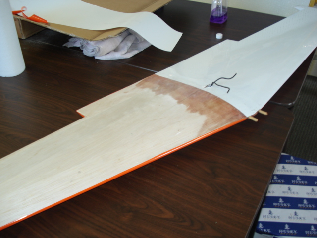

The wing is pretty thick in the center. I was actually more concerned about the foam block I had to remove to accommodate the retract servo. I'll get some more pictures up as the covering proceeds.

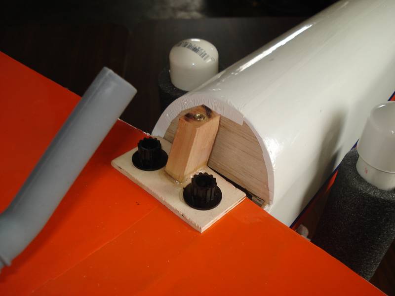

I wanted to simplify the setup process so I modified the belly pan attachment to consist of 2 dowels at the leading edge and one 4-40 bolt at the rear into a "T" arrangement at the wing hold down plate. I also put one of those spring clips on the 4-40 bolt so it will stay in the belly pan when the pan is off the fuse.

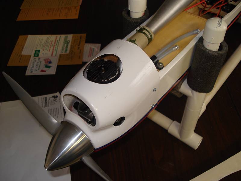

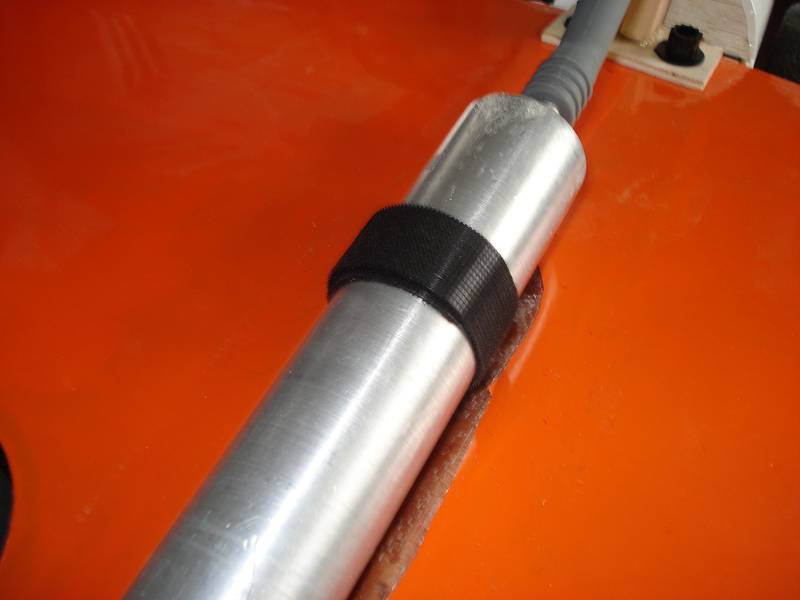

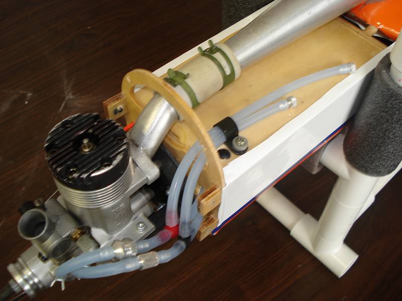

Here's my pipe mount. Piece of aluminum strap epoxied into the pipe channel....pipe held on with a velcro strap. I had minor concerns about the heat but someone else on the site has since posted that he's done it with no issues with the heat so I think I'm okay.

RE:Velcro Straps. If there is a heat problem, you could use Nylon Lock Ties. I use for my pipe and they would be compatible with your design.

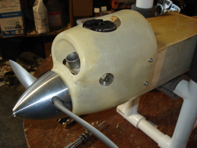

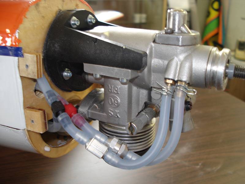

Took me awhile to decide how to plumb this thing. The YS is a closed pressure system and needs a means of venting the tank pressure before refueling. I ended up with "T"s in both lines running through the firewall to the area under the belly pan next to the pipe. I just have to pop the pan off to refuel.

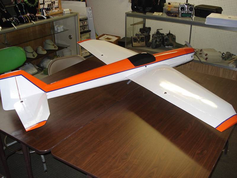

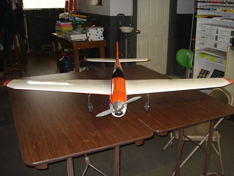

And the (mostly) finished plane. There will be some lettering, etc. when I get it done. On my fast stuff I'm more about being able to tell which side is up than anything else.
