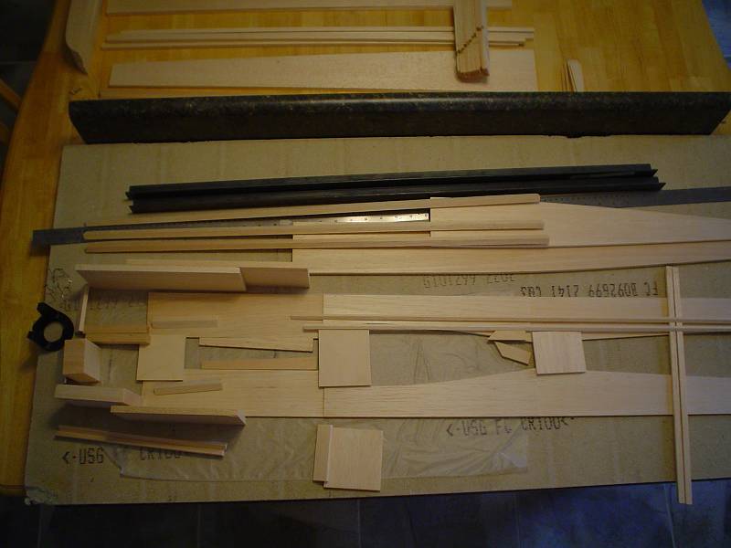

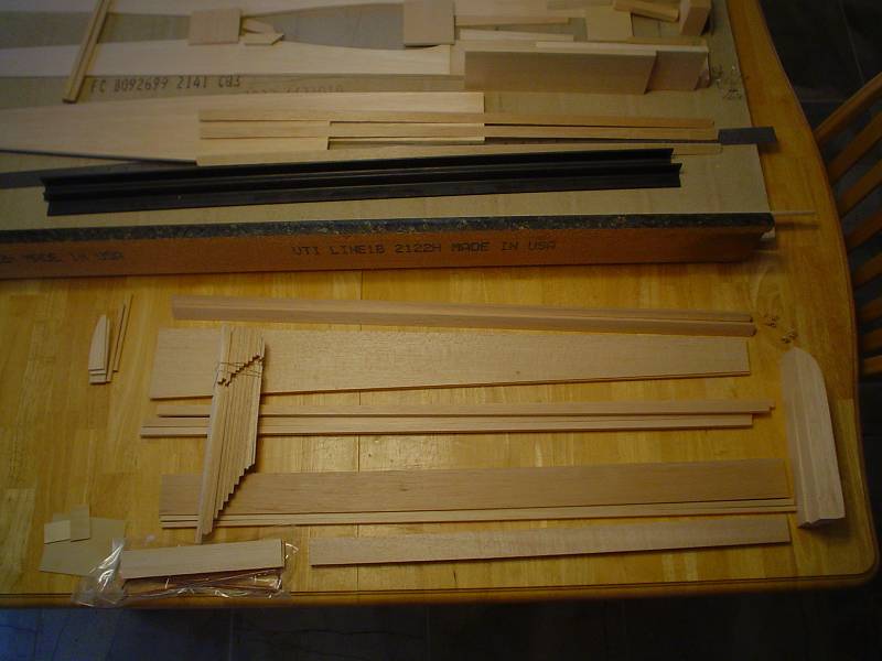

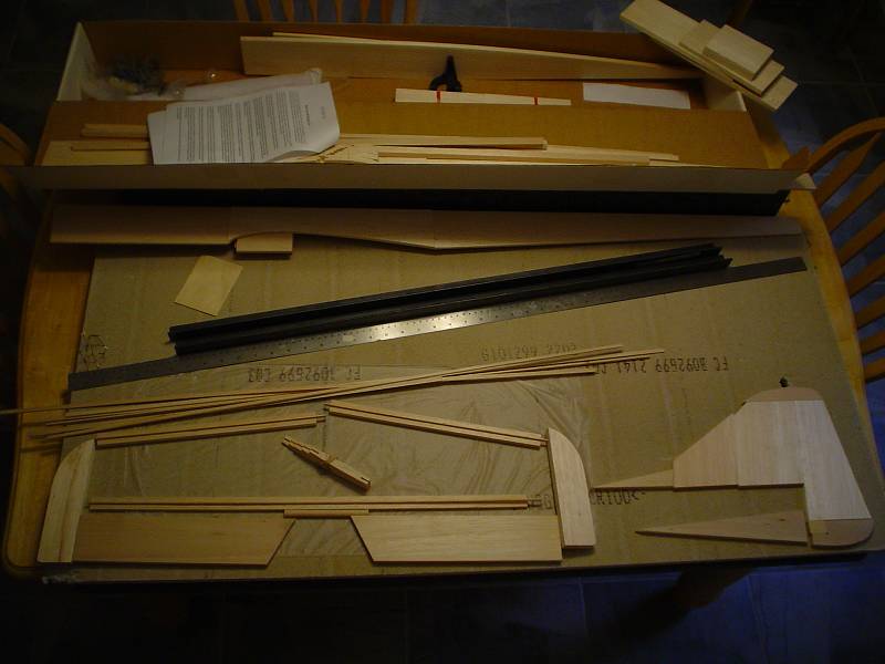

OK, the kitchen table it is...
I got all the pieces sorted by sub assembly.

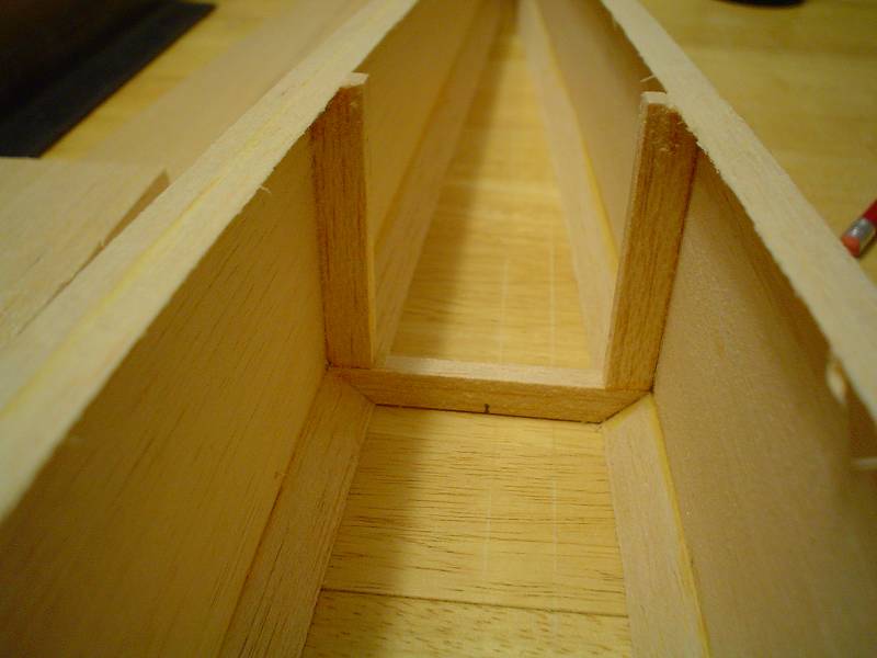

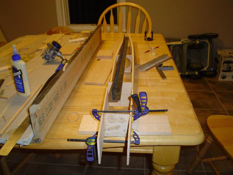

I joined the fuse halves and lined them up using a straight edge and some angle stock. I glued the doubler in place and weighed it down until it was dry.
By the way, I'm using Titebond 2.
After the glue was dry I pinned the fuse halves together and lighly sanded the halves until they were identical.
Now it's time to mark the bulkhead locations on the fuse sides.

Thanks Dave. Your DB looks very nice. The Bridi kit doesn't hve the holes pre-drilled for the wing mounting dowls.
I've run into a small snag. Former 3 is 1/4 inch shorter than what it shows on the plans. I'm studying the plans to see if I'm interpreting them wrong or if the former is cut wrong.

The plans show bulkhead #3 has vertical grain. Try turning it 90 degrees. The fuselage is exactly as wide as the fuse top. The sides are edge glued to the bottom of the fuse top, the triangle stock is added and then the whole corner is carved away. (Did that make any sense?) I kept thinking the parts were wrong too.
You're right, the wing dowel holes were not predrilled. But the instructions have you drill them before fuselage assembly. My point on the other post is that if you drill them after setting the wing incidence you'll be able to position them exactly where needed.
Dave

The photo shows that the bulkhead is orientated with the grain verticle. I tried turning it 90, but there's no way it would work. Take a look at my photos. I'm just going to cut a new one.

Laminate some Carbon Fiber to one side.
You may also try some 2 oz glass cloth. Should help.
I don't know which is easier for you, make new former or laminate.
Your pick.
I would use CF.

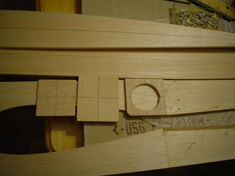

I've made a new former #3 and carved out the hole for the pushrods. I deviated from the instructions in that I've joined the fuse halves together with the formers instead of glueing the formers to the top block and then bringing the fuse sides together.
I've also mocked my engine and mount together and determined that the firewall had to go back about 3/16. I wanted to side mount the engine so the pipe exited under the plane, but with 2 deg down thrust, the pipe would be angled up into the wing.
Once the firewall cures I'll add the top blocks. I might wait to add the bottom block unil I get pushrods installed.
