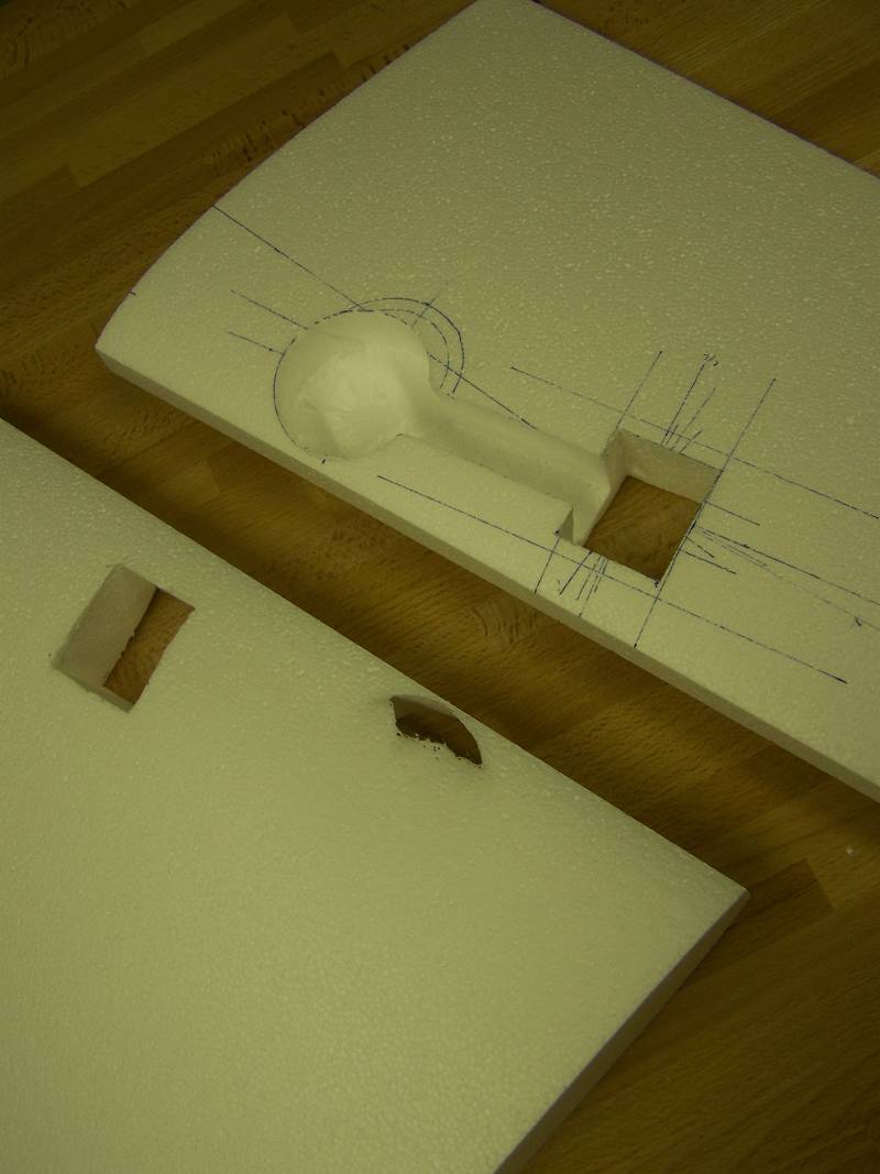

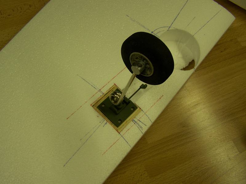

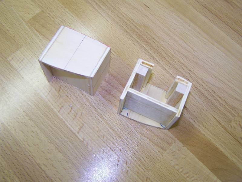

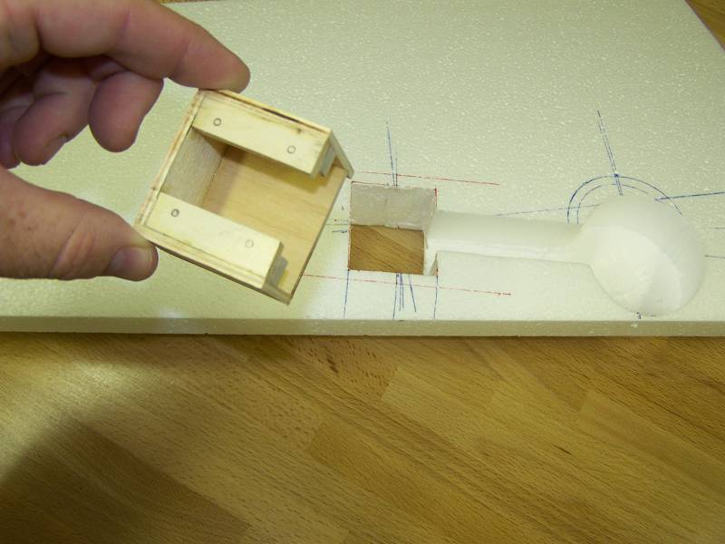

The following posts are to provide additional perspective about the historically relevant Joe Bridi, Dirty Birdy. The work was completed the Fall of 2006.
My kit is from the last remnants of Joe's inventory featuring the built-up wing. I sent the wing plans, root and tip ribs to the new owners (circa 2006) of WING Manufacturing, to create a set of foam wings. WING, I believe, is now in Michigan and should therefore, have the wings available?

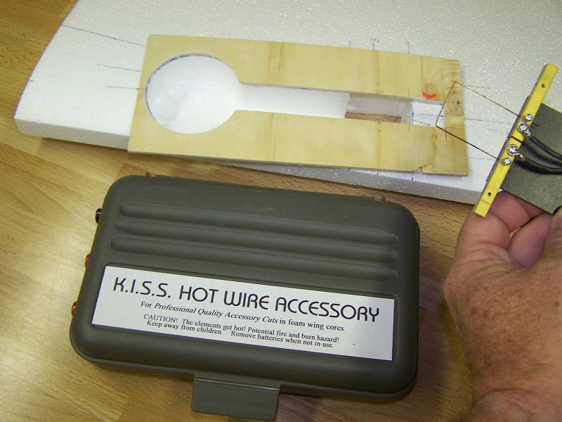

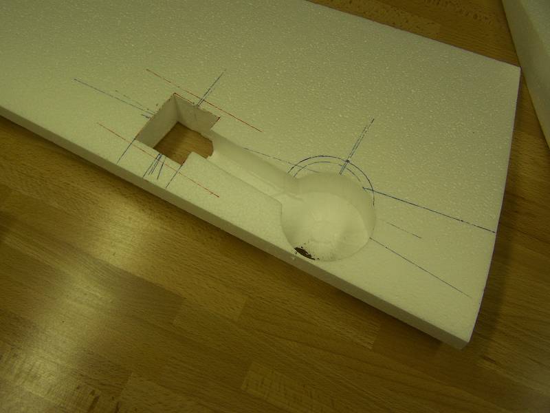

The photos show how I prefer to mount retracts (conventional) using a light plywood box which is glued into the wing prior to sheeting. The design provides for using the top sheeting, bottom sheeting and the foam to provide a significant amount of strength with weight LESS than a conventional 1/4" plywood plate and dowels. It is very important that the "box" fit very snugly for the most strength and least amount of glue. I add a 3" square piece of 3/4 ounce glass closth on the top and bottom of the box, between the sheeting prior to the sheeting process.
The cut-outs are made using 1/8" light ply templates and Sam Turner's KISS System...good luck finding this must have little gadget. The retracts are EZ- Supra for .60 size models from Central Hobbies. The 5/32 piano wire struts will be replaced with titanium versions also from Central Hobbies...much lighter.

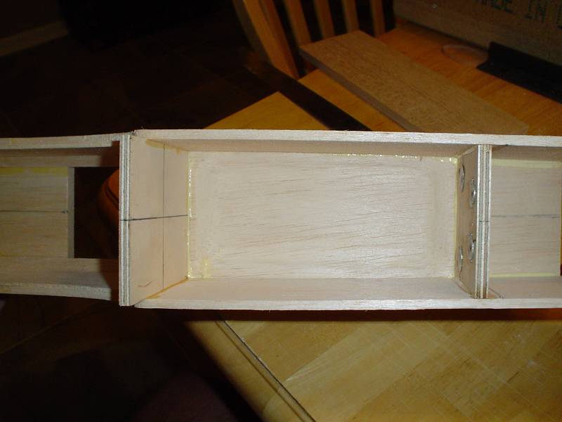

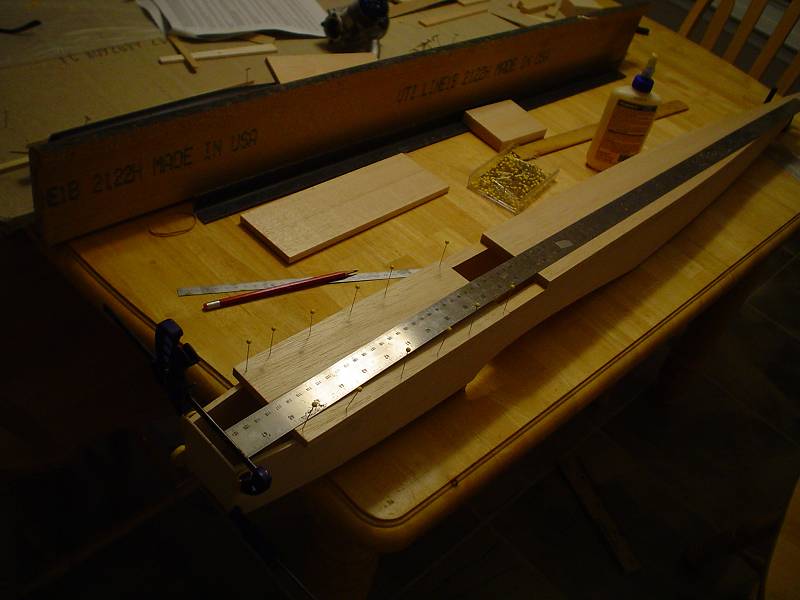

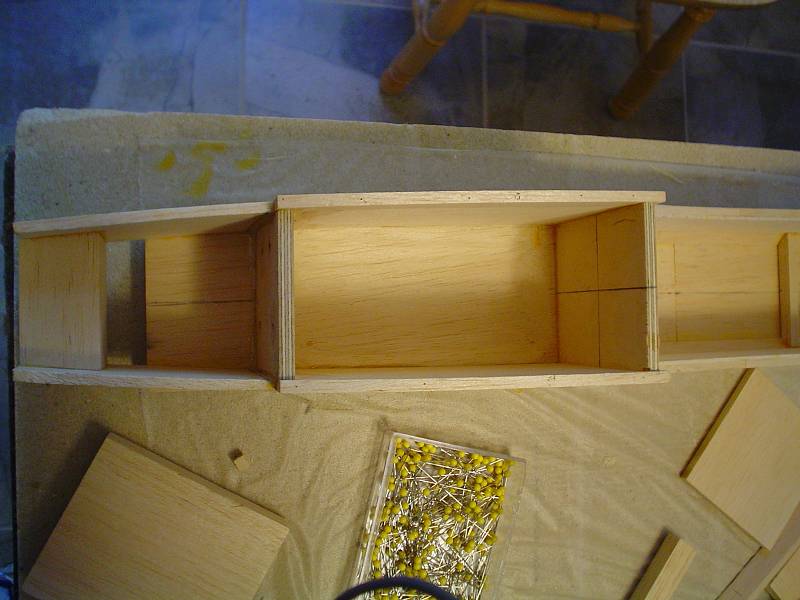

This post is to provide an additonal perspective on building the Dirty Birdy. The techniques have been stolen, copied or adopted by me from many of you and in no way do I take credit for their origination.
Just as an earlier post described, my rear fuselage former was too short so I added a filler piece. The hole was cut with forstner bit.
The elevator pushrod is mounted to the rear, the rudder servo is elevated with 1/4" light plywood and will use cable for actuation. The elevator pushrod uses an MK item which puts the elevator pushrods on the outside of the fuse with very short rods driven by an arrow shaft. It is very tight, remains tight over time, requires no maintenance. Some builders have changed the drive pushrod to cables by fabricating a new horn.

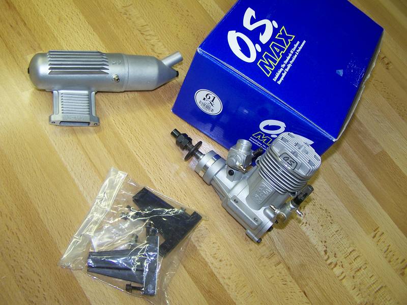

The model will be powered by an OS .61 to meet the SPA rules by keeping the retracts down. The photo shows a white shim added to the left nylon engine mount for "right" thrust. The tank plumbing detail was executed prior to gluing the various top blocks in place. The Rossi .61 is shown with the Scott Anderson "Deception" canopy and the stock plastic canopy...it would be pretty cool...?

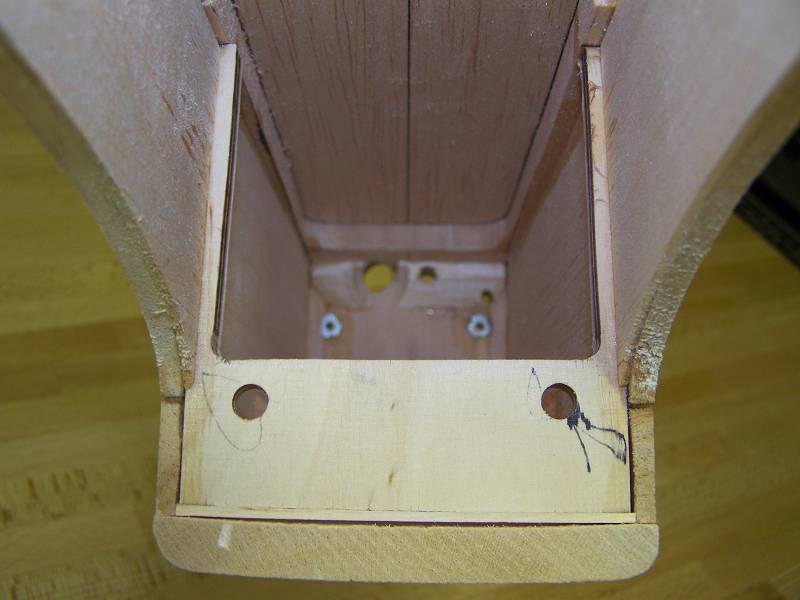

Thanks for the photos BERUSTY. Your plane is looking good.
Ed,

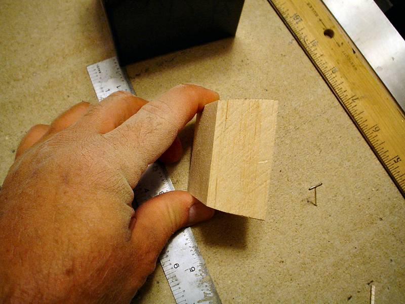

I fullly understand your thinking and appreciate your post. I had already epoxied the firewall in place though so this one is going to be built stock. Like you said, it should fly great.
The attached photos show the tank top block that's been relieved a bit on the inside as per the plans. - I guess for fuel tank clearance.
I've got the rear top block glued in place.
Next will be the front top block and finishing out the nose. I'm going to save installing the rear bottom block until I get the pushrods in place.
Cutting the slots in the side of the fuse for the stab is going to take some time.
Ed,

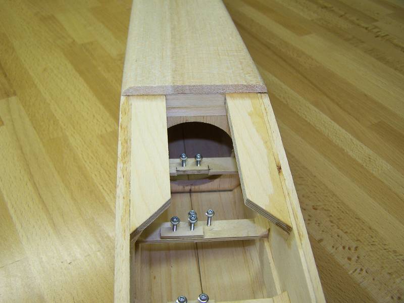

I kept thinking about side mounting the engine, and I decided to go ahead and make the modification. I removed the firewall and made a new one. In doing this I discovered that the firewall is also cut incorrectly. It's the right width, but the one supplied in the kit is cut square instead of rectagular as shown on the plans. So, now all is good. The firewall is the correct dimension and the engine will now be side mounted.
#34
My Feedback: (180)
I've got the nose block beveled and installed. I need to fit a piece to the upper nose block to fill the hole that would normally be filled by the upright engine.
At this point I'm trying to decide if I should build a hatch to get to the tank or just open up former #2. I wont fit the chin block or tank floor block until the wing is done. I want to be able to access the front side of former #2 when I drill for the wing dowls.

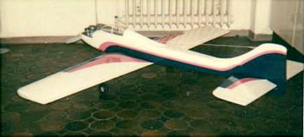

Here's a couple of photos of a DB 40 I built around 82.
