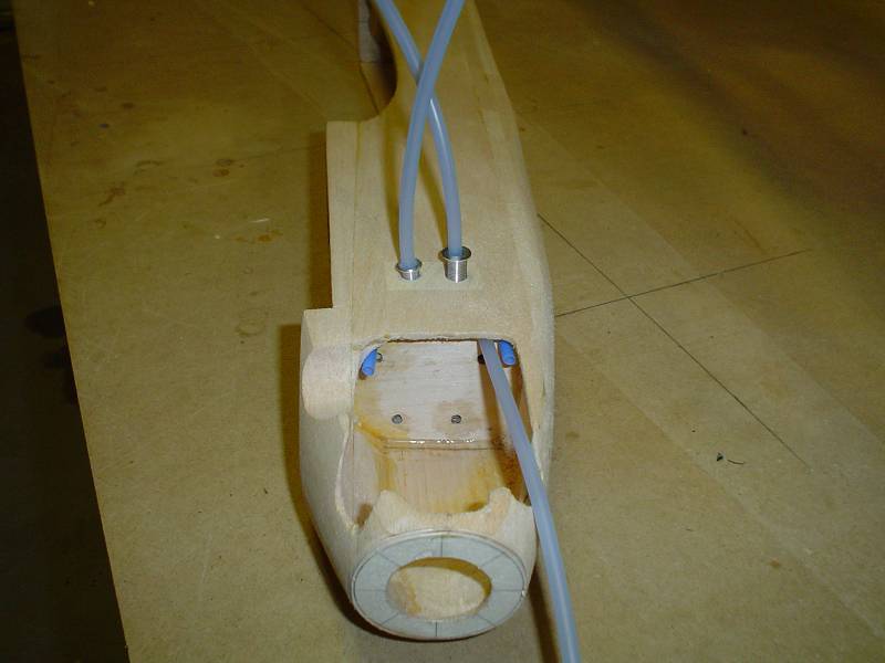

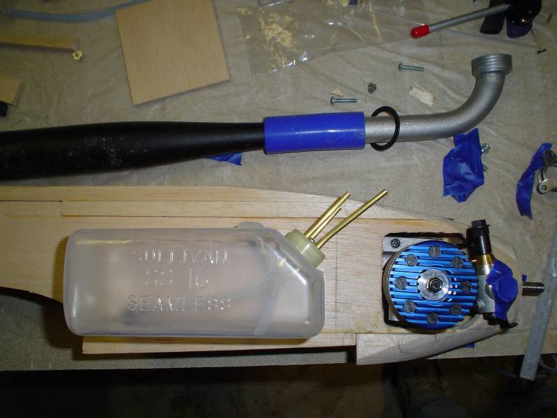

I'm back on track with the Dirty Birdy. I needed to get a fuel tank and some other hardware before I felt comfortable moving on.
I did add a filler block to the top of the nose where the engine would normally protrude.
I bought the Sullivan 16oz flex tank since it was one of the few that were less than 16" long to fit between the firewall and bulkhead #2 and leave room for some foam rubber.
I can't wait to start making some sawdust.

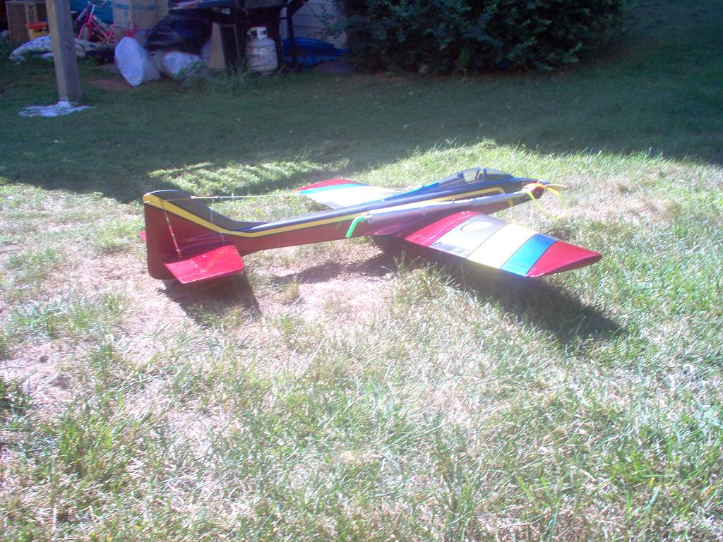

I built the Tweety Bird, Dirty Burd 40 and 60 size Bird back in the day (around 78 and 79). They all flew the schedules of the day well.
The 40 and 60 models were trike retract equipped. The 40 size was heavy with retracts and flew heavy as I recall.
I had just started to play around with piped set-ups when I made a paradigm shift into Arrows with the pipe running down the fuse top. The Arrow was and may still be the truly outstanding rolling model of back then and now. The MK Arrow kits were amazing

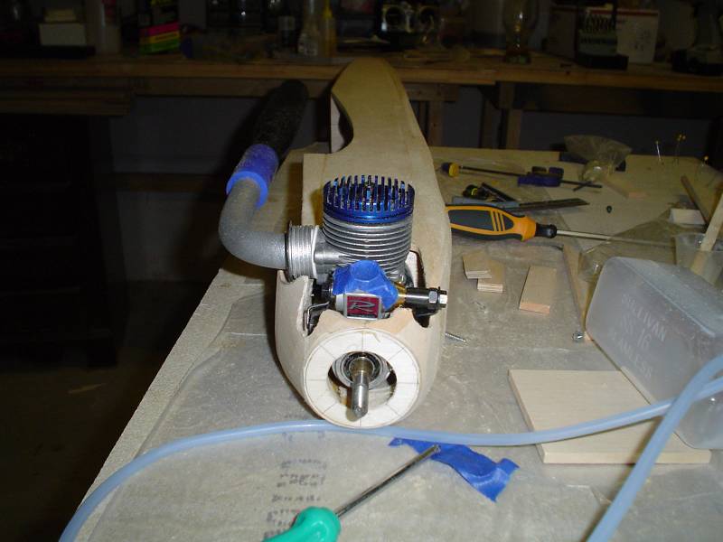

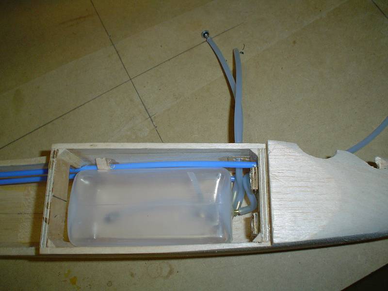

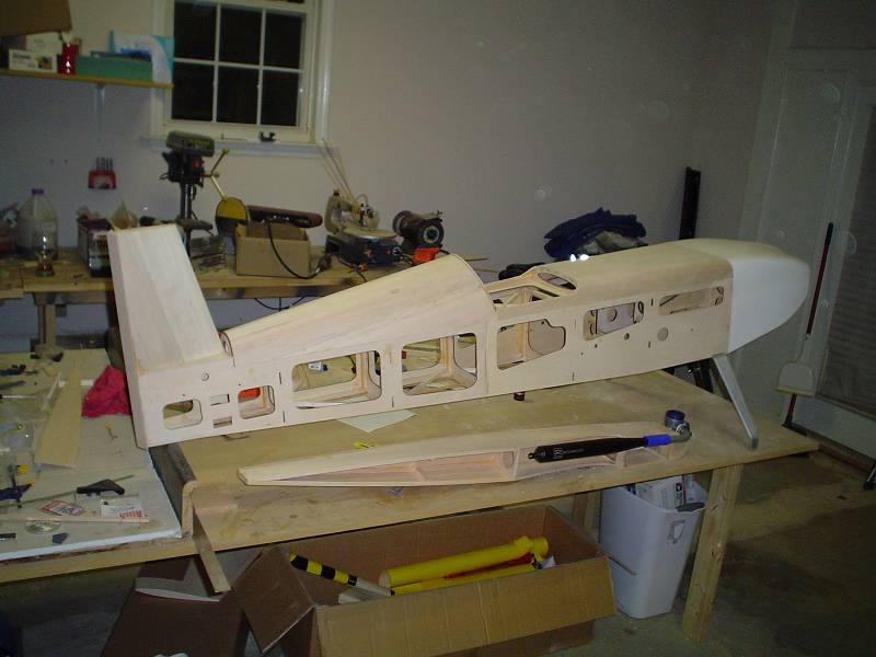

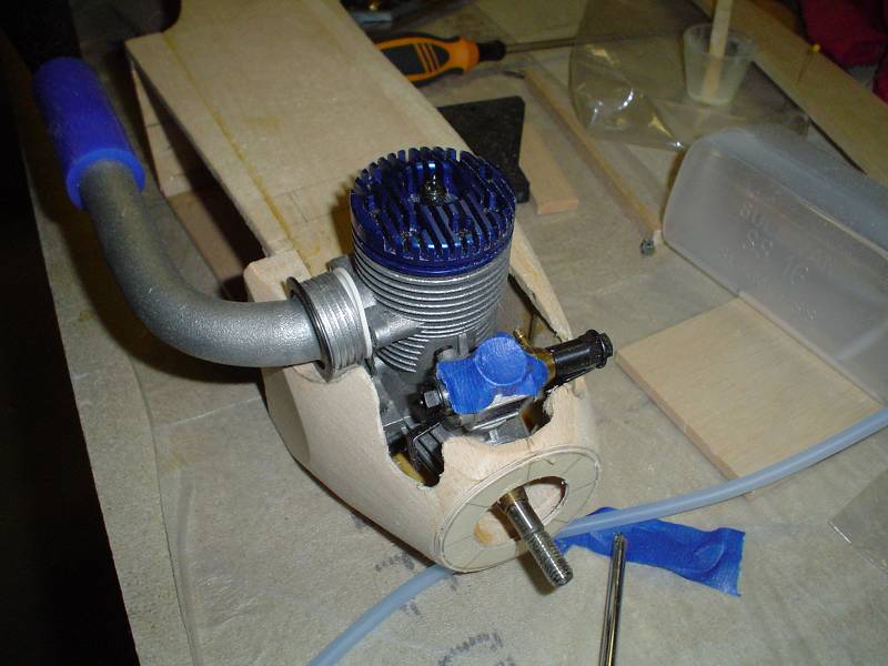

A little more progress made on the fuse. The motor is mounted and the nose is roughed in.
Next I'll install the throttle and mixture pushrods. I'm going to install a plywood plate behind the head for the fuel dot and tank pressure line instead of running the lines through the firewall.
Once that's done I can install the tank floor.

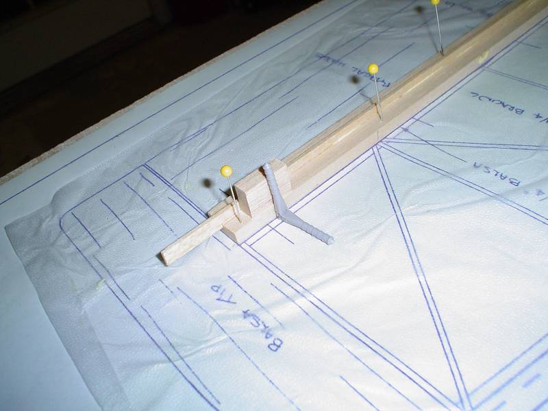

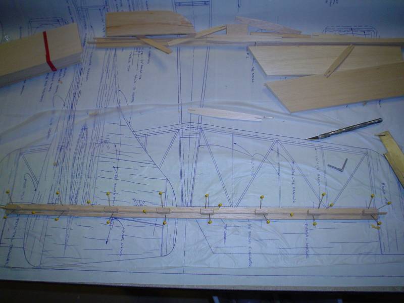

I started on the Stabs.
I first layed out the locations for the hinges on the trailing edge. I'm using Robart hinges, so I then drilled a 1/8" hole at each location. Since the trailing edge is very thin, I added hard balsa blocks for extra meat for the hinges.

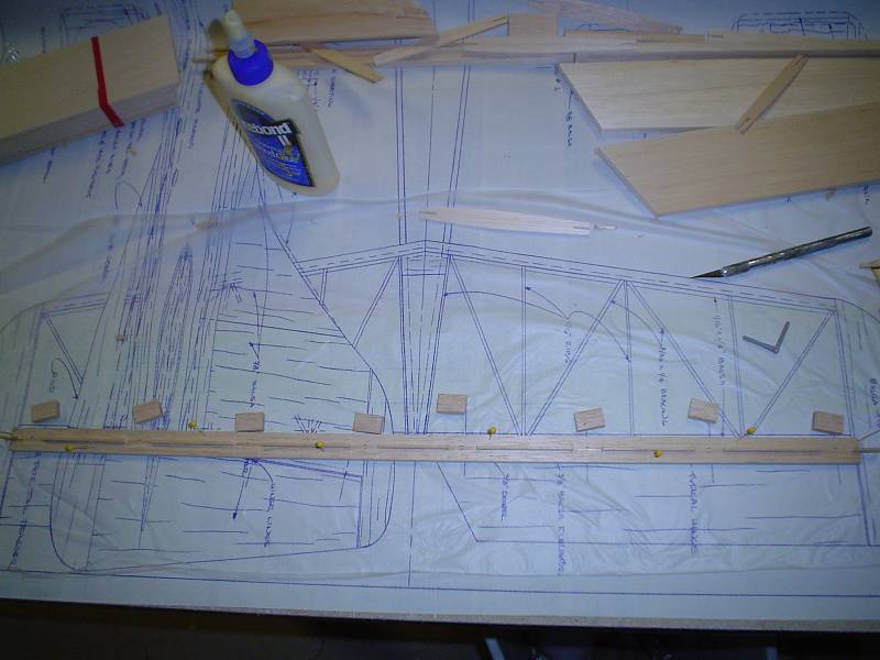

Hello Ben.
Titebond can warp wood if you use a lot of glue and don't clamp/weight/pin the structure. One thing to keep in mind when using that type of glue is that it's water based, and the water can/will expand the wood and cause warps when doing sheeting etc. But if you clamp/weight/pin then once the water evaporates and the glue dries, the structure will not be affected.
I rarely use CA anymore. I find the Titebond gives me lots of time to make sure everything is lined up and where I want it. It's slower, but I find I'm more accurate with alignment and parts fit.
BTW, I plan on glassing the fuse and tail with 3/4oz cloth and painting with Klasskote. The wings will be Monokote.

<xml>This winter I bought a DB-60 kit from BlueJay, and finally did the maidenflight yesterday. It flies supper nice. I consider myself still a beginner and I was able to land this airplane with a very nice long roll.I'm very happy about it.
Completing the kit was a little bit of a challenge for me, since the wood, the plans and the instructions did not always make sense in the first read. I had to take my time, think it over and re-read the instructions, and in a few instances go my own way.
Some tips (which might be obvious to some, but were not to me):
- Measuring my OS-60 engine and the plans, I decided to move the firewall back about 1/4 inch to allow for the prop to end up in the same place, and not needing longer fuselage sides.
- I used a different nose gear than what was delivered in the kit: I used a taller one to keep the 11x7 prop off the grass, and also used 3" wheels for main gear. Looks a little big, but gives nice clearance.
</xml>- Ikept the control horn on the steerable nose gear inside the fusefale, but to get that working had to hollow out the bottom nose block and the side support block. You have to play wiith this before you final glue these pieces or else it's very hard to get to.
<xml>- Even with the battery pack tight against bulkhead #3, I still needed a lot of dead weight in the tail. I found this out after covering. If I had balanced it before, I would have created a battery compartment further back in the fuselage. If you need weight, it might as well be the battery.
- The plans and instructions did not mention throws. Lynn from BlueJay suggested 5/16" for ailerons, 3/8" for elevator and 1 3/4" rudder. Somewhere else I found 3/8" for ailerons, 5/8" for elevator, 1" for rudder. So I set my dual rates around these values. With my limited skills I was able to keep it under control on high throws. Once I get more familiar with it, I might turn it up a notch.
- To give the canope something to hold on to, Iglued pieces if 1/8"x1/8" balsa on top of the fuselage.

I will try to attach a picture. Some might recognize the color scheme: it's taken from Scott Sapington's Daddy Rabbit on the front of AMA magazine March 2006.

Hey Peter,
That's onebeautiful DB you have there. If that's theplane you built from the kit to mentioned in your post back in October,you sure build fast.... Please keep us posted with the maiden. I'm sure it will fly as good as it looks.

Hello RCU friends.
I started this build over a year ago, went gangbusters on it for a month or so, then put it aside to build a 35% Panzl (in my avatar). There were a ton of issues with finishing my Panzl - mostly Monokote problems - no need to discuss. But anyhow, I was severly discouraged by all the problems I had over most of last winter with the Panzl, that I put all my R/C stuff aside and bought a boat.
Well, summer is over and the Dirty Birdy looked so helpless in its half assembled form that I've decided to resurect the build. I had some pictures of the stab assembly, but the camera that held those photo's is broken.
So here is the status of the build as of today:
The fuse is 75% constructed with the engine mounted (temporarily), the plumbing installed and the nose roughly shaped.
The stab is 90% completed and just needs final sanding.
I have started on the wings and have spent the last couple nights working on the retract mounts for the main gear. - Remember that I'm going with a tail dragger and the spar placement is making the retract and wheel well placement tricky.
***Does anyone have photo's of a DB as a tail dragger? I haven't finalized a tail wheel set up.
I promise to post photos in the next day or so for those that are interested.
