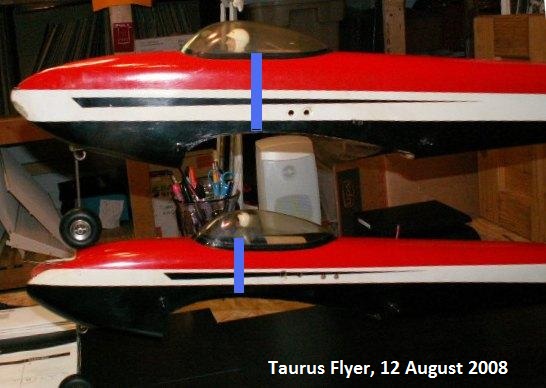

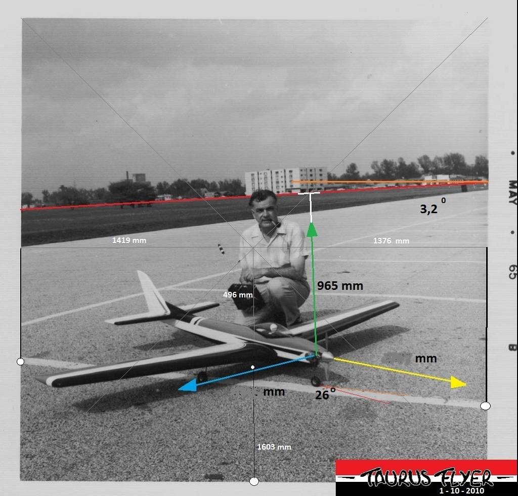

Bo, and for who is interested, just to give a second view with examples.
Why no drawing software?
Try to open these pictures with paint and enlarge them
Look at the x and y coordinates on bottom left side of the screen to make distances readable.
With this simple tool any picture is easy to compare and calculations, also three dimensional if needed with the use of these 2 dimensional coordinates are possible so no CAD but Paint, that’s one of the important software tools for me.
Picture 2 does show what’s possible with rectangular figures on special made combined pictures..
CAD and laser cutting haven’t much to do with the process of redesign and reconstruction of classic pattern planes.
For me it is more an art like sculpting but with the use of calipers, a pair of compasses and a drawing board.
Cees

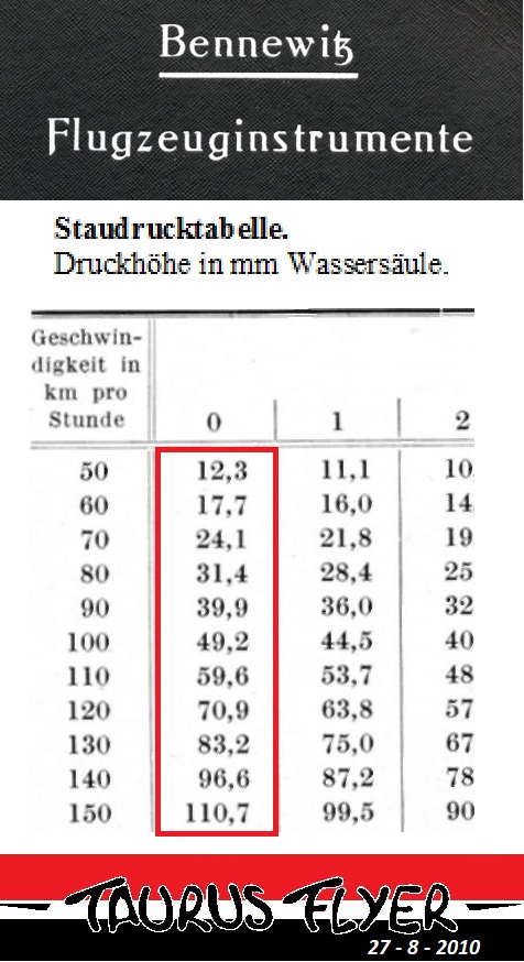

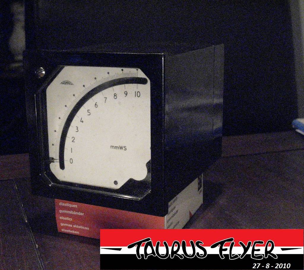

Gents, for who is interested,
I do have some communication about the airspeed measurement and of course the question, how to calibrate the Taurus airspeed transmitter?
More inportant, what is the pressure level of a Prandtl tube?
When we look for values of dynamic pressure, the pressure of a Prandtl tube, we find for example in Bennewitz Flugzeuginstrumente (1921), the values of picture 1. It is a part of a “Staudrucktabelle”. These values does not change, only the Barometric pressure can be some different. We also can calculate the values.
We see the dynamic pressure of an airspeed of 50 km/h is 12,3 mmws (Millimeter Wassersäule) is mm water column, and that is about ½ inch water culumn.
Measuring the important stall airspeed of the Taurus isn’t easy. these pressure levels are lower than ½ inch wc.
To calibrate the airspeed transmitters of the Taurusses I use a Thommen (Switzerland) Micro pressure gauge (age about 40 years, so classic pressure indicator) . Max range of this pressure indicator is 10 mm water column and has a scale to read in tenths of mm. Dimensions front is 95 x 95 mm.
10 mmwc (so max scale) is generated at 45,1 km/h.
Lowest value to check the transmitter of the Taurus has to be about a half of this speed.
The dynamic pressure of a speed of 22,5 km/h is a quarter of the 10 mmwc is 2,5 mmwc generated at a speed of 13,7 mph!
Of course the Thommen is calibrated too (with a German Askania Minimeter).
Speeds above 45 km/h I check with a U tube water gauge, see again values picture 1 red square, flight level 0 km.
There are some tricks to couple the instruments and “generate” these low pressures by hand with a rubber hose.
The intrument indications are compared on a few speed levels, for example 20 -50 - 80 % (is 4 - 25 - 64 % of pressure level of max speed pressure)
Deviations are noted and can be used to correct measurements after flights.

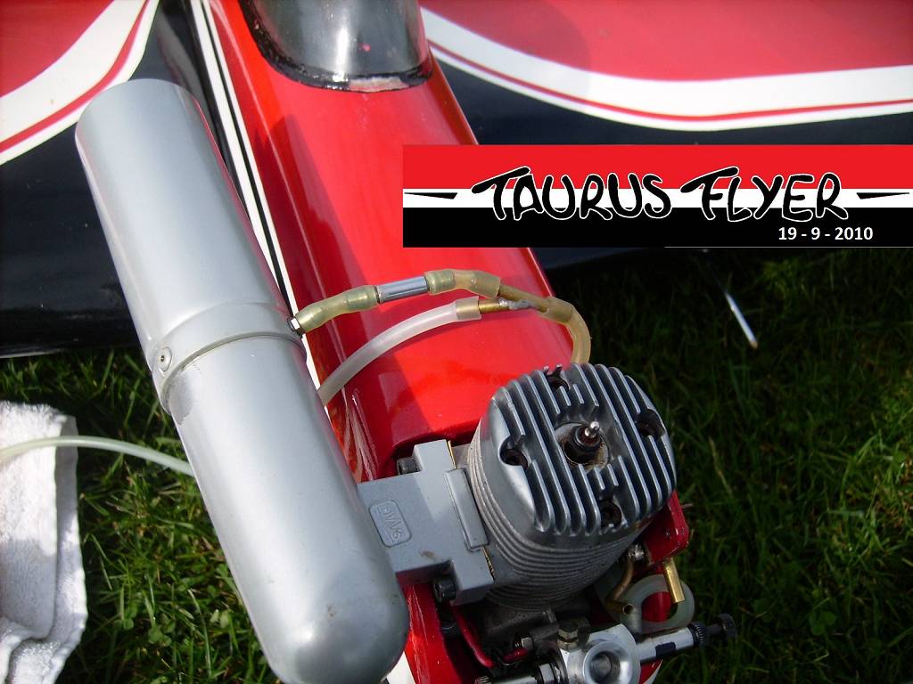

Gents,
Some pictures of my research today.
Measuring muffler pressure without (2) and with (3) check valve in the connection between the muffler and the tank.
I do need the values to know the most backwards possible position of the tank when use a MVVS in the Simla.
I also have to do these measurements with the ST G60 on the benche.
I do not like to use crankcase pressure, much to high in my opinion.
Of course I also did fly today, but the results are only visible on bottom side.(4)
Cees

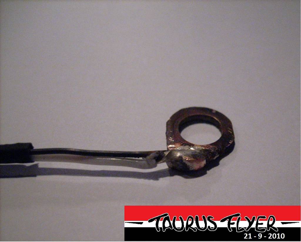

Gents, Top Flite Taurus
Still not ready after overhauling, funny things to do.
Today I did install an new thermocouple. Electronics and element I do make myself.
To archive, a picture of the thermocouple before isolating the wiring. Picture 1
Second picture after mounting.
Important for me is the 200 C degrees detector to detect overheating during flight. (Bad glow plug, lean running etc)
I also can take samples during flight.
Cees

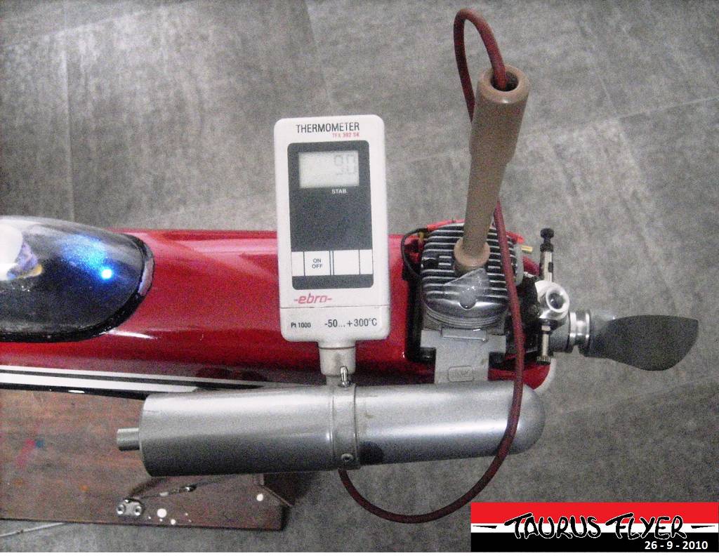

Gents, for those who still remember!
(US 1977, peaking at number 39 in the Billboard Hot 100. Later 1978, Dutch top 40 number one)
I have a very talented Taurus pilot, people often say: “Look at him, go this boy can really fly”
So I did want to surprise him and reinstalled his “?”
Result, yesterday before start-up I did hear him saying to his plane: “It will feel all right, well I want to make your motor run.”
Dashboard
Picture 1, Winter simulation, LED lights blue below lowest acceptable temperature. “Touch it is cold and lonely……….”
I have to “pre heat” for my pilot, after that: “Baby got to go & shout it!”
Picture 2 , Engine reaches normal operating temperature, intermitting green, duty cycle shows us the temp of normal operating temperature. Constant green is above normal operating temp:
"gonna go all the way…..? “Before we go any further………”
Picture 3, Lean running, in a few seconds the LED lights up red as result of a temperature above max acceptable (my check during flight). “STOP RIGHT NOW”, The red color we can reset by power off-on of electronics.
Taurus, looks like a little “Paradis by the dashboard light”.

Old 10-01-2010 | 05:52 PM
  #770
Taurus Flyer's Avatar
Joined: Jan 2004
Posts: 2,408
From: Almelo, NETHERLANDS
Default RE: Redesign and reconstruction of the Oldest Taurus on Earth
Gents,
Angles do not play with us, we play with angles.
Original construction drawings of the replica are ready and we use them to build the plane now. Takes some time but that’s the way we like it.
Because I do have all original dimensions I also can recalculate, in spare time, all other pictures the way I did with the crate picture.
What is interesting?
Location of vanishing points, Point of View of the camera: http://www.rcuniverse.com/forum/fb.asp?m=7993660
and dimensions and angles of remarkable objects, visible on the picture.
Cees

I was surprised by reading these posts; 1161, 1162 and 1163 and some earlier of comparable content.
http://www.rcuniverse.com/forum/fb.asp?m=8638876
Fuselages do have the same vertical dimension people show.
See also:
http://www.rcuniverse.com/forum/fb.asp?m=7892474
Part 3
Yesterday I do read this post and I see my own good old picture back again, the picture of the set of 12 of 12 August 2008:
http://www.rcuniverse.com/forum/fb.asp?m=10051547
So the fuselages now do have different vertical dimensions again?
Of course but still in post 80 we can read:
“I knew there were differences, but I didn't think they so profound.”
Someone who still did have the photo shopped picture of post 1161 in mind!! I think so.
Conclusion:
Same thing happen in other projects now, pictures with “measured values” some after photo shopping “to have better results!”.
