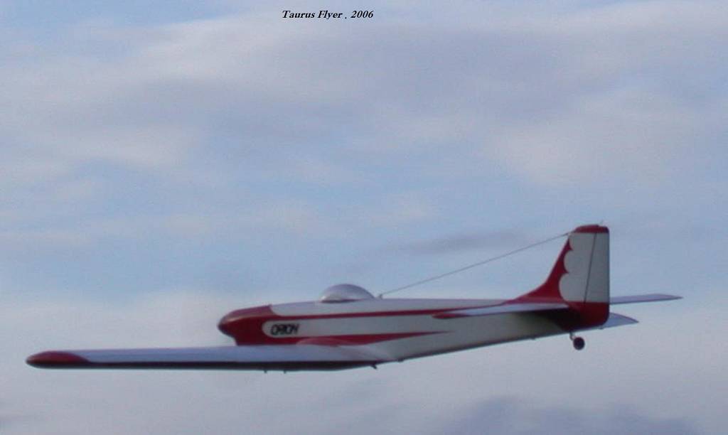

Bo,

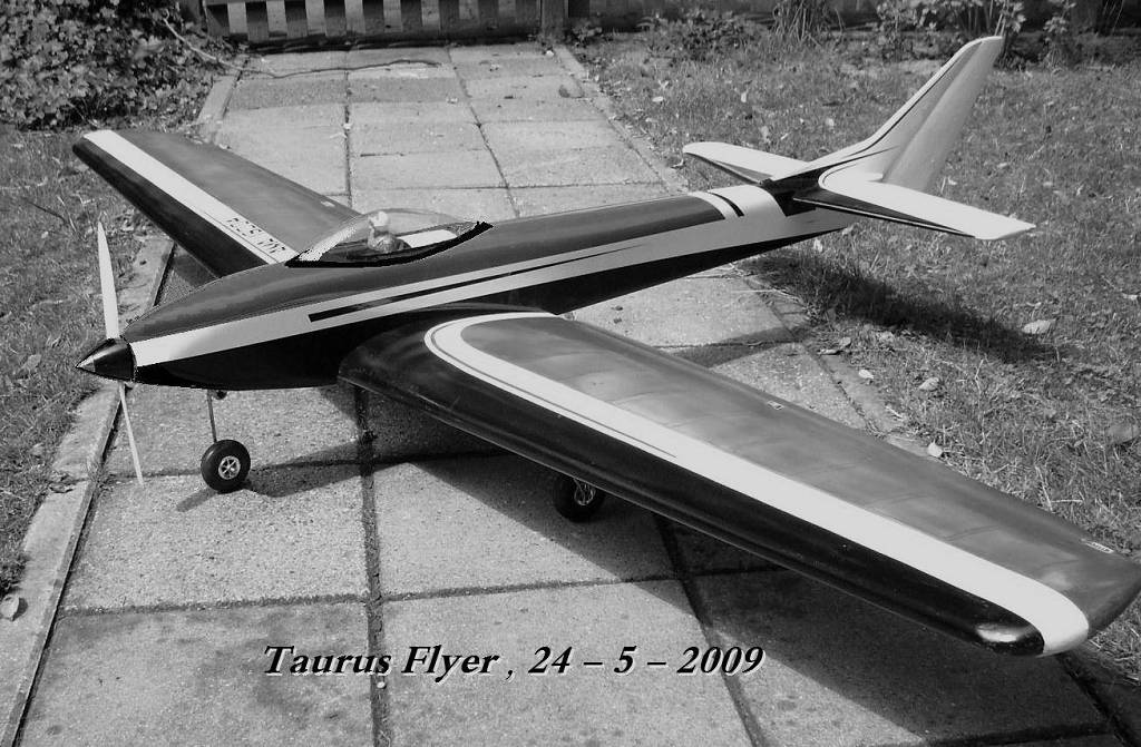

I am an instrumentation engineer and I am interested to design and built ANY part of my planes so also retracted gears. In the past I did make retracts already in pattern planes to experience the problems and results see the black and white pictures, Mäxi, with shorter nose and electrical activated retracts.
So in my situation it isn’t the question, why do you make retracts in an Orion, but, why do you use an Orion to invent retracts. This is the answer.
In the past it started as a Taurus, but after conversations, many years ago in a Taurus thread on RCU with Jim Messer, I did change my project to the Orion, two legs.
The fat wing of the Orion (or Taurus) has a lot of space to built in and try out an own designed system and the Orion did make already hundreds of flights until that spar he met and lost a wing.
Now I am finishing the design of the second generation gear set of my Orion.
My goal is design, build and use own designed systems and retracts are a real challenge!! (force distribution, fail safe, weight, complexity, maintenance, used components)
For example, because leakage is often a point of intention I do use only 3 o-rings in the whole system with plenty of spares!!!
So profits are, learning (most important!!) and nice to see (last picture) but not speed or flight characteristics.
Remarkable is, the Orion is/was 10 pounds , 4,5 kg and does fly excellent with a ENYE 60 4 stroke, so reduced drag maybe is a profit. The weight of the plane I always have to keep in mind when flying the plane (climbing!). Now, after finishing the plane next week I hope I did save some weight, but I still do not know how much. The reliability of the system again is most important.
About designing, I am preparing a new post about pneumatic retracts systems: “Wheel collar or constant differential pressure relay?”
So stay tuned about the retracts! Maybe in the future to show the “commercial suggested” method and an industrial solution for my Orion to control the speed of retract.

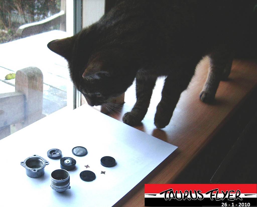

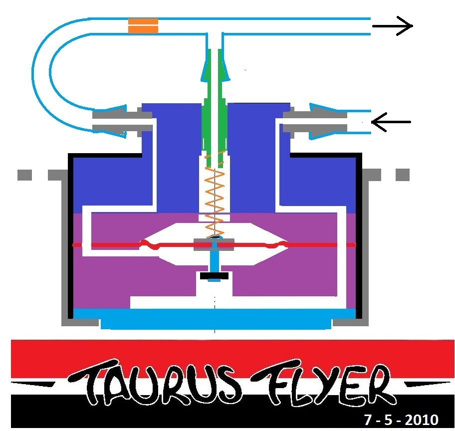

So, leakage test finished with good result.
After the movie is made I did not change anything on the plane, now, 24 hours later the legs are still ”IN”. So leakage test is also oké
Reliability has a lot to do with complexity and amount of components, that’s the reason I prefer pneumatic above electric retracts. Also fail safe is easy to realize.
For me the retracted position is as important as the "tract", I prefer belly landings outside the field or when there isn't enough length , normally without damage.
In the industrial instrumentation in the past we did use a lot of pneumatic equipment; measuring instruments, analog controllers and valves, calculation systems etc. Some brands: Foxboro, Bristol, Honeywell, Siemens, Moore.
It isn’t strange we also did see pneumatic control systems in our modeling in the past, read about Karlheinz Stegmaier and Omu. Pneumatic equipment was used in 1960 and 1962 during world championships pattern flying. In 1962 there were still 3 pneumatic systems used.
More to come
Cees

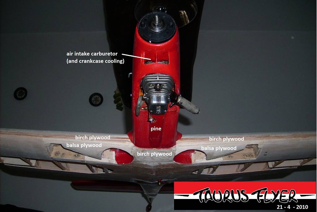

Gents,

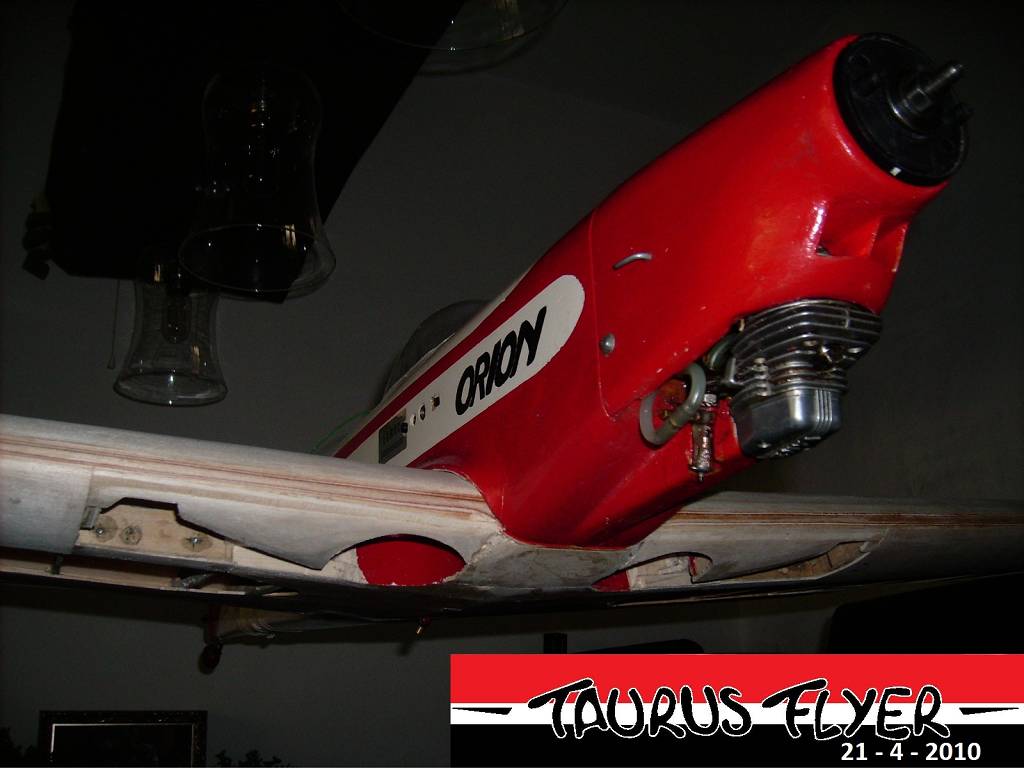

Some construction pictures of the Orion.
Background: The Orion is designed for belly landings, only when the surface is good enough I use the wheels.
The sheeting of the wing in front of the wheel main legs is 3 mm balsa plywood (1/8 inch) .
The sheeting of front part of the wing centre section is birch plywood 3 mm.
The LE of the wing is also covered with birch plywood, 1mm
The wheel legs and covering will be positioned behind the balsa plywood wing sheeting when retracted. So the balsa plywood will protect the legs for damage during belly landings.
Second picture you see the engine protection, the pine headrest is to protect the engine mounting. There is a gab of about 0,5 mm between the headrest and the valve cover. So the engine only makes contact with the headrest during belly landings.
The high positioned air intakes for the engine cooling is also used for the carburetor combustion air. This high position and over pressure in the plenum chamber will keep out dust and sand from the engine air intake during belly landings (I hope).
So, did we see the Father of the Oldest Taurus on Earth, Orion, with three wheels in 1961, I often use no wheels !!
It is whatever you want to make also your plane a winner.
More to come,
Cees

A picture of the inside of the wing, location of the right main leg.
All these pictures are helpful in the future when looking back at the results of the several designs and modifications.
First generation was single pivot (double ball bearing bolted together, 8 mm axle) and very heavy. About 10 modifications after the first flight of the Orion and over several years. The legs were easy to mount with two bolts on a plywood plate on the main spars.
These (second generation) legs both have two pivots, plain bearings (6 mm axle) with distributed mounting points. Light but complicated to align the two pivots, That’s also the reason for the glass reinforced plate to mount the front pivot block on.
The new legs have some very strong positive points, cost prize and weight. Interesting to find out the quality.

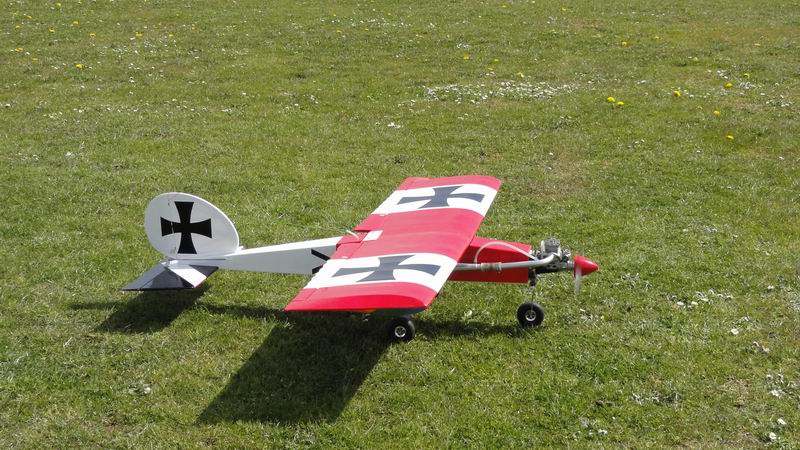

Gents, to make a story complete.
I did make a post about mounting the tank in a Taurus (or plane without a hatch above the tank, see post 678.
http://www.rcuniverse.com/forum/fb.asp?m=9562117
While mounting the tank in the Top Flite Taurus, I discovered the job is more easy, especially wen the lines were already used, after winding some thin tape around the end of the line and steel spoke.
See the picture and the blue arrow.
Cees

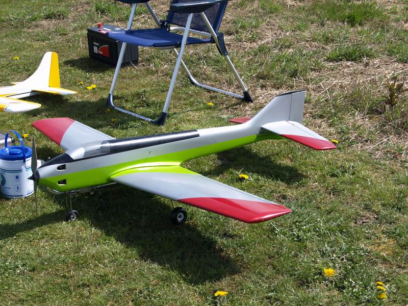

Flight report,
Preparing for a demonstration in Umtali, Rhodesia 24 April 1962?
No, in Lienden, Netherlands, 24 April 2010. 48 years later
Pictures of my visit at the vintage meeting in the Netherlands with the two Taurusses from the crate of Africa.
The Top Flite Taurus did make 4 flights after the overhauling and the detailed new paint scheme with original Taurus name.
Cees

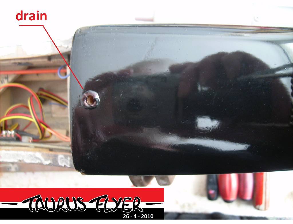

“Fuel and oil on the wrong places”, in the engine bearers and under the covering.
First the bearers,
I do have to ”service” the fuel pressure controller so it was possible to make a picture of my way of mounting the engine on the bearers of my “Top?” Flite Taurus, that was also the reason for this post!.
The bottom of the engine room is closed, no nuts or whatever visible. The bearers and wood in the engine room is covered with two component epoxy.
The bolt heads are soldered on a metal plate, on bottom side of the bearers, and glued, with white glue, in the drilled holes of the bearers. The engine is mounted on two glass reinforced plates that are also glued on the top side of the bearers with epoxy, see post 707.
In case of a broken bolt I can remove them with a solder iron, that’s the reason to use white glue!.
I did remove the thread of the top of the bolts. for easy mounting of the nuts.
Each bolt has a ring-nut-lock ring-nut combination to mount the engine, see the first picture.
With this way of mounting never any engine will leave, unwanted, the room.
I use MVVS 10 CC and OS Max 61 FX, they do have the same positions of mounting holes.
After 6 years and after the overhauling, the engine room is still “as new”.
The tank compartment is painted several times and I drilled a 3 mm, 1/8” drain hole on lowest point to detect any leakage of the tank. See second picture.
(This is not a rearview mirror but the bottom of the tankcompartment!)

Some more pictures of the vintage meeting in the Netherlands,
There were a lot of airplanes, scale, sport, gliders, helicopters.
I only did make a choice of the pictures of pattern planes of the past.
And of course two of the Top Flite Taurus
Cees

Gents, for who is interested,
Some people will remember my drawing of the Perry pump after our research, picture 1 , but what's this? picture 2
More to come.
Cees
More to come.
Cees
#723
Picture 2 of the last post has nothing to do with fuel injection.
Off topic
Hanna was very ill for period so we did use fuel injection. It is going a lot better already.
Cees
Off topic
Cees
