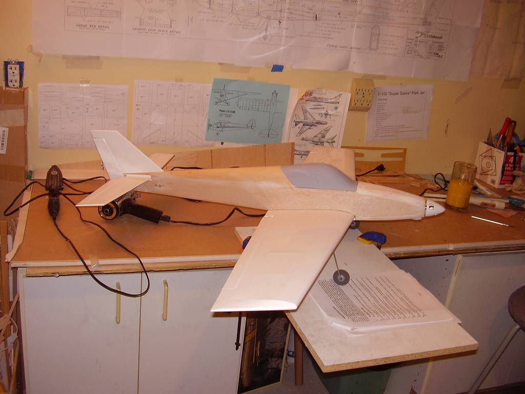

alright fuse is finish sanded and came up with a scoop to get cooling air into the motor area. Got the canopy sanded and smoothed and a coat of finishing epoxy put on. Gonna paint it black to go with the scheme i have envisioned in my head. Any ways the scoop is a plastic spoon cut in half and glued and blended into the fuse bottom. Just have the fairing where the wing meets the fuse in the dowel area to do and covering wil comence. Colors will be white,sapphire blue, Sky blue and black.Anyways more pics and more tommorrow. Phil

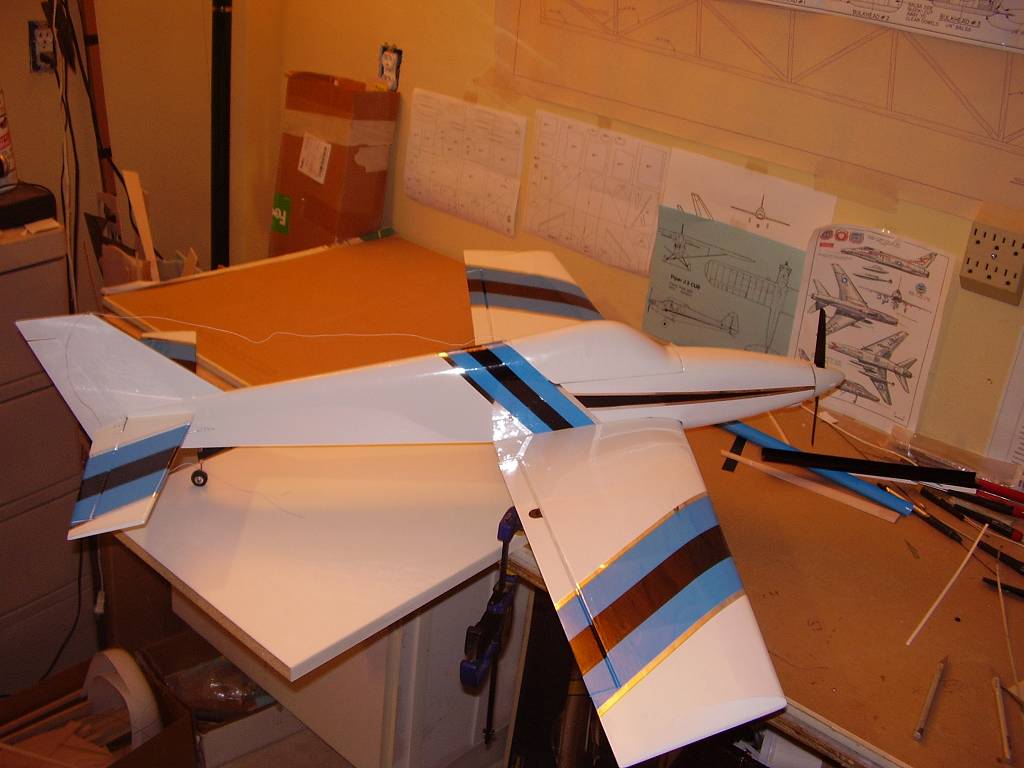

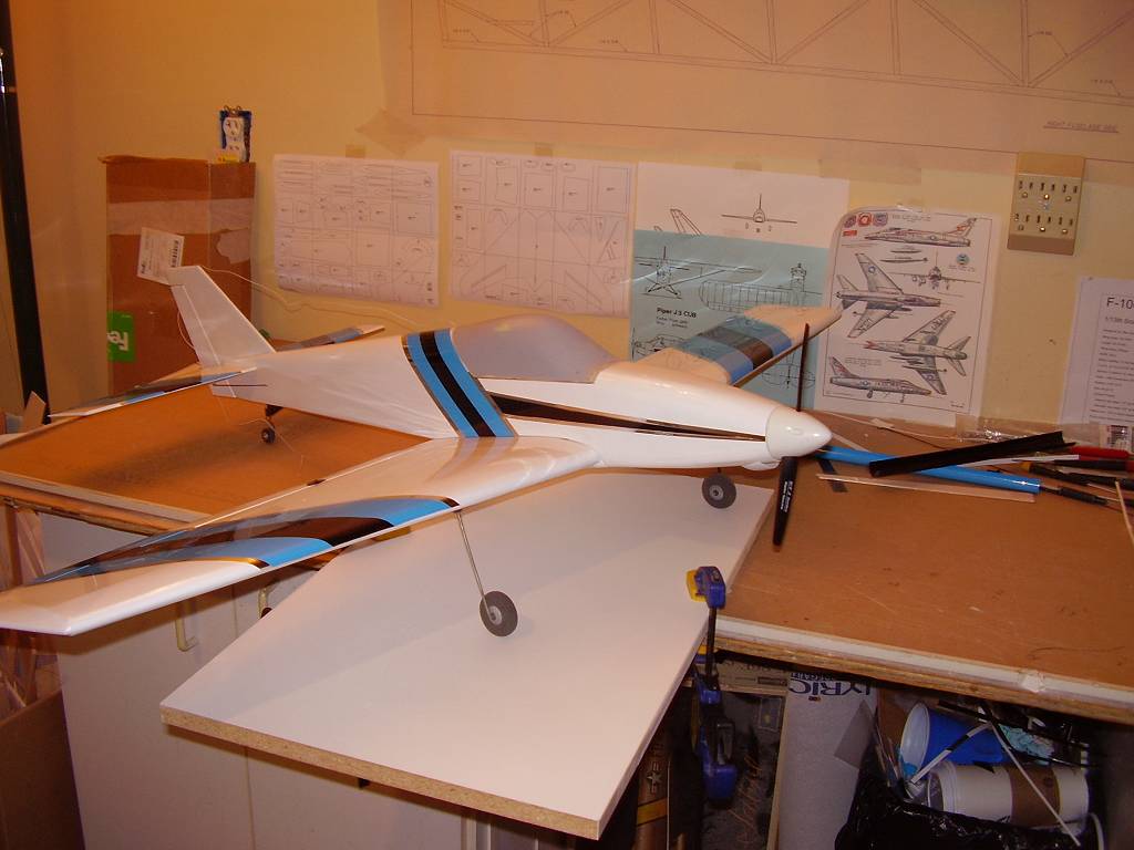

alright base white is on and started the trim. All controls except ailerons are in and working correctly including retracts. So finish trim and canopy and i think we will be ready to get this bird in the air. Phil
ID:	1641714   Click image for larger version
ID:	1641715   Click image for larger version
Old 07-29-2011 | 03:51 PM
  #358
doxilia's Avatar
Joined: Apr 2008
Posts: 5,200
Received 9 Likes on 9 Posts
From: Montreal, QC, CANADA
Default RE: Tsunami Build Thread
Phil,
nice and clean covering scheme. Are you planning on adding some contrast?
That is an interesting prop. What kind? It looks rather small for an electric and/or for a model of that size.
How's the 40 size coming along? it'd be cool to have the pair side by side at the field...
David.
Old 07-30-2011 | 09:06 AM
  #359
Joined: Jul 2010
Posts: 191
From: caledonia, MI
it's a 6/3 ma but it's what i git for now need to get new batts first anything bigger and it goes into lvc cutoff so batt is shot but good enough to co set etc. The 40 is getting the engine fitted and the turtls deck repaired and then off to finish the covering. I plan on adding some black stripes along with the blue on the top of the wing and maybe checkers on the bottom for orentation. Hoping to improve my aerobatic flying with these so orientation will be my biggest concern with these. anyways more to follow next week. Phil

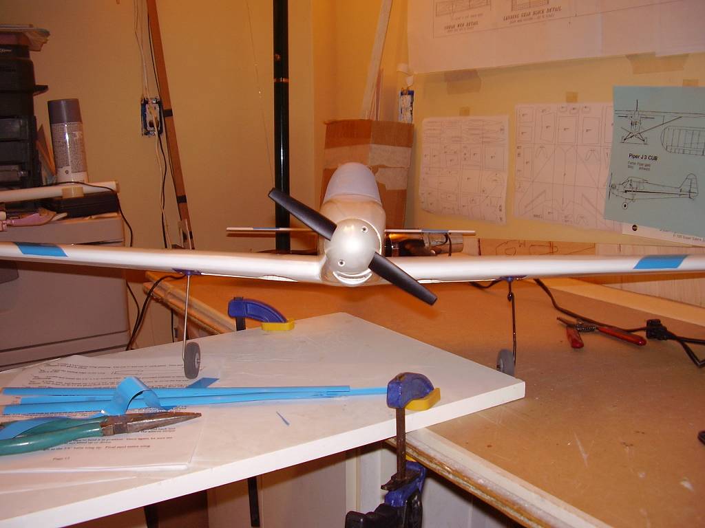

Old 08-08-2011 | 06:16 AM
  #360
Joined: Jul 2010
Posts: 191
From: caledonia, MI
ok progress mis being made just nothing picture worthy yet. Fixing my canopy where spot putty ate the faom away and balancing. Looks like i'm going to have to add 1 ounce of lead to the nose to get her to balance right. And this is with a 2200 3s batt pushed all the way to the firewall. Wasn't expecting that. Any ideas on to add usefull weight? Maybe biggerr battery? What do you think. Phil. Also thinking about my next project. I've narrowed it down to a picorare,40 inch wingspan curare, Or a .40 size dirty Birdy. What would any of you do? Opinions? Phil

here are pics of the amount of lead i need to get this to balance at the specified location on the plans. Any body have any ideas on to get rid of atleast a portion of it. That is an ounce and a half on the nose. Phil
ID:	1646394   Click image for larger version
ID:	1646395   Click image for larger version
ID:	1646396   Click image for larger version
Old 08-09-2011 | 07:51 AM
  #362
doxilia's Avatar
Joined: Apr 2008
Posts: 5,200
ORIGINAL: mrshea
here are pics of the amount of lead i need to get this to balance at the specified location on the plans. Anybody have any ideas on how to get rid of at least a portion of it?
Yup! Use a heavier motor. Sounds like you might need the thrust anyway.
Also, you could use an aluminum E-Flite, GP or TT E-spinner but I'm not sure how much weight it will net you.
The location of your weight is requiring much more than you effectively need. If you place the weight in the motor bay say flush against the FW, you should need quite a bit less.
Finally, use higher C rating (e.g., 30C) or slightly higher capacity batteries (e.g., 2650 mAh) - they will be heavier.
Oh, you could also use heavier wheels but that won't help a great deal due to their location close to the CG.
Coming along nicely but I'd imagine it will be hard to see your Vortex in the sky! Maybe you're not done with the covering or your eyes are excellent.
I'd go with a graphite metallic paint for the canopy. It will make it look like business is meant! [8D]
David.

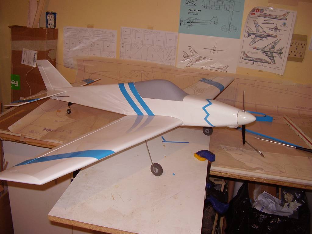

ok most of the trim done and final primer coat on canopy. Almost done. Have to figure out how i'm going to the bottom yet, But almost there. Phil

ok more trim done this morning. Turtle deck and verticle fin done. More tommorrow. Phil

Good stuff Phil,
looking good. Is your radio installed? I'd be interested in knowing the AUW without battery.
How're the retracts working - take a little video with your camera if you can.
Is that LK primer on the canopy at the moment? If you are still planning to do a metallic gray or some other color on the canopy, I have been using some cool automotive rattle can paint - Dupli-Color. It is really nice stuff and comes in a myriad of colors.
