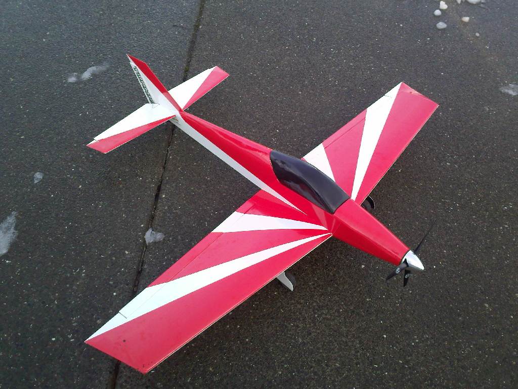

Hi, found this thread while building my T40 over the winter. Finished it up a few weeks ago and put about 3 hrs on it. It's got a Magnum 46 XLS, dual aileron servos and I made some minor internal mods. AUW is 4lbs 15oz, balanced per plans. It's definitely a hot rod, the faster it goes the happier it is. I had to crank a little washout into the wing tips to improve low speed handling. I use an APC 10/5 for best all around performance, 10/6,11/4,11/5 are ok.
It's a blast to fly, has true unlimited vertical, slow & point rolls nicely, full throttle knife edge passes are just down right fun! I haven't done any spins yet, just having to much fun going full speed. The one comment I hear over and over, (why no retracts?). Well the next one will get retracts and I'll add flaps so I can use higher pitch props and still slow it down to land. Also found out that a US40 canopy is a perfect fit after I over heated the original in the dye pot.[:@] A truly nice little plane that's definitely different at the field.
Scott

Scott,
thanks for posting pics of your excellent Tsunami. Great job!
I'm always interested in seeing how others go about layout of gear. Do you have any more pics of your radio install.
What are your thoughts regarding flaps? How would you divvy the wing up flap/aileron wise and would you make the flaps deeper than the ailerons?
Are you running a 10 or 12 oz tank on the 46 XLS?
My plane has a very similar setup to yours (two aileron servos) and weighs an oz more (5 lbs) with a ST S40 and Macs pipe. I'm surprised the 46 doesn't do better on an 11" prop. A 10x5 must really be turning!
David.

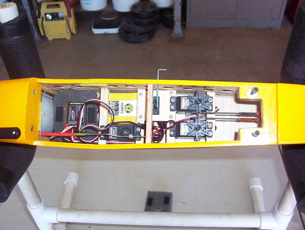

Scott,
Very nice! Where did you get your US 40 canopy? I'm using a carved foam canopy right now and I'd like to consider a proper bubble one.

doxilia, As far as props go, I think I like a 10/6 best but it's hard to slow down for a good landing at my lowest idle and it hauls good with a 11/5 but I got a prop strike on landing, so it's a compromise. Yea it's turning fast with the 10/5. I didn't tach it, but I've burned a couple glow plugs already with it, but it sure is fast and very loud!( I LOVE IT!)
For flaps I think I'd just use about a third of the aileron. I blew it on that, I installed the torque rods but forgot to hinge it for flaps. Maybe I'll retrofit it later at some point. I put a 8oz fuel tank in it, I get 10 minutes at mostly full throttle and enough to land, (just about right for me).
bwoollia, I got the canopy from Tower Hobbies. Look under parts, Great Planes, Ultra Sport 40, (not expensive).
Nice plane, I'm really liking your gear set up. What size and brand are they? Maybe I'll stop being so cheap and get a nice spinner like yours.

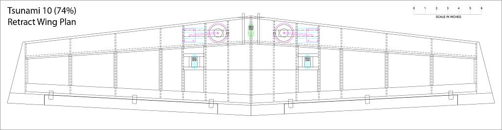

if you need a wider stance, may I recommend that you leave the original ribs in their position and make two sub-ribs (only D-tube section) to hold the retract body. Cut them in balsa and then use those as a template for the 1/16" ply doublers. The interfering rib in between where the body might go can be relieved to suit. It's good to have at least half a rib (the top part) in the D-tube section near the root.
What retracts are you using? What about servos?
David.

I just sketched up the retract and servo installation for the 43" span T10. I didn't find a problem using the standard rib spacings for the GP mechanical retracts but wheels used are 1.5" which should be fine on pavement. The wells are 1.75" but I would suggest making them from 1/64" ply rather than 1/16" balsa. Just to allow a little more space around the wheel. It should also be fairly easy to slide in the rolled ply into a round cutout in the bottom sheeting.
I also pulled 3 of the original 11 ribs in the outer panels. I think the 43" span wing should be fine without them so long as shear webs are used out to rib 6 (the new #6). The last web will be rather wide but I think that's ok.
What retracts are you waiting for Phil?
I hope the drawing helps.
David.

i'm going with the gp 10 retracts and probably a hs 65 for the servo. Hopefully they came in this week because flying weather is finnally here and would like to get this in the air along with my 40 size. Hopefully i'll something to post in the next few days. Phil
Phil,
in that case, it looks like we're thinking along the same lines... [8D]
I drew in HS65HB's for the ailerons and an HS65MG for the retracts. There are some similar sized servos specifically designed for retracts. I forget where I found them but they are perhaps a little more stout. I don't think they are proportional though - probably 180 degree servos. HS-65's all around sounds like a good choice. Dave Brown Lectra Lite or Dubro Foam wheels.
David.

hey dave is it possible to get a copy of that wing drawing at scale. sure would help. Anways still waiting waiting for the retracts. Think i'm going to order them from tower now as the local hobby shop seems to be getting slower and slower. Phil

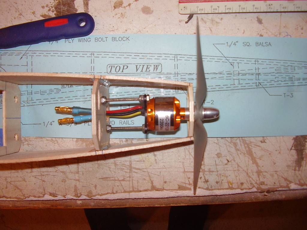

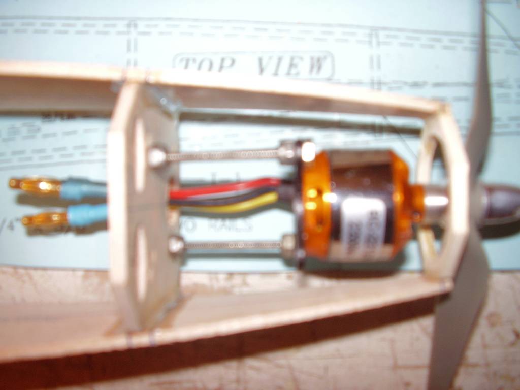

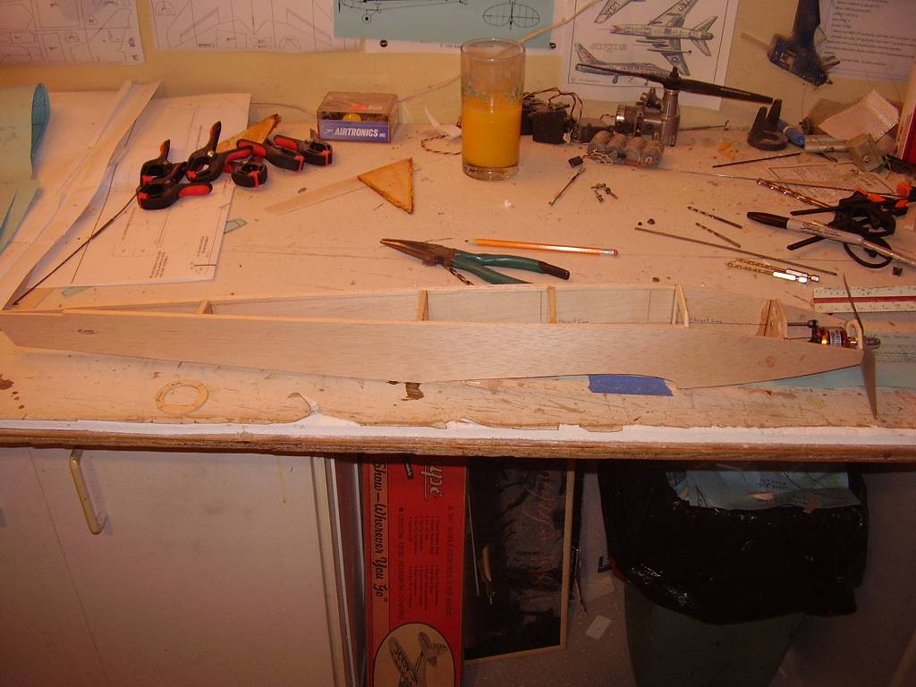

cool video bowilla. Hey david got the fuse for the vortex framed up this weekend and the motor mount figured out. Need more blind nuts and carbon fibre but think this will work alright. Ordred the retacts from tower those should be here in a day or two. Any ways i have oics take a peek and see what you think so far. Later Phil
ID:	1609610   Click image for larger version
ID:	1609611   Click image for larger version

ORIGINAL: mrshea
Hey David got the fuse for the vortex framed up this weekend and the motor mount figured out.
Excellent! Glad to hear that the name I coined up for the 75% is catching on! The Vortex is looking cool [8D]
ORIGINAL: mrshea
Need more blind nuts and carbon fibre but think this will work alright. Ordered the retracts from tower those should be here in a day or two. Any ways i have pics take a peek and see what you think so far. Later Phil
That fuse is starting to bring back memories! I didn't feel bold enough to frame mine up as I didn't have a wing built yet but I suppose one is allowed to build in reverse order from time to time. I might pick up the project again later this year.
Keep up the good work. I look forward to more of your build.

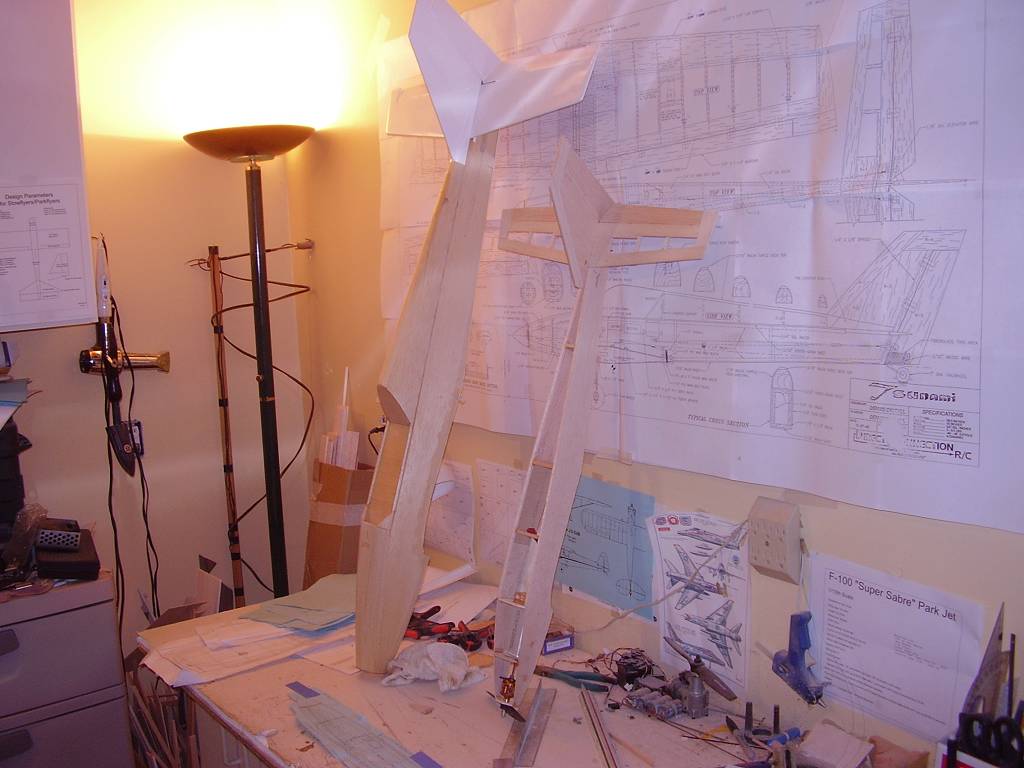

a little more done today. Tail parts built. and i think this what you had in mind for a battery tray/esc mount? pics with a full size tsnami fuse just for reference and my retracts from tower showed yesterday so will get back on the wing seeing how all major components are done. If you want me to start my own thread and not clutter your's up i'll do that too. Later Phil

Nah! Keep it here Phil unless you want to start another. It's a good evolution of the thread.
Looking good. Did you end up using 3/16" or 1/4" balsa for the tail surfaces?
I might be inclined to lightening them up by boring some holes (fin, rudder and elevators) to give you a little more latitude with the battery position. With the light weight motors, the battery often needs to be right up against the FW which is a little inconvenient. If you lighten the tail, you might be able to install the battery where you have it with the Rx behind it and the ESC underneath in the front bay. The 4 servos end up being behind the CG (except retract) so it's good insurance - you can always move the battery back if needed but once you're at the FW, you're kinda out of options other than lead.
Are you in the covering stages of the 40?
David.

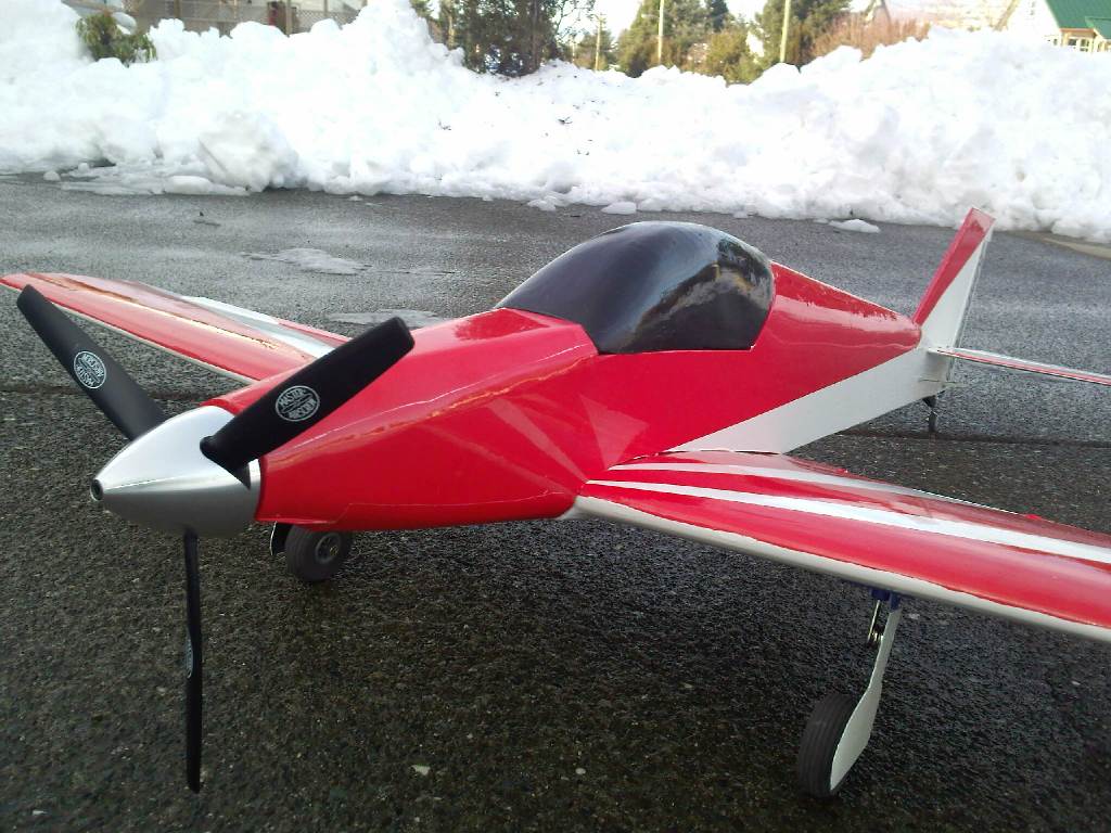

Here is Scott's Tsunami (see post 305) at the Classic Pattern Get-Together, where it put up an awesome performance. Thanks for making the long drive from SD and bringing your cool aircraft. It was a pleasure to meet you.
-Robert

Thanks Robert, the pleasure was all mine. Your get together was well worth the drive. I'm glad you liked the Tsunami, it's definitely a fun little plane. Thanks also to your club the Condors for the use of their awesome field.
Scott
