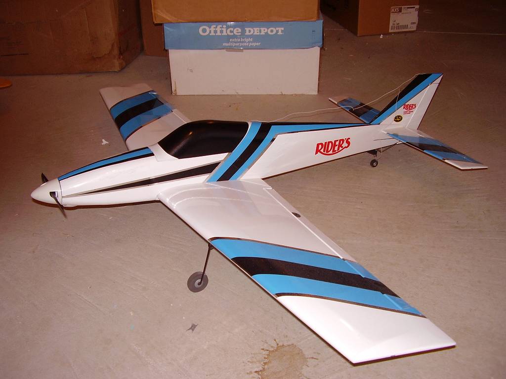

the twins almost finished with them both. Next flying season should be fun. Phil

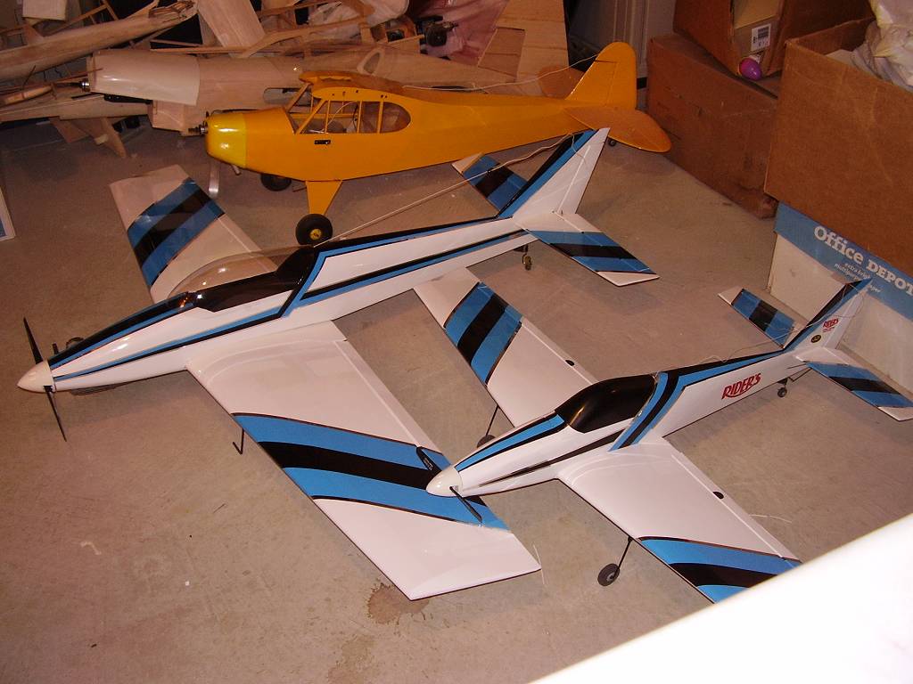

alright i'm building another vortex to trade for a futaba 9c transmitter. Hvve a few ideas to make the tail lighter and and make battery acces easier. Will post pics of the mods i make. Phil

thunder tiger .46 with a ma 10/6 prop. All up weight of the vortex ready to fly is 32 oz even. Didn't weigh fuse and wing seperatley so i don't know. Will post pics of radio layout in the morning. It has flown. Flys just like it's big brother. Phil
