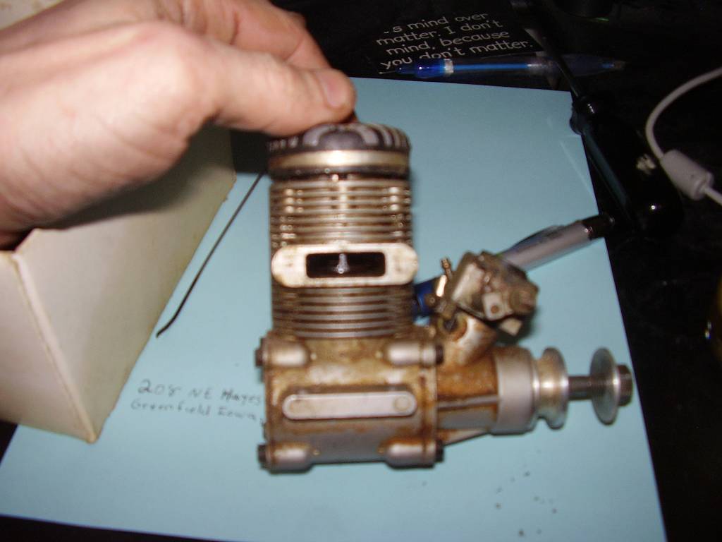

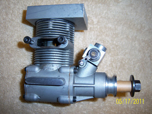

Phil, changing gears (and no one should get upset if I post this here...
), I found a picture of what we want to do to the Webra crankcases. As you can see, Webra taps them in the factory for bolt-on headers/mufflers.
David.

Joined: Jul 2010
Posts: 191
From: caledonia, MI
once i get the header from macs Should be easy for the tool guy's here at work to do that. Only problem i have right now is i can't get the sleeve out of the case so that is presenting some problems. Any ideas on how to get it out? Phil
