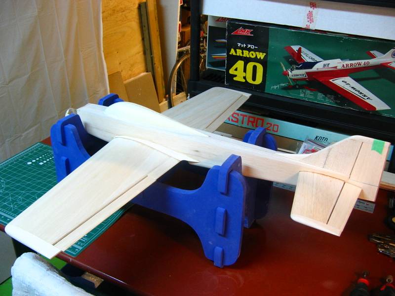

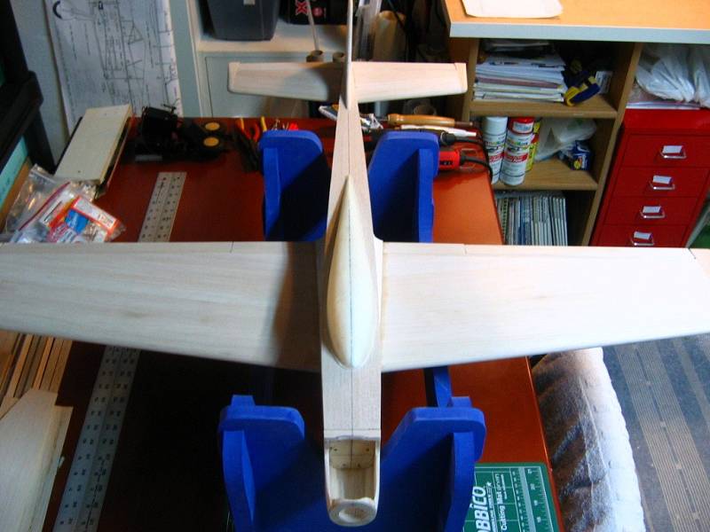

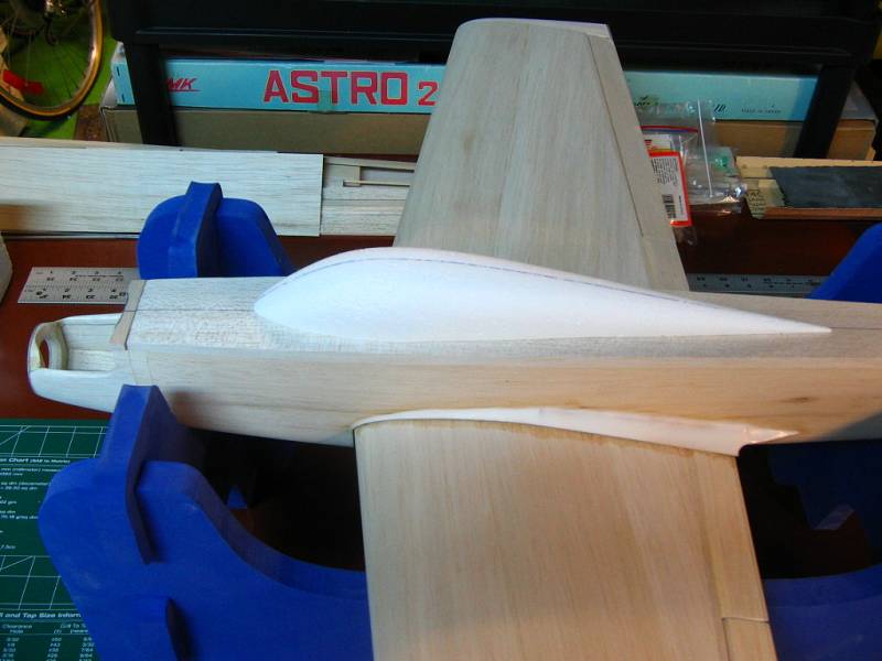

ORIGINAL: doxilia
Come together... right now... over me!

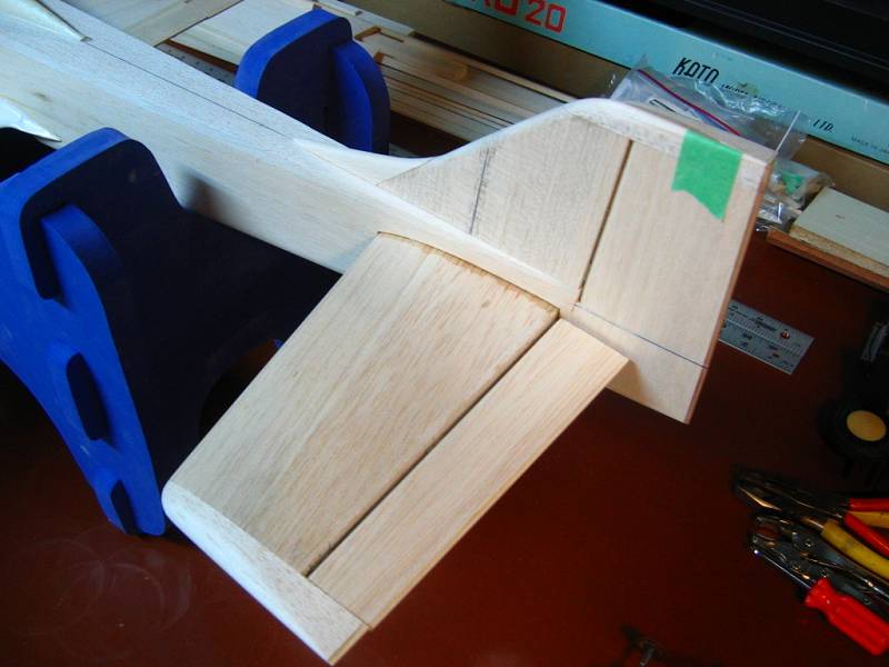

Although, not the sharpest of pictures, the following show the progress on the assembly process. Fuse bottom is roughly sanded to shape (not fine tuned yet), wings and stabs are joined (love the flat top wing!) and I'm proceeding to mount the wing followed by the stab.
... the crux of any pattern aircraft here's the moment of truth!
more to come soon...

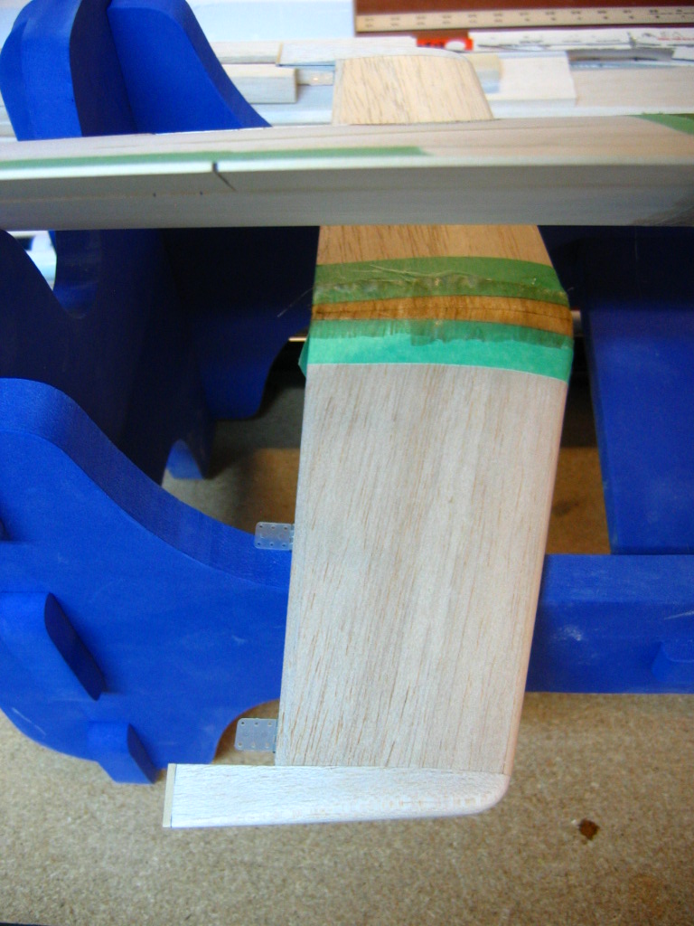

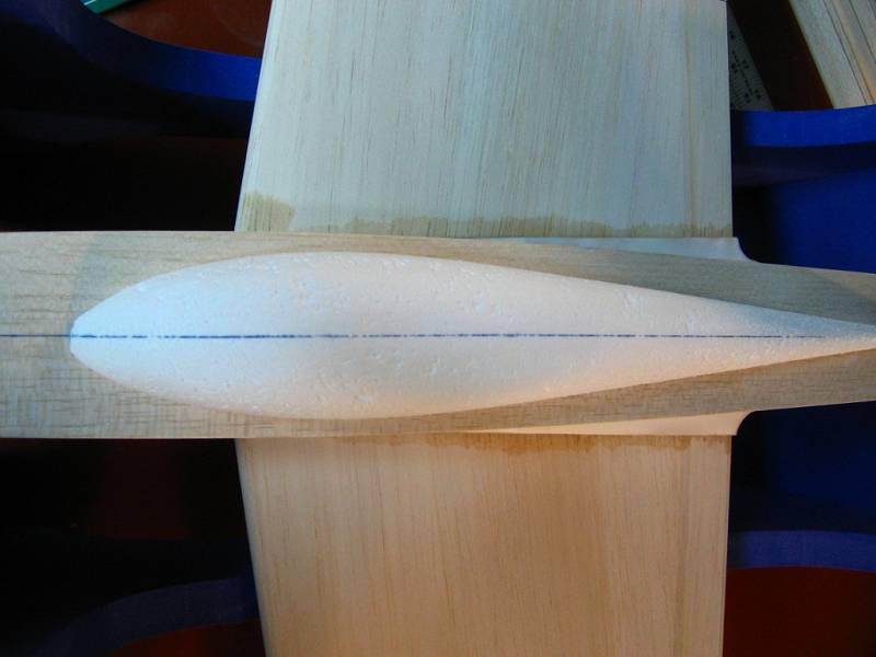

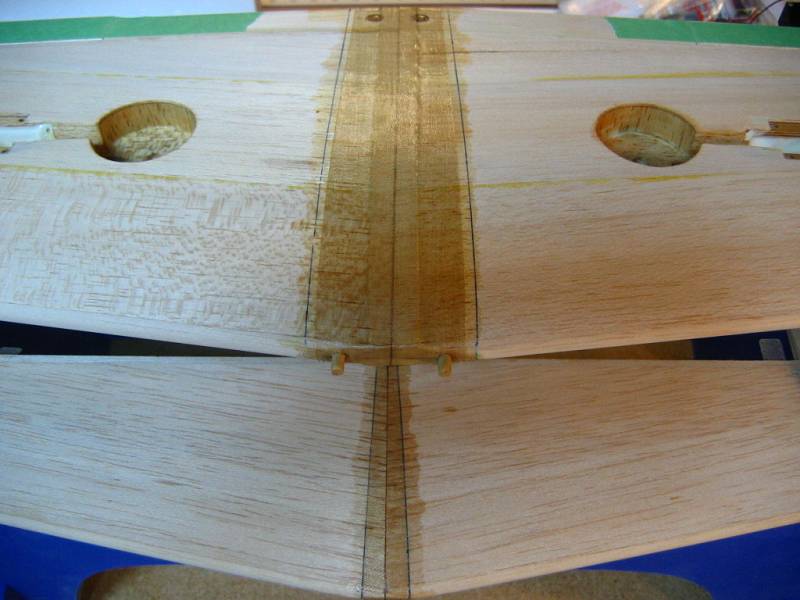

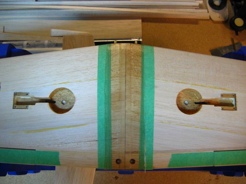

Alright...

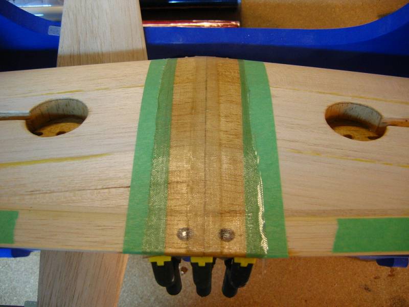

the glass work on the flying surfaces is done. I glassed in two layers starting with a 1" strip at the wing joint of 4 oz cloth followed by a layer of 3/4 cloth. On the wing top, the glass spans the width of the fuse including the wing fillets. This provides a nice wide swath of glass but keeps it concealed by the fuselage. On the bottom, the glass spans the width of the bellypan less 1/8" on each side to allow the bellypan walls to bond directly to balsa and keeps the joint gapless and smooth.
I find that using tape to delineate the desired glass width helps. Further, if the glass is cut at the edge of the tape and removed with the tape while the resin is still curing, the tape comes off much easier. I do it when the resin is a touch tacky and still elastic.
While glassing I also went ahead and sealed the wood of the retract wells with laminating epoxy thinned with alcohol. This will allow primer and paint to be sprayed directly.
The wing of course has been mounted via two dowels in the front extending into F2 and two screws in the rear passed through oak dowels inserted in the wing and drilled out to pass the 10-32 nylon bolts.
Aside from the bellypan, that pretty much completes the wing prep. Once the resin has cured overnight, I'll proceed with the wing fillets (here's where I have to make sure the wing is square wrt the fin) and then the bellypan. With that complete, I'll then move back to the empennage starting with the stab installation, fixed rudder portion (and torque rod!) and permanent installation of the fuse rear bottom (still free in order to install a couple of tail section inserts and secure the stab from the inside).

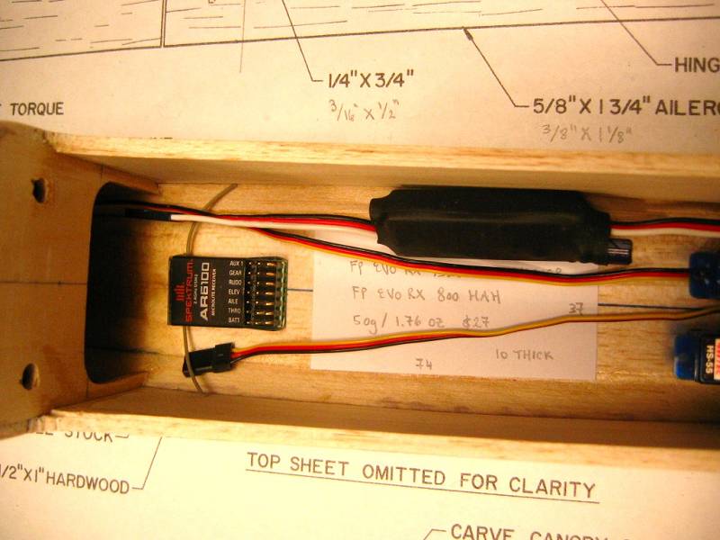

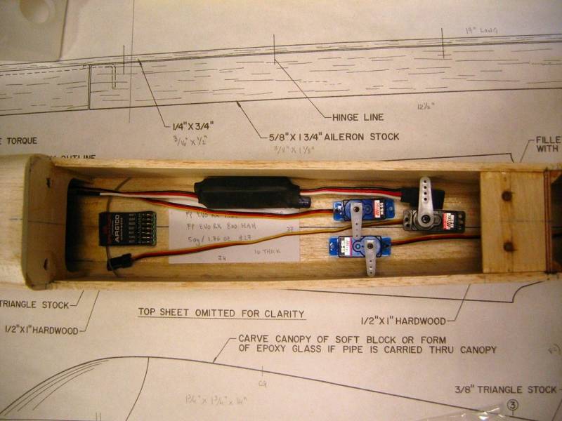

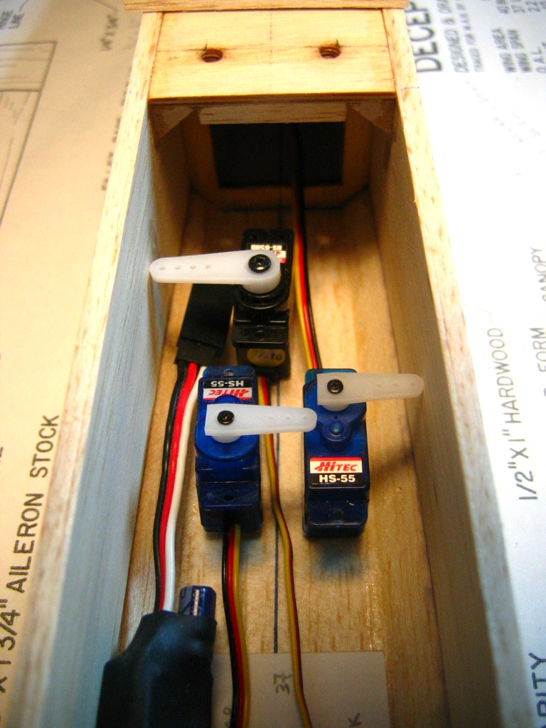

White waiting for the glass work to cure, I began planning the radio layout.
I've converged on using the following Hitec servos:
[ul][*] 4 x HS-65HB for control surfaces (ailerons, elevator and rudder)[*] 1 x HS-65MG for main retract gear[*] 1 x HS-55 for nose retract gear[*] 1 x HS-55 for throttle
[/ul]
I've also quite conclusively decided that all 4 fuse servos will be mounted in a quartet arrangement in the back of the fuse in order to offset the weight of the engine. At the moment I have a gut feeling that the model may be nose heavy with a conventional radio layout and so I decided against installing the nose gear servo in the retract bay.
I'll make 2 radio trays - one for the servo quartet and switch and the other for the receiver, battery and voltage regulator (VR). I decided to go with an 800 mAh 2s Lipo and VR as the combination weighs between 10 & 30 grams less than an equivalent 6s NiMH 2/3A pack. An added benefit is a more constant voltage fed to the radio gear.
The purpose of using radio trays is that it will allow me to dynamically relocate the gear in order to achieve balance. The servo tray itself will slide on rails and will be pushed back flush against F3 or moved forward as necessary. It will be anchored at the front end via two small hardwood blocks on each side of the fuse - one mounted to the tray and the other glued to the rails. Two screws will then hold the tray in place.
For the Rx and Battery the intention is to be able to float mount them with foam underneath since receivers of this size are difficult to wrap against vibration.
Just spacing things out at the moment. I made a paper cutout as a battery template. HS-65's will go in the back and HS-55 toward the front.
to be continued...

I think your Deception deserves better servos than Hitecs. My GS has HS-55's throughout, and one of the first things we all noticed is how "mushy" the plane feels. This second one is getting JR's on the control surfaces. The retracts will be Spektrum DSP-75's.
Andy

#164
ORIGINAL: AndyKunz
Andy
Andy
thanks for offering that suggestion. It's this kind of comment that makes one re-consider ones choices. In the absence of feedback, one simply goes ahead with what seems to make sense.
Having said that, I am considerably more impressed with Hitec HS-65's than the 55's and even the 81's and 82's. I have no experience with the 85's but they are considerably larger and heavier. I find the 65's to be light, fast and strong (30+ oz of torque) at 6V. I haven't seen in my non exhaustive research too many other servo's of this size and weight that deliver the same speed and torque as the 65's.
I've always been a fan of JR and it's what I use to fly but I don't know whether their offerings, at any price, are any better than the 65's - even in digital version. But... I'm certainly open to suggestions. Are you thinking digitals or JR sports (e.g. MN48's or similar)?
I've yet to buy servo's for the D10, the ones that I've been using for measure and in the shots are for a 1/2A electric scale project which is not far from completion. Actually, today I did order a single HS-65MG for the D10's main gear. A larger servo wouldn't work too well as built. I would have to rebuild the servo bay. In any case, those are retracts not control surfaces... those are the servos we really care about!
I look forward to your recommendations.
Thanks, David.

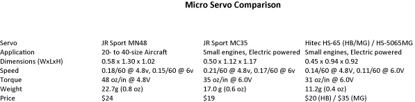

On servos I'm not 100% decided. I think my wallet will have some say
I'm still looking around. The 285MG is fast but not much torque (17 in oz), while the MN48 is probably 'fast enough' and has lots of torque. The 285 should be OK because it's only driving a single aileron.
The servos are mounted on a plate, so changing them out isn't a big deal. I might even try making up plates for each type and then swapping at the field to see if there's much difference in feel.
I _know_ how the plane feels with 55's all around (and not easily swapped out on the prototype), and I'm trying to deal with it by changing linkages and expo. I have to believe I wouldn't feel as disappointed if I had GOOD servos to start with.
As for pushrods, Midwest has some CF tubing that I'm planning to use (# 5720). The prototype has .047 piano wire in DuBro antenna tubes for support.
Hmmm, thinking about it, I wonder if maybe that's part of the mushy feeling too...
Andy
Andy

Andy,
I'm sure the JR 285's are nice servo's but I suspect more in the range of the HS-55 class rather than the HS-65 class. The HS-55's are, as far as I'm concerned, 1/2A or foamie servos (25-30 oz max AUW aircraft) so I don't plan on using them on control surfaces. It seems like where things become interesting is with the JR Sport MC35's and the MN48's. The 48's are better suited to a 45-48" span models - they are largish. The 35's might be an interesting option. The specs off Horizon's site and those of the HS-65 for comparison are posted below in a JPG.
It appears that the Hitec's are the smallest, lightest and fastest. They compare favorably in price and torque with the MC35's. I think I'll stick with 65's for this size of aircraft and probably use 35's and 48's on 20 size models. BTW, the 65's come in a digital MG version too at about $45 [:-].
There are however, some very nice Hobbico (Tower) digitals for $30: the CS-110 (TS-110) and 115's. On paper, these appear to be very nice - similar in specs to the 48's but digital. For rudder one can use 115's for strength and on elevator and ailerons, 110's for speed. I actually plan to use these on two 20 size Tiporare builds when I'm done on the D10. I started a thread here:

Yup, David, I'm hemming and hawing on the servo thing. The torque on the HS-55 and SJ 285 is the same but I have one of each and the JR holds position a LOT better than the Hitec when you try to turn it. That might be part of the difference. There's a lot more travel before the Hitec fights back, so the JR is definitely a tighter servo.
I figured out the pushrods aren't the problem. They are not flexing - they're mounted well at several points in the fuselage. Also, the ailerons are only 3" pushrods and they felt soft too. It's just something I have to figure out, but I think I might be on it with the sloppy hold on the Hitec. I have some MC35's on order now. You're right about MN48 being for bigger models, that's what I have in my Pulse 25.
By the time I'm done I'm going to end up with some extra servos. Have to build a couple foamies to get rid of them
Andy
Andy

No doubt JR servos are much better, Hitec 55's have the worst centering and speed I ' ve ever seen.
Even hextronic 900 have more torque and speed at 1/3 the price .

A quick update on fillet and glass work...
I've cut and installed the wing fillet plates and have made a first pass on the fillets. More work is still required in the rear part of the fillets. The foam canopy mold is also complete and the glass is curing overnight as I write this. I decided to make it in two layers with the first layer of 6 oz cloth and the second layer with 3/4 oz cloth to smooth things out and cover with a fine weave. Another evening of work on the canopy and it should be ready for installation when the time comes.
With these details done, I should be able to finally work on the tail section and install the stabilizer. Once that's done, I'll no longer need a flat top fuse and will be able to proceed to shape the fuse top to contour. Then, some final work in the cowl area and we should be pretty close to having a complete airframe!
David.
David.

Aside from some minor sanding, the fin with its dorsal is complete. The canopy is glassed and plenty strong so unless I proceed to make a mold from it, I'll just leave it as it is.
[ul][*] Canopy weight = 0.7 oz.[*] Fin/Rudder weight = 0.4 oz.
[/ul]
I still can't help myself from playing a little and taking assembled shots!
Now... onward with that empennage!
David.
[/ul]
David.
