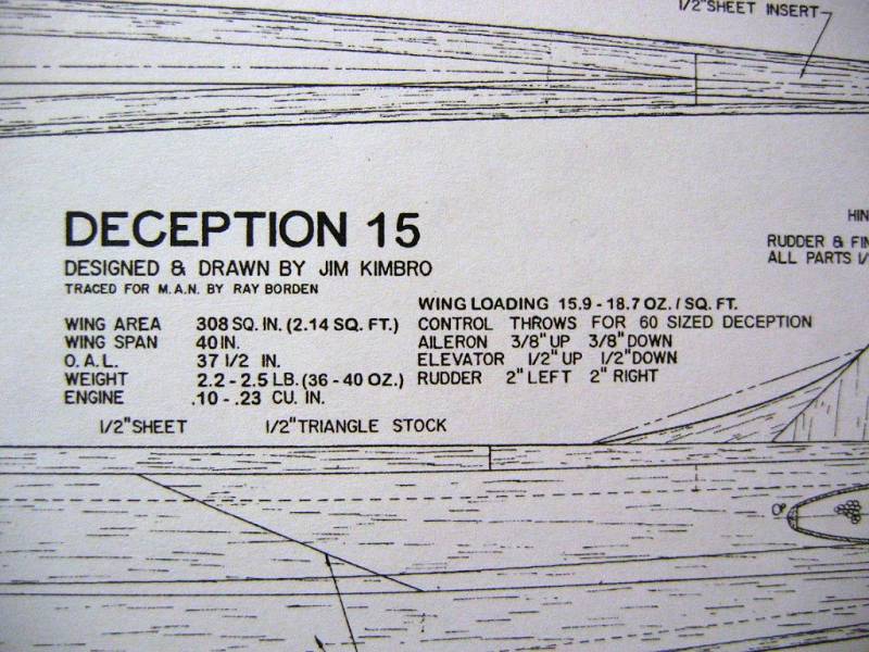

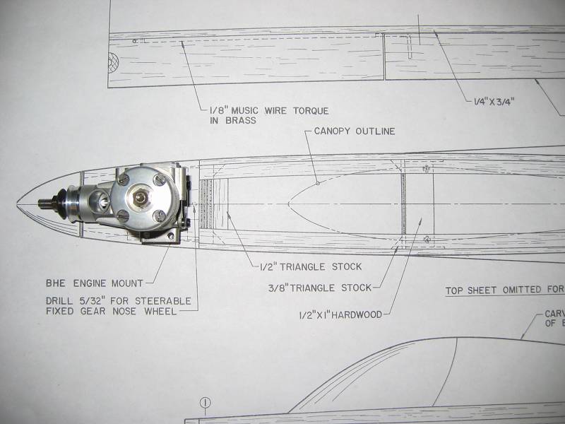

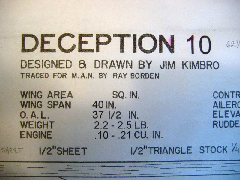

Here are the specs of the plans I reduced and a few planning shots.

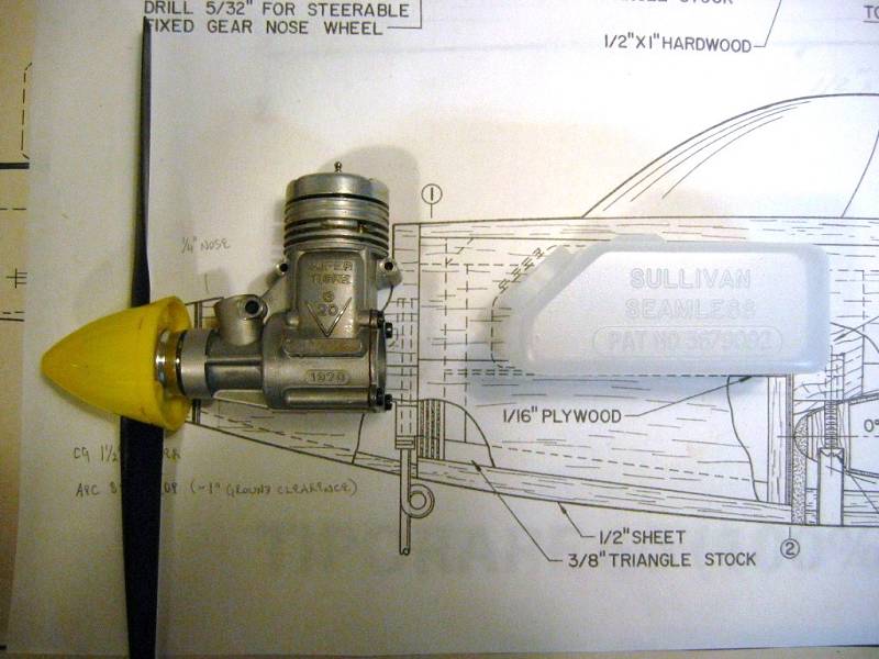

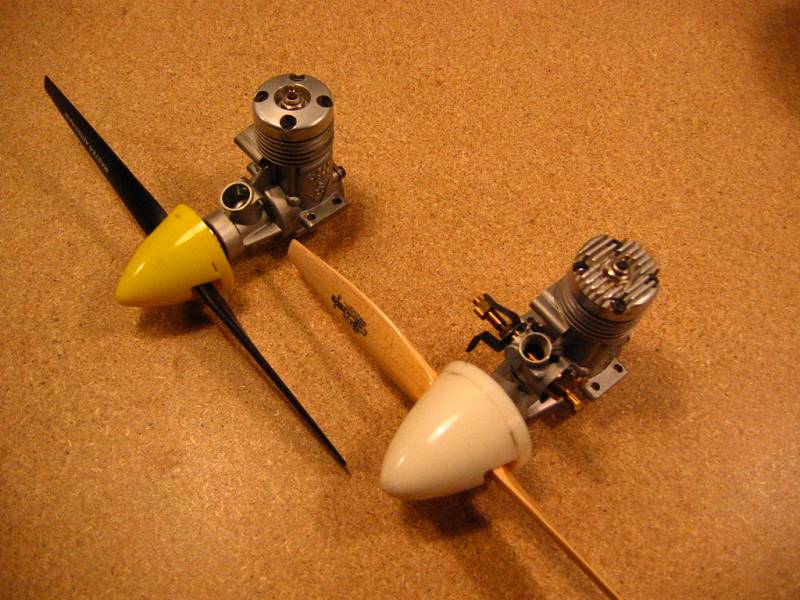

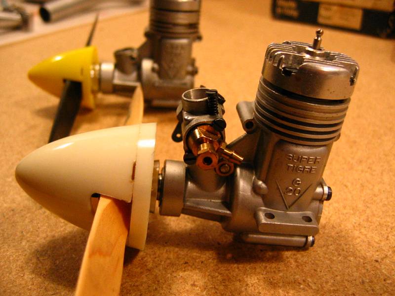

I first had the idea to build the Deception around a 28 year old ST G20/15 that I have which dates back to my CL days. I bought the engine in Milan while on a trip back to the old country when I was... 14 I think. Great hobby store called Movo. I remember the feeling of not knowing what to look at since my time was limited and I wanted to see and touch everything. In any case, the ST is still silky smooth but I had to find a RC carb for it so, with a little help from our favourite auction site, I picked up its sibling - a NIB G20/23 - in this case with a RC carb!
The two engines are almost identical except that the 23 has a slightly heavier crankshaft, a different head, sleeve and piston. Otherwise, the crankcases are essentially identical. Now, even though this is an engine that was designed in 1970, a 23 on this little rocket might be..., shall we say, dangerous!? With that said, given that the engine mount and crankcase are the same size, I am thinking of maybe just bolting in that 23... I also don't have mufflers for either one so, what can one do in such a situation other than pick up a header and 3.5cc muffled pipe from Mac's? [8D]

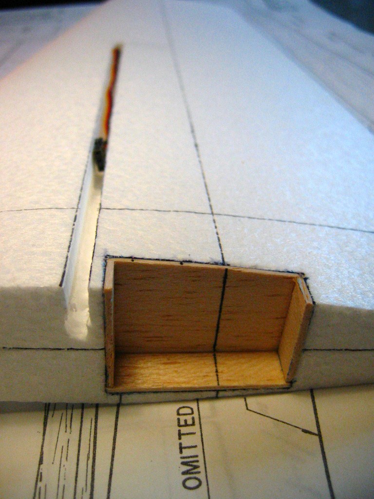

I got started on the wing retracts yesterday. My left gear well (right panel) somehow ended up with unparallel sides for the strut length between the wheel and the mechanism. Something I'll have to fix as it will bug me otherwise. I'm also debating on whether I should stick a couple of dowels through the gear mounts into the cores... I picked up some dowel today. What do you guys say?
Next I'll have to make a shaft for the pushrods to the wing root as well as the servo wells for both the gear and the ailerons. I'm a little undecided about the aileron setup since two servos might actually be lighter than one servo centered behind the gear servo with torque rods (these weigh more than a micro servo!). Food for thought... any suggestions out there?
I'm also not sure about servo's yet. HS-55's, HS-65HB's, HS-82's... I think I will be using Hitec's as I'm not in the mood to drop $ on JR servos. Perhaps those Tower/Hobbico servos might also do nicely although they are a little pricier. Something sub $20 would be nice considering I'll have 6-7 of these in there!
Maybe 55's for ailerons, 65's for elevator and rudder, a 55 for throttle and nose gear and an 82MG for main gear... would that work?
BTW, she will ride on trike gear.

One engine has no cooling fins on the head. It's not a marine engine is it? Looks like you're building on a foam core. What type of sheeting are you going to apply. I would guess 1/32" ply with epoxy? Nice start on a very involved project.

Yea, believe it or not, the G20/15's were made that way. I think there was also a G20/19, if I recall correctly, that had no head fins. All three engines are designed around the same crankcase. I think that since the piston in the 15 is of fairly small bore, the sleeve and crankcase are able to absorb/dissipate enough heat. I've actually run that 15 a fair bit on CL planes at full rpm's and there's not a hint of varnish on it! So it must be cooling adequately. I think I used to run 10% nitro in it.

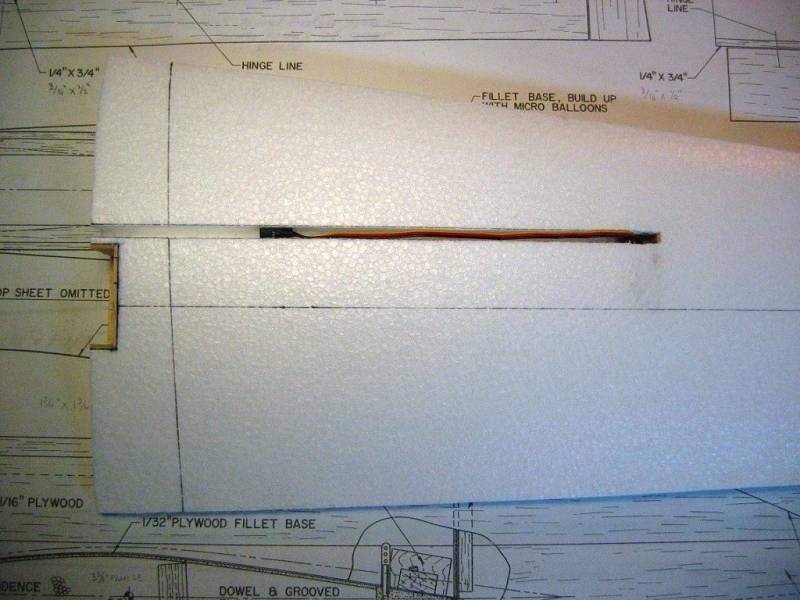

A little progress...

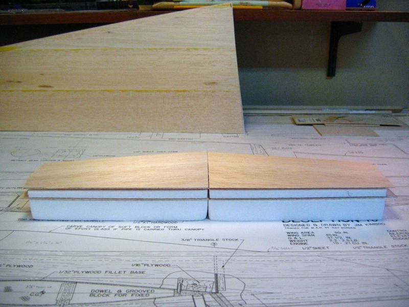

I got the aileron servo installation sorted out. I decided to mount dual outboard servos for simplicity and lightness. They may be wired as flaperons (independent channels) or via a Y-harness depending on whether the nose gear installation will require a servo (likely). I'll be using a super light 6 channel receiver (AR6100) and 6-7 servos. I also decided to go with HS-65HB's on all control surfaces as the HS-55's are a little flimsy for a high powered mini pattern plane. I'll probably also use an HS-65HB for the mains and 2 HS-55's on throttle and nose gear.
The aileron servos are mounted centered on the CG line. I've mostly completed the prep work on the right wing panel. The left panel still needs its servo lead tunnel as well as servo well sheeting. The gear servo center section is done except for the pushrod tunnels.
Wing and stab sheeting has also been prepared so, with some LE, TE and aileron/elevator stock (which I need to pick up), the flying surfaces should come together pretty quickly once the wing prep is complete. I'll be using Zpoxy laminating resin for the sheeting which I decided to build up with aliphatic resin (typically I would use CA to build the sheeting but foam safe CA is rather precious).
I'm looking forward to some sheeted wings and stabs!
David.

I did a few back of the envelope calculations and amended my plans to better reflect what it is I'm building. In particular I was concerned with the wing loading given that I'll have trike retracts and a full radio setup. Also, I'm widening the fuse a little which reduces the effective wing area present for lift.
The good news is that if I manage to keep the weight down, she should be ok (I think ). Even though there's only 40" of wing span, the wing is quite wide compared to many other classic pattern planes. In short, I should have a total of 308 sq. in. of wing area which translates to a wing loading of 15.9 to 18.7 oz./sq. ft. for AUW of 36 to 40 oz., respectively.
If anyone has any magic insight or rule of thumb for the wing loading range aircraft in this size should have, please do chime in. David, I enjoyed reading your SureShark build thread and will get back to you. I noticed that your build came in very light at ~24 oz to yield 14.4 oz./sq. ft! If I can get the Deception to come in at ~36 oz. (~15.9 oz wing loading), I think she might be golden!
David.

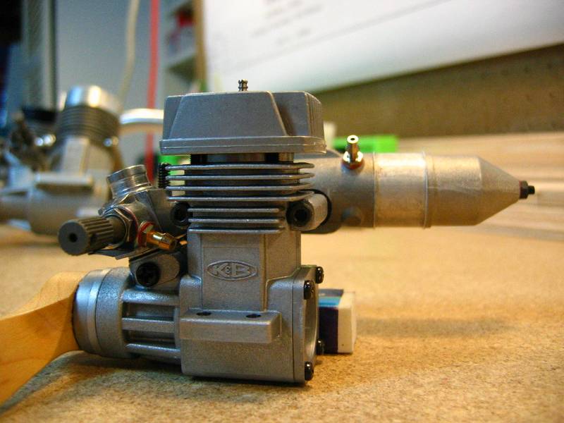

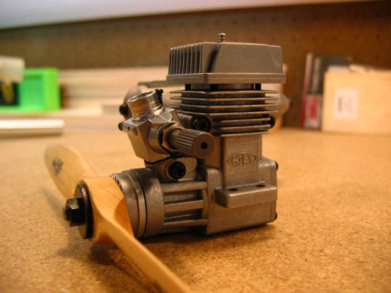

Mmmm... now I'm a little confused. What to do...?

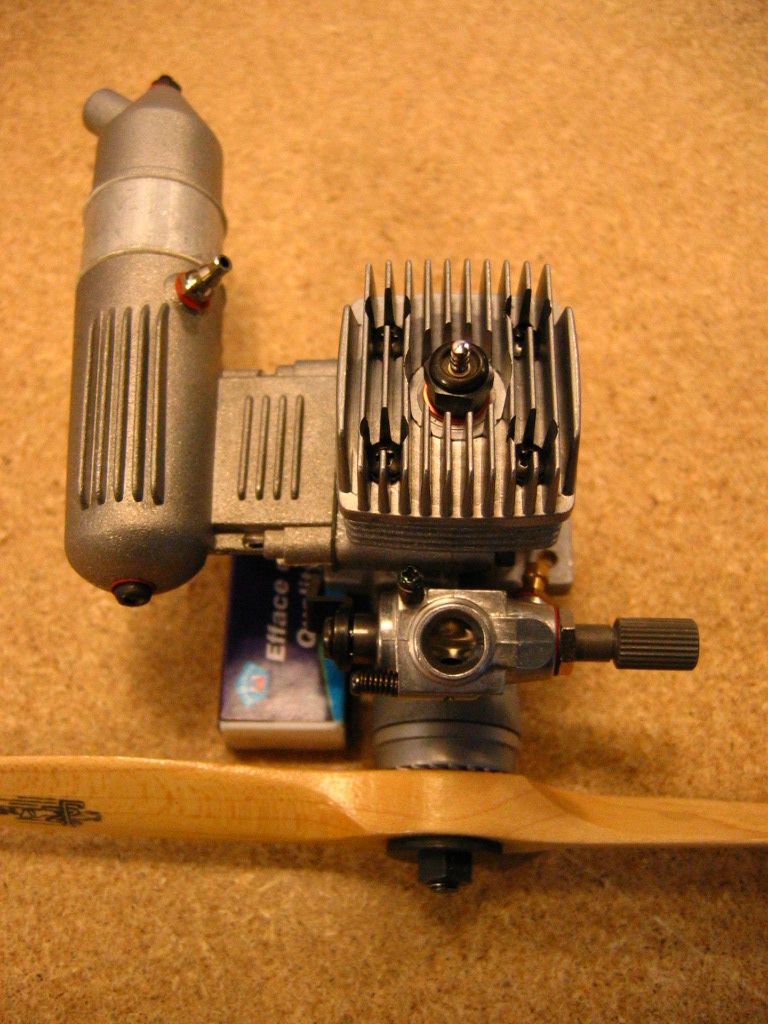

Have you guys seen one of these before? K&B 18 Aero. They claim 1.2 HP @ 18K on a pipe w/ 30% nitro. [:-]
It was practically a gift.

My K&B .18 is a DOG! You would be much better off with a good, lightweight .15. When I first saw the .18, I was glad to see a K&B product as I always had good luck with them. However, this one is not a screamer like my old K&B's. Look up previous threads on the .18 and you will find that others have had the same experience. I threw $90 away!
Frank

that's too bad... [&o]. It looks like a nice little engine. I actually picked it up for $30 plus shipping so maybe I got lucky. I do want to try it out on a little 2.5cc pipe though.
The ST G20's I have faith in so maybe I'll just go with those.

I tried a mousse can muffler on mine and it only got me the rpm's of the engine without a muffler. The G20's will eat it alive! I did want to inform you that the G20's have a sub-induction cylinder and sleeve which is not conductive to pipe use. It's a shame as I love those G20's!
Good luck with your engine and let us know how it runs on a pipe. I really like your thread as I had two Deceptions and loved them.

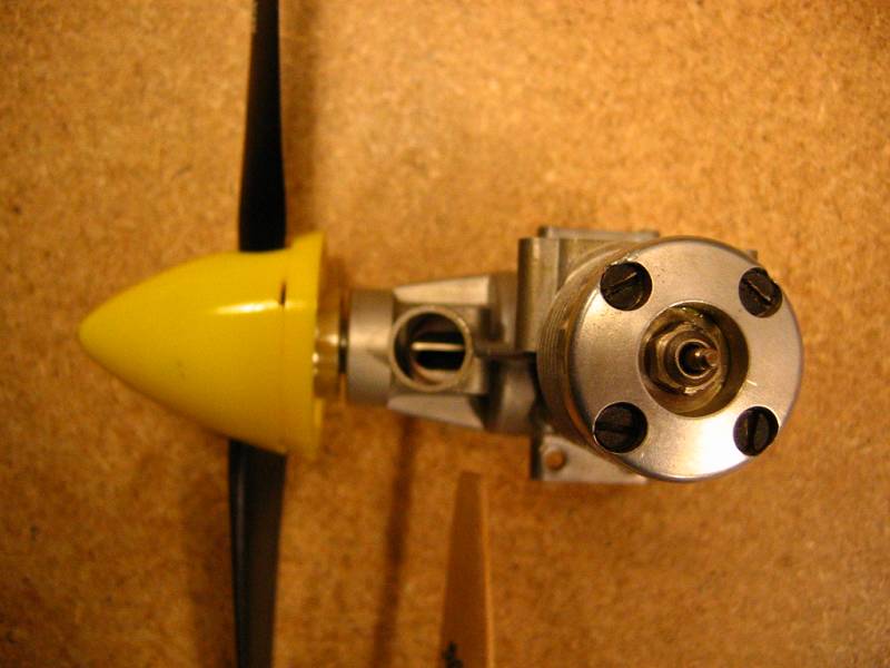

thanks for pointing out the issue with the G20's and pipes! I noticed that the 23 and the 15 have different sleeves and pistons. The 15 looks like a regular induction sleeve with a flat piston head while the 23 has a lapped piston and a much thinner sleeve. I have never run this particular 15 with a RC carb but a friend of mine back in the day had the same engine with the RC carb shown on the 23. I'm not clear on how sub-induction works so if you can explain that would be interesting.
Given the 15 and 23 don't seem to have the same guts, do you think the 15 might lend itself to pipe use while the 23 only to muffler use? If not, what mufflers would you recommend for these guys? I don't think the ST will be easy to come by...
Regarding the K&B, MECOA states a figure of 1.2 hp with a pipe and 30% nitro! Maybe a little overstated but I would hope that it could turn an 8x4 at decent rpm's with or without a pipe. Did yours just not run well? Wouldn't come up on rpm's? or maybe just not reliable?

My experience with the .18 has been with a Herr Extra and I was very disappointed with a 8/4 prop. It runs ok, just not very powerful. For $10 more, I could have bought an OS .15CVA. However, since you only paid $30 for yours, try it on a stand and see if yours has the power that you need.
Keep up the good work!
Frank
Please check out this:http://www.rcuniverse.com/forum/m_64...tm.htm#6451209.
I am not a expert in motor tuning so I could not explain the sub-induction porting problem. I remember reading about it when tuned pipes became popular. I do remember that the old flow-through mufflers were used for the .23's and folks had problems when "closed" mufflers became mandatory. Maybe some of our more learned friends here could explain this better than I ever could!
Frank

Hi All,
Back in the late 60s and very early 70s almost everything I had built was around my pair of Tigre 23s. Dynamite little engines, and they responded poorly to any kind of muffler.
Any back-pressure killed both the power and the friendly running characteristics.
Regards to all,
Dean P.
Regards to all,
Dean P.

Dean,
thanks for that info. I've always thoroughly enjoyed reading your column in FM!
ST's are engines from my childhood memories and thus I'm quite fond of them. Based on your comments, would you think that an open pipe (e.g., a Macs 1110 or 1120) might be a better muffling solution for the G20's? These engines used to come with open type mufflers but as you mention, they didn't do much for the engines performance.
David.
David.
