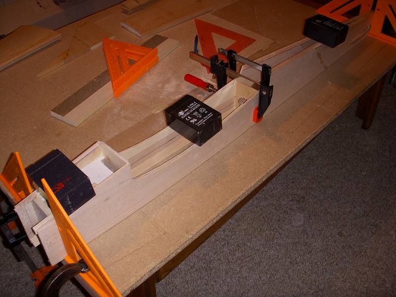

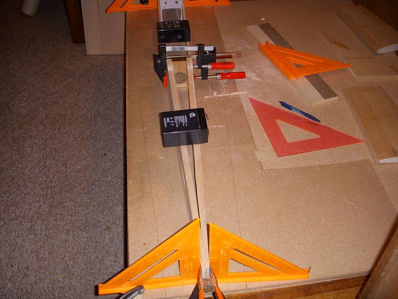

Thanks for the words of encouragement. I've only got six days of holiday left and my goal is to have the plane ready to cover/finish (I haven't decided how or what colors).
I have to decide what to do with the vertical fin soon, The one from the original kit is pretty rough. The parts are glued together but are not in perfect alignment and are very banged-up. I also think this design is very heavy. It would be neat to do a built-up fin made exactly like a wing, with ribs and a "D" box. It would be lighter, for sure, but probably take much more time than just starting with this 1/2 inch slab and carving/sanding away anything that doesn't look like a Deception fin.

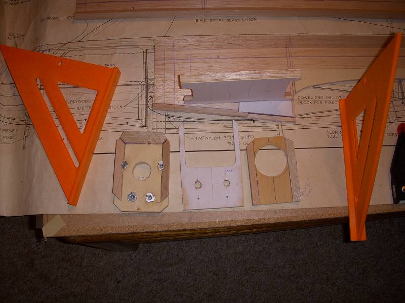

No picture yet, but the landing gear block and nose block are ready to be installed. I will coat the entire area under the tank tray with a thin layer of epoxy.
Mitch

Mitch,
I'm sure we're having very similar parallel thoughts on these builds.
I framed up my fin from 5/16" balsa (the 1/2" scaled thickness) the other day. Between fuse top, thick balsa sides and a fair amount of triangle stock, the fuse/fin assembly is one solid, and rather heavy, structure. Having stared at the plans of the 40" model for a while thinking about how to lighten it, I decided the easiest thing was to stick to the plans and drill out lightening holes wherever possible. Doing so on the fin creates a "framed-up" like structure without too much extra work or loss of strength. I figured two holes 1 - 2" in diameter (depending on scale) forward of the hinge line along with another smaller hole parallel to the first in the forward part of the fin. On the rudder, three smaller holes (2 moving and 1 fixed) should be doable after it has been shaped.
I weighed my fin/rudder to 0.7 oz (20g) without lightening holes. I think that can come down to 0.4-0.5 oz without a problem. I plan to use this approach throughout on fuse sides, fuse top, fuse bottom as well as ailerons (3 holes moving/1 fixed) and elevators (2 holes between the three hinges). I feel that this could bring the weight down of the overall frame by as much as 20%. Give or take we'd have:
[ul][*] 40" - 15 size model: 40 oz -> 32 oz[*] 63" - 60 size model: 136 oz -> 109 oz
[/ul]
Even if you are only able to remove 16 oz from the plane you might end up with a 7 - 8 lb model which would be excellent for a 2c 60 or 4c 90. I'm hoping to bring mine in at 40 oz or less (this will depend on engine and exhaust).
Of course having a fuse that appears to have been in the woods during bird hunting season does complicate things a bit if you intend to glass/paint but there are options. Apparently Sig Koverall is not bad as a base layer for paint. Never used it before but I'm curious to try it on the larger birds. I plan to paint only the required areas including the engine bay, canopy and wing bottom if necessary for a clean finish. The rest will be covered in film so the holes don't pose a problem.
