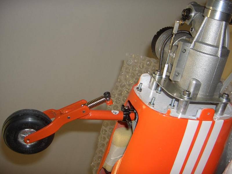

Delays, delays - have to be more patient until maiden flight.....
1) The nose gear wheel strut broke as I tried to tighten the hex screw which holds the spring. New has been ordered and installed, but is of much more poor quality as the old one (lot of tolerance...) May have to make my own one from billet aluminum bar. See pic for broken strut detail. Cast aluminum shows quite coarse grain....
2) More severe: The Rossi FIRE made a final test run in my garden, but sounded like a diesel direct injection engine - klak klak klak - way too much tolerance in the lower conrod bushing! At this time I ran first time synthetic oil in that engine, on the former test run with castor oil this didn´t become obvious. The sick Rossi is now at a good friend for receiving a new bronce bushing to the lower conrod eye....

Hello Speed-panzer,
Oeps, that landinggear does not look good.
I new it was not the best quality, but this is really bad.
I think i will start looking for a better option.
Sorry about your Rossi!

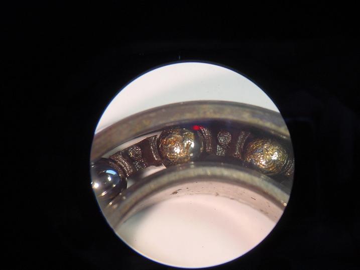

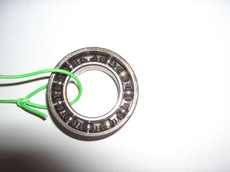

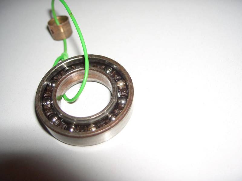

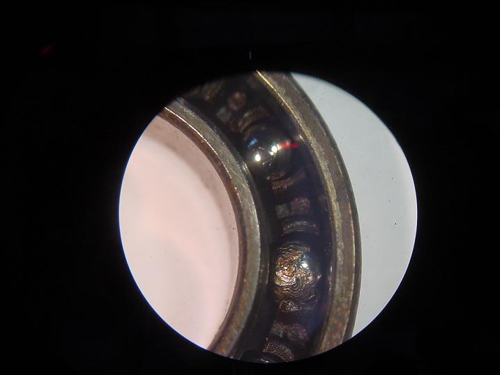

The Rossi has been repared, a new bushing was installed in the lower conrod eye.
BUT - there was a big surprise waiting upon disassembly of that Rossi - the main ball bearing was missing a ball !!!! and 3 of the remaining balls show severe spalling. Still can´t beleive one ball has completely dissappeared.
Has anybody else encoutered this? I have tried to do some photos of that ball bearing, I think you can see the spalling quite well. So much for engines which are offered "as new condition, unrun" on E**Y.
What will the reason be for blowing out a ball, and such severe damage to that bearing? Heavy knocking? Unbalanced prop? Besides of that, the Rossi looks very well, has a like new strong compression and does show only minimal signs of rust on the crankshaft.
Please share your experiences....
Good news about the broken nose landing gear, it has been replaced by a new one. We will see how Ã*t behaves in flight.

Nice home made rear engine mount. I like the idea. How effective is it?

It is simple, very leightweight and can be adjusted to the needs of every individual plane firewall, engine, nose gear etc. I am using the same kind on a OS .61 RF-P, the Al-Plate has just a hole in its center to make room for the pump. I have come down to 1,5mm thickness of the Al-plate, earlier I made it 3mm but that is just oversized for a .61-engine.

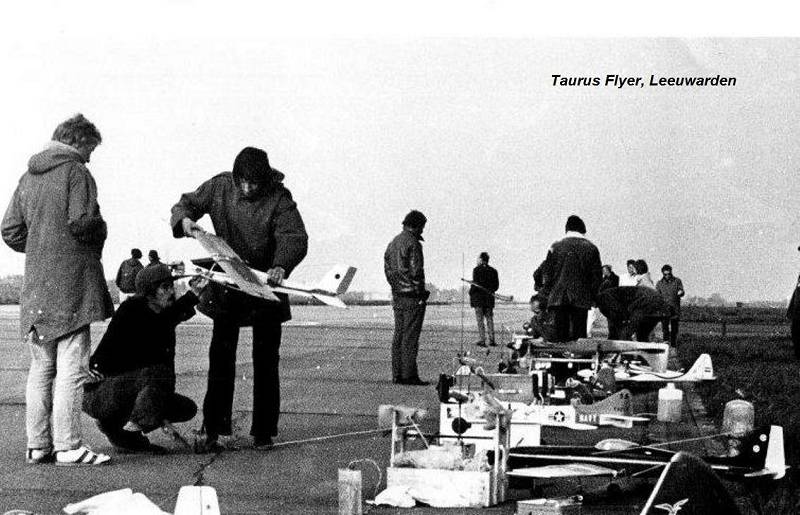

Speed Panzer,
Classic Pattern Flying, I am looking in my pictures
Dutch Classic Pattern Flying airport Leeuwarden.
Picture: I am preparing the Plane for a flight, in the centre of the picture
You can see several other planes. Date 1970?
So, recognize planes? Not mine, own design.
Picture 2 enlarged of the first picture
Picture 3 The USA was there, Leeuwarden Airforce Base!

That one here could be a Robbe Mäxi. Maybe the very first plane in the foreground on your 1st picture is also a Mäxi.
That plane was available as a fully wood built up construction (could be the one in the foreground) and it was available with GFRP fuse (could be the one I marked red)

Speed Panzer,
You are right Robbe Mäxi with your arrow.
What you say, "Maybe the very first plane in the foreground on your 1st picture is also a Mäxi." I think you are not correct, but we will hear soon I hope.
The "USA" plane is that a Cutlass? Crusader?
To be honest, I do not know all other models and forget the names, only never the "Taurus".
Why I know that Mäxi? Wait.
Here we are again, second picture of the Mäxi on my "nephew picture", right side.
That Mäxi was of a friend of my in the period we did fly Pattern. Construction "all wood".

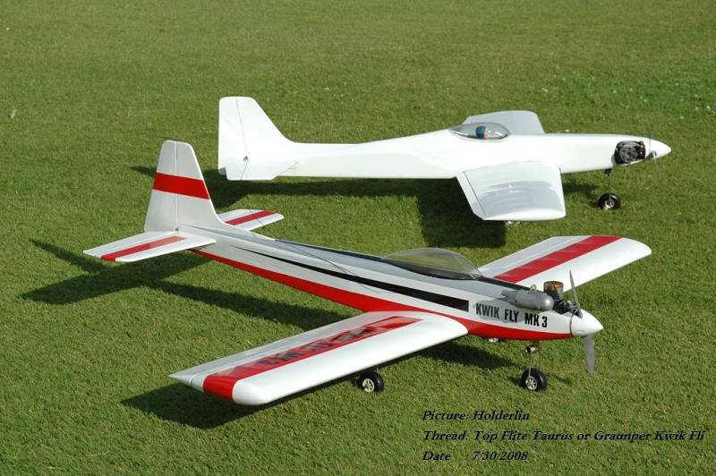

Speed Panzer,
I am always interested in Taurus so I did see somewhere in the past this picture look that thread name.
This is your thread, I did find it again for for you.
Search for the thread, that member is from Germany.
I also maybe have somewhere plans of that white plane.
Name the plane- such a nice game...!

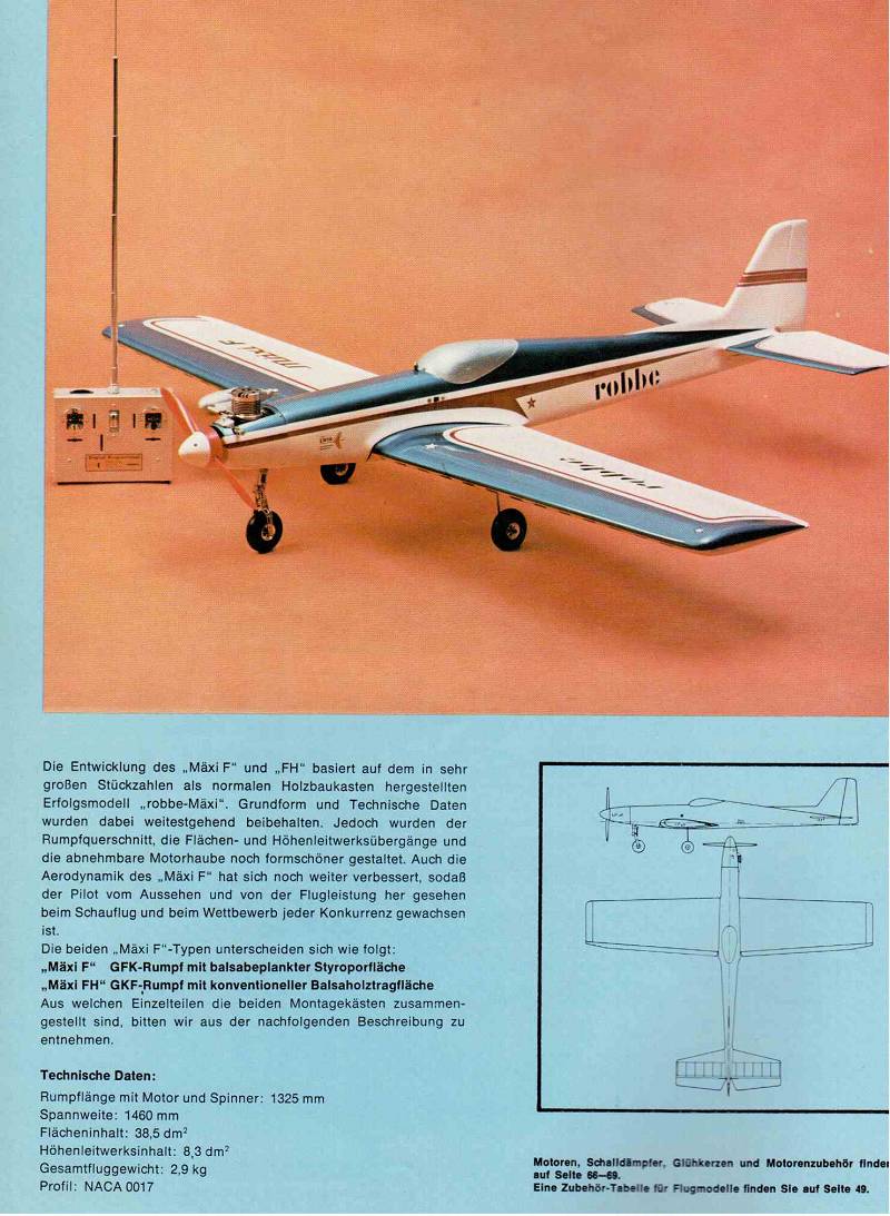

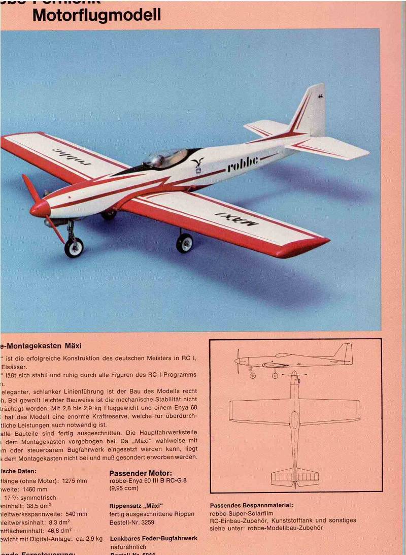

Hello Taurus Flyer,
found these pictures in the old 1974 Robbe catalogue.Still whish I would find a Mäxi kit....
Yes the plane in the foreground may have to high fuselage sidewall, it is no Mäxi. Did you page through the classic pattern plane pages? This is so huge amount of images meanwhile, it takes a little time...
