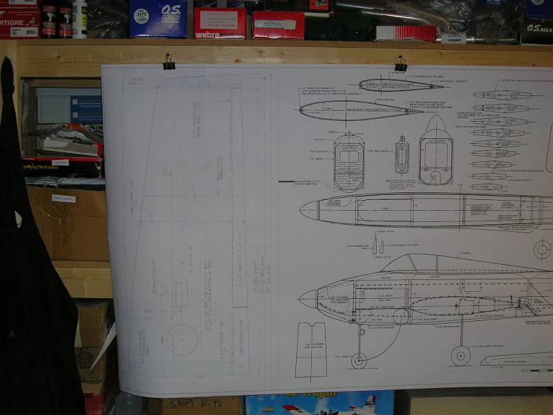

Hello Guys,

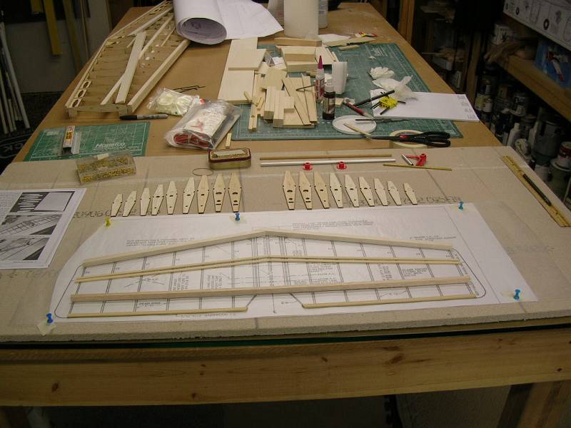

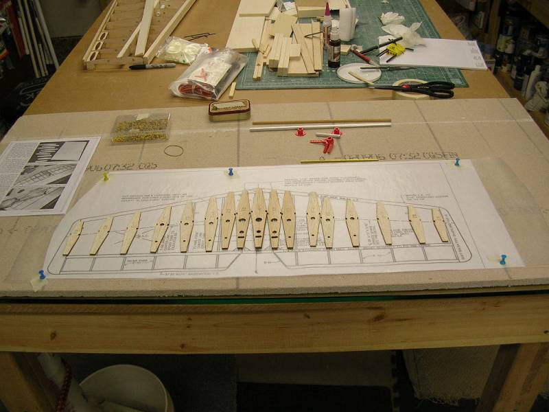

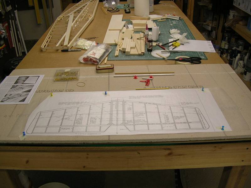

I cut the stab part mof the plan out and laid it out on the building board. You can see the ribs, flying fork, LE & TE and spars laid out on the plans. Tomorrow the Stab assembly will begin. Dan at Laser Technologies will be providing a copy of the original construction article with his sort kits. The Stab is the most complicated part of the build and the Stab must be completed prior to assembly of the Fuse. More to follow.
Leo

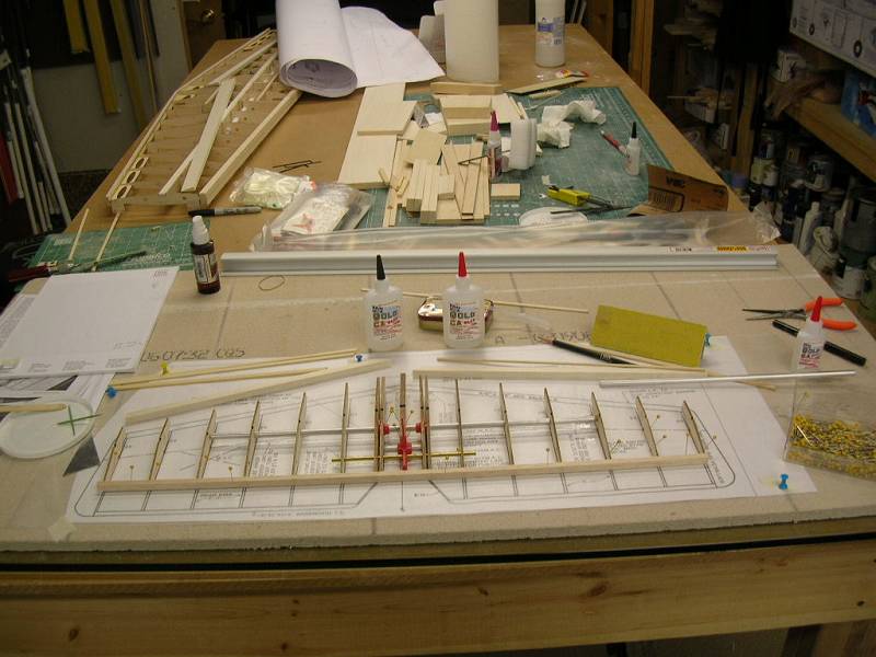

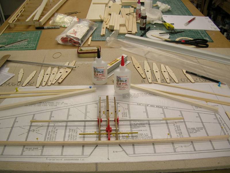

Old 04-19-2009 | 12:44 PM
Pattern One's Avatar
My Feedback: (73)
Joined: Dec 2004
Posts: 288
From: USA, Earth
Default RE: SEQUEL, Laser cut kit

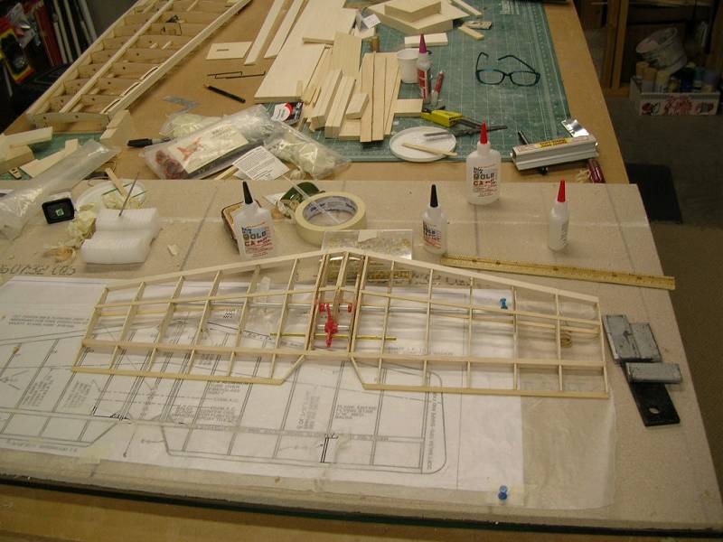

Hi Everyone,

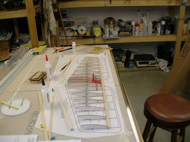

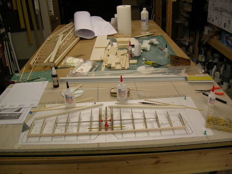

I started construction of the Stab today. You can see Ribs 1 & 2 in place with some of the Flying Fork System. Epoxy was added to the Lexan Bearings and to the short Aluminum tube that the fork rides on. After that more ribs were added. More Epoxy was added at the correct locations. After the Epoxy sets up it will be time for the two top Basswood spars and the Leading Edges. After that the bottom spars will be added along with a few fillers, sheeting and Stab tip blocks. More later today.
Dan's Laser Cutting is perfect. The Flying Fork Parts slid into position without issues.
Leo

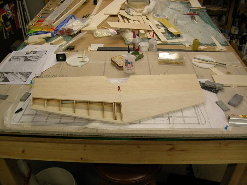

The Majority of the Stab has been completed. The top and bottom spars have been added, the leading edges have been glued on. The end ribs have been sanded flat to accept the stab tips when it's time. The LE & TE need to be sanded to rib shape. The rib ends and rib end trailing edge need to be added behind the TE that you see now prior to sheeting. More on that in the next post or two. I can't wait to get it sheeted and cut the center section loose so the Flying Stab moves! Dan at Laser Technologies has done a fantastic job on this.
Leo

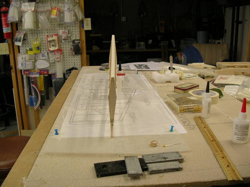

Hi Guys,
I taped off the ribs by the LE & TE so I could shape the LE & TE. I cut the fork off so that it will not come through the sheeting as far when it moves. This was done in the original. After that I added the sub ribs and final TE parts. The spars were cut prior to sheeting so after the assembly is sheeted the LE & TE can be cut to make Flying stab work. The next steps will be: Sheeting, stab tip blocks and final shaping. More to follow.

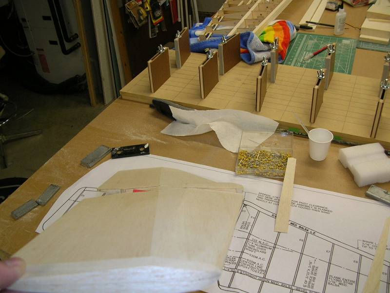

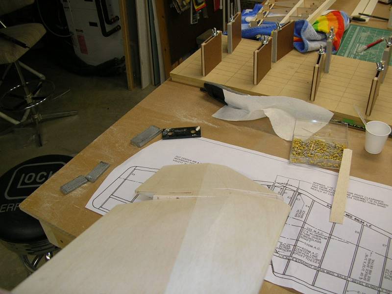

Old 04-26-2009 | 06:20 PM
My Feedback: (73)
Joined: Dec 2004
Posts: 288
From: USA, Earth
Guys,
I was able to get 1/2 of the stab sheeted. I like to make paper templates for the sheeting. It's easier for me that way. I also like to use a fine tip Pipette filled with thin CA to get things glued down without wasting the glue in tight areas. Here are some pictures of the progress.
Leo

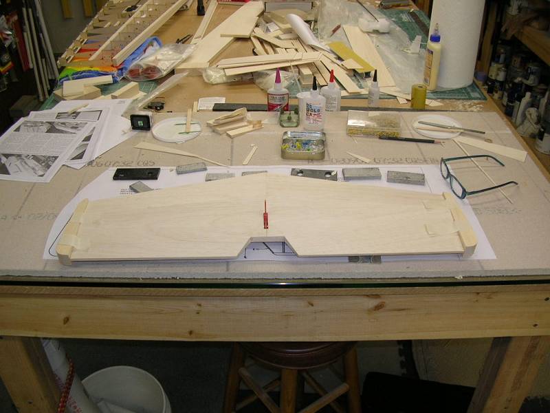

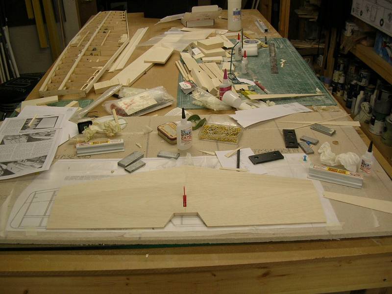

Old 05-02-2009 | 04:14 PM
My Feedback: (73)
Joined: Dec 2004
Posts: 288
From: USA, Earth
Hi Guys,
I finished sheeting the Stab today. The first picture shows some of the sheeting ready to go and follows from there. Next session will be the Stab tips, shaping the LE and tips. Then the final step, cutting the center section free. If all goes well I will have a flying stab at that point and can begin construction of the Fuselage.
Leo

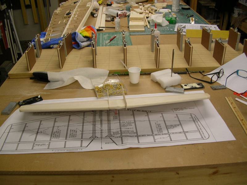

Hello Everyone,
The Stab Tips were made and glued in place. After the glue had set the Stab Tips were shaped. I gave the stab a quick sanding. You can see the diamond profile at the tip. At this point I need to put a 3/16" radius on the LE. Radius the Stab tips and cut the center section of the Stab free. You can see the fuselage jig I will be using in the background. Here is a link to the jig if you want to make one:
http://webpages.charter.net/rcfu/Con.../FJConstr.html
The fuselage jig is just like the one published in RCM Magazine way back when. It was simple to make and works well.
Leo

Hello Guys,
I shaped the Stab tips today. The Stab is now complete and I am ready to move on to Fuselage assembly.
Leo
