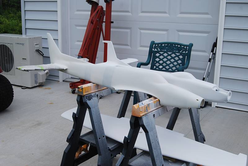

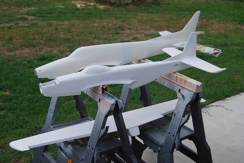

Update- First coat of primer applied - After cleaning up a full sprayer cup of mixed materialspilled on the shop floor!

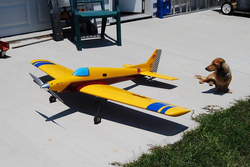

Update-
Phoenix V electric completed, to fly Saturday!.
AXI 4130-16, Castle 80 ESC, Zippy 6S 3700 mah battery, APC E16 X 10, and Winston admiring my work.

Beautifully done!
Nice and simple approach to cooling too. Looking forward to hearing reports on the maiden.

I flew the Electric P-5 for the first flight today. One of my two batteries had a dead cell so I only had one battery to fly with which also has a weak cell (It's making the return trip back too). As a result I only made two short trim flights. As I suspected it's nose heavy but not as much as I thought it would be. I'm moving the rudder servo to the tail to help. It needed some left aileron and a couple clicks of up (nose heavy) but otherwise flew very well. All up weight is 6.87 lbs with the Zippy 6S 3700 pack. It needs some rudder to aileron mix and I need more aileron throw as the roll rate was a little slow for my taste. Once I get new batteries delivered this coming week and the CG moved back I'll be able to better trim it with the needed mixes I hope. I think it's a keeper and right now I'm planning to fly it in the Asheville SPA contest on 7/18 & 19.

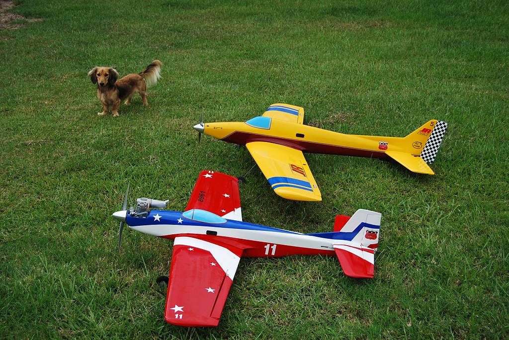

New birds all finished.
I did the Kirkland Mustang X in a Semi Miss America scheme. Haven't flown it yet but maybe this week end weather permitting. It has an OS .55AX for power. Phoenix 5 has electric power (AXI 4130-16, CC 80 ESC, 6S 3700 Rhino batteries) and flies very well.

Want to hear how that Mustang X flys. I'm seriously considering the same setup you have. Nice color scheme, but your cockpit looks a little small???

One short flight on the Mustang X today. CG seemed about right, needed a little down elevator and 2 clicks aileron trim. Seems to be a pretty nice flying plane. Elevator and aileron were both too sensative so they need dialing back a little. OS-55AX started up on the first flip and the idle mixture is pretty close - a little rich I think but I had the HS needle sloppy rich for the first runs. I ran one tank on the bench and then one flight. It was very windy and gusty making it difficult to determine what trimming it needs so I just put it away and I'll wait for a nicer day.
Cockpit is a little small but it was a canopy I had from some kit I didn't use and I didn't have to search for a source of something larger.
