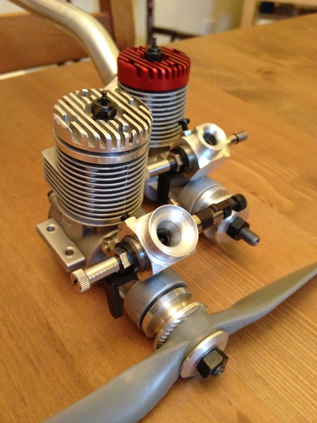

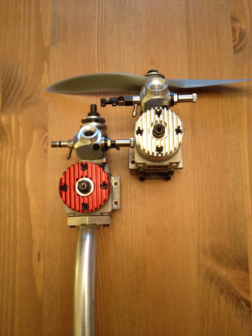

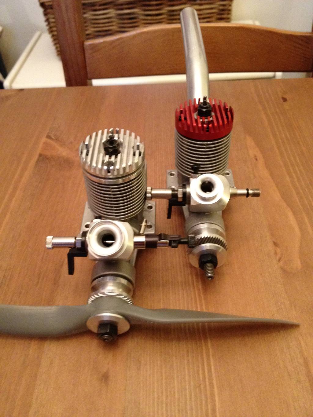

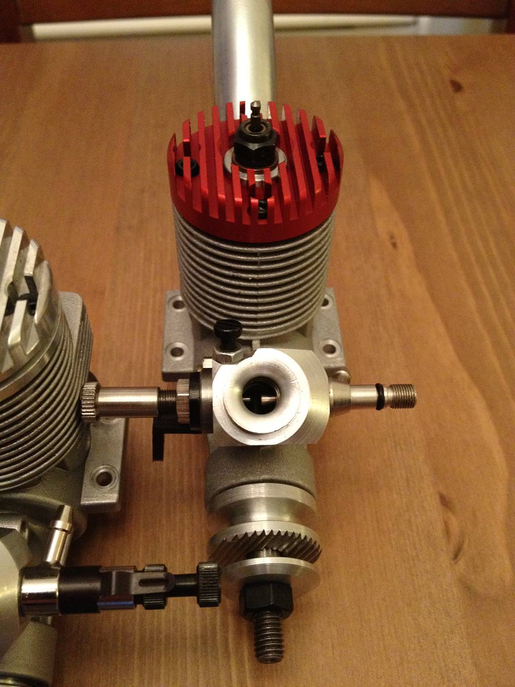

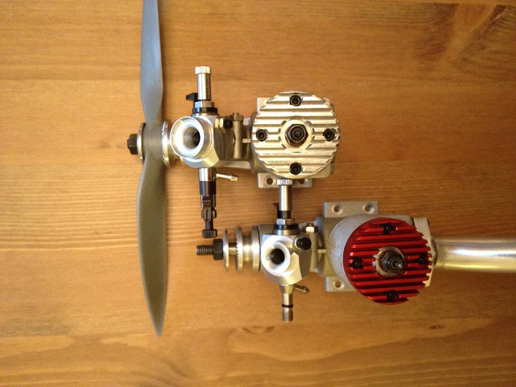

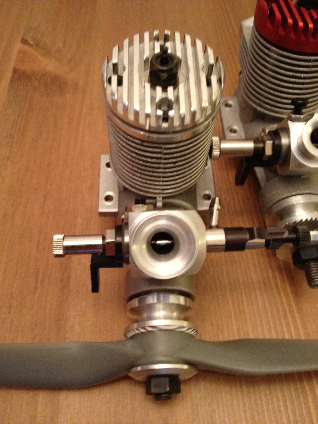

I've been a little slow in my follow up on this thread.
Thanks to all for your input on the engines available for the MK 20 size. Between Jeff's recent Skymaster 20 build and Jason's Curare 20 and Yoshioka Ursa Major 20 builds we have a few more 20 size classics to add to the books.
After a little research I have been able to source a pair of nice new MVVS 28's. While these engines are still in production and available from European sources (mvvs.nl and mvvs.cz) I opted to seek them out from individuals. The first of the two I picked up has a red head and was configured for CL and didn't come with an RC carb. The second I bought from a nice fellow in the Czech Republic (home of MVVS) and has a silver head and came with the standard current MVVS carb. The older RC carb on the red head I pulled from an MVVS 40 I have. All MVVS carbs used on 25's to 48's are the same in inner and outer bore so they fit any and all of these engines. The issue with the older carbs is they apparently have a poor transition caused by a very modal high speed needle. Replacement of the high needle with the new "sleeved" needle solves the problem and the engines apparently perform very well. Naturally, current production MVVS 28's bought from the distributors come with the proper new carb. It's worth noting that current engine head and thrust washer anodization is apparently blue as shown in the manufacturers picture I posted a few posts up.
The MVVS's are very nicely made. The 28's and 40's more so than the 60's but this also depends on manufacture date (the older engines were not quite as well made as the current engines). They are solid yet light and comparable to Webra 25-36's in weight. They are shorter in height than Webra's but a fair bit longer in the crank with the full thickness of the thrust washer over extending the Webra's. I have configured all the MVVS engines I have recently bought (a 40 and a 60 as well) into RE mode as that is what I find interesting about these engines. RE classic designs usually accommodate longer engines without too much trouble so I don't anticipate any issues in being able to use the 28's on the MK 20 classics where desired. They can be mounted inverted (e.g., Skymaster, Magic, Aurora) or upright (e.g., Arrow, Citation) and could even be used in a side mounted engine setup with a pipe down the side of the fuse. Naturally, the engines can be used in their factory SE configuration as well using either a Macs pipe setup, MVVS' own mousse type performance boost mufflers or simply an MVVS muffler. The SE configuration would be suitable for the Mattlas, Curare, Blue Angel and Cosmos. Personally I find the elegance and beauty in these engines when used in RE configuration with a longer concealed Macs pipe setup using a 9x5, 9x6 prop. Performance on a pipe should be in the 700W ball park - more than ample to expedite these little classics straight up.
While neither MK nor Yoshioka ever came out with a 20 size Arrow or Citation, respectively, I plan to design both of these with the MVVS RE 28 specifically in mind. Of the three easily obtainable "30 class" RE engines (MVVS 28, NovaRossi 28 and Jett 30), the MVVS is the least expensive and therefore, the most attractive IMO for these little classics. Naturally, nothing would preclude one from using either a NR 28 or a Jett 30 in these two designs with little, if any modification. I plan to design the models using 5/16" horizontal ply "bearer" engine mounts that integrate into the fuse design and build producing the required down/side thrust. Actually, to be frank, the models are already designed but for 40 class engines so the job is to scale the design down and simplify somewhat and "re-select" materials and wood thicknesses for a 20 size build. The two will be scaled to specs similar to the Skymaster and Magic which are not the very small Mattlas and Blue Angel but aren't the larger Cosmos or Aurora either. Because the Arrow and Citation have such different wing planforms, they will likely have quite different spans which track the 40 size version counterparts.
Production of my first MK CAD efforts in the form of a Super Chipmunk 120 will soon be underway so the 20 size classics should not be too far away after that. I may well start with the RE "non existent" Arrow and Citation which might help to inject a little excitement back into this project.
Below are a few snaps I took of the MVVS 28's. Interestingly, the fuse top Macs header you see on the red head is for an OS 25 VF. The difference in screw spacing between the OS and MVVS is ever so slight so it actually fits. That said, Macs has serial production MVVS RE and SE headers for the 28's, 40's and 60's. The 28 takes the "MVVS 20" 3370/71/72 series of RE headers. The Arrow will likely require a fuse top 3372 header (as shown on the red head) while the Citation will probably require a 0 degree 3370 header (straight back).
David
