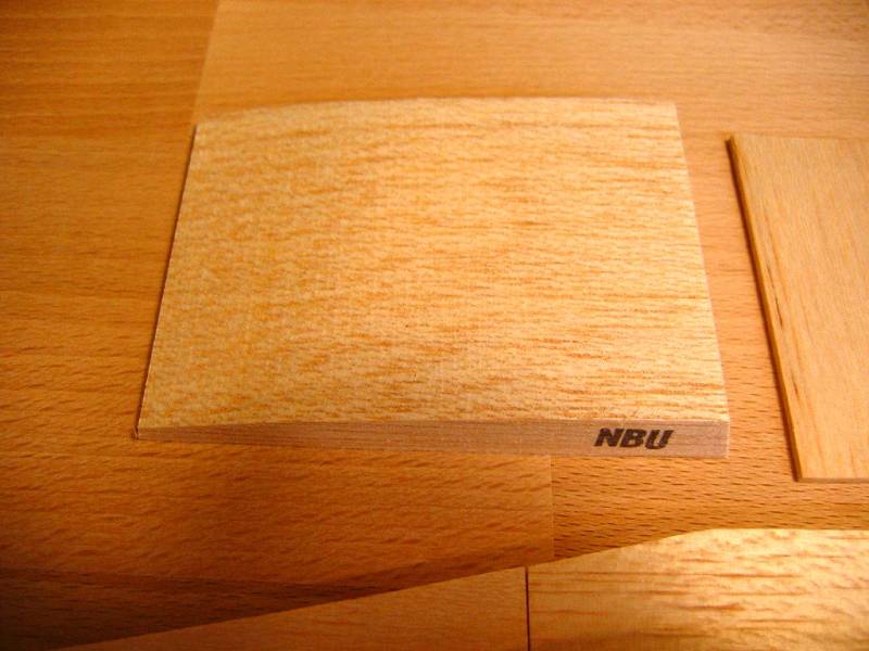

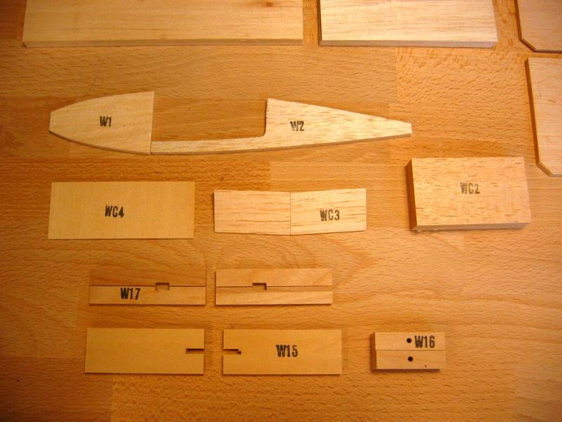

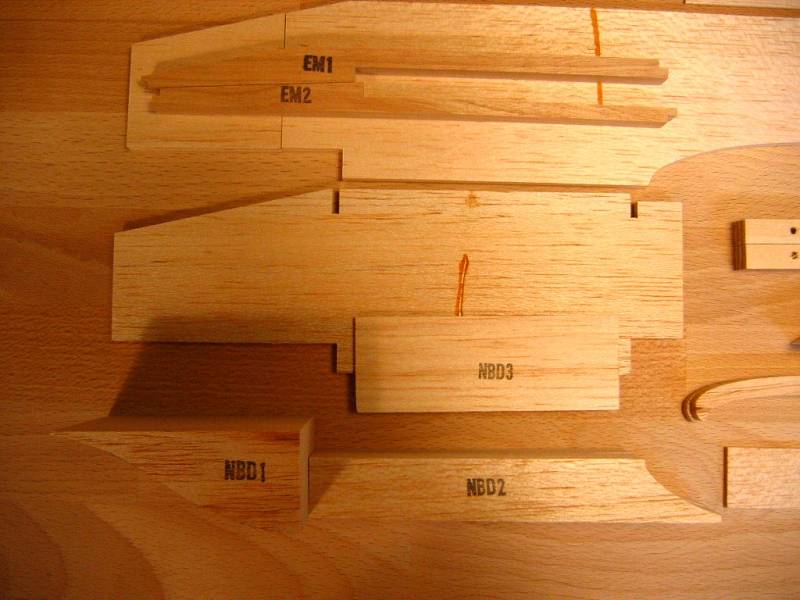

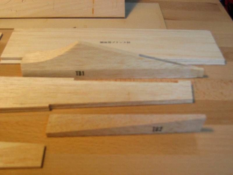

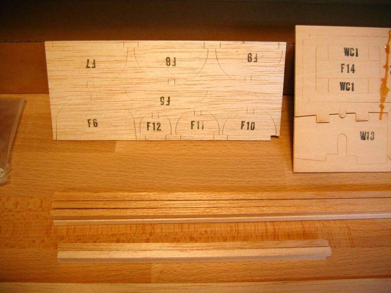

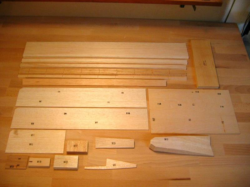

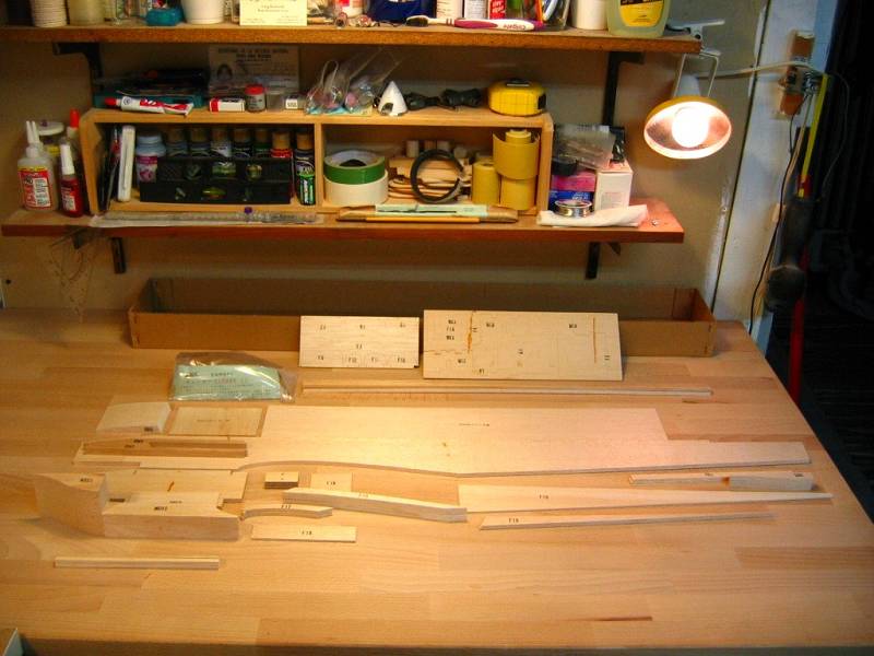

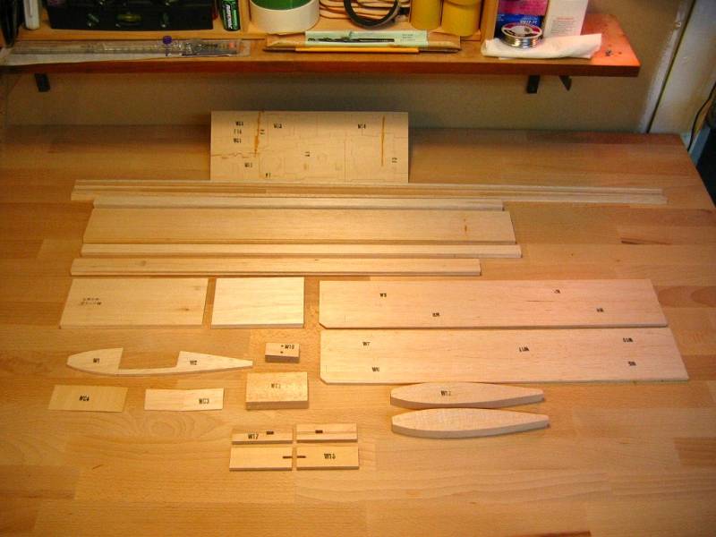

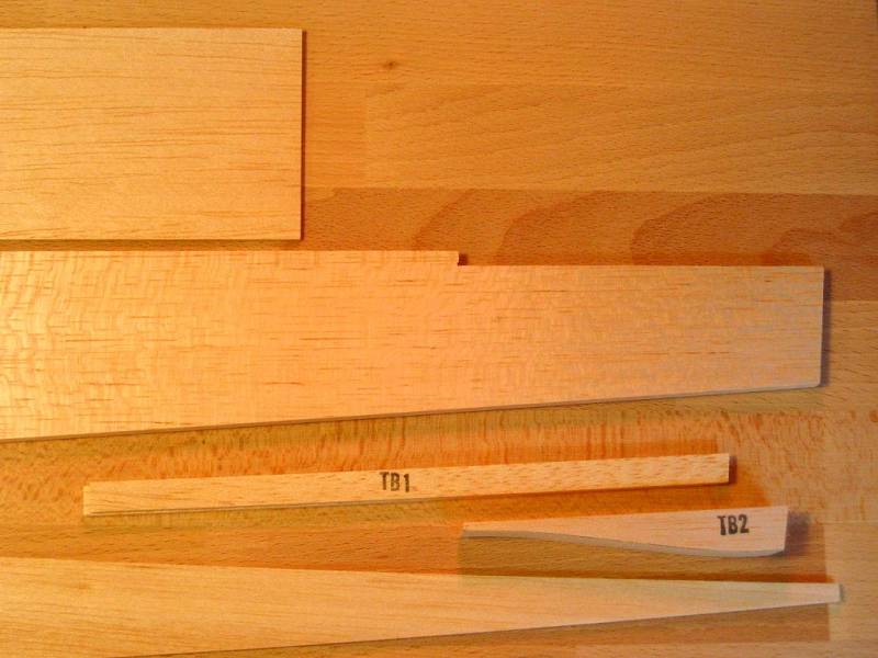

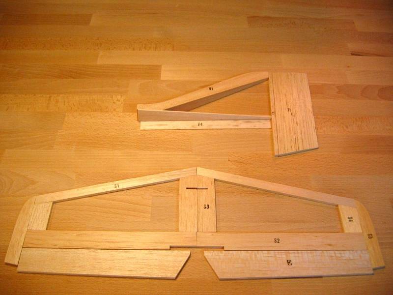

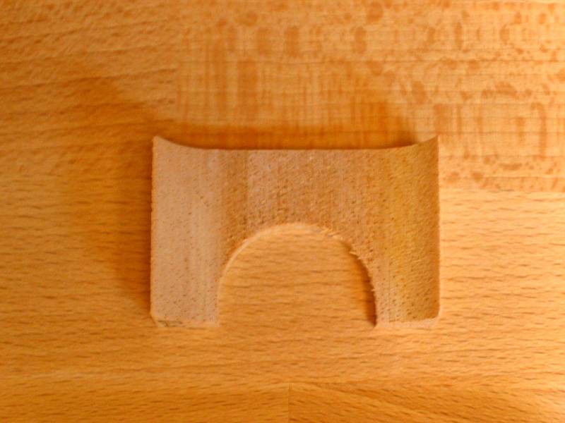

I did a preliminary inventory of materials and parts and took some photos while I was at it. Unfortunately, I have to report that the kit is missing one sole piece of balsa - R2 - the TE portion of the rudder. Fortunately this is an easy piece to trace from plans and measure up and reproduce. I'll have to report the news to Joe.
Here are some pictures of the wood contents in the following order:
[ul][*] Wing (first shot)[*] Empennage (second shot)[*] Fuse (various shots)
[/ul]
Wood quality, weight and attention to detail is surprising even with these lower cost kits (well,... once upon a time). In particular, what is nice to see are the preshaped CNC balsa blocks that considerably assist in the building of the model and reduce the amount of shaping and sanding required. The pieces are primarily used in the front nose/cowl area and the fuse/fin junction. These blocks will require the most attention in CAD in order to be reproduced.
David.

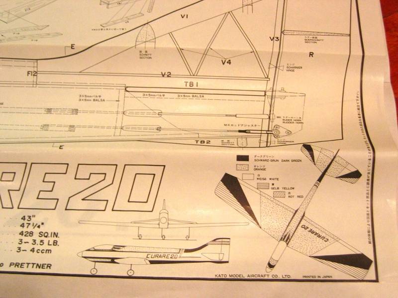

The Curare 20 was next. A true classic and perhaps the most recognized pattern plane of all time.
It is a smaller model well suited to the various .25 size engines available - with or without pipe. At 47+" span and 428 squares it would do well built to 48-50 oz. No provision for the pipe is designed into this model and so the side mounted engine would have the pipe tucked under the wing as many 60 size classics do (e.g., the Tiporare - it's American cousin).
I've yet to unpack the kit and do the inventory but I did manage to get some box and plan pictures.
David.

Here are the inventory shots for the Curare. Fewer parts than for the Cosmos as expected as it is also a simpler model to build - standard fuse box construction with a sheeted turtledeck supported by a longeron above semicircular balsa formers. The nose/cowl area is also simpler with two blocks - one above and one below and two blocks on each side of the nose gear bay fairing into the wing LE airfoil. This model should go together fairly quickly.
[ul][*] Wing (first 4 shots)[*] Empennage (5th shot)[*] Fuse (remaining shots)
[/ul]
Fewer pieces in this kit that require 3D CAD rendition - essentially two nose blocks, and two fin blocks (LE and subfin).
The laborious task of tracing will commence after matching the parts listings (inventory) to wood thicknesses and dimensions.
