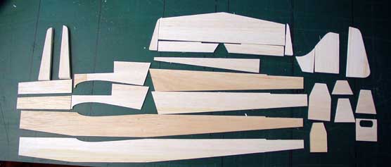

First attached pictureis of the kit ready to build.
Don @ Eureka Aircraft.com

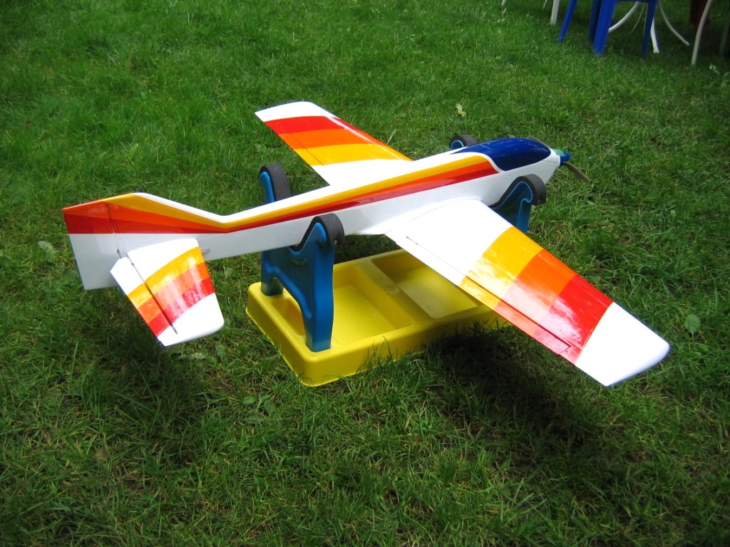

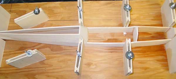

The fuse sitting in the fuse jig. Pretty funny fitting this in a fuse jig that holds 1/4 scale planes. But it deserves to be straight, too
One more plane that I forgot about is the Baby Banshee, designed by Jim Martin. I don't think it was ever relesaed anywhere, but Jim sent me a faded copy of theplans hedid of it, back whenhe found I bought the rights to the J&J stuff. Thanks, Jim

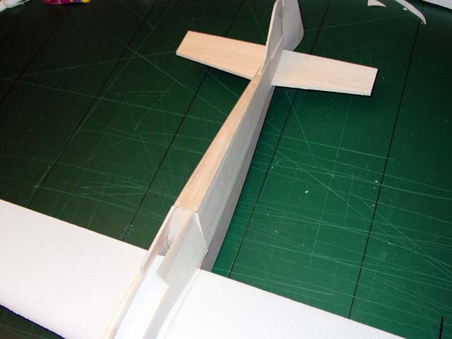

More pictures...

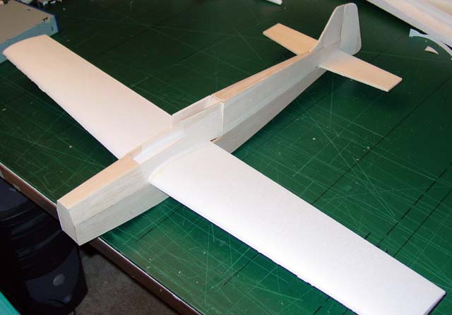

Fuse at current build state, and with wing, stab, rudder, cockpit section taped in place.
Starting to look like an Eyeball...

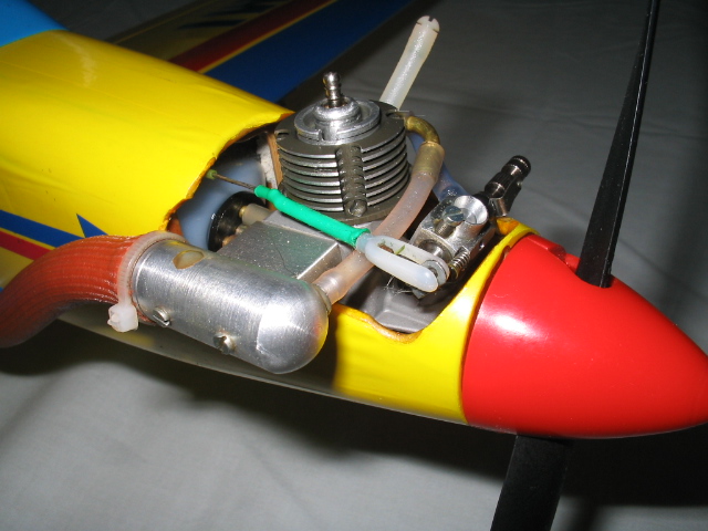

Don,

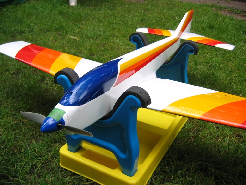

in the build of the little 10 sized Tipo (Picorare) I used an inexpensive (CD$43) outrunner from Dualsky. I propped it with an APC 8x6E which seems like it will do the model justice and pulls ~300W and about 35 oz of thrust (the model weighs 30 oz AUW). For an ESC I used a Castle 54 Amp ESC for about $40 but a cheaper one could have been used. 3s 2350 25C Lipo's were $18 if I remember correctly and I bought two of them. That makes for a ~$100 power setup including fuel which seems reasonable to me when compared to an OS 10 LA or, better yet, FSR.
Further details on the components used and how I installed things are in the build thread:
http://www.rcuniverse.com/forum/m_8858351/tm.htm
Hope that helps, David.

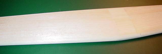

The wing is sheeted and ready for wing tips and ailerons. the 1/32" sheeting only added about .4 oz to the wing, so went for the strength. Plus the much lighter modern radio gear will still bring the plane under the original weight...

David,
Ifound fuse jig online a while back. Inever got around to puttingthe protective padding onthe clamps, but it does need it.
http://www.nwrcc.com/viewpage.php?page_id=20
I've used it on everything from a 1/3 scale cherokee fuse, to SPA pattern planes, and now a little Eyelash.

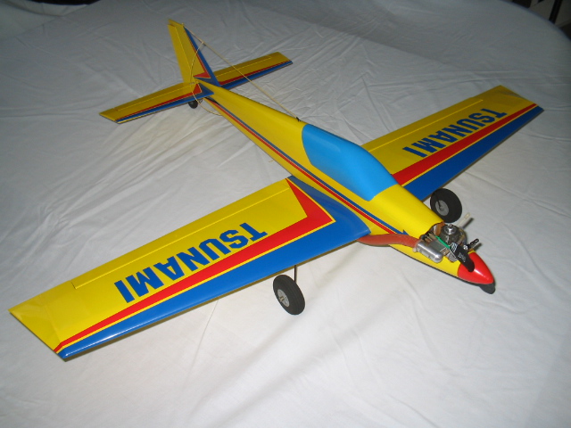

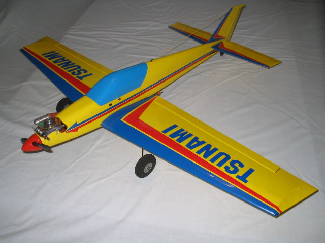

Don,
If you're familiar with the Tsunami, pictured is one I did at exact scale down to 40 inches at 25 ounces. It was intended for the Norvel .06 but came in heavier than intended. With a just broken in Norvel .074 on 25% fuel, it will do (sloppy) knife edge loops. It flys exactly like the .40 size but looks faster due to its smaller size.

just as a follow up to my PM on the Pico's electric power setup, the finished airframe (a combination of Monokote, Ekonokote and Ultracote) came out at 14 oz if I remember correctly (I'd have to check the build thread). Unfinished it was 12 oz with fully sheeted foam core wings and stabs. I was optimistic for a 26 oz AUW model but it ended up weighing 30 oz with the somewhat heavier 3s 25C 2350 mah lipo. The battery alone is ~7 oz and I could use a 3 oz lighter one at 15C 2100 mah which would lower the model to 27 oz AUW. Of course that would be ideal but without the heavier battery the model is tail heavy which is largely attributed to the sheeted foam stab and built up airfoiled fin and rudder. If the design was modified to stick construction empennage then one could even use 1350 mah lipo's for a very light model but in their absence, the model ended up weighing twice as much as the finished airframe.
I still don't know how well she'll fly but as AndyW points out, it will be fast and will likely not slow down that much for landing. In any case, that's ok as the plane was a bit of a proof of concept as well as a bit of eye candy in my shop (to me) and inspiration. As a result of the build I can think of several things that would help to bring the model in at it's ideal 26 oz AUW while at the same time balancing correctly. I don't think that the 40" airframe could weigh much less than 12 oz and still look like a Tiporare as well as of course being true to the plans in concept.
In any case, inspired by AndyW's little Tsunami a few months ago, I expect to built one just about the same size (many of the parts are already cut) as his (a tad larger) with retracts and the same motor that's in the Pico. I expect the model to be even lighter than the Pico by design even though it's a tad larger. I imagine it will also have a ~30 oz AUW but will have lower wing loading since the wing area is a fair bit larger. It will also be able to land on wheels rather than belly land as the Pico will.
