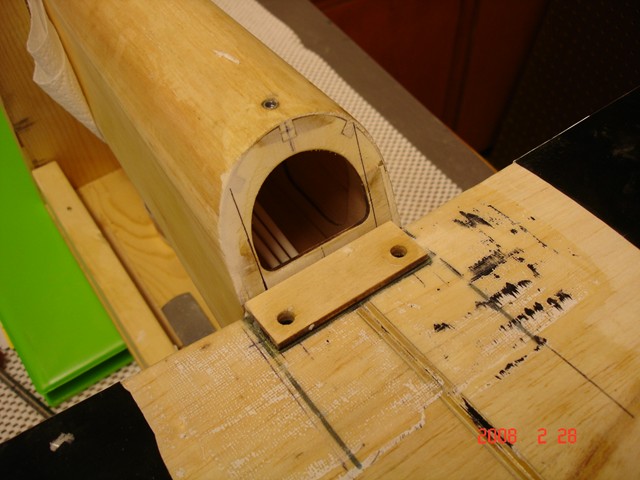

Bridi designs typically have a rectangular piece of 1/16" ply that is glued to the rear center section on the bottom of the wing (prior to covering but I glassed the center section first).
It does two things, one is to provide a hard surface so as not to crush the balsa when tightening the wing bolts, and the second is to bridge the slight gap between trailing edge of the wing and the fuselage although that gap seems larger than normal.

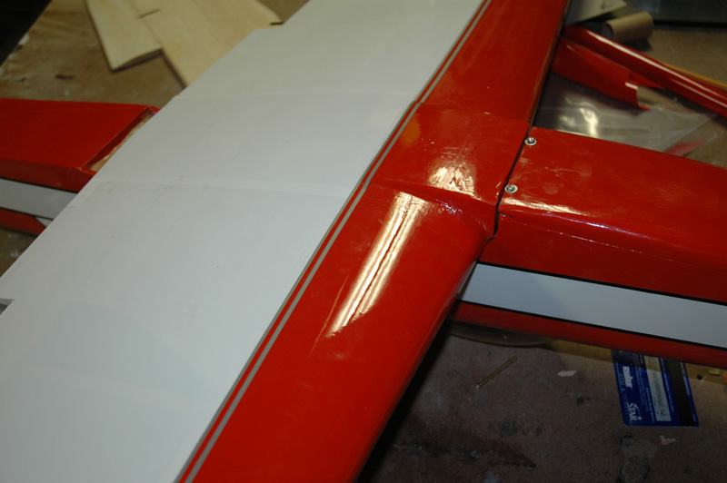

Rangerman - I take it you did not build this plane, right ? How did this happen ? If it fit's in the saddle, strip some of that covering off the wing and fuselage, set it up again. That wing looks to be glassed, it is enough to cover where the fuse set's. Providing everything fit's, this is an easy fix. After stripping, you can epoxy some hardwood back there, from the looks of things, fill the gap on the fuse side, then glass over it. Looks like no wing bolt's have been set up. Get the blocks in the fuselage, L&R, after you fix the area, drill in, tap 1/4-20, or epoxy in brass insert's. I would epoxy 1/8" plywood where the nylon bolt heads are going to sit, after all this, then re-cover. Something like the attached.

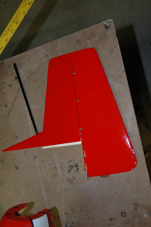

I did have to cover the tail surfaces...see photos. The bad thing is Missle Red does not look like it should when it's 20 years old and you have to use a new roll to finish![:@]

judging from the fit of the wing on the fuse saddle, I'd say that the two were never quite mated in the construction process. Aside from the gap at the rear of the saddle behind the wing TE - which is quite an easy fix, the front fuse chin on the wing seems like it wasn't sanded to match the fuse bottom contour. More importantly though, the wing top at the front doesn't seem to mate properly with the front wing saddle.
My observation is not really a criticism but rather just something you might want to address when you strip the covering as Crank suggests. You'll be able to re-mate the wing to the fuse so the bolts are not subject to undue pressure caused by air entering the fuse at the saddle junction. The pressure applied to the screws is also commensurate with the mating of the two parts and if they don't mate well, you'll have high pressure points along the junction.
I'd make sure that the two parts mate well before mounting the wing permanently (presumably with dowels in the front and screws in the rear) and recovering. The saddle TE will just need a piece of balsa/ply to cover the gap and a patch of covering.

The wing actually fits good, it's just set in the saddle without snugging it up. It's the gap in the back that puzzles me.
I'll fill it with solid balsa, strip the center part of the wing the with of the fuselage and about 3" long, mount either bass or plywood where the wing bolts go, glue a balsa block to the bottom of the wing, feather it into the wing bolt locations and the block in the back, drill and tap (or inserts, I have both) cover and be done with it.

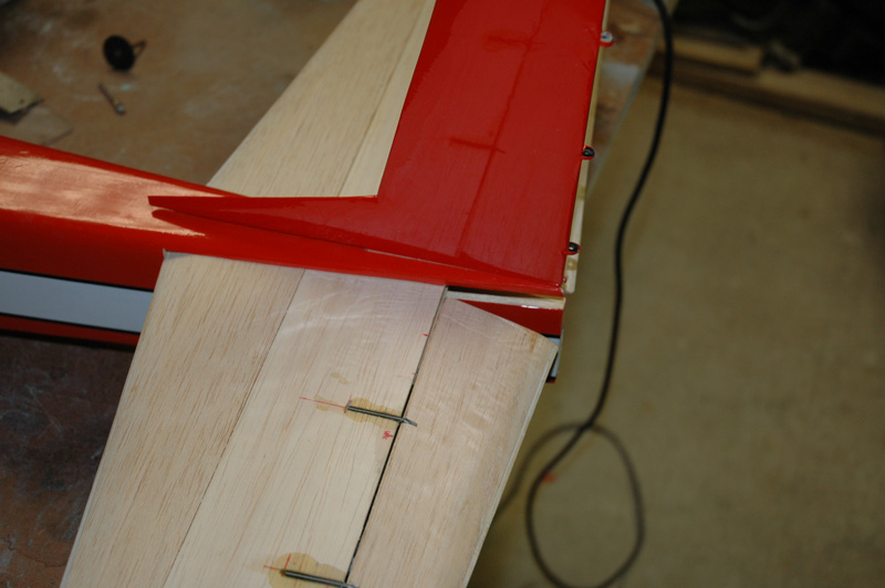

I just found out the wing mounting dowels are wonky. One of the is higher so I filled in that mounting hole and I'll adjust it.
I pulled of the covering from the block on the LE and found it was mounted wonky too so I'll have to sand it to fit the fuselage. I like the way this box is made so I'll do the same in the back.

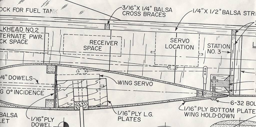

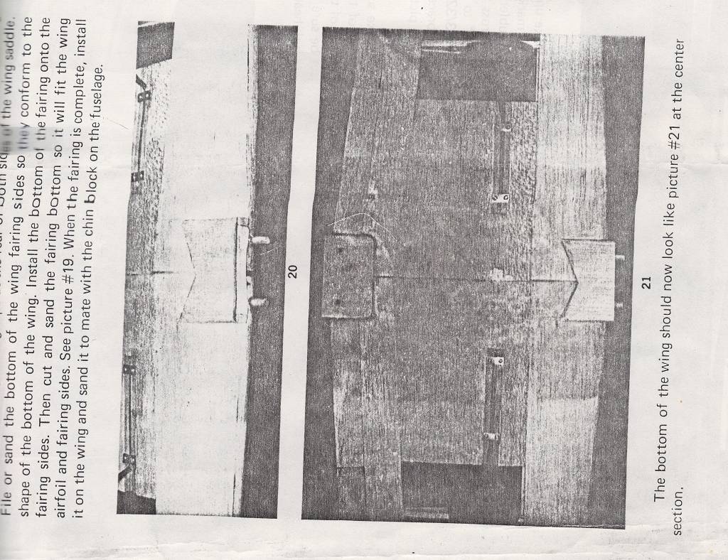

If you working with a SK-40, the gap looks to be okay per the plans and
construction photos (see attachments). SK-60 may have gap also but not
as much as the SK-40. No photo of SK-60 wing to really tell how much.

IF you have a slight gap in the wing sadde/wing join, but the wing and fuselage are both properly-aligned, don't sweat it. It's not a big deal. Just wrap a piece of plastic wrap or dropcloth around the wing where it will join the wing saddle. Then, apply a bead of clear silicone bathtub caulk around the wing saddle. Mount the wing and allow it all to cure. When the silicone is cured, remove the wing. The plasic wrap will easily peel from the silicone. Now you just use a very sharp single-edge razor blade to trim the silicone flush with the fuselage/wing fillet. You'll have a perfectly-fitting, nearly invisible joint.
If you fly with the gap, don't be at all concerned about "air pressure" getting inside the fuselage and causing problems with the wing bolts. That's just a non-starter. You won't get such a thing happening at all...whoever told you that didn't really know much about how things work. The only thing you need to worry about making sure the holes in the wing are properly-aligned with the holes in the hold-down plate. For best fit, you want zero gap between the wing and the hold-down plate. A gap there will allow the bolts to flex side-to-side, and could cause them to fatigue and weaken. When you have zero gap, the bolts will shear neatly if the wing is struck and tries to pivot...unless the bolts are much too big.
