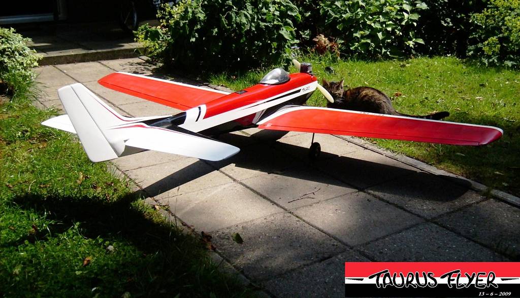

One important fact I also think about is weight, especially on silk and dope.
For that I look to the scheme.
First I spray paint a thin layer of white primer.
next , white surfaces with some "overlay?" in the surfaces black and red.
Next step is black for the wings and fuselage and than red. (or vv)
Last action is dashes and characters,
I do not use a clear coat.
Because the wing has a lot of red especially on the open structure I do not want to have two layers of paint on that.
When I would paint the red surface of the wing first, I will see the red through the white in the white surfaces later I think.
The less weight/paint on the silk and dope the less change for "crack" in the paint, important especially the stab exhaust side.
Also less total weigth and more easy to repair. For these reasons the paint is as thin as possible on the surfaces.
When an new Taurus I mount the aileraons and rudder elevator after painting.
On the picture you can see the whit paint on the D tub with some overlat on the open structure. The doors are mounted with some tape, only make this picture.
Cees

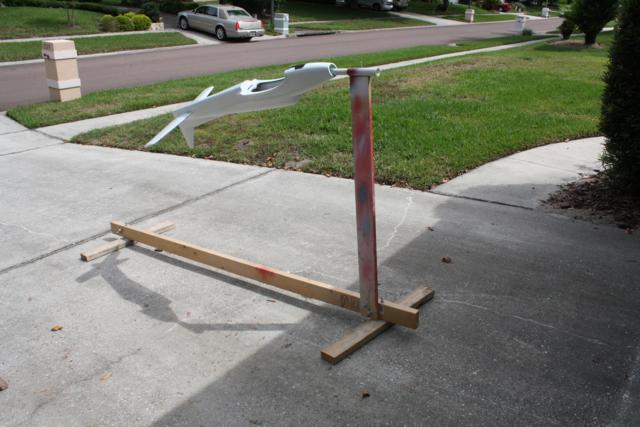

OK Guys here they are:
I decided to paint all surfaces first with a base coat of white. I will then lightly sand and look for any imperfections which hopefullly will be fixed. The plane has some white on it , so I will give it a final coat of white concenytrating on the areas where the whit will be.

Cees:
No, no, never. Light colors first.
The Phoenix V I am building is going to be painted using Dave brown's original colors, that is white and copper poly (similar to a bronze). The wings/stab have a checkerboard scheme and the fuse is coopper poly and white.
What I was saying I am painting base coat of white which is what you see in the pictures, sand lightly, check for imperfections, then, a final coat of white over the areas that are going to be white without worrying to mask. Then once paintecd, mask off for the copper poly color and paint.
Before the next coat of paint, I am planning to install the control surfaces then continue with the painting.
But always paint light colors first followed by darker colors.
I am using Martin-Senuor (spelling??) Acrylic Enamel auto paint for the White and PPG Copper Poly for the other color (Dave Brown used the exact same paint). I think Crankpin can chime in here for that.
