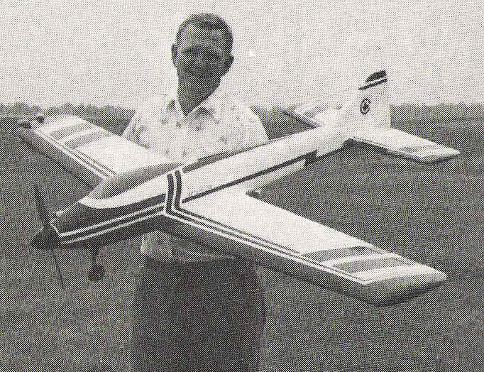

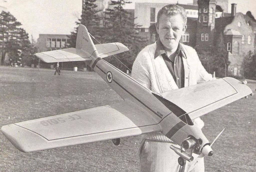

Saturn published MAN October 1975 (L)
Saturn SE published MAN October 1980 (R)
Ray

Hi,
The "Saturn" in MAN October 1975 I clearly remember I have read about  - if I remember correctly it was yellow with light blue and some red trim color. Nice plane also. I suppose the newer Saturn SE was enhanced and maybe flies even better.
/Bo
BEM - you're correct about the colors of the Saturn. I have the above picture in color.

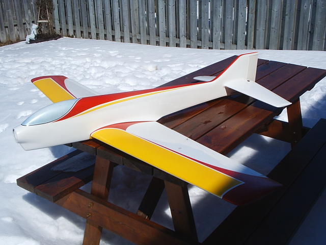

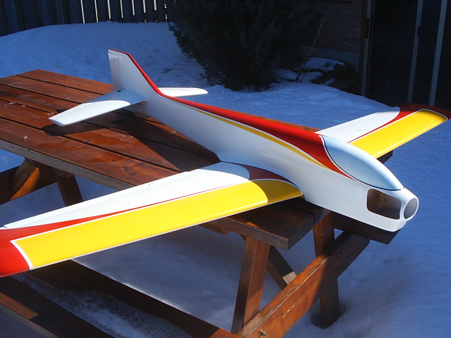

P.S. I've always been very impressed with your Tipo - beautiful finish. Happen to have any pictures of her all geared up?
Bo,
Main changes are -
Ailerons made shorter and wider
Wing made lighter by using cutouts (honeycombing as we would call it now)
Nose lengthened by 1/4"
Tailplane lowered 5/8"
Thrustline lowered 1/8"
Rudder shape changed and subfin added.
More powerful engine - Webra Speed & pipe.
Ray
