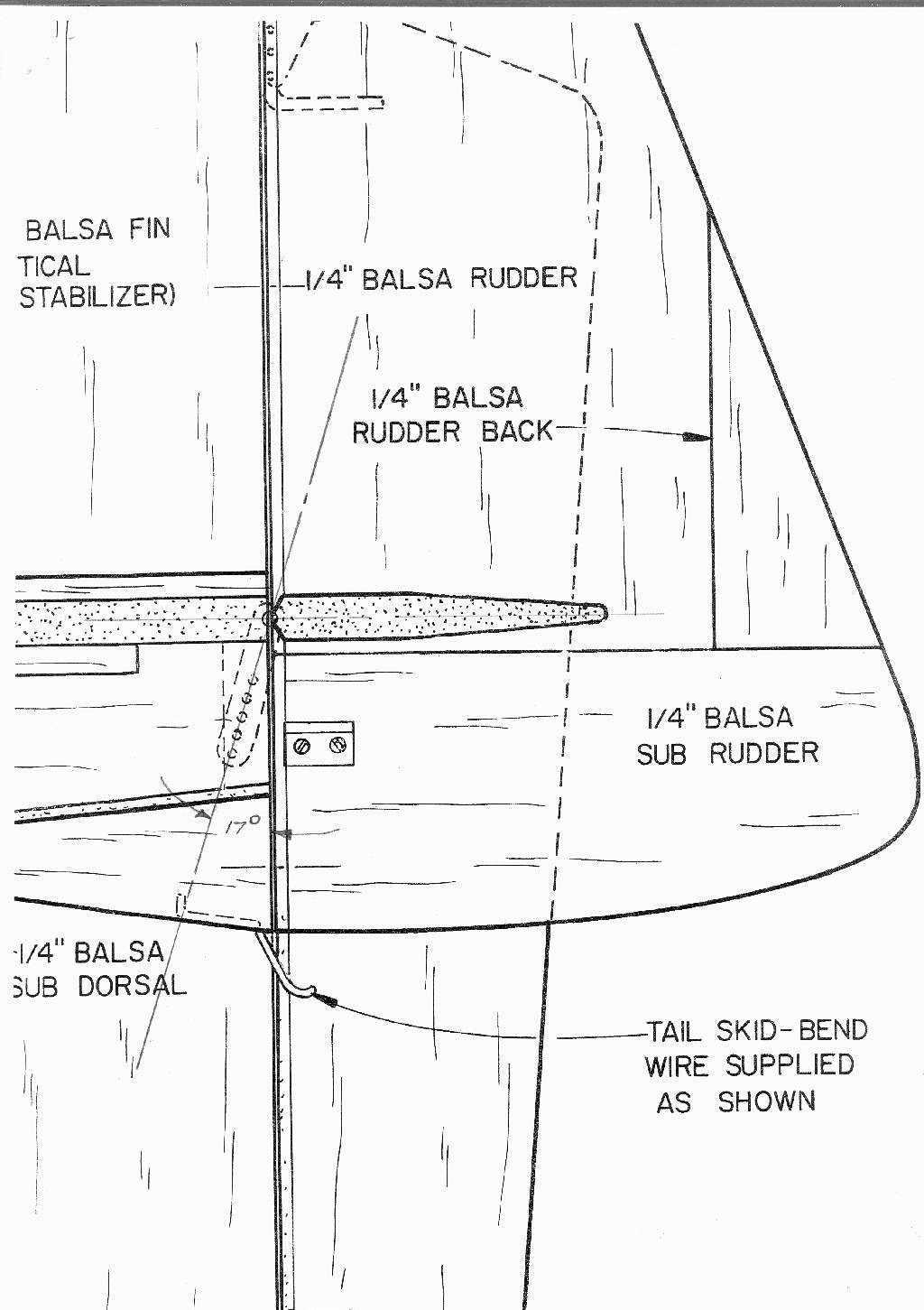

Hi Guys:
I’m building a KAOS 60 from an old Great Planes kit that I had stored away. (This is a revised version of the original KAOS 60 that was designed by Joe Bridi.) I have a question about the (metal) elevator horn supplied in the kit: Does anyone know why the horn has a forward offset? I measured the angle at approximately 17 degrees off the vertical. (See copy of the plans showing the elevator horn.)
From what I can tell, this will result in less down elevator movement, and more up. So the overall effect is elevator differential.
Does anyone know why the elevator was designed this way, and what effect it will have on the flight performance of the airplane?
I have built five KAOS kits over the years, and I’ve usually swapped out the offset elevator horn and replaced it with a conventional horn (with zero offset). I have never noticed any problems with this setup.
Any information on this will be very helpful. Thanks!

You will need the connection of horn to pushrod, directly over the hinge line. It could be the way the horn is mounted in the LE area of the elevator, the degree of offset will accomplish this. This is my opinion, but not necessarily right.
Did you draw that horn on the plan's ?
Crank
Crank
No, I didn't draw the horn on the plans; that is the way it was drawn on the orginal copy of the plans that came in the kit. All I did was draw lines over the horn to show the angle that the horn is rotated forward.

A slanted horn would be done to induce differential throw. I wouldnt change it. I'm not a Kaos expert, but I do remember my Super Kaos 40 (in 1977) having the same differential elevator throw. I'd trust the designer. It was a very well proven airplane.
Joined: Apr 2005
Posts: 1,136
From: Belfast, IRELAND
As Joe puts it in the UFO article - "to equalise the response of the aircraft to elevator inputs". This type of mechanical differential set up was quite common in reed days to equalise the diameter of inside and outside loops and as shown will give more down than up. A bit redundant now with proportional control and the ability to adjust everything using transmitter software.

Typically if any differential is needed, slightly more down than up is desirable for aerobatics.
Odd thing about the Kaos is the forward slanted horn on the bottom side of the elevator gives more up than down. A bit counter intuitive but still, its a proven formula on that model so I wouldnt change it.
Again, with computer radios its a bit of a moot point anyway, you can dial whatever differential you want in about 2 seconds. Gotta love technology!

Thanks... this explanation sounds logical, based on the fact that the KAOS design goes back to the early 1970s when radios were limited in the amount of features that could be programmed into them, (compared to modern day radios.) Even something as simple as dual rates and servo reversing was unheard of back in those days. We've come a long way since then. Thanks to all for your input. [8D]
I hesitate to disagree but I think the swept forward horn on the bottom will give, as it should, more down than up.

Trust me, Mike is correct. More up than down.
