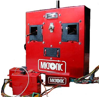

Other interesting information in that "National Identification - SE" sheet is that Christer Gillgren used a Swedish made radio control "Micronic". It was construced by civil engineer Gerhard Westerberg from Sweden but the radios wasmade in Japan (as ar as I know) and considered top of the line here in Sweden at the end of 1960th and beginning of 1970th.A picture of one Micronic 6 ch below. I know one club member in the RC club I was member in (at beginning to middle 1970th)had a Micronic 6 ch but not exactly the same gimbals as in picture below but the transmitter case was same anodized red aluminium. It had a very long antenna I remember (I flew with it a couple of times with a Graupner Cirrus sailplane that my friend let me control) and the linear servos was red and exactly same as EK-logictrol linear red servos (I know because I had a EK-logictrol myself and some if these servos). Well that was little RC history from this corner of the world.
