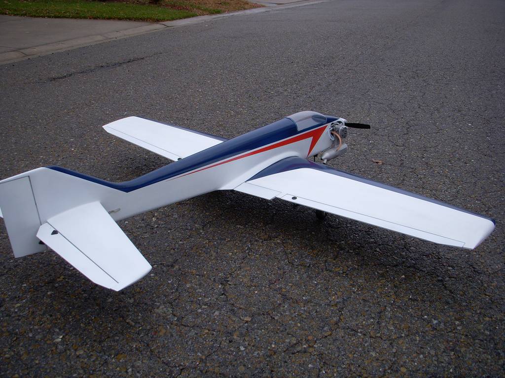

I got very frustrated with the paint job on this plane and put it down for quite a while. They are now paving our runway (Chapin Field in Wichita) and I want to christen it with a plane that can appreciate it.
So I just sucked it up and got it done even though the paint job still has issues.
I'll fix it later if she behaves.
Maiden will be tomorrow if the weather permits. The maiden will be at Afton. They aren't finished with the runway at Chapin yet.
I still have to adjust the nosewheel to get the proper angle on the ground. Any advice? Level?
I may ask this question in a new thread.

I think you might be too picky. The pictures look GREAT! (I know, up close they look different). Good luck with the flight. Mine has been sitting on the bench too for over a year. I got stuck on the wing fairings and then got distracted by the family....
Old 12-04-2011 | 06:03 AM
  #314
Joined: Feb 2006
Posts: 523
From: Rose HIll, KS
Default RE: Curare Build
Thanks Peter.
The main problem was that the paint didn't adhere well to the primer. When pulling off masking tape, little flecks of the paint would come off with it revealing the primer below. This only happened in three places, but it makes me worry that I'll have issues in service.
I also had issues with paint getting under the mask.
I know that these issues have pretty easy solutions, I just need to learn how to paint right the first time so I don't have to rework.
Still go for the maiden flight today. Lake Afton (nearest paved runway) is about forty miles from here so I'll make it worth my while and bring my Deception as well.
