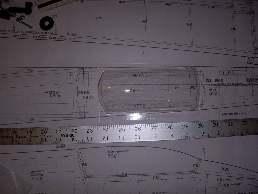

Sure, this is what it says on the invoice:
Curareo 6 X 2 1/2 X 2
Item# C 1117
Merchant
ParkFlyer Plastics
[email protected]
total invoice price with shipping was $6.64
Remember, this canopy is shorter (front to back) than the one shown on the plans. It will require a mod to the turtle deck. A purist may want to keep looking. I haven't decided if I'm that pure yet.
I will go with the flaps/spoilers, with the servos in the wing (outboard of the centerline).

Mitch, how short is the canopy?
I’m sorry about that since I recommended it.
On the MAN plans the curare canopy was made to be removable, with a back/ floor and front pieces. This canopy probably was around from then because I remember curare canopies for the MAN plans.
If the Eureka short kit is based more toward the MK plans then I think I know where you can get an exact copy for an MK kit. I personally would make it removable to have access.

This canopy is about 1 1/2 inches short. The Eureka kit is definitely based on the MK plan. Don't feel bad about it, it wasn't alot of money, and it can be made to work with little effort.

1 ½ inches short, looks more like for a 40 size version. I have three other sources for curare canopies, even for original MK curare kits. PM me if you’re interested. Keep up the good work

Well that would explain it. I took another look at Parkflyer Plastics site and this appears to be the only Curare canopy that they have. Now the search is back on.

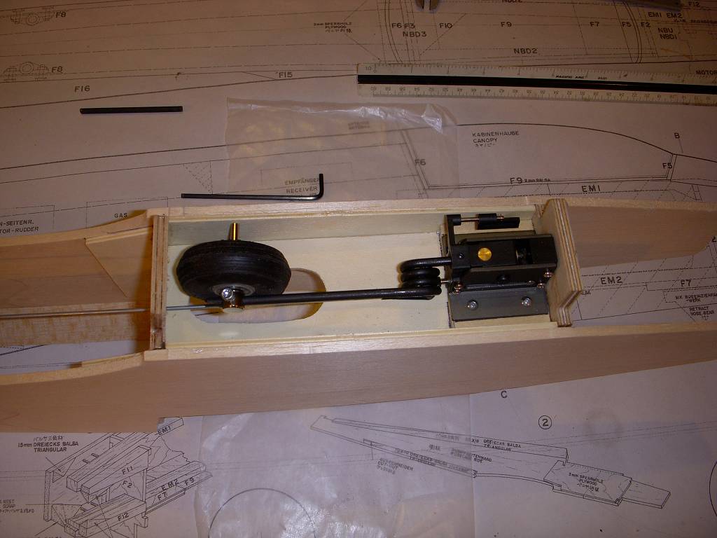

One obvious way to save weight with current techniques would be to make it a fixed gear taildragger. I did that on my Deception practice plane. I also used a four-stroke on the Deception. I want this aircraft to be closer to the original. I'm willing to accept a performance decrease for that.
If you really wanted to apply modern techniques, you could make a mold of the completed fuselage and create a carbon/kevlar version. I don't currently have the skills to do that. I would like to learn these techniques, but not at the risk of this Curare.

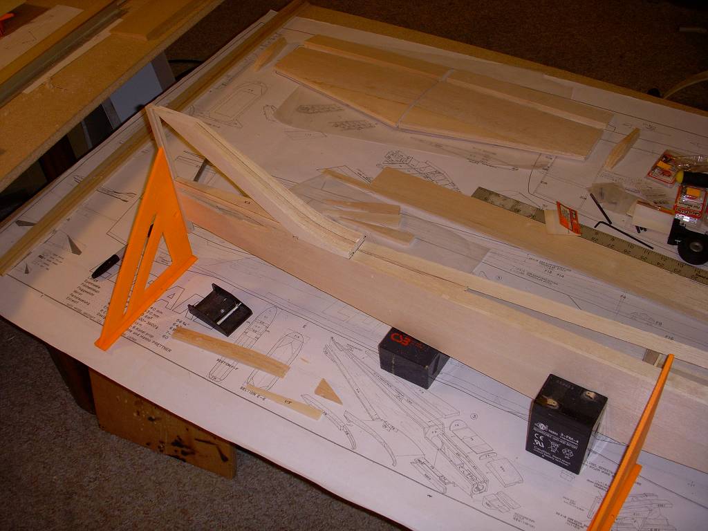

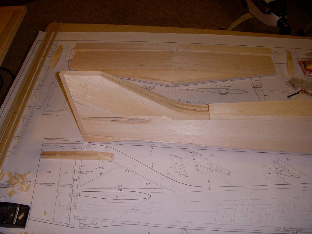

Tail is now roughed-in. I thought about building this off of the fuselage, as in 8178's blue angel build, but I felt that this way it was much easier to ensure that everything is aligned.
I know that this will make it much harder to install the pushrods, but I'll cross that bridge when I get to it. Worse case scenario is that I have to create a temporary hatch from the bottom for access.

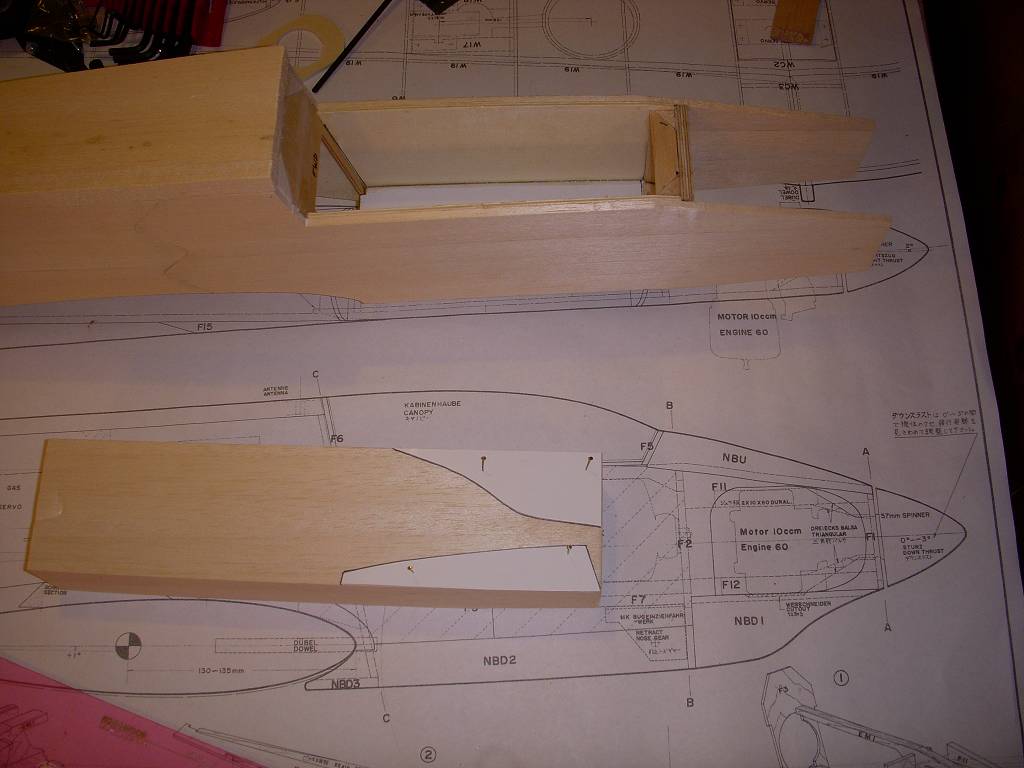

Oh, yes I see what you mean. This kit is set up to do that somewhat, as the wings of the original kit are to be planked with 2 mm balsa. The Eureka kit uses 1/16 inch sheet.
I avoid using epoxy unless necessary (for glassing or fuel proofing). However, I also avoid CA. I have a mild allergic reaction to CA that produces hives on my arms if I use it for prolonged periods. I'm worried that someday this may get much worse.
I'm using a product called Weldbond on most joints. It is applied by painting a thin layer on each surface and letting it air-dry for a few minutes. The parts stick together but are still positionable for a few more minutes. Pinning or clamping is preferred, but I've had good luck just sticking the parts together as well. When using it for a doubler, you have to clamp the parts together firmly (as can be seen in one of the photos above, the one with the car battery on the table). The Weldbond takes an hour to set, but I'm always able to find some other task to do during that time.
For skinning the wings and stab, I'm using Southern's Sourghum. I hope this is OK to use on a wing that will get fiberglassed and painted. I planned to research that before committing. I suppose I could save weight by doing a film covering on the wings and stab.
