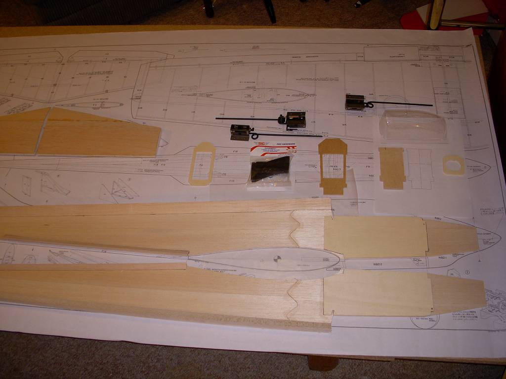

Hi David
Yep, she's on the board. Currently glueing in the fuse doublers.
Looking forward to staying motivated with your help.
I'm very happy with the quality of the Eureka kit.
Mitch

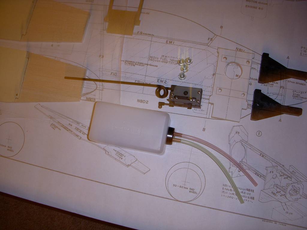

The nose on this bird is so narrow that it is causing me problems with using a standard fuel tank and engine mount. The firewall is about 2 inches wide. Here's what I have so far:
As for the engine, I am going to mount a brand new OS .61 FX. I will leave provisions to swap out the Rossi when I get it sorted out.
Also included in this shot is a closeup of the nose gear (not in the correct position, I know).
Mitch

Wow... that is pretty narrow! Then again, I remember identical concerns in my Tipo planning and builds which are essentially not much different from the Curare nose.
But actually it looks pretty good. It appears that your tank (it must be a 12 ouncer which is actually what the MK plans call for - 360cc) will leave the rear portion of the tank area open so you'll be able to tuck the wheel in there behind the tank. The nose gear always looks short but if you measure the farthest distance to the LE of the wing you should have the length shown on the plans when the gear is extended. That's all you should need.
I see that you have a prop mounted on your FX and there seems to be ample clearance. Is that an 11" or 12" prop?
I also assume that the tank fits through F3 which is where it will have to be slid into position through unless the opening between gear opening side blocks is wide enough to pass the tank. I'd try to insure you can slide it though F3 so that you can fix the tank floor into position. You might need (want) to make a U shaped cutout in the rear center portion of the tank floor to provide clearance for the wheel as well as to facilitate the linkage back to the servo which might best be mounted directly behind F3. The only problem with servos directly behind F3 is making sure that you can still remove the tank without the servo interfering and thus require to be removed as well.
I remember going through the acrobatics of getting the tank/gear/servos/linkage sorted out in the little Deception [&:]. At that size it was even more fun!
In any case, that looks like a good tank for the application. Is it possible to mount it sideways to leave even more space between the tank floor and the fuse bottom? It would have to be ~2" wide or so if I understand correctly.
David.

The other reason the fuses need to be narrow at the FW is so that it will allow a header (muffler? ) to be attached to the exhaust of the engine. On a Curare you will likely need a big drop in the header to bring the pipe down parallel to the fuse under the wing. Luckily, they are probably the most common headers at Mac's. [8D]
David.
Old 12-03-2009 | 10:06 PM
Joined: Feb 2006
Posts: 523
From: Rose HIll, KS
Default RE: Curare Build
David,
The prop is a 12 inch Master Airscrew that I happened to have handy which is the largest dia. that I plan to run. I'll most likely run with an APC though.
The tank was chosen because it fits through the hole in F3 (with a little persuasion). I didn't want to get creative and come in from the top or bottom. The tank is taller than it is wide, and so it can't be mounted sideways.
I like the idea of notching the tank floor to allow the nosewheel to clear. Thanks! I'm not so wild about the idea of notching the wing leading edge. I'd rather just run with marginal ground clearance. I've already resigned myself to flying this one off of asphalt only.
For clarification, the distance between the insides of the fuselage sides at the firewall is 2 inches (if that makes more sense). The tank's cross section is rectangular and the narrow dimension is just under 2 inches, so it barely fits as shown.
Mitch

Old 12-04-2009 | 02:46 PM
Joined: Mar 2007
Posts: 37
From: seven mile beach, AUSTRALIA
Hello, I noticed the canopy in your pics,can you confirm that the Eueka short kit comes with a canopy please?
