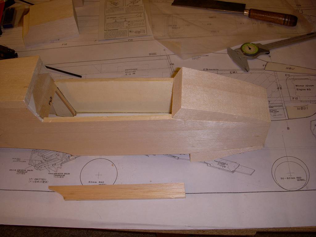

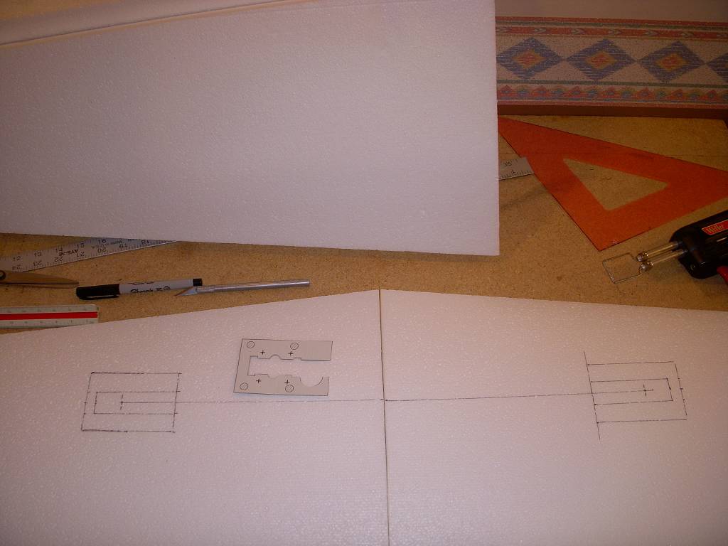

Nose blocks are glued and roughed-in, center block is hollowed out rough. Beginning the landing gear installation in the wing with a layout of the mounting pads location.

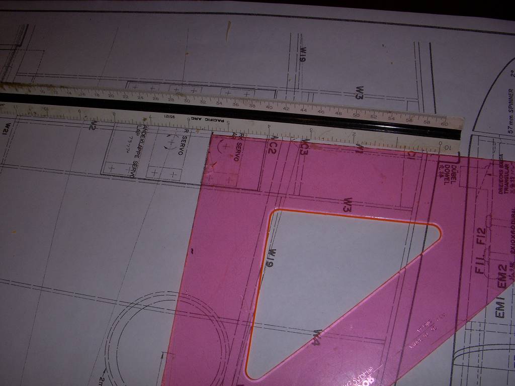

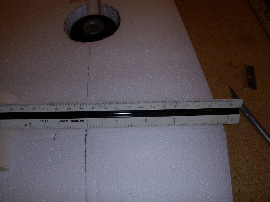

Your build is still looking good. What is the distance from the center line of the mains to the leading edge of the wing, at the root?
Old 12-19-2009 | 10:24 AM
  #105
Joined: Feb 2006
Posts: 523
From: Rose HIll, KS
Default RE: Curare Build
Thanks Ron,
5.1 inches from the landing gear centerline to the edge of the foam.
5.4 inches to the leading edge of the wing per the plans.

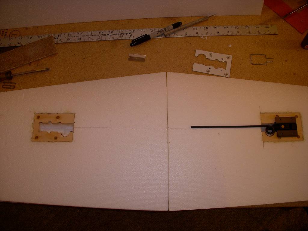

Old 12-19-2009 | 02:54 PM
  #106
Joined: Feb 2006
Posts: 523
From: Rose HIll, KS
Gear blocks installed.

Mitch,
Ron's question is the same that I was going to ask. Looking at your photo with the line templates, it appears that the blocks are almost in a tail dragger position! However, 5+" for the gear line sounds right - same distance as on a Tipo wing. Maybe it's just optical. In the second photo showing the blocks installed, they appear to be further back just because of the angle of the photo.
Usually, the CG just hovers in front of the gear axles (~4.9") - make sense?
Oh, I just realized that Don's cores are cut with ailerons included - that's why the gear looks so far forward.
David.

Double-checking the gear placement:
On the side view, the CG is shown .1 inches forward of the ldg gear axles.

The camera angle and the surface curvature makes it look funny, but the projected distance (looking straight down) is 5.1 inches.

Old 12-20-2009 | 01:18 PM
  #118

Mitch,
I measured the MK plans digitally as I was a little puzzled by that gear location. I measured 5.35" at the root from the front of the LE to the gear axles which lines up just a little forward of the rear side of the gear servo.
I think your first photo with the pink angle ruler shows this measurement, just shy of 5.5". The CG is stated as 130-135 mm (min) = 5.12-5.31".
If the gear axles are located at 5.1" from the LE, they would actually be in front of the foremost CG position! The plane will rest on it's tail unless you make it quite nose heavy. The CG might end up being too far forward for good flight.
I'm sorry about this bad news.
David.
Edit: Ahhh! Never mind, I was measuring to the real LE of the wing, not that of the core. Apologies - all's good, whew!

David,
The 5.1 inch measurement is to the edge of the foam. The wing leading edge is an additional .3 inches thick. So the current location is 5.4 inches from the leading edge.
That puts the CG roughly .1 inch ahead of the axles as stated (at the rearmost cg location of 5.31).
Mitch
oops, fired this before reading the note at the bottom of your post, never mind as well![8D]

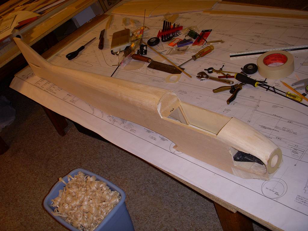

I got tired of the wing and decided to make a mess with the fuselage. I'll clean up tomorrow.
Shape is not nearly complete, I'm sneaking up on it!

  #124
bem
Joined: Feb 2009
Posts: 1,688
From: SWEDEN
Hi,
I love pictures when people is slicing or has sliced balsa... I remember when I built my Curare many years ago it was balsa all over the place. I think I had a big rubbish sack filled with balsa before I was finished with fuselage, wing and stab. But I really likeslicing and sandingbalsa. Just wonder if we are the last generation doing this? (with all ARF's these days...)
/Bo

  #125
AllTheGoodNamesAreTaken's Avatar
My Feedback: (180)
Joined: Aug 2002
Posts: 1,578
From: Somewhere In, NC
Looks real nice. I love the trash can full of wood shavings! [sm=spinnyeyes.gif]
