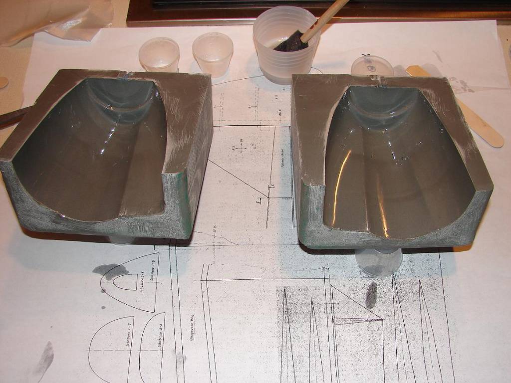

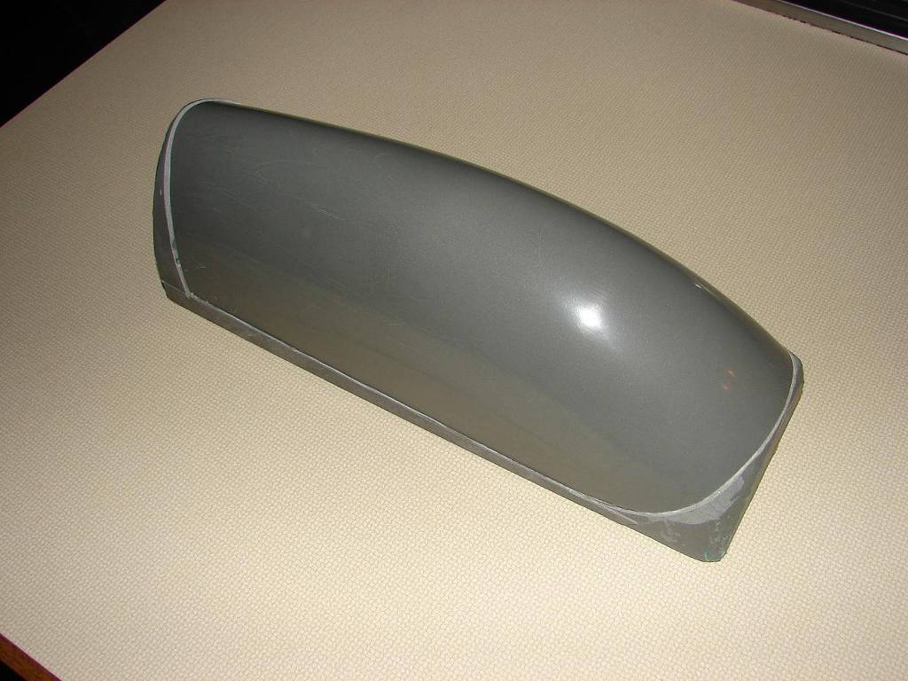

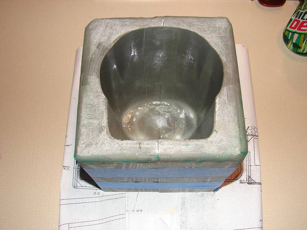

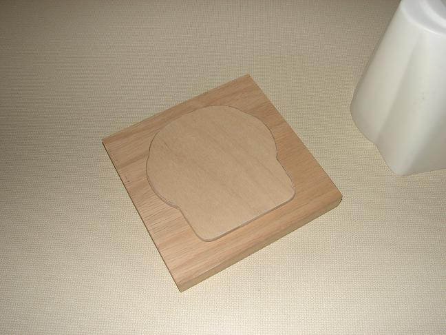

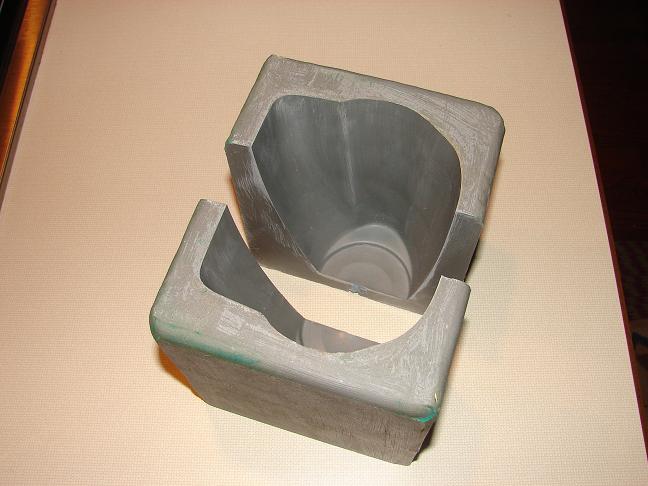

Here's a few pics of the cowl mold. I forgot to take a picture prior to pouring the material. I think the mold turned out very nice. It'a a 2 part polyurethane used for industrial molds.

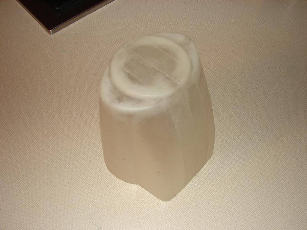

Here's a few updates... Got the gel cote in the mold, glass laid, and the first cowl out. It turned out really good for my first glass project. I'm also thinking about doing the turtle decks with glass or carbon fibre... The fuse sides are also done just waiting to get the formers finished up.

Chris,
very nicely done!
With the cowl and canopy molds, you should consider making a short kit including these, and laser cut wood for the fuse and cores for the wings, stabs and turtle deck. Glass, carbon decks sound nice but they do require painting. Using sheeted foam decks gives you the option to produce a model which can be entirely covered (except for the cowl).
BTW, what industrial mold material did you use for the cowl? Where to obtain it? I like what appears to be a relatively easy pour into the mould container approach.
David.

Thank you David, I'd like to do a kit for this but first things first. Once I get through this one I'll look more into that. I'm planning on painting the fuse so the glass or carbon deck will be quicker and easier for me right now. I'm even considering painting the entire plane.
The material I used for the mold was given to me by a friend that works in a pattern shop. It's called Pro-cast 132. It was very easy to use and didn't harm my brand new Supra-Fly 45 Unlimited cowl. I'm not sure were to get it but I bet there's a lot of other products just like it.

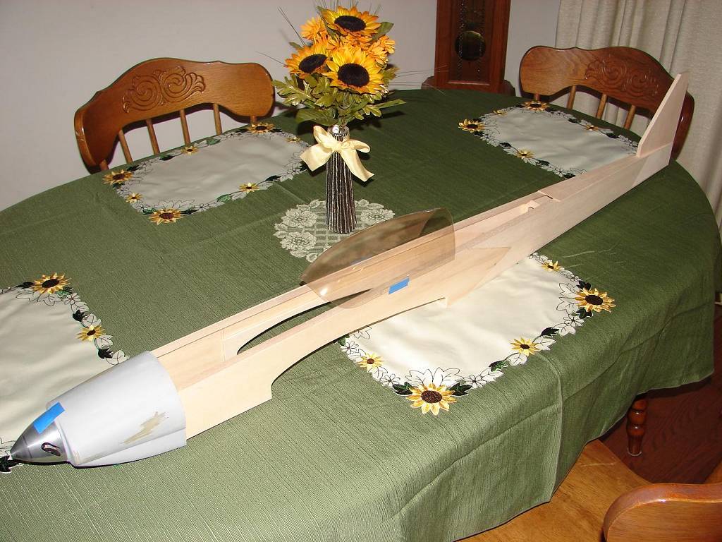

From: Columbus, IN
Default RE: Supra Fly 60 build

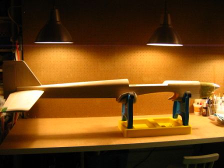

Thought it was time for an update. There's not much to see here, fuse is coming together. Wing and stab cores should be here in a week or two.

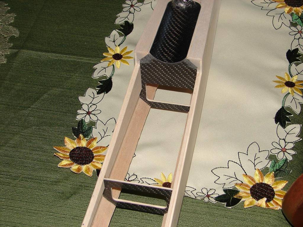

Here's some updated pictures. Fuse formers, firewall, and rear pipe tunnel are in. I laminated 6oz carbon on lite-ply. I think they turned out great!

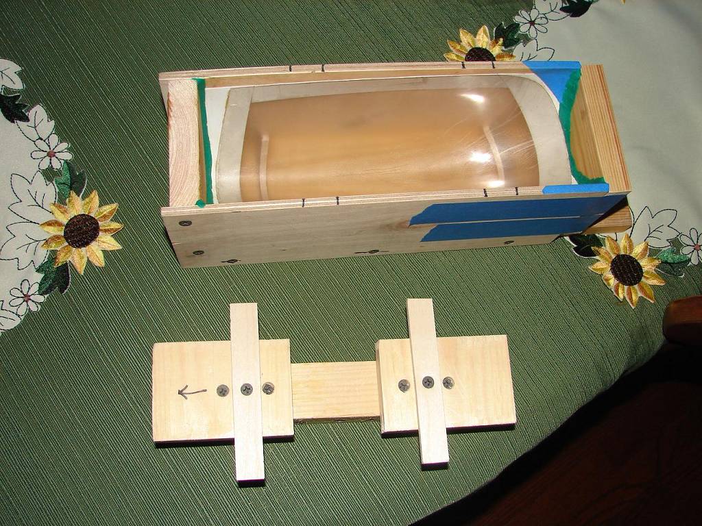

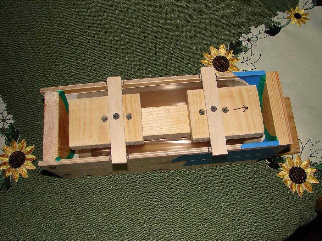

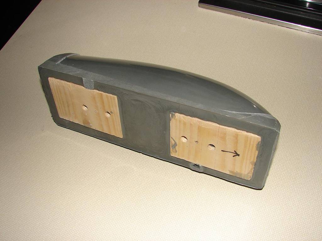

I got back on reproducing the canopy.
Here's the pics.
I cradled the original, sealed it off, and used the same material that I used to mold the cowl.
Now it's time to build the vacuum form!

This is very cool Chris.
So the ply plates on the bottom are to provide some structure to the plug? To pull the original canopy from the plug, do you simply disassemble the cradle and pull it right off? I imagine you need to spray the canopy interior with release wax - correct?
I understand that mold silicone is quite pricey but I bet it is really very fast compared to the traditional two part glass/epoxy approach - right?
