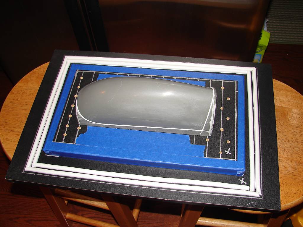

Thanks David! I'm really enjoying do all these thing that I've always wanted to do.
Yes, I just took all the screws out popped the box apart, then popped off the original.
And yes I did brush the inside with a bees wax and rubbed out the brush marks with TP.
The material is a 2 part polyurethane, very easy to use and sets up rock hard. I'm not sure of the cost as it was given
to me. It's also sets up very fast too. From pour to disassemble was about 45 minutes.
Total labor to produce this plug was less then 3 hours.

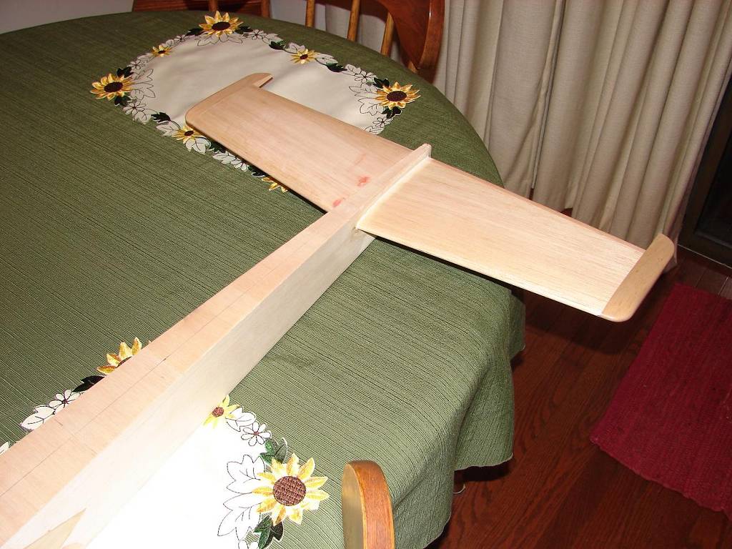

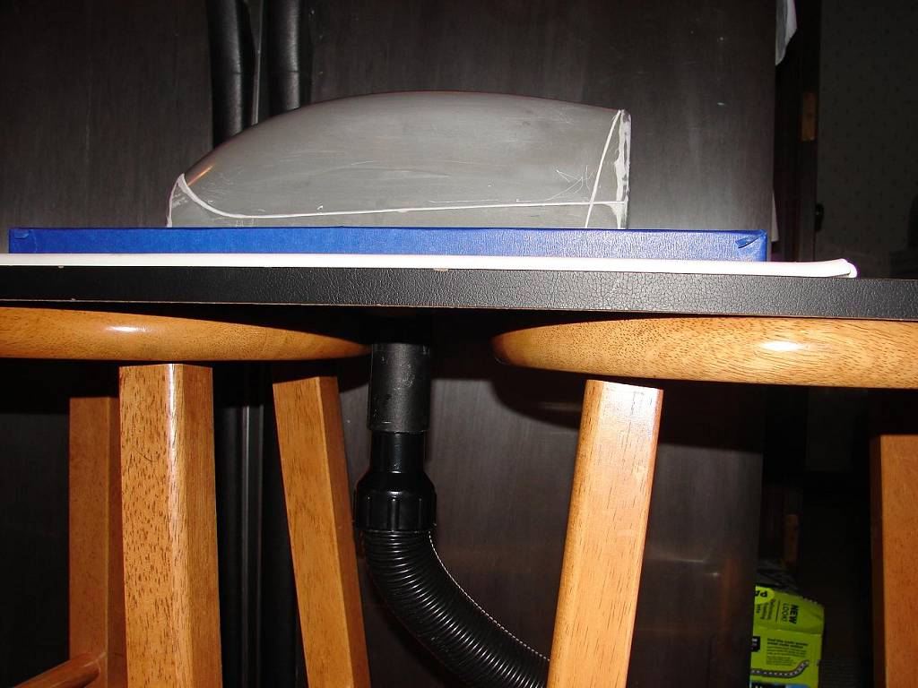

Updates!
Vacuum form is done and material is in. The first few pulls are good. Just a few tweaks!
Here's also pics of the engine mount and tank installed.
Foam cores will be here tomorrow.

Old 05-06-2010 | 10:23 PM
  #28
Joined: Apr 2003
Posts: 82
From: Columbus, IN
Default RE: Supra Fly 60 build
pics

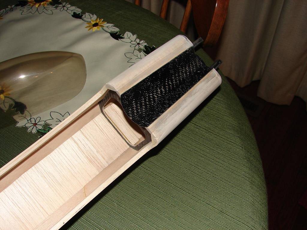

Thanks David,
I've not decided what to do with the front tunnel yet. I'll probably fill it in with balsa up to were the tunnel is then epoxy the tunnel in like I did behind the wing.
I took one of the wifes old hairspray bottles, tacked it down to the bench so it wouldn't roll around, put some mold release on it, and laid the carbon on it just like glass. When it was done, popped it off and a perfect tunnel. The carbon I have is just a standard 5.9oz plain weave. Then next time I buy some it will be the stitched variety. The stuff I have is very tough to cut small pieces with out it falling apart. The larger flat pieces are not too bad though. I put some mold release on a piece of glass, wet out the area of the fabric, lay the fabric down & wet that out, then put the balsa or lite ply down and a thick board and weight. The next day it's a perfect carbon laminate.
The originals SF cowl I used is almost the exact same size and the cowl in the reduced plan.
As far as I can tell the two originals cowls, 45 & 60 are the same. In fact there is very little difference between the 45 and the 60 in relationship to the fuse. I think it's going to look very nice.

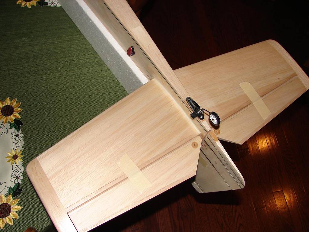

Thanks for the comment Jeff and yes David I've been working on it. Just been lazy posting updates. Here's a new pic of the stab installed. I received the cores but the wing was not what I wanted so I had them redone. The new ones should be here Wed. along with the decks. I'll probably mock the whole thing together and take a pic.

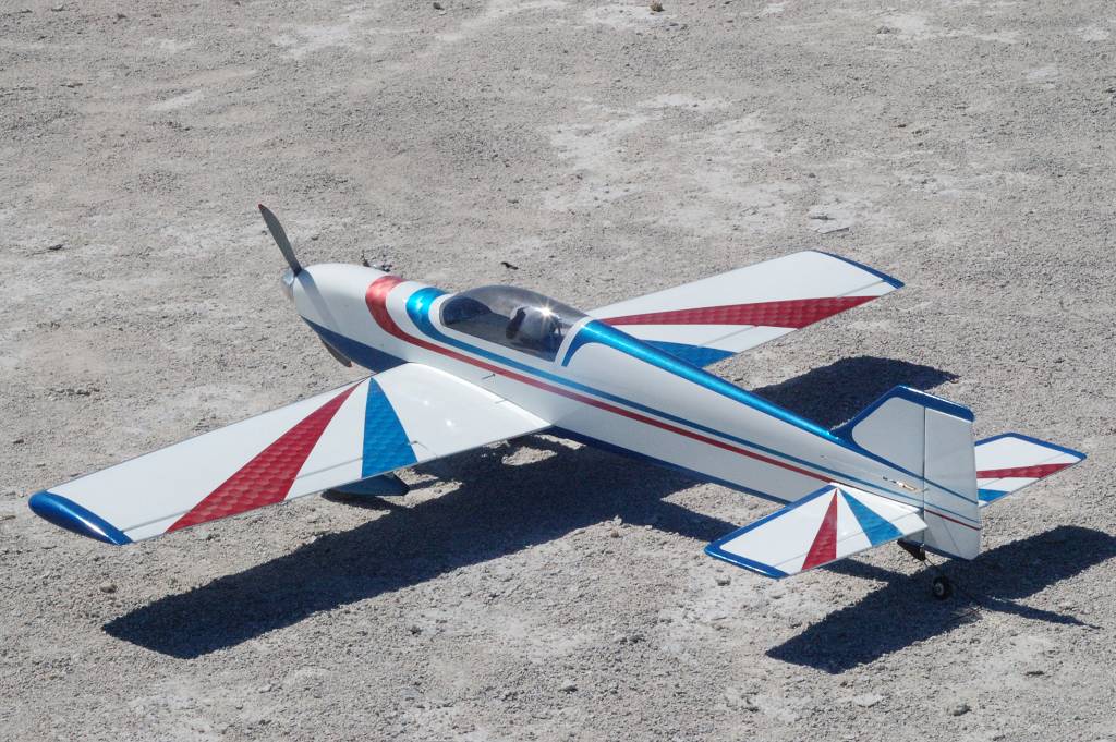

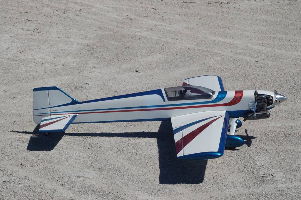

Old 10-30-2010 | 11:23 PM
  #50
Joined: Mar 2003
Posts: 1,881
From: Perth, AUSTRALIA
Well guys, one of the two supra-flys is nearly done, just needs it's decals and I'll call it finished.
OS 46fx,
JR 700 rx
2 x 591's for elev and rudd
2 x hs85bb's for ailerons
1 x hs 55 for throttle.
AUW- 1875g.
It's a great little flyer, and tracks smooth just like her bigger sister
