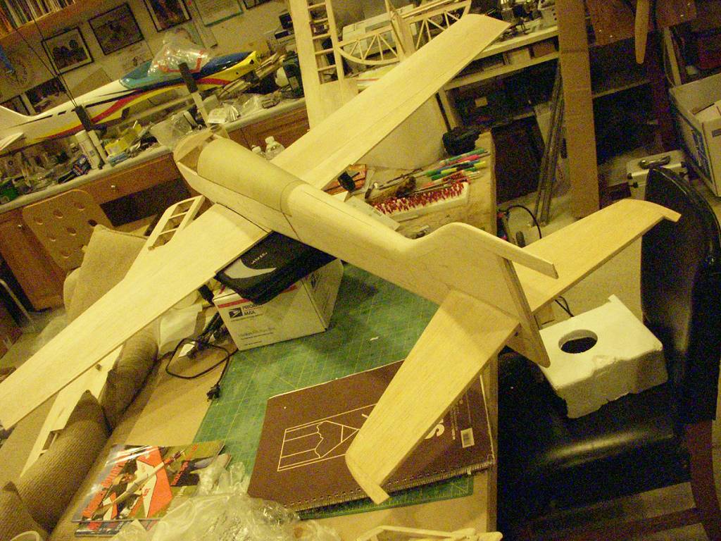

I do what I do, I just can't help myself. I had a Curare a long time ago and I had to add weight in the tail to balance so this one is streched 7".

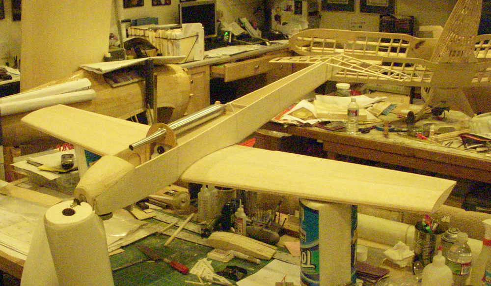

I really wanted a sleek steamlined plane. I didn't want my engine exposed, so I widened the front end about an inch or so to keep the pipe inside. I'm making a custom header to connect to the pipe, but for now I just used a stock side header for spacing.
ID:	1451777   Click image for larger version

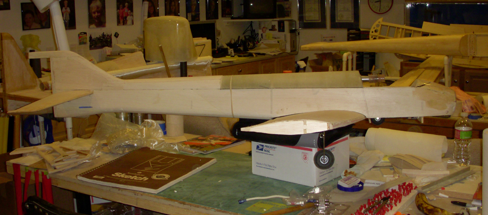

I am building a fiberglass cover for the pipe in this picture and I may extend it in a new splash to include the canopy.
ID:	1451780   Click image for larger version

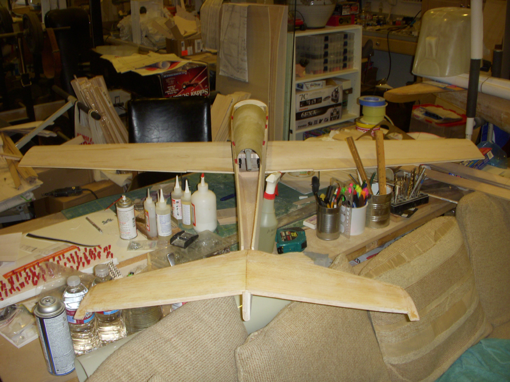

Here's a shot sitting on the landing gear! You can better see the length. It is as long as the wingspan. It's about 7" over stock length.

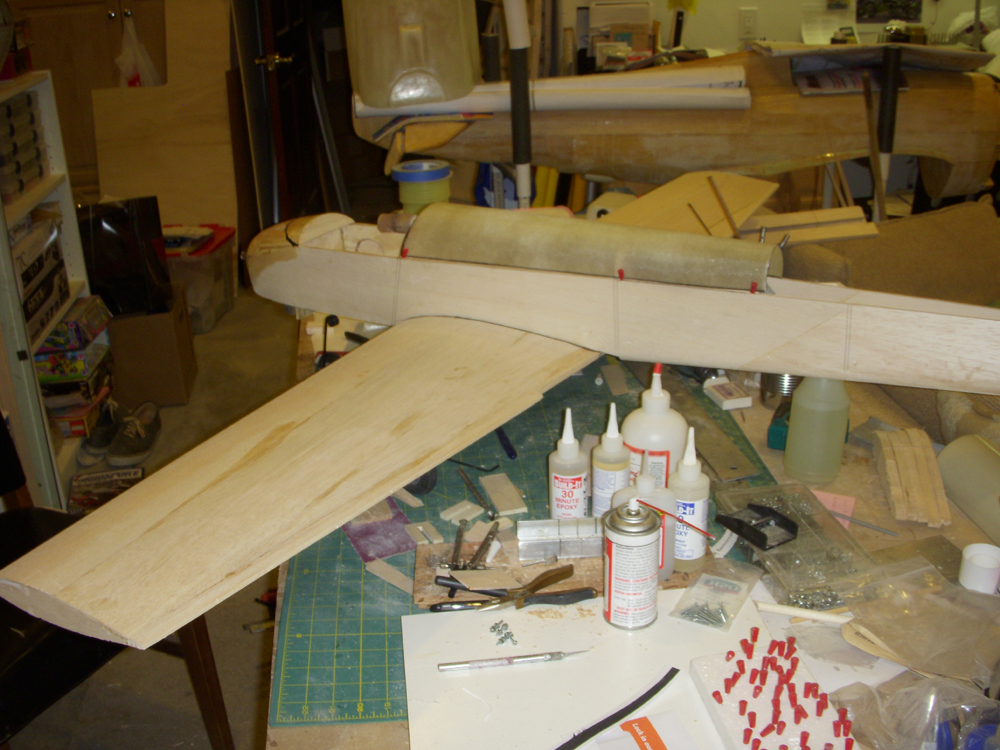

OK, I thought I better do a rear shot. I'm getting ready to do the turtle deck and the rest of the tail/rudder etc.

Just curious, what was your reasoning for adding 7" to the fuselage, instead of say 2 or 3"? TIA
Ed Cregger
Old 06-13-2010 | 10:12 AM
frequent flyer's Avatar
Joined: Feb 2003
Posts: 1,485
Received 5 Likes on 5 Posts
From: Grand Junction, Colorado
Default RE: Modified Curare Build!
The orignal is nose heavy that I had. It was stubby looking and most of my current pattern planes are even longer than their wingspans. To me it looks better, balances better, shoud roll better, better is what I like to do.
