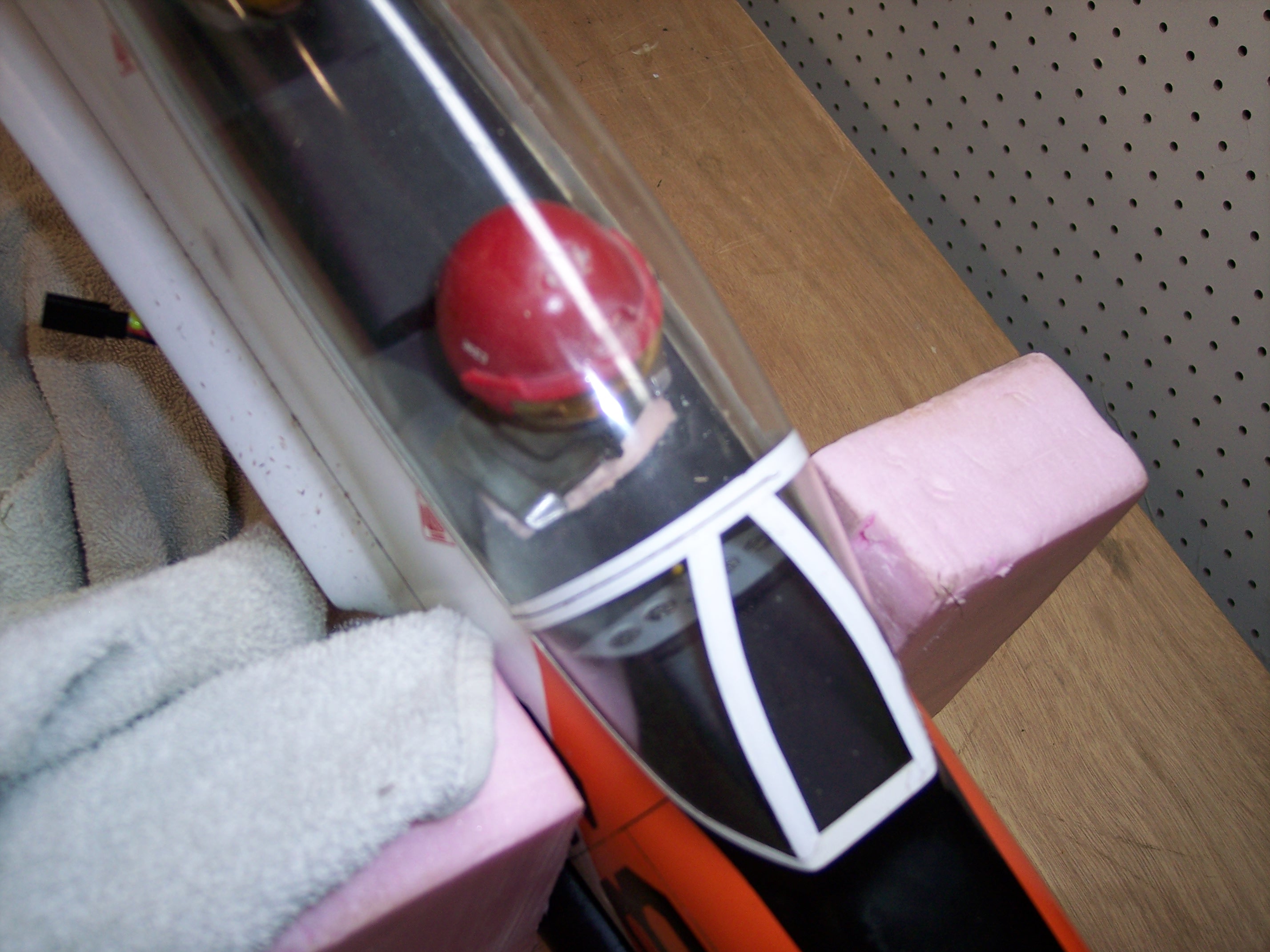

edp 03-25-2010 06:02 PM
RE: My T2A
1 Attachment(s)
I hope to finish this this year. I building a GP Deception right now. I just lost intrest in for a while.

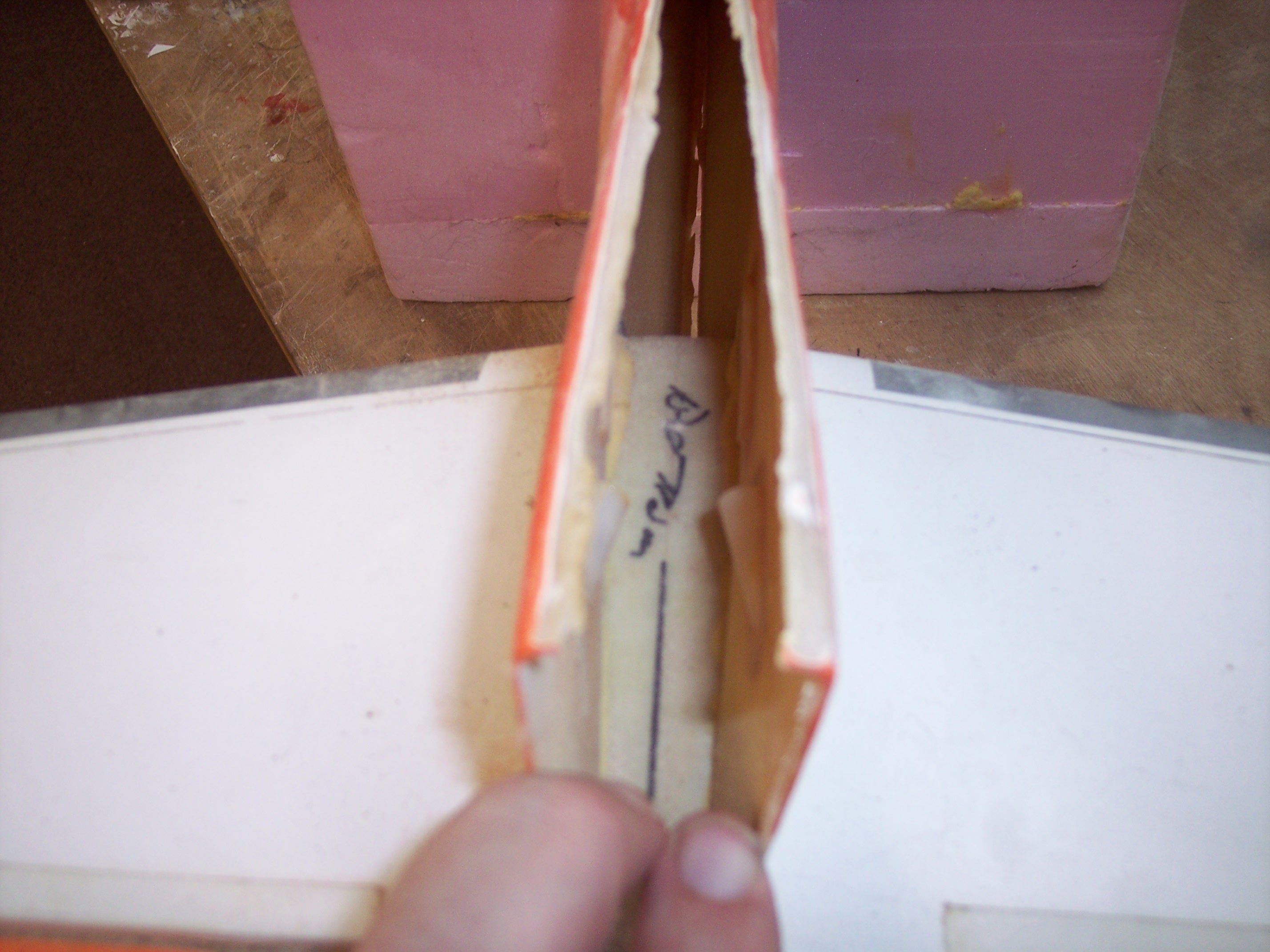

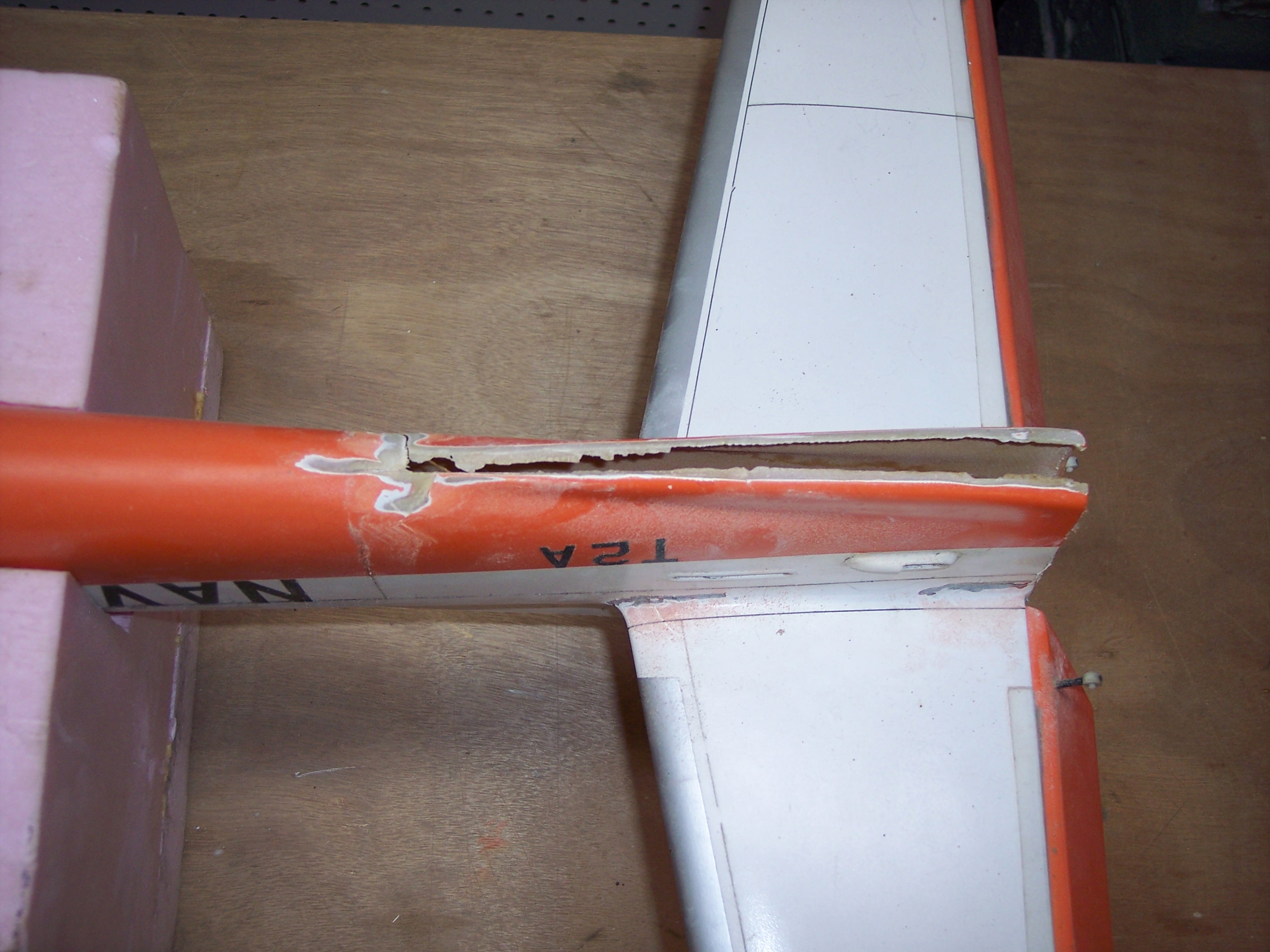

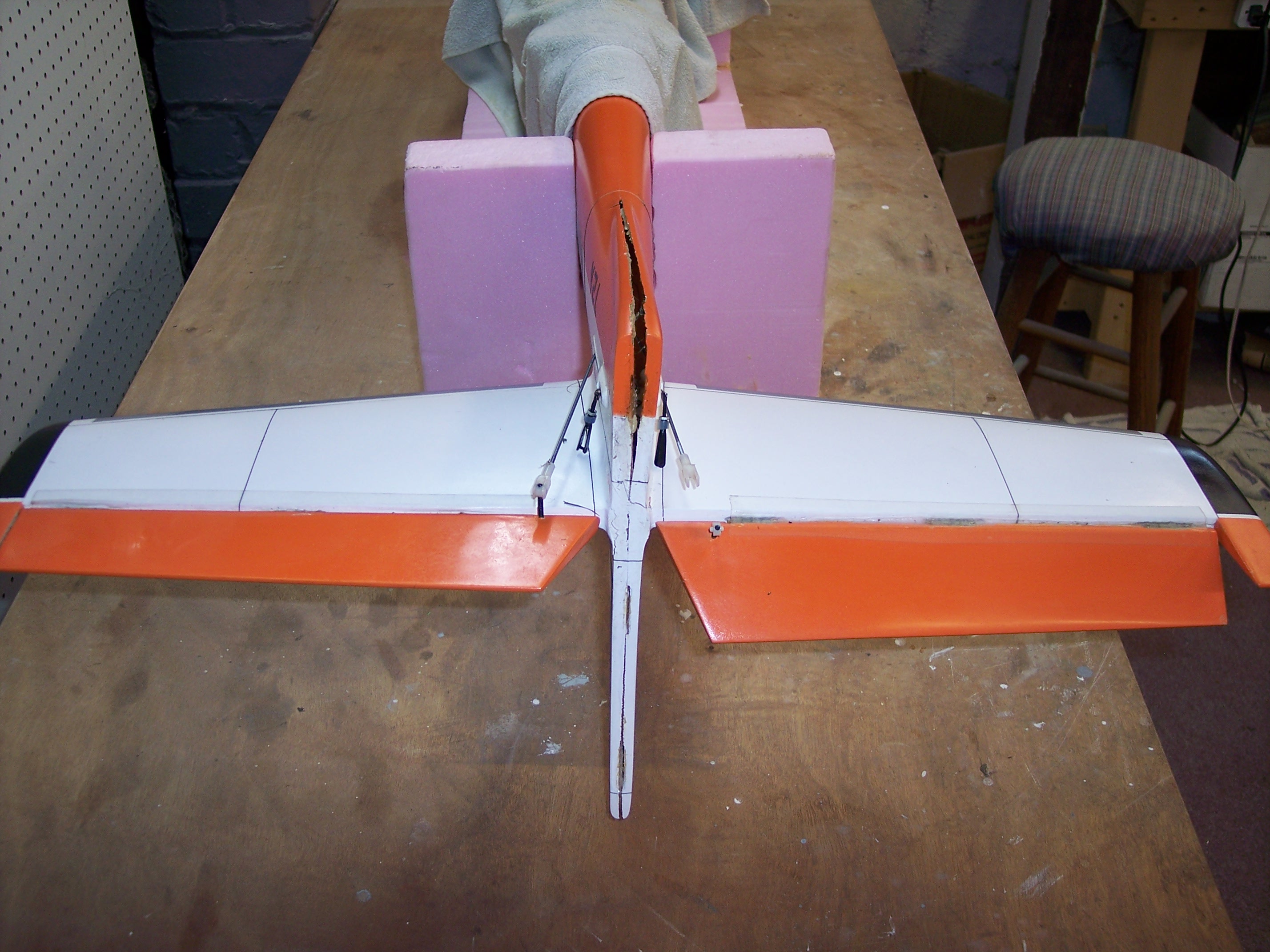

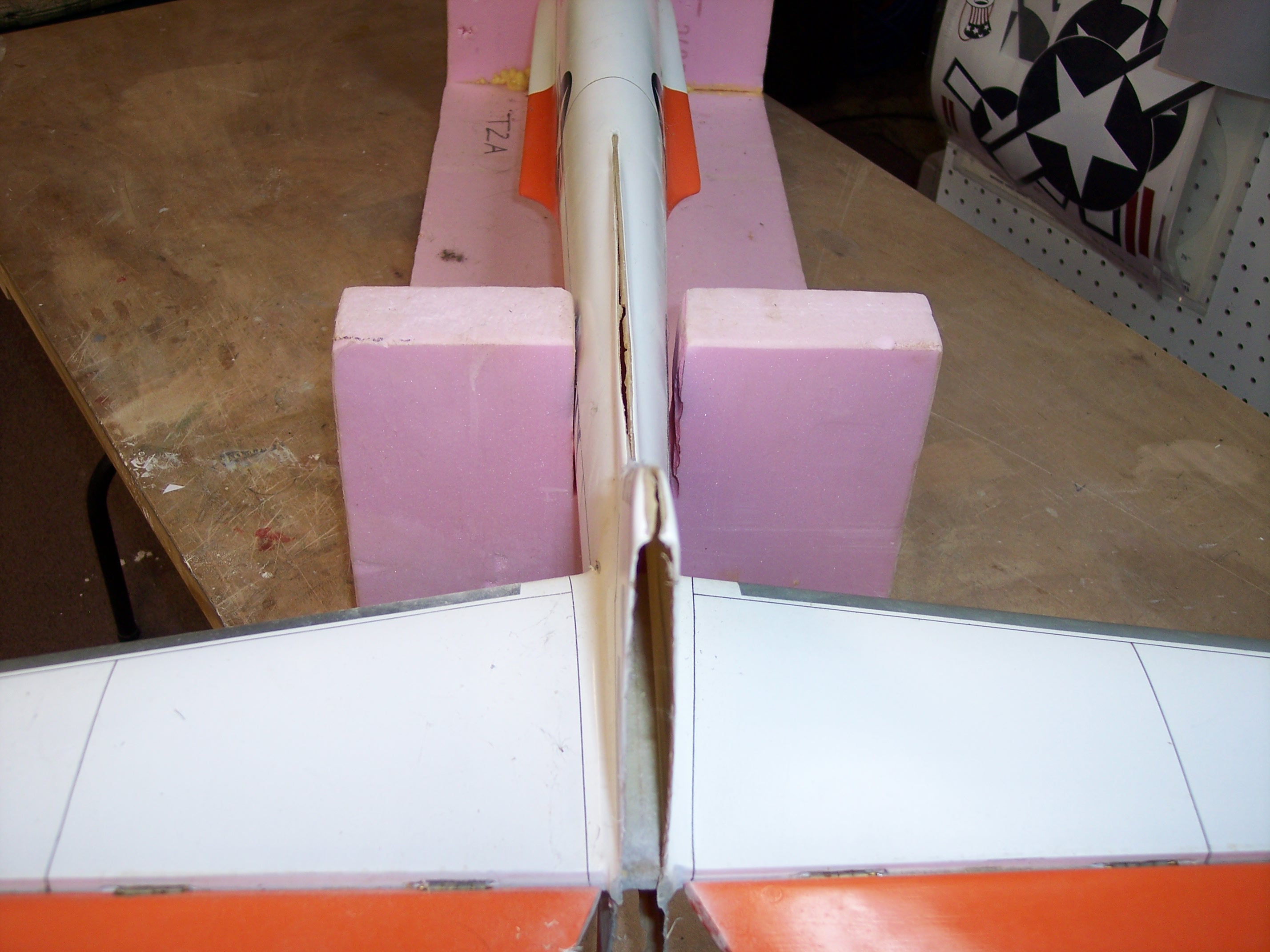

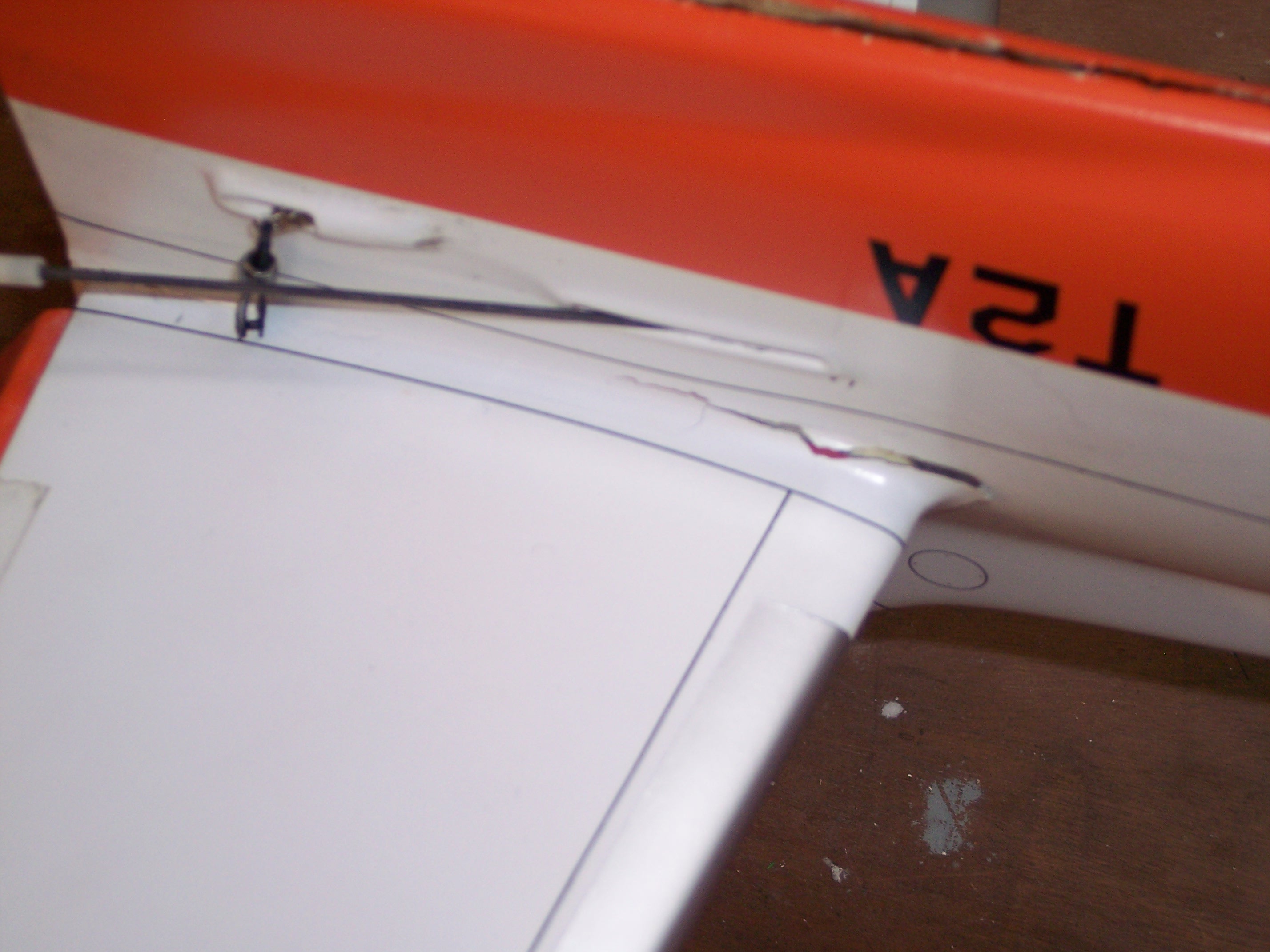

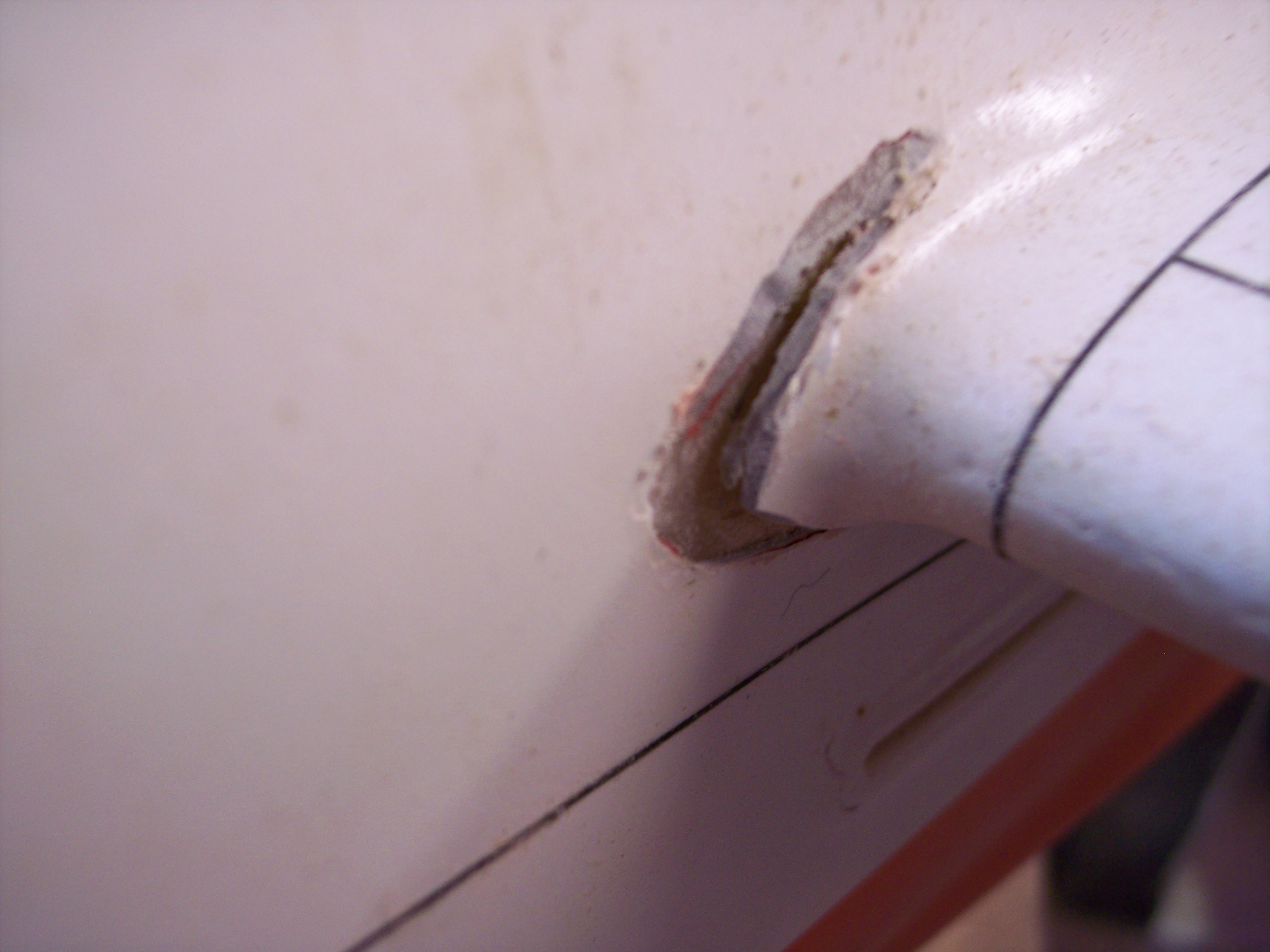

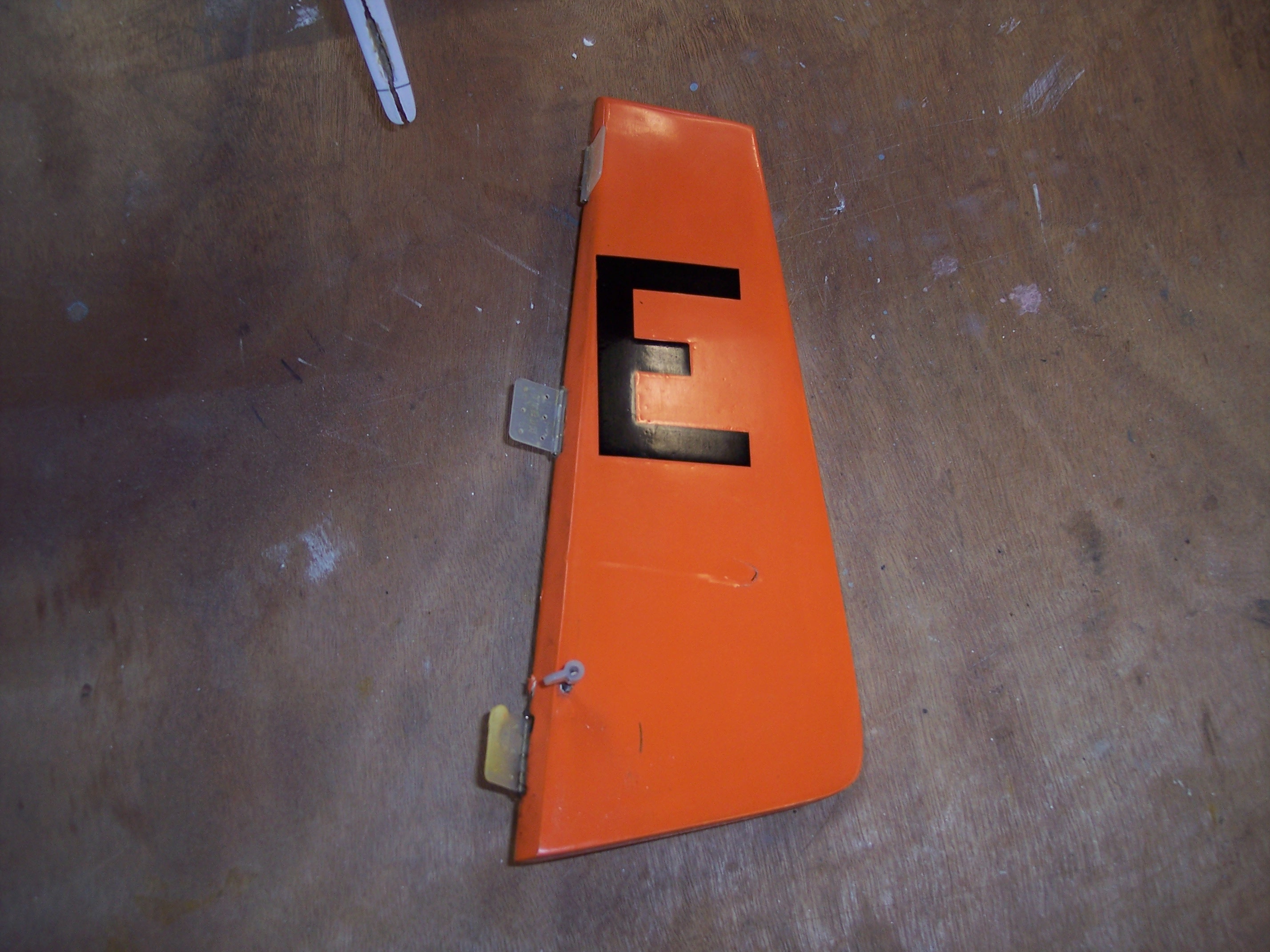

edp 12-07-2014 09:14 AM
9 Attachment(s)
http://www.rcuniverse.com/forum/atta...mentid=2052904http://www.rcuniverse.com/forum/atta...mentid=2052905http://www.rcuniverse.com/forum/atta...mentid=2052906http://www.rcuniverse.com/forum/atta...mentid=2052907http://www.rcuniverse.com/forum/atta...mentid=2052908http://www.rcuniverse.com/forum/atta...mentid=2052909http://www.rcuniverse.com/forum/atta...mentid=2052910http://www.rcuniverse.com/forum/atta...mentid=2052911http://www.rcuniverse.com/forum/atta...mentid=2052912
Finally I'm in the mood to repair my T2A. I had to avoid a full scale plane that took off w/o radioing ANYONE back in 2013. We have spotters along w/ a radio set to the airport. i dumped it in high weeds. No damage to the wings but the tail feathers another story.
There is no glass that crossed the seems aft toward the stab. Also none in the fin/fillet.
In the stab area, it looks tike only the epoxy/filler popped out.
I cut/ground out the tail post that wasn't very good in the first place.
I have cab-a-fill to mix w/ epoxy. What is the best way to add glass cloth and what weight? I have 3/4 oz and 6 oz.
Roguedog 12-07-2014 04:59 PM
Here's what I would do.
For the bottom I would use several layers of 6oz cloth or better yet use 2 to 2.5 inch fiberglass tape usually 8.9oz, laying up the first layer with at least 1inch of overlap from the inside out folding over so that you have a surface to build up on.
The fiber glass tape has weaved edges that won't fray making the repair easer. Once that is done you can use the regular process of feathering the fiberglass on the outside than use varying patches that get smaller and smaller until built up enough that you can sand back to the original shape.
After the outside is back to shape you can trim/sand the excess off the inside if to heavy.
For the top if it's to thin to for you to to do an inside layup Cab-O-Sil is the right filler to use. I'd make up a mixture the consistency of peanut butter or icing then place if in a Ziploc baggie to use a cakebag. At the corner of the baggie cut it so you have a 1/16 to 1/8in hole then squish it into the gap along the top. You won't need a lot maybe at the most 1/8 to 3/16 of an inch deep into the crack.
Use strips of masking tap to hold if together with the last strip covering the entire length of the upper crack.
You can get the peal and stick sand paper and stick a peace to one side of a 1 or 2 inch putty knife to rough up the inside of the fuse enough to get a good bond when applying the epoxy layup on the bottom and on top so the Cab-O-Sil mixture will have a good surface to stick too.
There's no loss of structural strength with Cab-O-Sil, there is loss of structural strength with microballoons.
Show pics of the repair as you progress.
Regards
Bryan
