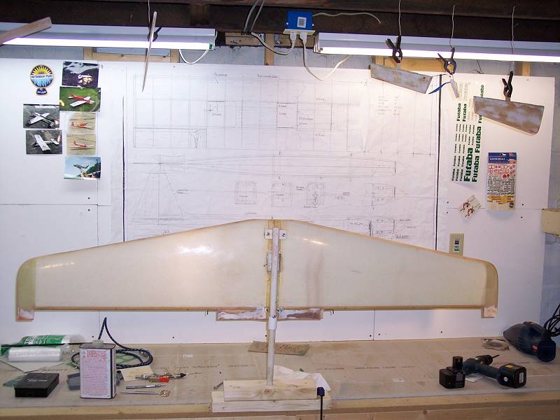

Getting ready to put on final primer coat on my Tom Atkins T2A. Will have an Enya Mk IV AAC .60 with B&D retracts. Futaba 9CAP will guide it. I will try the new Nelson Products paint system

Thanks, I'm going with his paint scheme of white, orange and black with a few changes. I have painted alot of planes in the past 40 years and I like the original.

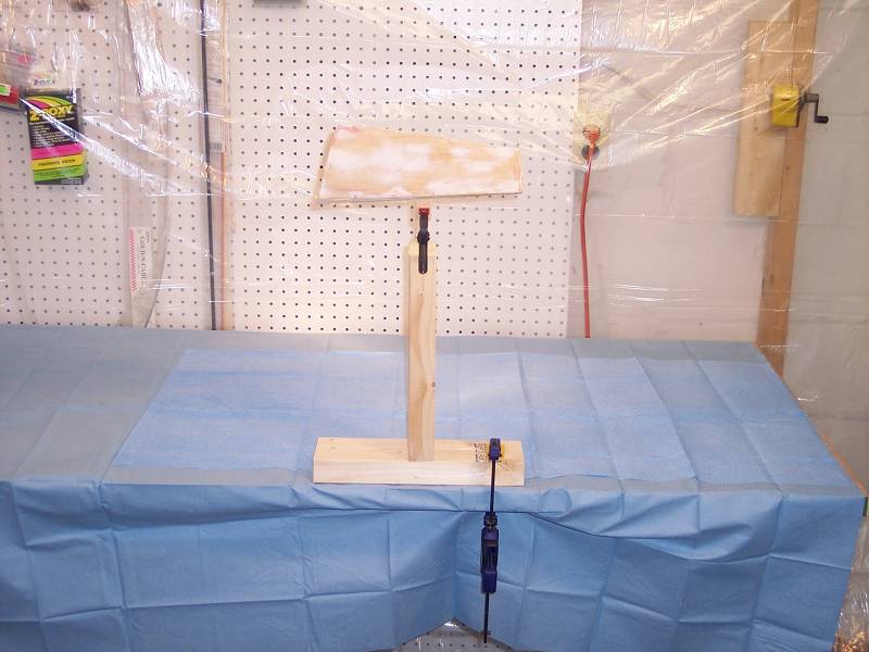

Thanks guys. I shot primer and found alot of pinholes in the wing itself. Looks like the epoxy never filled the weave. I didn't see or feel it before I shot . I went to Nelsons website and I did go with the 30% rubbing alcohol to thin it. I have flow Skylarks, Pheonix 8's and Tiporares for years. In fact in one of the wing pictures you can see my Tipo (before and after it hit a tree during a knife edge to knife edge pass at a strange field) and my Skylark. PS, that tree was cut down after two other people hit it. I will post some pics on Wed. I work 12 hour night shifts and not much time to paint on my days off.

[:@] Here is what I was talking about. I have some in both panels and a little on the fuse.. Hard to photo on an all white surface. I will sand and use glazing puttty to fill and reprime. I know, this is supposed to be a relaxing hobby..........

ORIGINAL: edp
I've seen this before. My solution in the past was to use a good filling type of primer, 2 or 3 coats, and wet sand. That way you can build up just where it's needed. I used to use K&B superPoxy primer.

I miss K&B products. I painted many an airplane with their primer, it sanded easy and smooth as glass. Nelsons takes awhile to set. I can glaze, sand and prime in 60 minutes.

Well, I filled all those pinholes I found after I primed. Nelsons dries to a semi gloss making it easy to find pinholes, dips and things. Now my bird looks like it has a rash or something. I will reprime Fri nite. Here are some birds of the past. One of my three Tipos before and after, My first pattern ship a CG Sklark 56 MkII. Yes, it has a full lighting system I came up with. I was able to put in retracts. I built just before I went into the US Navy in 1981. And finally my GP Tracer. Here is a shot of an EA-6B Prowler on the USS Independence, Med '83. I was an Aviation Electronics Tech (AT) for VAQ-131 Lancers. Go NAVY (Army-Navy game this weekend)

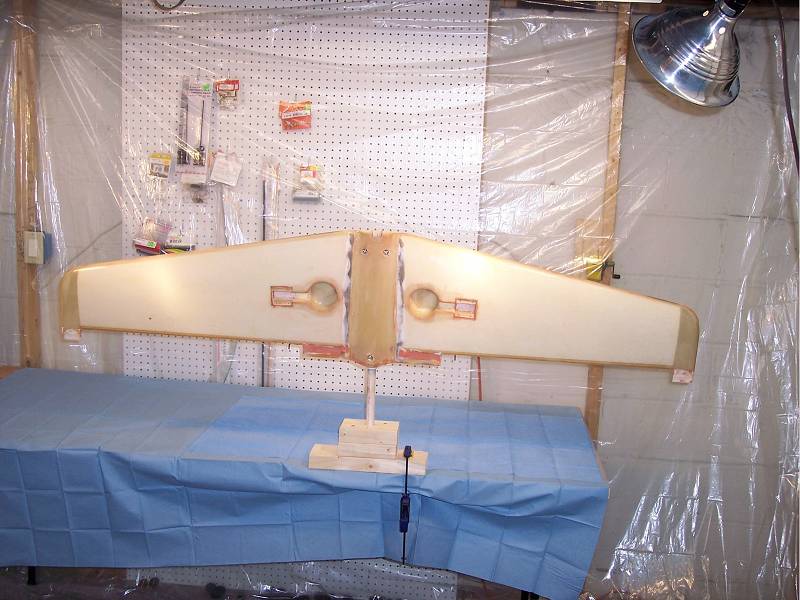

FINALLY, I have it filled and primed. I kept finding pinholes in the weave. The more I looked, the more I found. I mixed up a batch of Nelson's primer and dabbed/brushed it on filling pinholes. It took alot longer to dry this way than spraying it on (about 3 days). I finished wet sanding this morning and hope to shoot white tonight. I have my room at a toasty 75 deg. while it is 22 deg. outside!!!! Those are scratch built instument panels. I practiced with these as I am building a Top Flite GE 1/7 Mustang Mk.III (RAF P51b/c).

Finally, it's all white. I read and reread Nelsons instructions on there web site. I did use more water than the two cap fulls. The white is really thick. I used 6ozs. of paint to cover everything. I used close to 1 1/2 ozs. of water to thin it. I did add the crosslinker to help it flow. I am using a Badger touch up gun at 35 PSI. I will use my Badger airbrush to shoot color on Wed. night (that pesky work stuff gets in the way!!) I use and airbrush because of small batches to mix.
