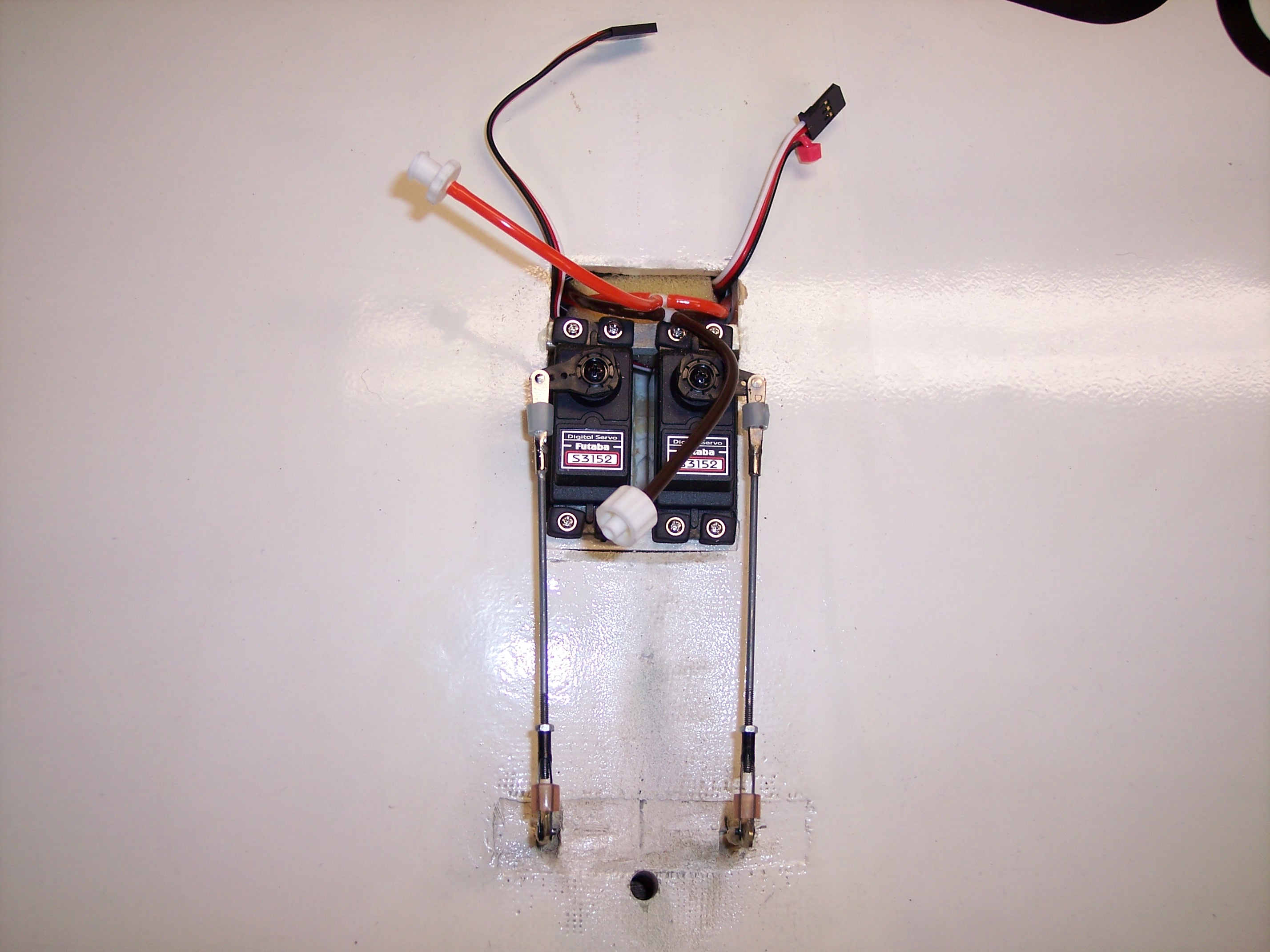

2 Attachment(s)
Will,
[ATTACH]2171178[/IMG]
No slop as I made the ailerons from hard balsa. These servos put out 56 oz. of torque on 6V. I have used this same set up on every pattern bird I've built w/o any problems.
I made flat high speed passes w/o any kind of aileron buzz.
Yes as soon as I slow down ailerons are back to normal. This is a first for me on this one.
On a scarier point, I was flying my friends 27% Extra 270 when both ailerons servos let go. Landed fine using the rudder. Turned out he had good JR servos but w/ plastic gear train.
[ATTACH]2171182[/IMG]
Just a bad day for ailerons

1 Attachment(s)
http://www.rcuniverse.com/forum/atta...mentid=2179837 This is my standard set up. This is just the first time I have had problems. What I will do is use 100% roll right and 80% roll left on the rates or whatever it takes to be equal. It just throws off my timing as it is now. Trimming a new pattern bird is always fun. The bird is dead nuts straight w/o any aileron or rudder trims.
crankpin 09-06-2016 04:28 AM
You are using 440 rods, thats good. Seal the gap TE wing to LE ailerons ? The arc of the arm on 180 degree plane, vs servo side mount, giving arm fore and aft ? I don't know as much as some guys on here, just my opinion.
Crank

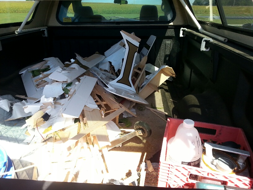

On a sad note for my friends, there were three totals at the field. one my Dad's foam jet, and a semi student's big Super Sportster, and this one. I have flown this Miles Reed SolutionX 84" for several years (That's yours truly 4 years ago). Bob was flying it yesterday when total radio failure from a 200' stall turn. This was a great Flying IMAC bird.
http://www.rcuniverse.com/forum/atta...mentid=2182893http://www.rcuniverse.com/forum/atta...mentid=2182895

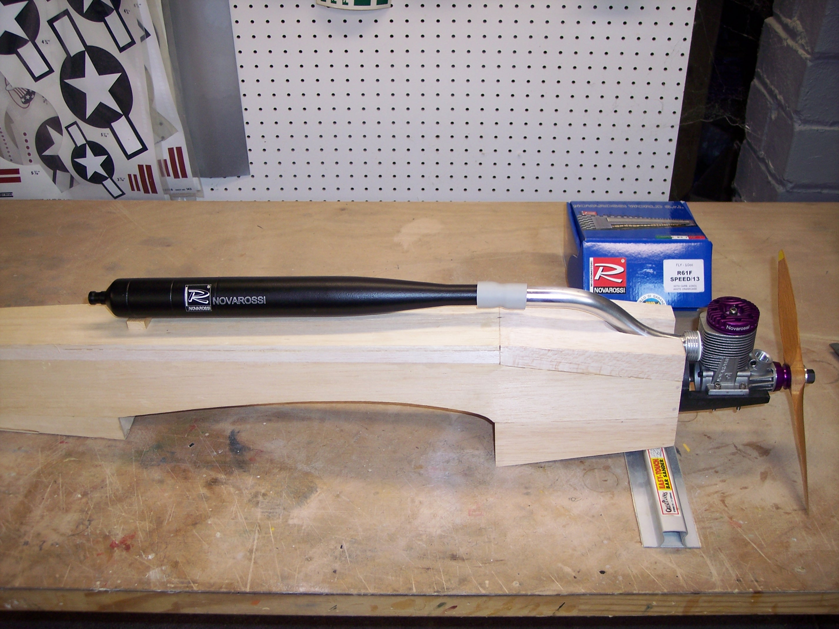

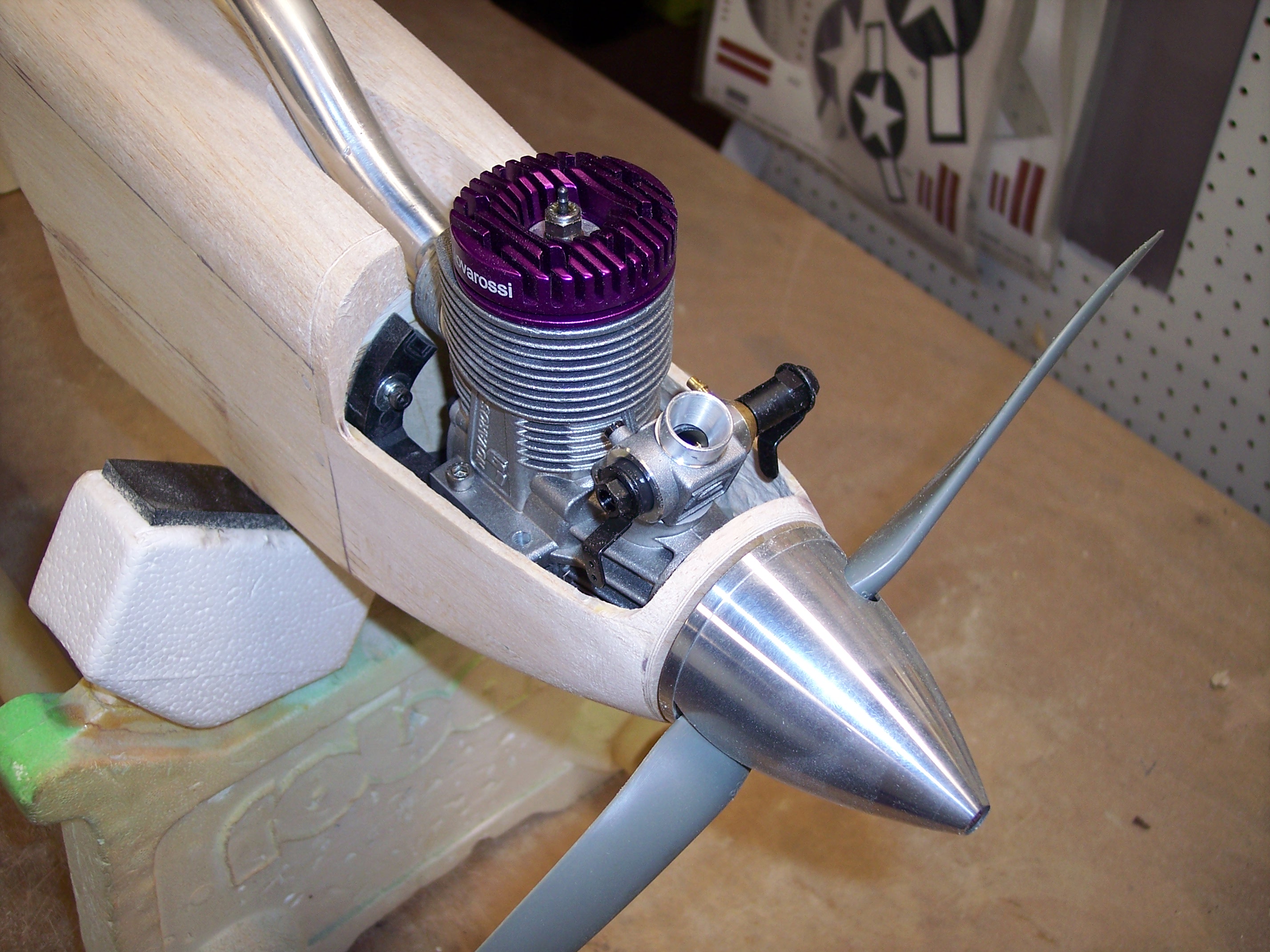

2 Attachment(s)
This one just seem more pronounced than others. My 3 Tiporares, P7, P8 and T2A, never as much. I like it know that the kinks are worked out. I am building a XLT w/ the FIRE Novarossi Speed .61. My RCAiir Illusion will tested this Spring if the weather is good.
http://www.rcuniverse.com/forum/atta...mentid=2192839http://www.rcuniverse.com/forum/atta...mentid=2192840
