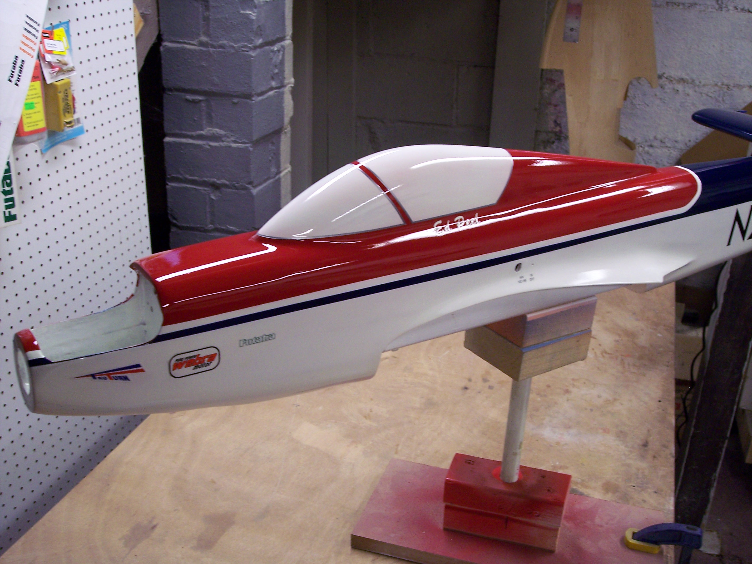

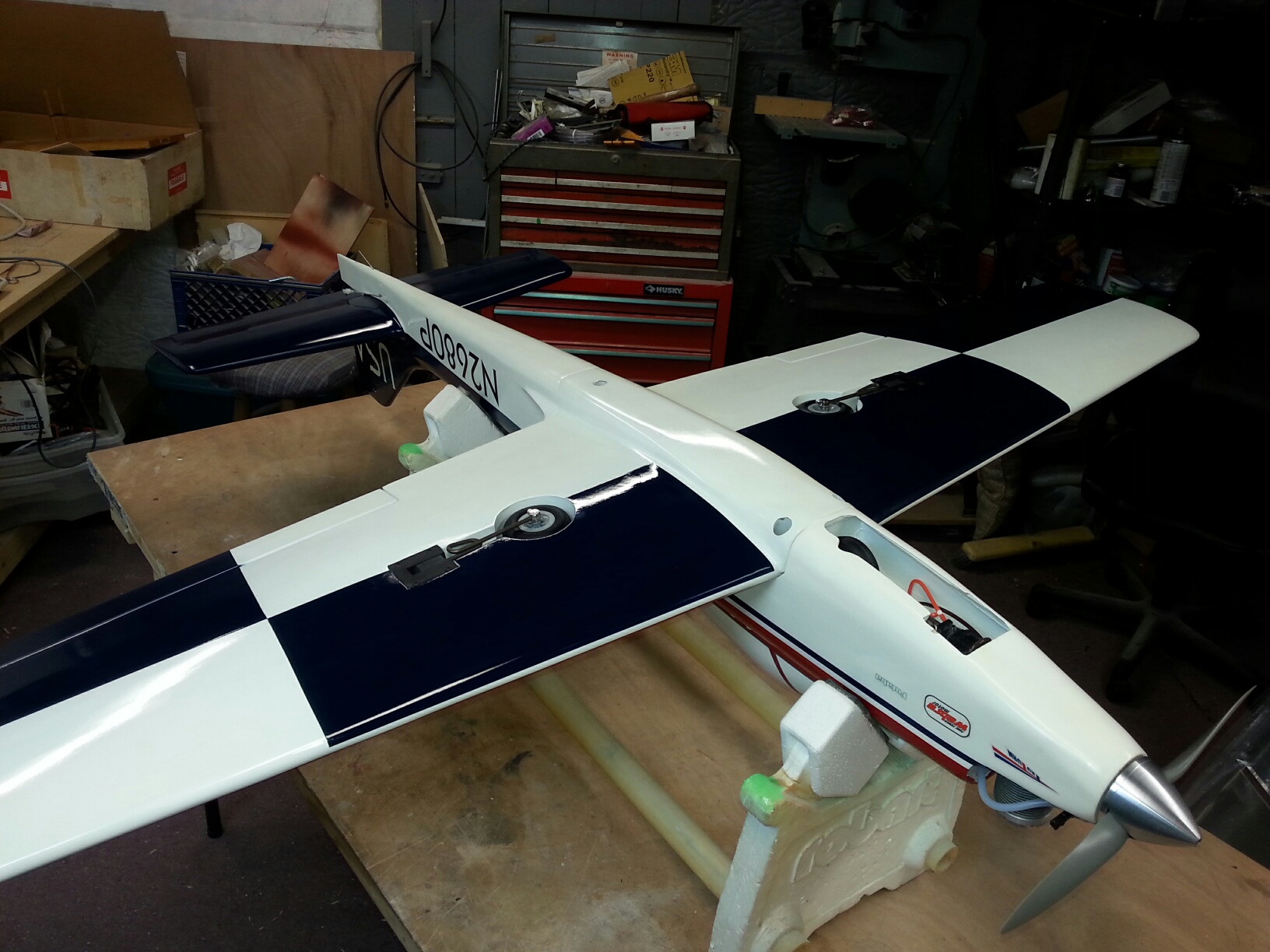

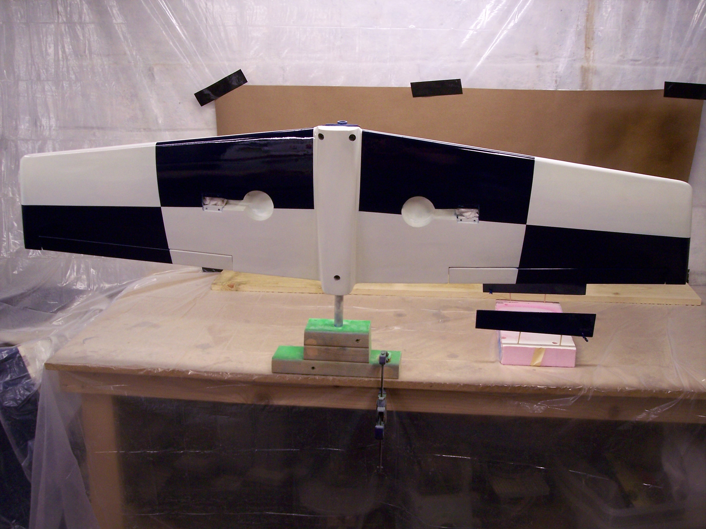

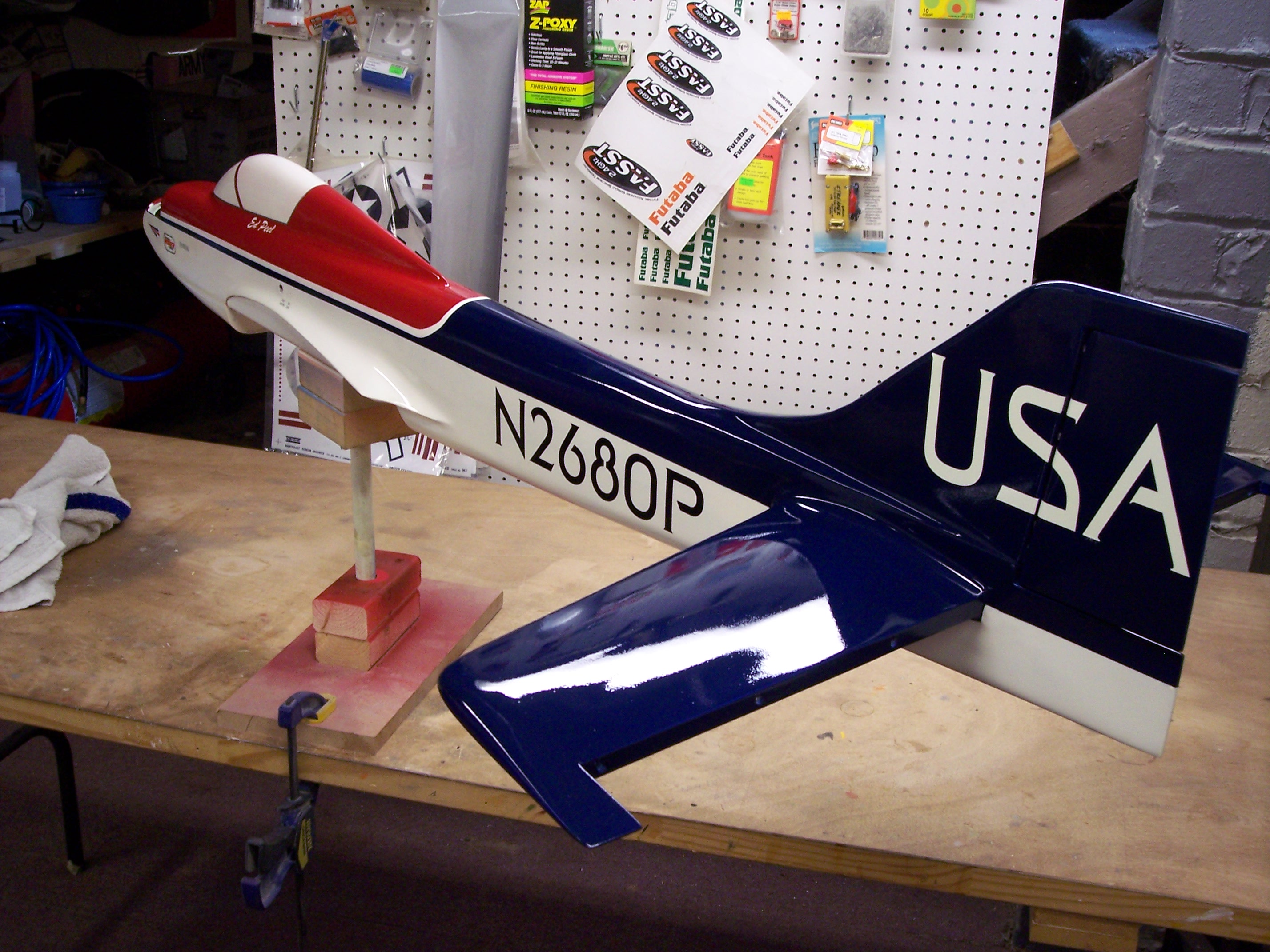

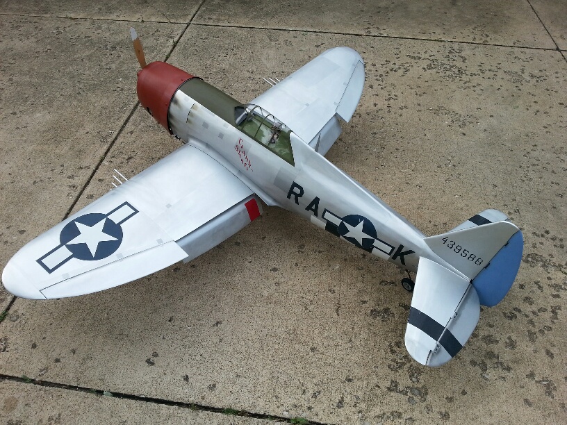

Finally shot the Klass Kote clear. I have been finishing my friends Ziroli 70" P-47. That's three birds in the past month.
dhal22 07-11-2015 07:22 PM
Good looking work. Love the clear.
skybuster97 07-11-2015 08:57 PM
Ed,
Beautiful work.... Can't wait to see it airborne.

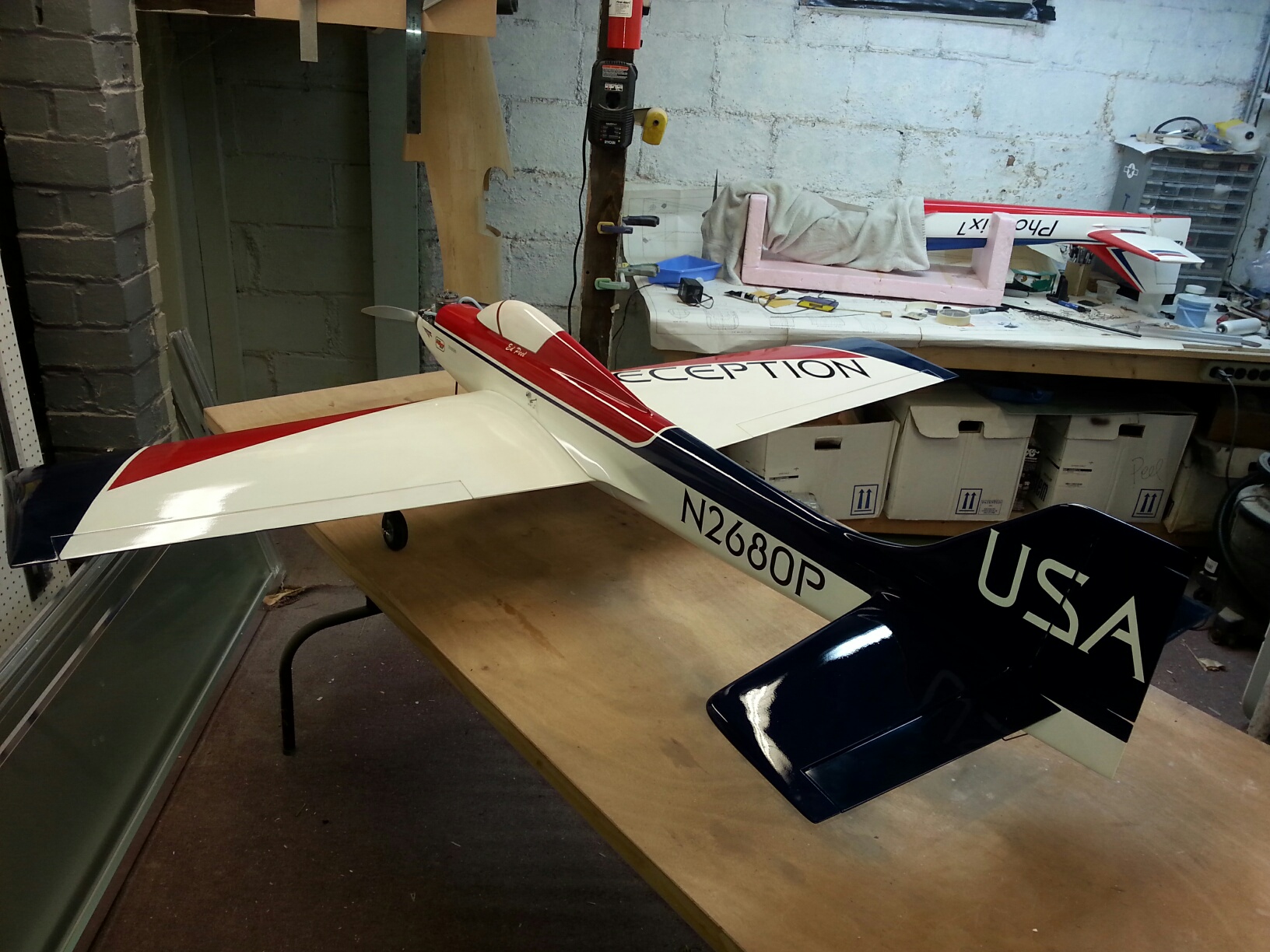

http://www.rcuniverse.com/forum/atta...mentid=2149576http://www.rcuniverse.com/forum/atta...mentid=2149577http://www.rcuniverse.com/forum/atta...mentid=2149578Best pics I can do now as the snow is flying.
dhal22 02-28-2016 06:21 PM
Fantastic! Beautiful!

The first flights.
It is built straight and true as it only took 3 clicks of up elevator for straight and level (spooky). Engine is new and was run rich at 11,750RPM on an APC 11x7. Take-off was straight and clean w/ the gear up and no issues. Pulls the vertical straight and plenty of rudder for a good stall turn. CG is spot on. NOW THE BAD, the ailerons go blank at full throttle. I can roll one way or the other and it will continue to roll and is difficult to roll back to level. At slow and up to 3/4 power, all is well with good response on the ailerons and rolls fine both directions on all three rates w/o problems.
All I can think of is that I forgot to seal the ailerons and elevators. My gaps are tight about 1/64".
