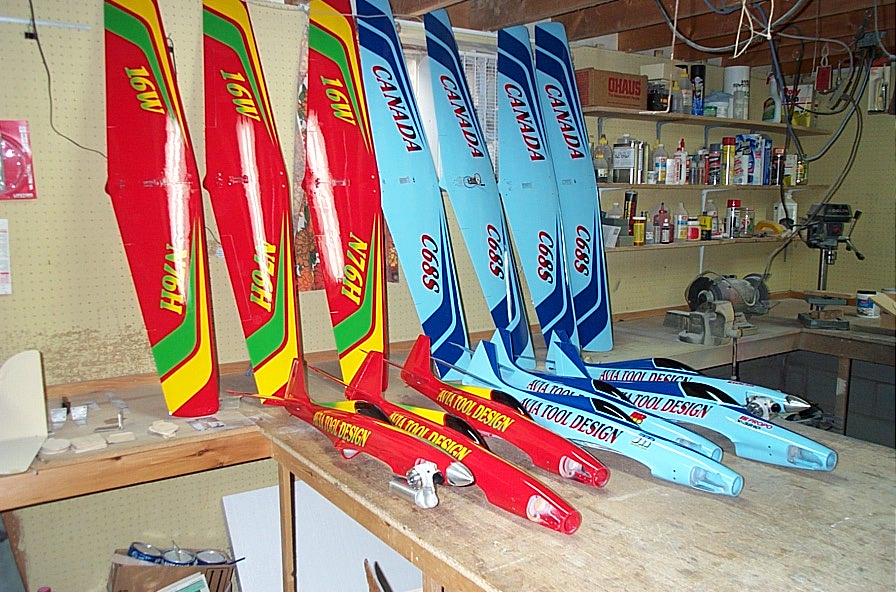

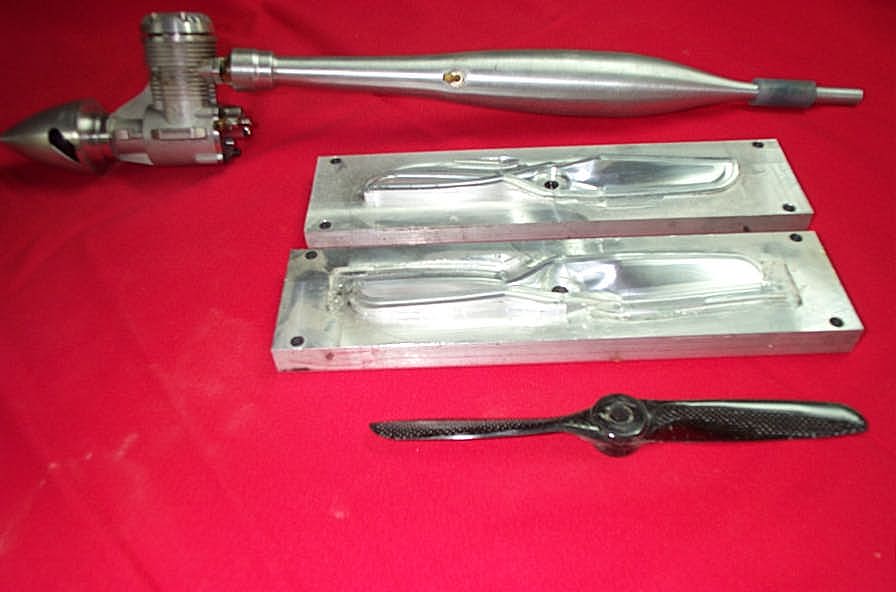

So that it can be seen I have some knowledge of composite use I attach some pictures. The fuselages were molded with MGS epoxy. The foam wings were skinned with balsa and covered with 3/4 oz glass squeegeed down with MGS epoxy. The propellers were molded with carbon fibre and MGS epoxy. GET RID OF POLYESTER!
Ed S
