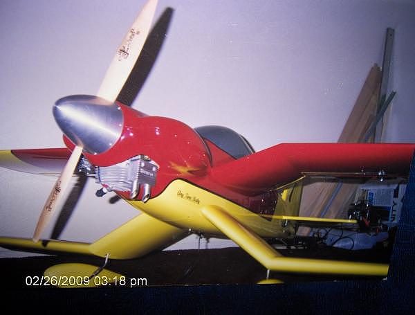

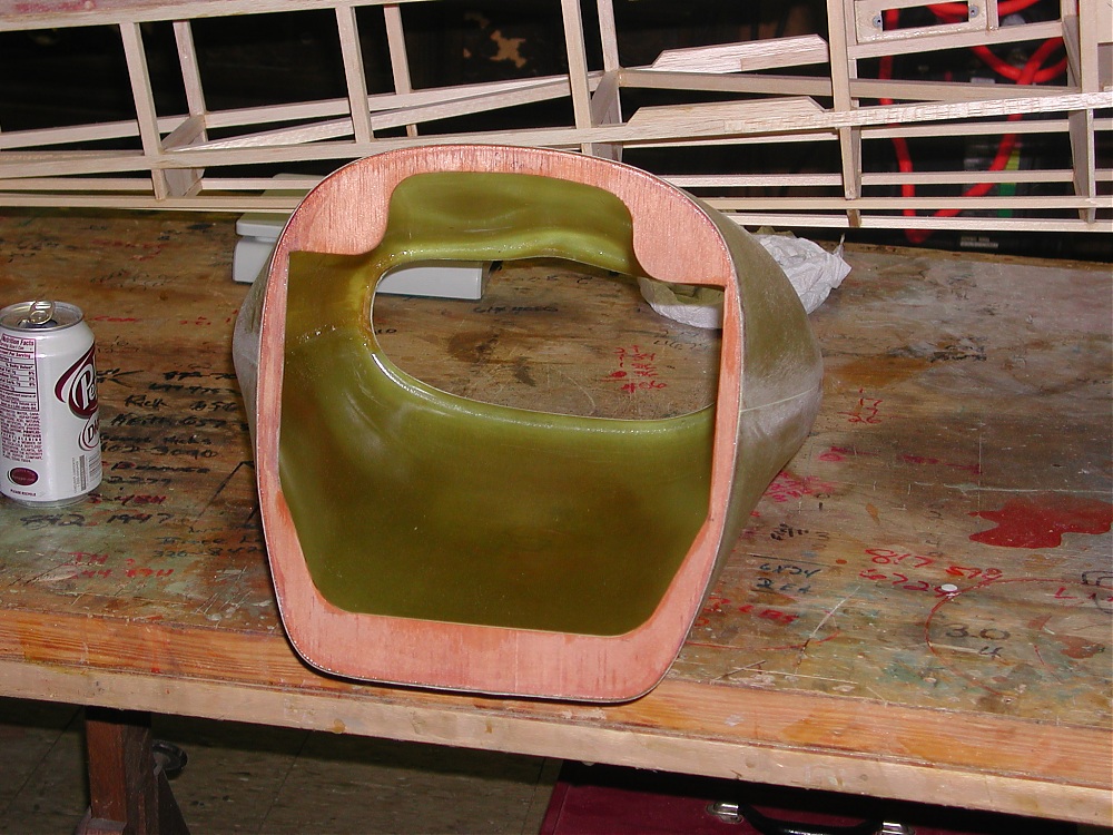

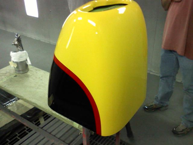

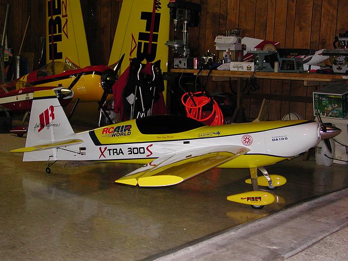

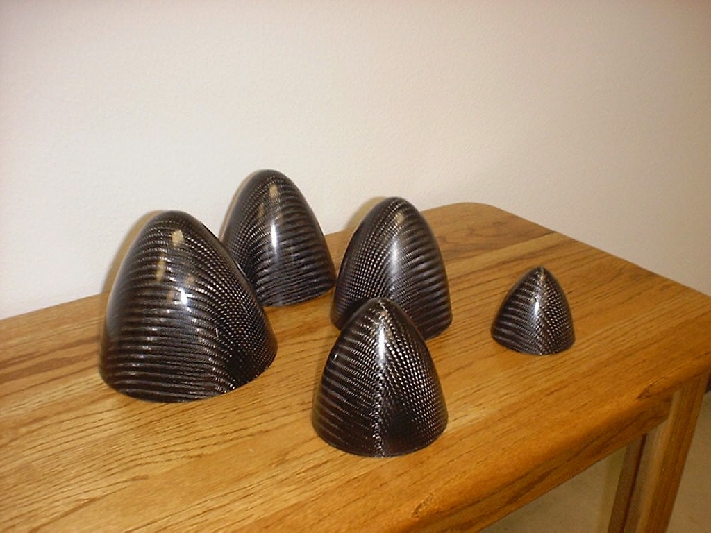

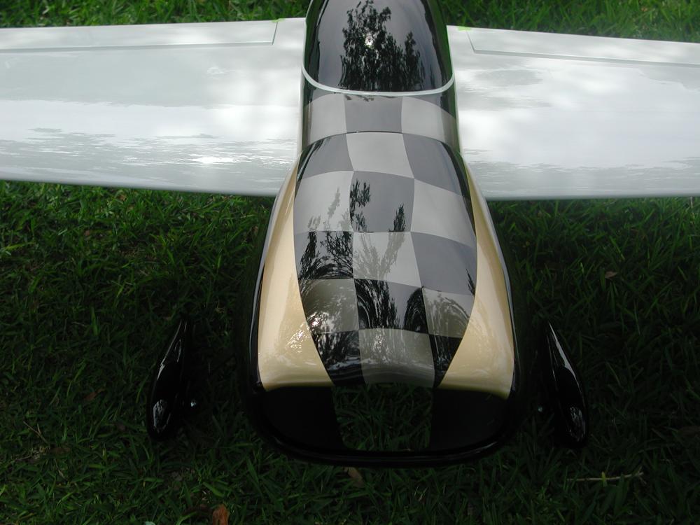

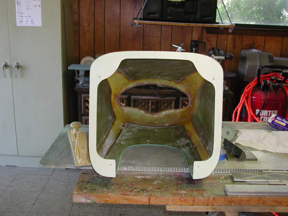

I have used this epoxy system in business and for models for nearly 25 years, it has a very low viscosity and a long pot life, it works well for laminating fiberglass, carbon fiber or laminating balsa sheeting on foam core wings as well. I am posting just a couple of projects using this epoxy system. The Extra 300 is a fiberglass and Nomex honeycomb fuselage with sheeted foam core wings and tail feathers and the red and yellow Cobra is an all carbon fiber and Nomex honeycomb airframe. There are two hardeners available, the 83 and the 84, I generally like to use the 84.
http://www.aircraftspruce.com/catalo...?clickkey=5667
Bob
