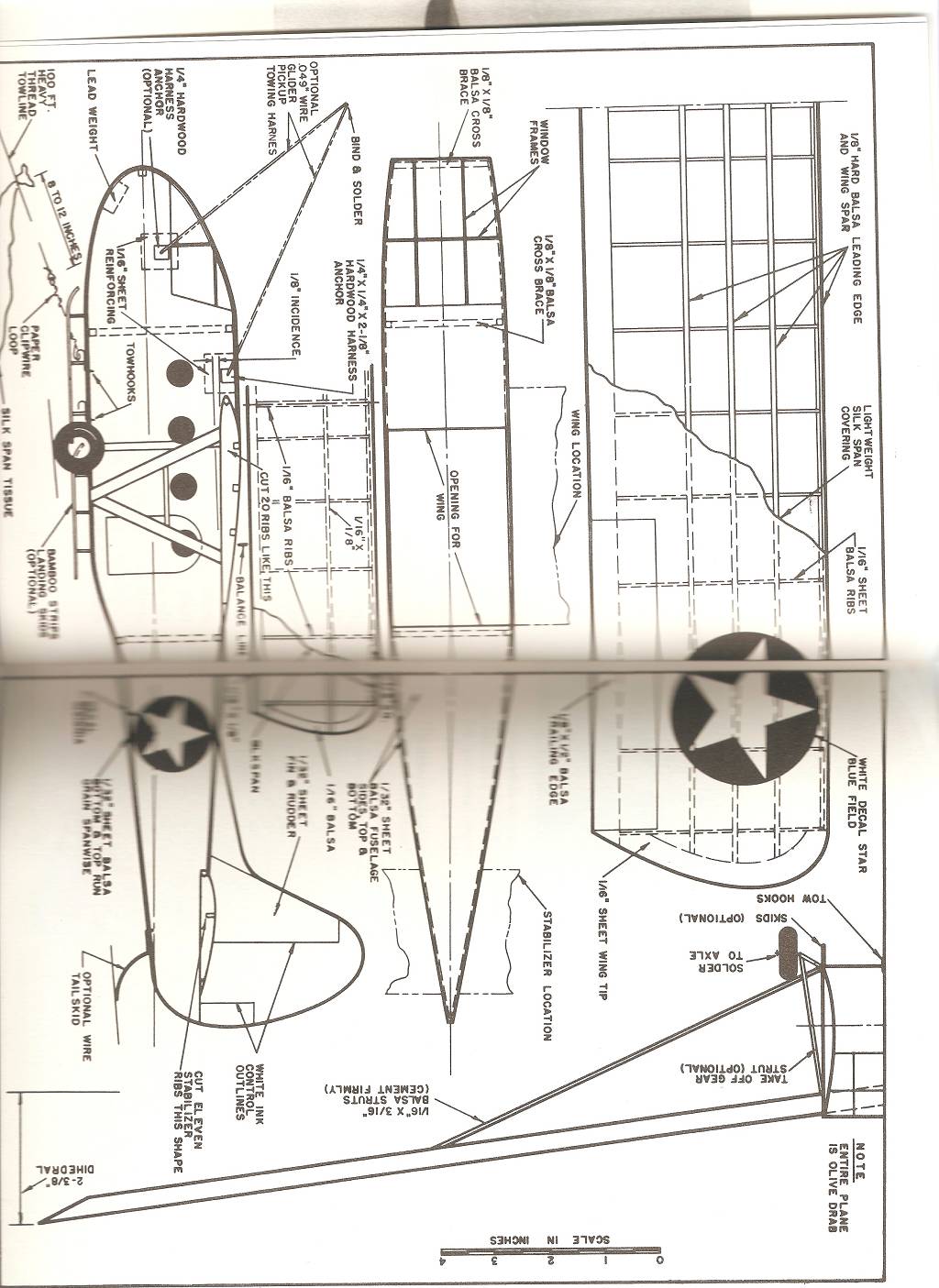

Ifound it!
Iwas sure I'd seen a treatise about flying a glider towed by a U-Control plane and it turns out it was in a book Iown and have had since the 60's. "Building and Flying Scale Model Aircraft" by Walter Musciano (of course) has a WACO CG-4A glider set up for pick up and tow. The book is still in print and can be had from Amazon.com for about $7.00 It's a great classic and should be on the modeler's shelf.
The model has a fuselage with sheet sides, bottom and top, wings with moderate dihedral and usual rib, leading and trailing edge construction. A trapeze affair over the nose and projecting forward provide the catch point for a hook trailed behind the tow plane.
I'd copy the plans, but I'm pretty sure I'd be busting some rules, just be assured that it has been done befort and worked.
The towed glider is just in trail, no pilot. Isuppose you could try to do it with two pilots...sorta captured combat style.

Would you be so kind as to scan the article and see what, if any, trim settings Walter suggests for the glider. How does he suggest keeping it in trail?
The dihedral has got to cause a roll when yawed, and left yaw is what the glider will see as soon as the towline tightens up.
Heck, maybe it stabilizes with the towline tangent to the circle or some other surprising result.

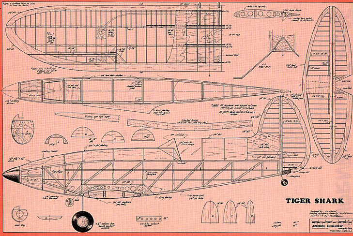

I'm saving that glider drawing, thanks for that.
With my software, I can scale drawings easily. I only need the outline to build, so I do a perimiter trace and enlarge the drawing to any scale. My cutting machine will hold a special pen. Acts like CAD.
I traced the Tiger Shark plans and enlarged them so I would have a 72" model. I used an Astro Hog wing but made many changes to it. This was for RC. I may CL it now.
I did have a Thread on the Tiger Shark, but the R/C guys didn't know much of it, or have real interest.

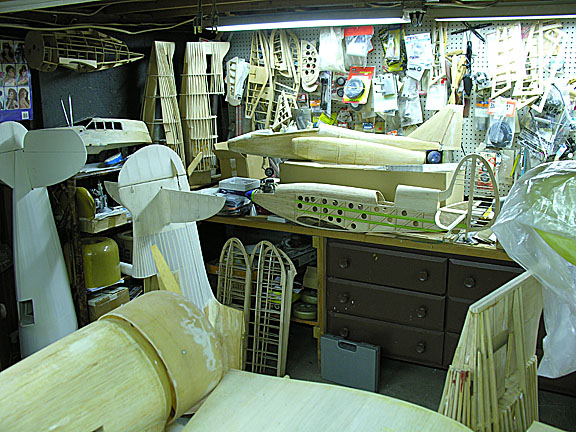

Here's a photo or two. You can see the Tiger Shark fuselage on my old bench.
Charles
I bought one of the Stanzell Tiger Shark kits that were original kits repackaged four or five years ago. Could not resist buying such and old kit from the orginal producer in new boxs and perfect condition for so little, it was a hugh attraction, could not resist.
On the plans in mine it shows the installation of the G line system and a fellow flying it with a bamboo pole. Also shows articulated rudder and elevator with a rubber band system to make them stay in place and remain adjustable.
