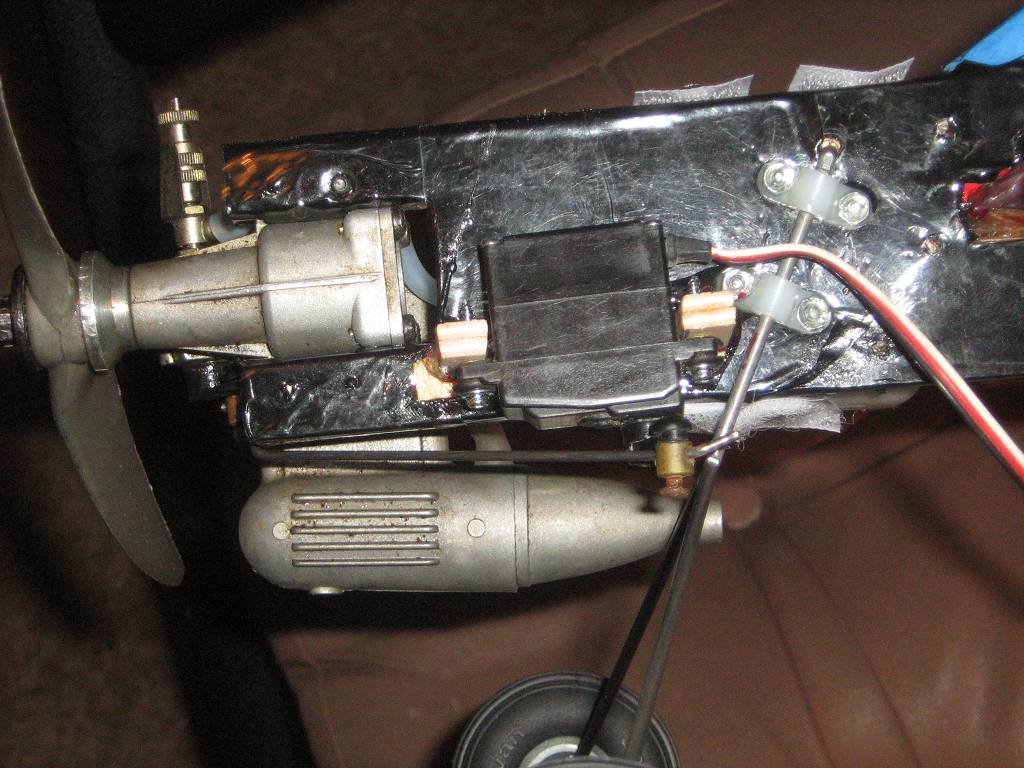

<div>I have been working on the radio and tank installation.</div><div></div><div>The tank is a 1 ounce clunk. There is a square of &frac14;&rdquo; rc foam between it and the fuse. It is secured with 2 Velcro straps. It is actually a very secure attachment to the plane. It is all plumbed up. Being on the inboard side of the engine It may richen out a bit in flight. We will see.</div><div></div><div>The rest of my build time and by far the biggest chunk of time was the radio installation. The throttle servo is right behind the engine and uses a short straight piece of small diameter piano wire straight to the throttle arm. The servo is not covered over, but I might do so if I can figure an easy way to do so. A plastic blister mght do the trick real nice if I can find on the correct size. I Might be able to mold one with a hot air gun. I have never tried to form plastic before.</div><div></div><div>The rest of the radio is going into a box on the bottom of the outside wing up against the fuse. I only have the battery and the rx (I toasted yesterday), The UBEC will also go in this box. There is a pad of &frac14;&rdquo; rc foam for the radio parts to lay on and will likewise be on the hatch to secure the parts. The servo and battery plugs sit high than the box cover so I cut a relief hole for them. I will see l if I can put a plastic bluster over the hole.</div><div></div><div>I have not yet decided if I am going to install a power switch or just plug and unplug the battery cable into the UBEC.</div><div></div><div>I have to cover the radio box to match the plane and I think I will just paint the servo mounts.</div><div></div><div>Also on the radio box cover I need to reinforce the corner with some fiber glass. It is just balsa.</div><div></div><div>One other note. The connector on the battery has to be changed out. I need to put a servo cable and a standard 2s balance connector on it. The local hobby shop cares the 2s balance leads but are out of stock at this time. I will also have to invest in a charge sack seeing as this is a LIPO battery.</div><div></div><div>On a side note, some of the old covering I used is already starting to peel. So I am going to have to address that issue.</div><div></div>Ken

A thought on your tank location. I tried this about 25 years ago and the engine ran real rich. I think the centrifugal force on the tank made the engine run rich, considering the engine is theoretically below the tank or downstream.

From: Orange, TX
Default RE: OS .10 Trainer
ORIGINAL: controlliner
Hicontrolliner
I have never tried this tank set up before, but your logic is correct. Just hoping it does not run to rich.
The throttle servo sort of needed the normal tank location. Also I needed that weight as far forward as I could get it. Should have made the nose a 1/2" or even an inch longer. When I dry fitted all the parts that engine location gave me the desired cg location. I failed to allow for the weight of the glue and covering.
If the tank location does cause a proplem I will just have to swap the servo and tank. No place else to put things on such a little bird.
I have seen some plane ser up this way so I thoght I would give it a try.
Ken

The inboard tank location works for rc, but won't for c/line unless you are running a pipe and need it very rich on the flight setting.

From: Orange, TX
The Velcro makes the tank an easy move. The servo move will take a little more work.
I figured it would run a bit richer.
Ken

<div><span style="font-size: 9pt;">Ok I moved the tank to the other side It just barely fits behind the engine. It was a piece of cake to do, although I did have to move the screws that hold the Velcro back a bit.</span></div><div></div><div><span style="font-size: 9pt;">And I got the throttle servo moved. I had to put a double bend in the push rod to get it to clear.</span></div><div></div><div><span style="font-size: 9pt;">The UBEC and new RX arrived. I set the jumper for 5 volts and hooked everything up after binding the unit. I had to use one of my LIFE batteries from a rc plane temporarily as the Li Po was not charged. Fact is I either got a dead battery or I wired something wrong adding the needed connectors. I had to replace the original connector wit a JST- XH and a Futaba male connector. Well After the wiring my charger would not go into Li Po mode, so either something is wrong or I really need to study up on the charger more. </span></div><div></div><div><span style="font-size: 9pt;">But with the big LIFE battery everything works. So I still have another hurdle to resolve.</span></div><div></div><div><span style="font-size: 9pt;">I did find this battery </span></div><div>http://www.hobbyking.com/hobbyking/s...arehouse_.html</div><div>It has the JST-XH balance lead just the wrong discharge plug. I can easily resolve that.</div><div>So again the radio weight goes up. I think now to 1.5 ounces. Sure would like to run a smaller servo. Just don&rsquo;t think the gears would survive the vibration of a glow engine. I think it might be worth exploring though. I will definitely build more CLs with 2.4. and would love to top out at about 1 ounce for the radio.</div><div></div>The UBEC will not fit in the Space I have behind the RX. I think I will mount it outside on the inboard side of the plane just forward of the bell crank. It will run a lot cooler mounted outside in the airflow and on the inboard side it will be out of most of the exhaust barf.
Ken

Ken, looks like you are on the way to producing a prototype for a larger airplane later, like a carrier plane.
Old 07-07-2013 | 04:00 PM
  #49
flyingagin's Avatar
Joined: Feb 2009
Posts: 2,547
Received 26 Likes on 24 Posts
From: Orange, TX
ORIGINAL: GallopingGhostler
Yeah the plane could be scaled up and a tail hook added. There is another channel available on the TX (presently have the pot unplugged). I intend to replace that pot with a switch later on. Maybe for smoke???? Or whatever.
This handle is a really crude hack on my part. Will look better with some paint on it.
I could likely cut the weight by 2 or 3 ounces.
But a better way to cut the handle weight would be to just have the throttle trigger and a switch on the handle and a jack to plug into it. Then make a arm band (upper arm) for the TX and battery. Now that would cut the heck out of the weight.
I am getting anxious to get this plane in the air. Heck I still have 3 RC planes to test fly.
Ken
