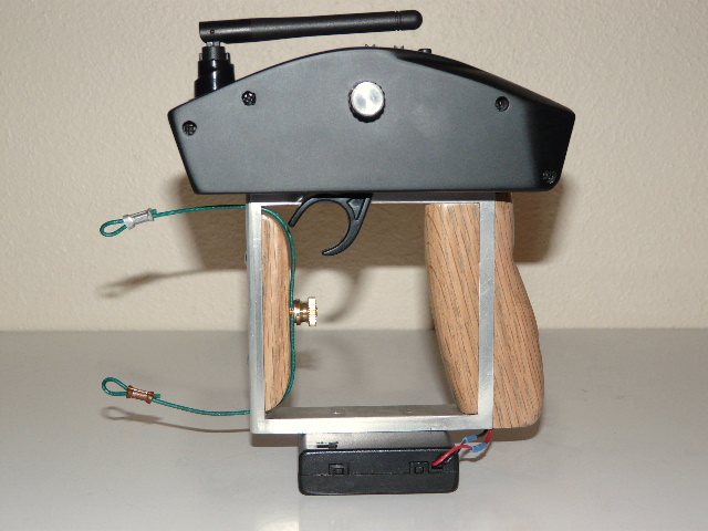

But I still have to make a handle. Sounds fast a simple, But I must be bain damage (breathed to much glow exaust maybe) as I never take the fast easy way.
I am going to mount a 2.4 TX on top of the handle with a romovable (quick change) line holder on front that will have adjustable line spacing and centering for the line. Yes 1 line that loops ftom top to bottom and back to the plane. the line holder front end will have the whole length of line (both up and down) from plane to handel. I am going with Spectra.

I am going to do something like this for the handle. But have the front (the line part) interchangeable for different line sets. I will just use a single line that loops through the handle front and thus 2 ends at the plane. It will be a hard point handle front end(s)<div></div><div>Ken

Nice looking solution there, Ken and neat work. Having throttle on it is a throwback to a friend's Testor P-26 with throttled .049 Wen Mac during the early 1970's. Had a third line on a ring slipped over the middle finger to control throttle.
Hi CG
I flew throttle set ups when I was young with a 3 line J Robert handle and bell crank. worked ok, And added that extra dimension of control, but also a lot of extra line drag and wight on the inboard side.
So this is kind of a throw back to that, but also a big step forward by getting rid of the extra line.
Sorry I did not mean to imply that the control handle pictured was mine. I found the pictures of that handle on another site and decided to file it future reference. I was just trying to show some thing of how I intend to make my handle. Again sorry for the confusion, I should have stated it was just a picture that I was going to emulate to a degree.
I apologize to any one I confused.
Ken

I used paint to show that I am going to make the front part of the handle removable. Quick change by using a uper and lower 1/4 20 stud and wing nuts along with a keying pin (so you can't put the lines on upside down) . That way one handle but indevidual line holders for each plane. Also at the end of fly I can just wrap the lines around the line holder for storage.
