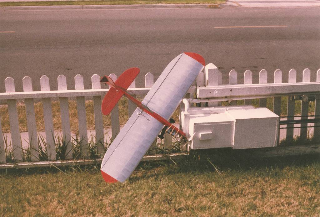

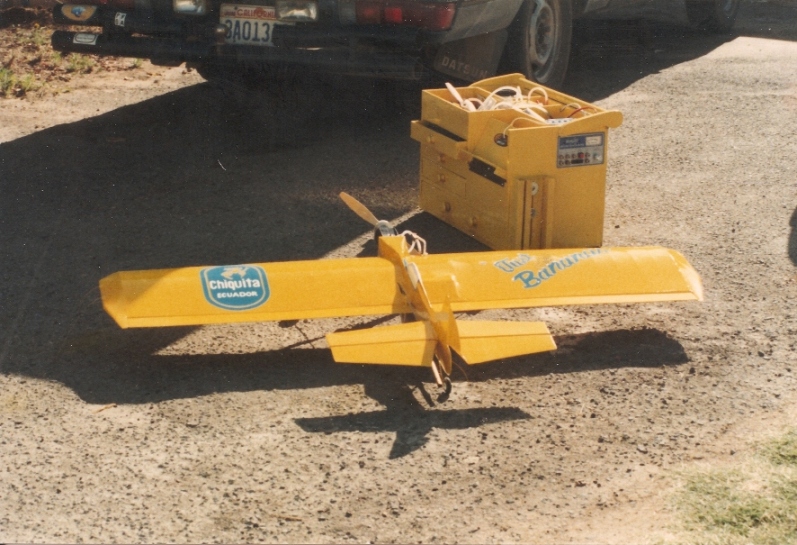

I built a bunch of .35 powered planes as a teen. I used Enyas back then. plain bushing baffle piston engines.
This is the only pic I have from then (Pic 1)

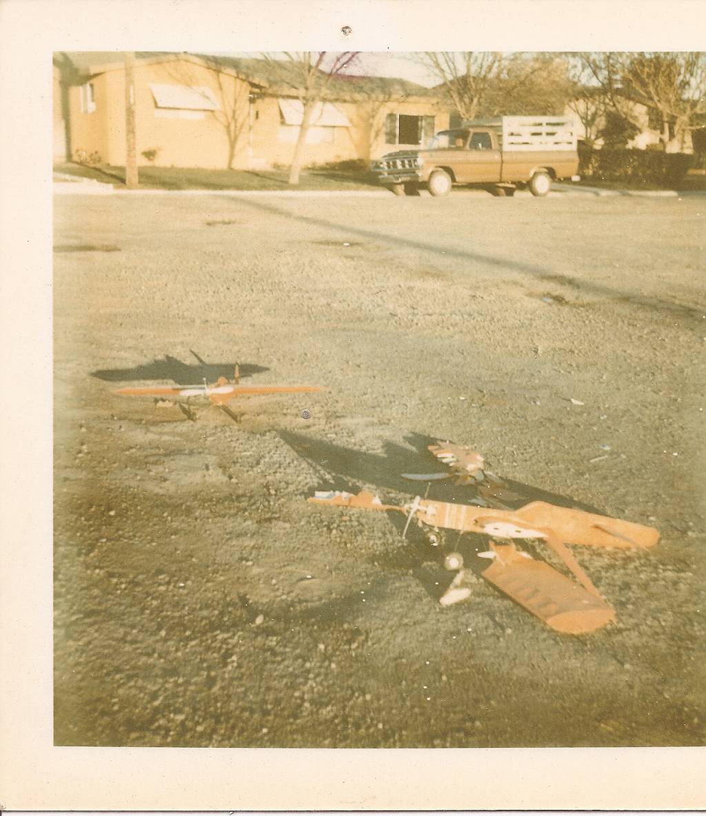

Speaking of .40 powered I built this one before "Just Bananas" another Magician From the same set of plans as the crashed in pic 1
Ken
Ken

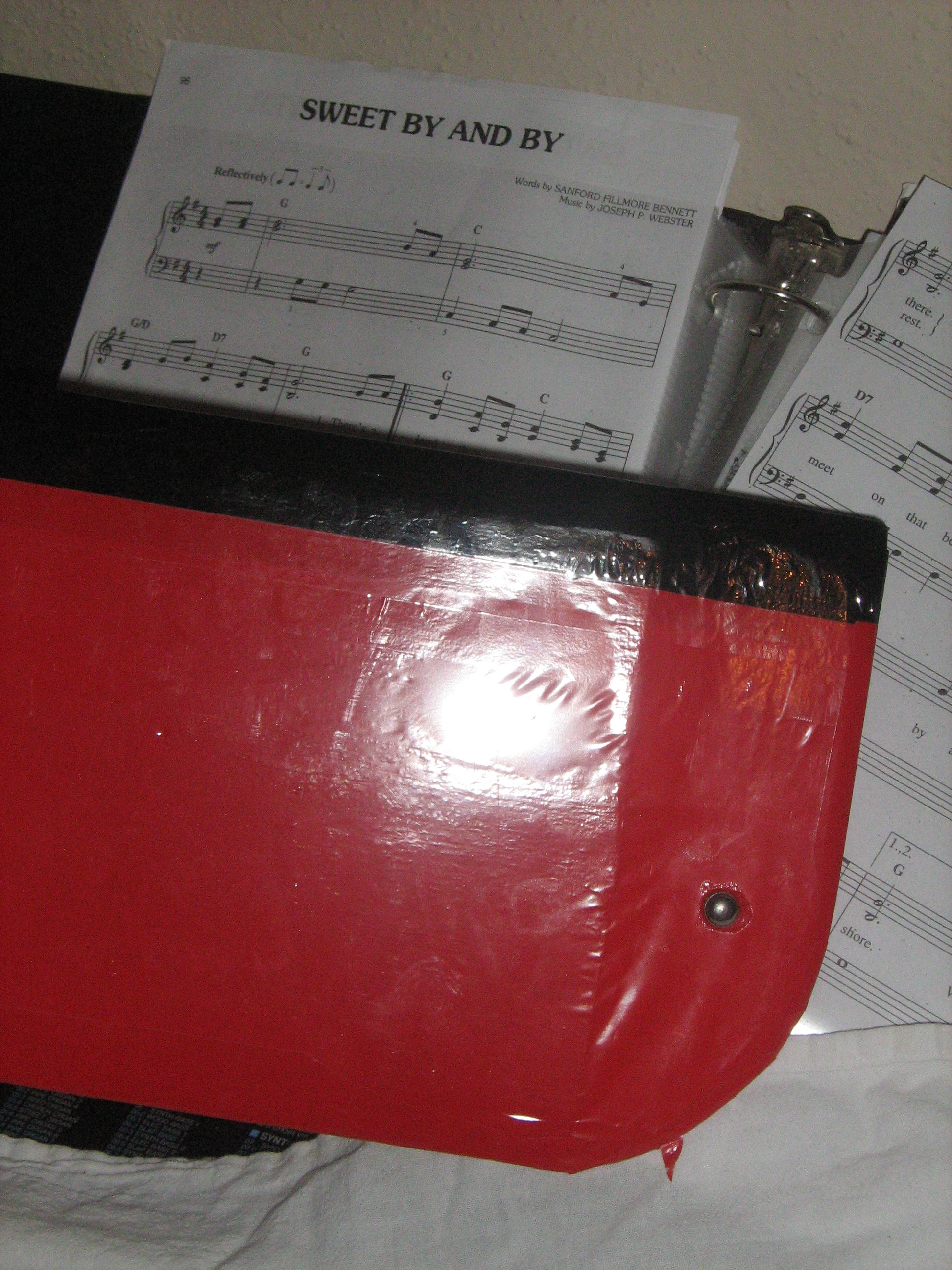

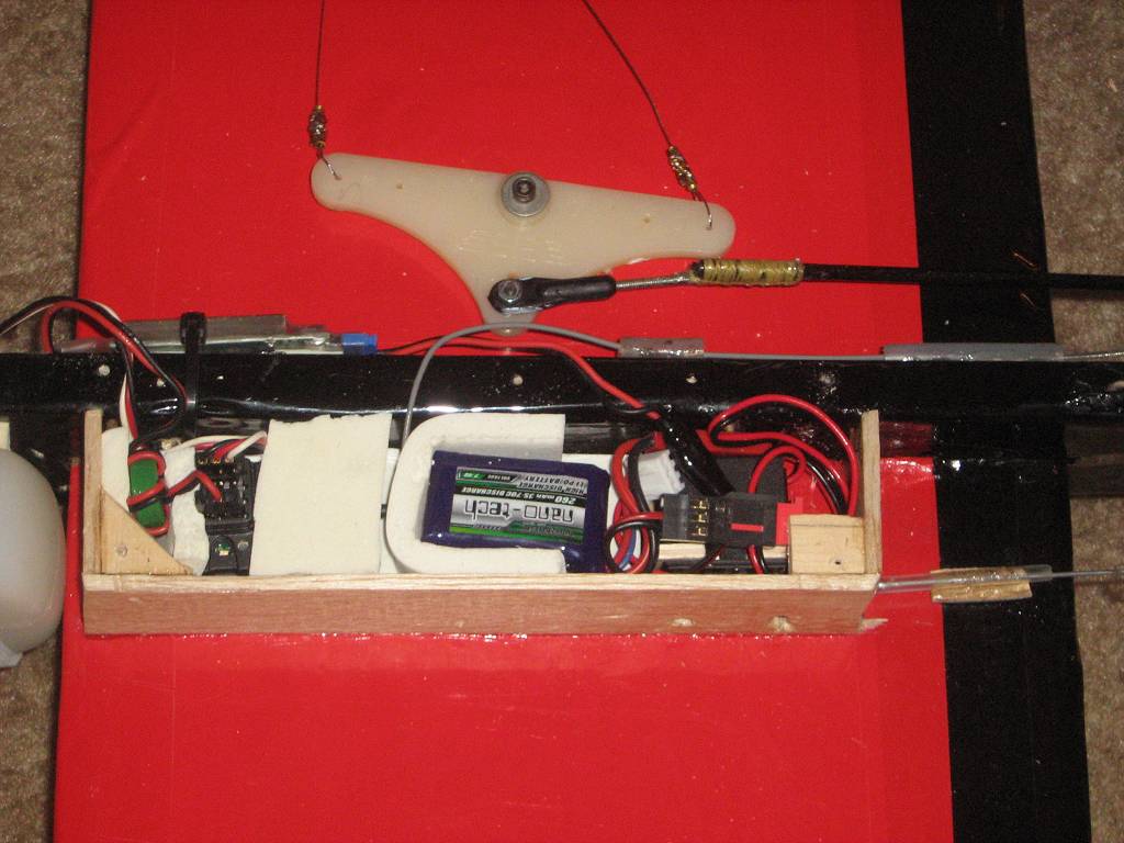

Ok I now consider the plane done. Maiden is the last thing required for the plane. I still have 3 holes to drill in the handle and build the line plate back stops. Then make up a line.<div></div><div>The radio box had to be covered. I had some more of the red Hobby Shack coat left. I just would not stick no matter what I tried. So heck with it I did the smart thing and gave up. I had some white Monocote and that worked like a charm. SO I have a white radio box. I don’t care I am done. I don’t expect the Hobby shack film to stick to the rest of the plane very long any way.</div><div></div><div>So now to finish the handle. And then some flying.
I will try to get some in flight pictures and some video.</div><div></div><div>Ken</div>

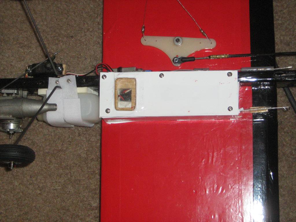

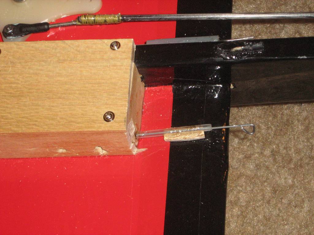

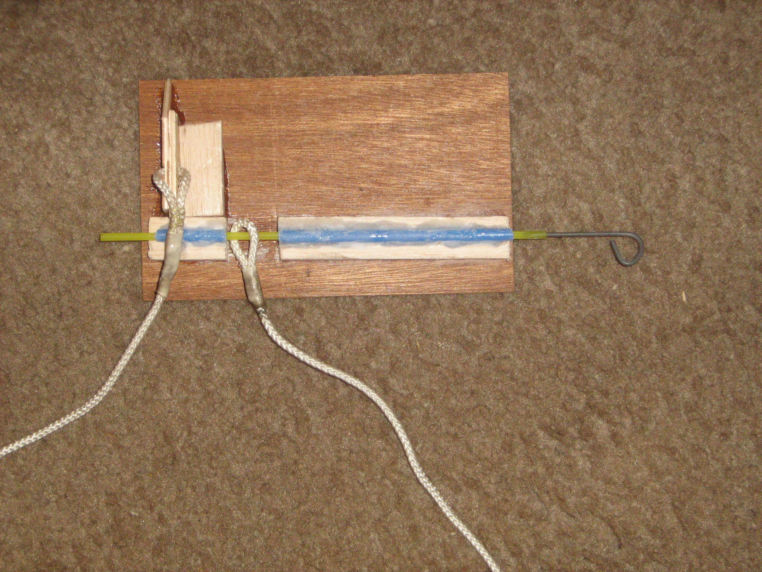

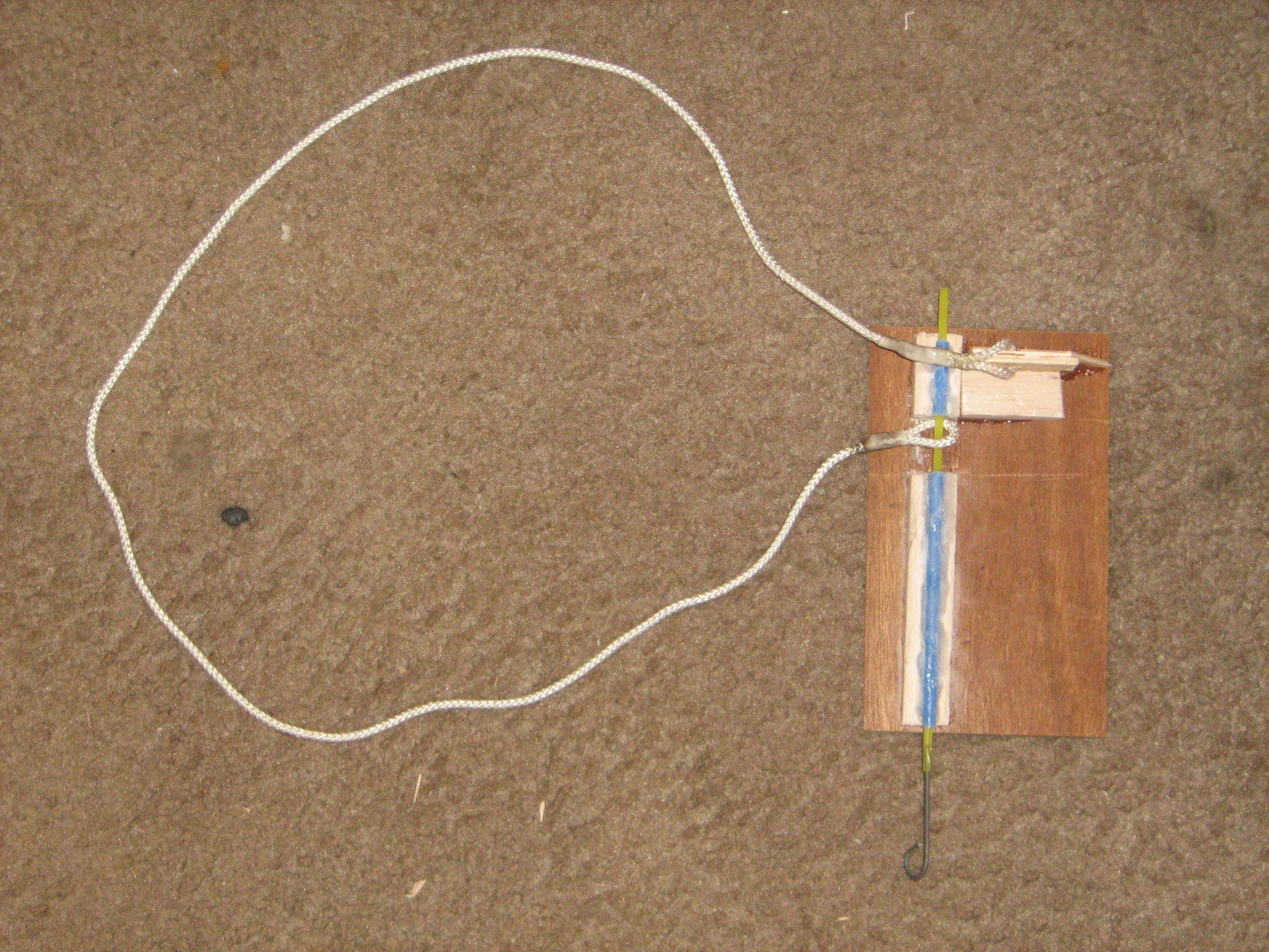

I was a set to test fly this morning. I had added tip wight, engine offset. I had made up a set of lines with spectra multi strand 30# test. Technically I made one line (about 90') since it loops through the line plate effectively giving me a set of 45" lines.
Learning to tie the 5 turn uni knot was frustrating. I got a nice loop in one line (much desired) and the other knot cinched all the way down. I think I need a form (dowel) to get it to make a nice loop (to facilitate removing and adding line clips).
The only thing that I need to do is neutralize the lines. Can't do that in the apartment. That only involves loosening the clamping bolt (nylon 1/4 20 RC wing bolt) pulling the lines till the elevator and handle are level and then tighten the bolt.
My wife is scare to hold planes with the motor running, so I need a stooge. I made one up that uses a piece of small diameter rope (maybe 1/8") with two loops. One loop is permanently fastened to the stooge and the other is retained by a sliding rod (ny rod yellow inner).
I wanted to make sure the release loop did not get hung up on the plane. So I did not tie a knot in it. I formed a loop and then secured the loop by wrapping some Kevlar thread (1/2A fling line) around the end. I then put some heat shrink over the end. Makes for a nice smooth loop end with nothing to catch and hang upon the plane.
Well I awoke to the sound of thunder this morning so I just rolled over. A little later it was pouring down, about the time I had planned to be at the site I was going to fly at. I had been scouting out possible flying sites for awhile now and found a dirt parking lot in an industrial area about 8 miles down the road I live on. It is rarely used during work days and then only as a staging area, and never ever on weekends. It is not fenced or posted or marked in any way. Noise will not be a problem.
Here are some pictures of my stooge. It is just some Ny Rod blue outer and yellow inner with a 2/56 rod in one bent into a loop for the pull string. The base is a piece of 1/8" ply door skin that I fasten to my starter box with a spring clamp. Not very heavy duty but should hand up to maybe a .25 or .35 powered plane. I can beef it up by adding a peice of music wire inside the yellow inner and fiber glassing over the blue outer.
So I hope to test fly next Saturday.
Ken

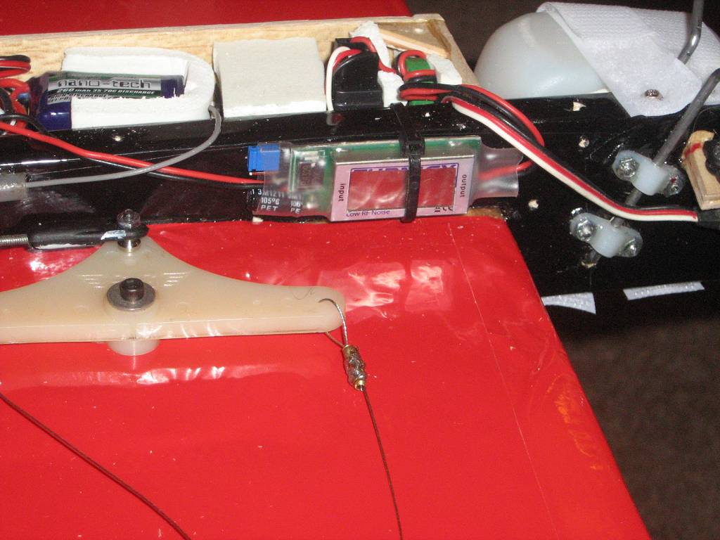

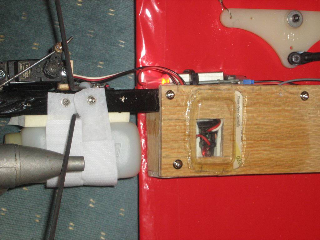

I sorted out my fuel system. I rebuilt the tank. The two brass tubes now make 90 degree bends immediately out of the tank, so the lines clear the engine, no rubbing.
I started the engine on the patio and adjust the hs needle. The idle air bleed screw needs to back out a bit. And the plug is no good. Will only run with the igniter attached. This engine last ran in the nose of a power glider back around 95.
I hope to try to fly again next Saturday.
Ken

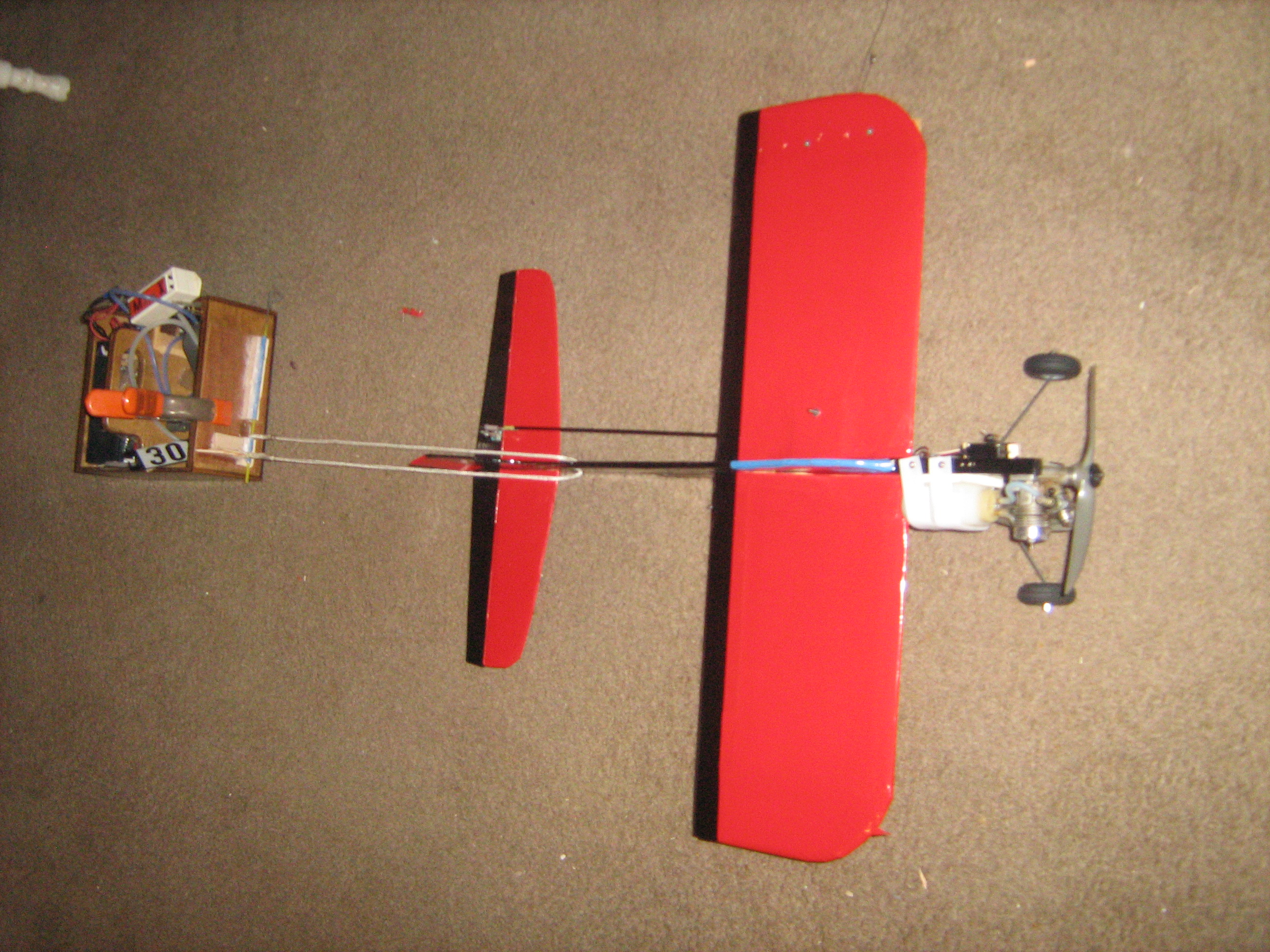

On the ground; When does the Barfing start, but Maiden successful.
Got the test flight in today. I was out by myself, flying buddy did not show. So it was a good chance to test the stooge. Worked like a champ. Perfect releases. The restraining line slipped off smooth as silk.
Had some problems with throttle rod not being adjusted properly. I was able to adjust that with the few tools I had with me, i.e. needle nose pliers. My 20 + year old igniter (nicad) died, but I used my panel supply by the 12v starter battery to light the plug.
I failed to hydrate properly before leaving the house, just coffee, had not drank a drop of water. I was sweating like a pig and dripping by the time I got my lines out and set up. heart rate and respiration up to much. To stubborn to slow down and rest awhile.
First 2 or three attempts to take off ended up not enough concrete runway area and ran into the grass at the end and just sat there. So I kept changing my angles in relation to the available concrete till I had enough run room. I was trying to stand in such a position that I would not wit the Light pole that was there when I came around. Also I had to avoid the concrete parking blocks. With out a helper it was just trial and error. And the most important thing I did not want to hit was my own car!!!!!!
Own the the 3rd or 4rth try I got airborne. Was almost surprised, but I quickly back peddled to insure enough room before coming around.
Now the actual flight report.
#2 The airplane yawed outwards like crazy on take off rolls, increasing the take off roll.
After the first lap I noticed I had significant line tension, much more than I expected for such a small plane. It was yawed out more than needed in level flight. Remedy reduce the engine offset and the move lead out guide forward.
#3 At full throttle the airplane was hunting up and down, maybe 5' up and down excursions. Manageable, but uncomfortable. At around half throttle the hunting almost completely stopped. So that is were I spent most of my flight time.
#4 I counted my lap times with the one thousand and one, one thousand and two method, and at 1/2 throttle I was getting 8 second laps. At full song I was counting about 6 second laps.
#5 At full song and a maybe 3 or 4 minutes into the flight I explored the control response with some full up elevator. Slow and no were near enough elevator. I will move the elevator ball link in all the way.
#6 When I could tell the that I was just about out of fuel. I went to full throttle and waited. cut out about two laps later. Ran out of up elevator on the glide down so landing was a bit nose down. No damage.
now #1 I was not properly prepared for physically for this little adventure. insufficient hydration, over heated before I even got the engine started. Wearing my back brace helped with my back but also was even hotter.
I started to get dizzy pretty quick, but stuck it out. As soon as the plane was on the ground so was I. Went to my knees, and then onto my back. The world was spinning, I was real nauseous and just hoping I could manage roll to my side if I started barfing. I was actually a little scared at that point that I would throw up and be unable to clear my breathing. My wife has informed me I will never be out like that by myself again. She will go next time, incase a flying buddy does not show She can at least call 911.
Biggest mistake was trying this with no else there.
But you know what It was fun. I will try again. This was my first CL flight in about 20 years.
