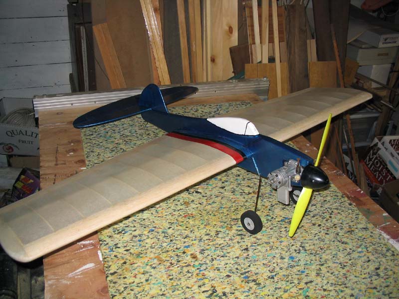

Nice choice of colors. Here's mine (without tank). Fox .35 with tongue muffler, adjustable tip weight and line spacing, Lite wheels.
George

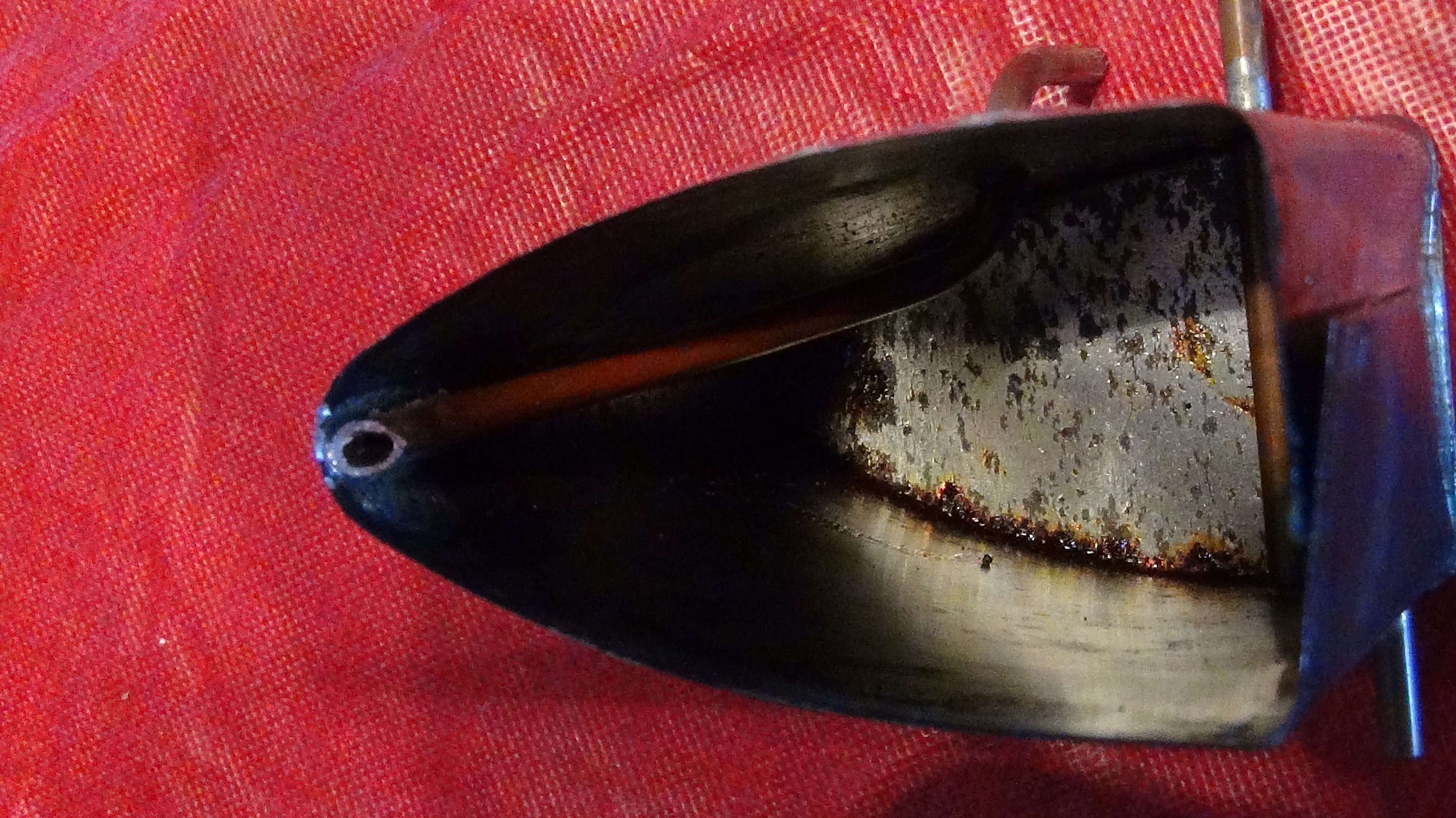

Hi guys, I started this thead back in May but RCU changed something and I couldn't get on with Firefox. Then here lately I descovered that Windows Explorer can work and I even have an old account.
Well I flew the Ringmaster some duering the summer but the engine starves for fuel when it go's negitive "G". Kind of gets old just flying level and inside loops. Last time I flew it was running good so I tryed a figure 8 and it quit going up the back side. It slacked out but to my surprize it glided wings level untill the lines draged on the ground and only broke the prop. Well these type tanks used to work before so I took the back off this one and the out let was up aginst the end of the tank. So I ground a V in the end of the tube. It is to cold and windy to try it now but I am looking foward to trying it in the spring.

Looks like you solved a fuel feed problem. Regarding Firefox, don't know what issues or versions are you using. I've been using it for a while and haven't experienced the problems you seem to be having. Are you running the latest version?

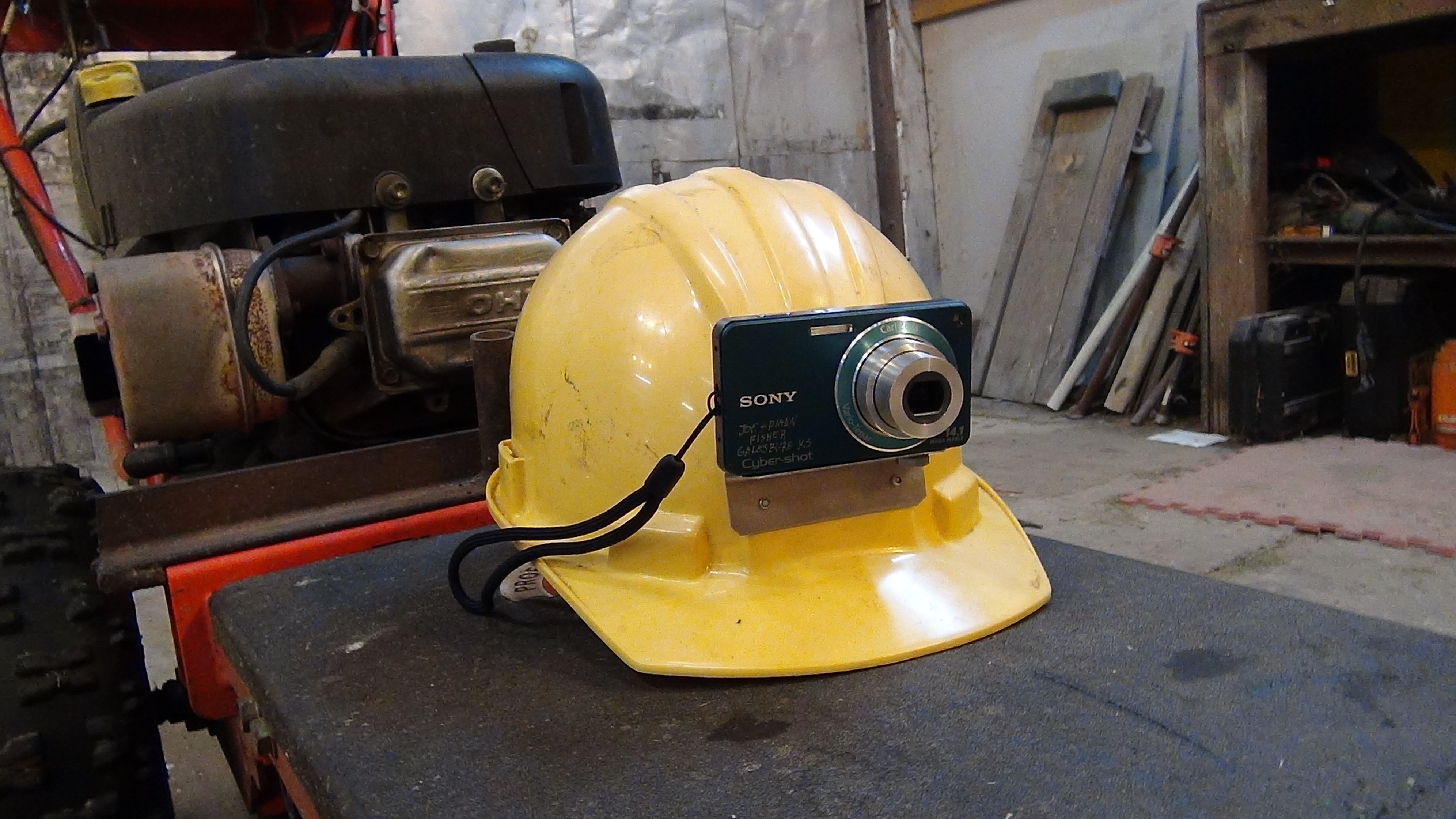

What camera did you use to record this and how/where did you mount it? I assume your cap. Nice video....

Sony camera on a hard hat ....from the post in Old Timers Look Here... just saw the Yellow Bird flight. Question answered.

The camera is a Sony DSC-W350 Cyber-shot. The bracket is pop riveted to the hat.

Thank you for the photo. Neat way to do it.
