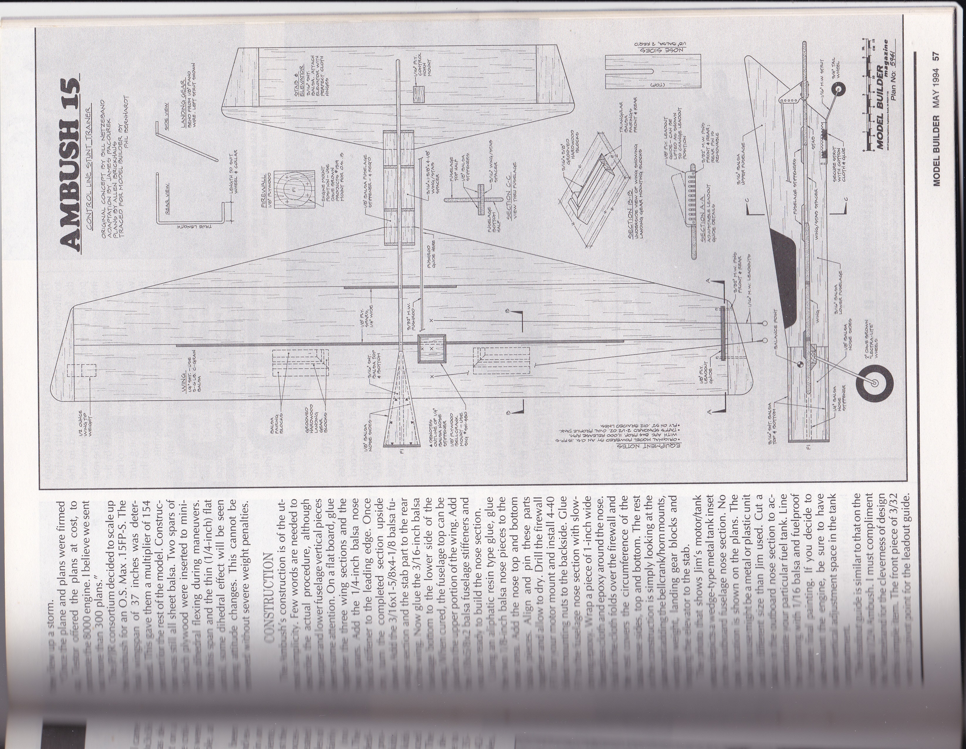

I was just thinking about a plan from Model Builder 1994, Ambush .15 All 1/4" sheet balsa, 37" span. It may be a little big or heavy for an old .099, but could be made with 3/16" or FFF foam or something. I could maybe scan it if you are interested.

I couldn't find the Winjeel real quick like, so I will put the Ambush in. I would personally not use a plastic motor mount, but the conventional maple and plywood engine bearers. There are more pages of instructions, but it is pretty basic, and a lot of it is the history of the .049 size one.

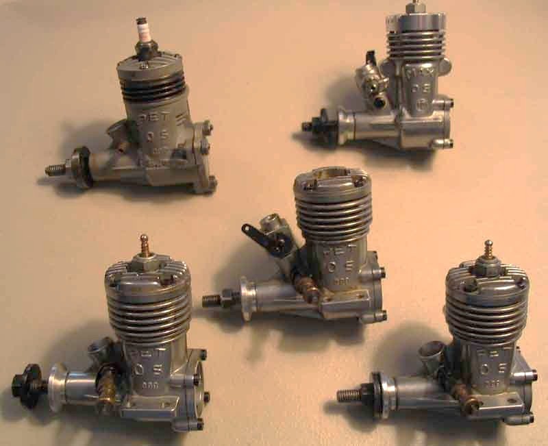

The first Pet .09's came out about ~1958 and had steel cylinder & fins and a smooth top aluminum head. The cylinder was held on with two screws, fore and aft.
The next iteration had four screws.
I believe the next one was the Pet-II.
The next version has a drop-in liner. All ran well in their day.
For a few bucks more you could get an OS .10 which was a notch better. I think the first Pets were ~$4.95.
Here is a pic with a Pet-II with the engine mounts cut off (before I got it)...note the Champion glow plug in the upper left. Upper right is an OS .10. The three on the bottom are the final versions with the drop-in liner. They are baffled engines but you must remove the head to see it because they have a step-down baffle.
If you are looking for a kit plane, a Flying Clown from Brodak or a SIG Akromaster (if you can get one) would do nicely. Fly on 42' x .012 lines and use 15%-25% nitro fuel. As someone mentioned, if you use RC fuel add enough castor to have 20%-22% lube. Since it has already been run I would suggest all-castor lube.

I think I used as little as 5% up to ~15%. Don't remember using 25% for a Pet .099 back then. I think I propped it with a 7x4. I think I used a 7x6 also but that is a lot of prop for that engine. I would start with the 7x4 and 20% lube. Try different nitro contents and see what works for YOU.
Good luck with it.
