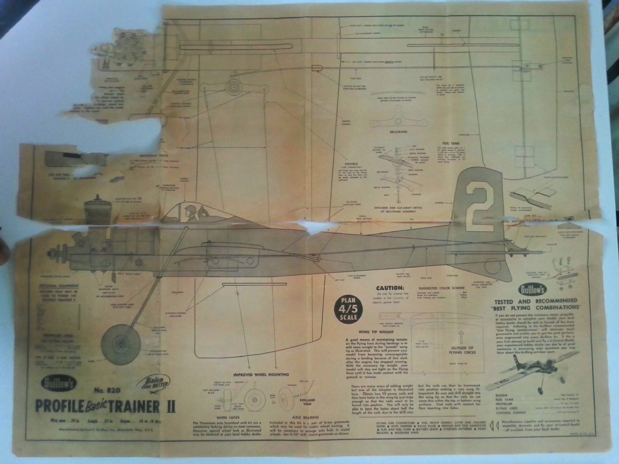

I found that plan. After much experimentation on tile % I was able to print out and tape together a useable copy. The plan states hardwood for mount but I wondered about pine. Now I know pine will work.
Old 11-12-2014 | 11:34 AM
  #27
Joined: Nov 2005
Posts: 167
From: Lincoln, NE

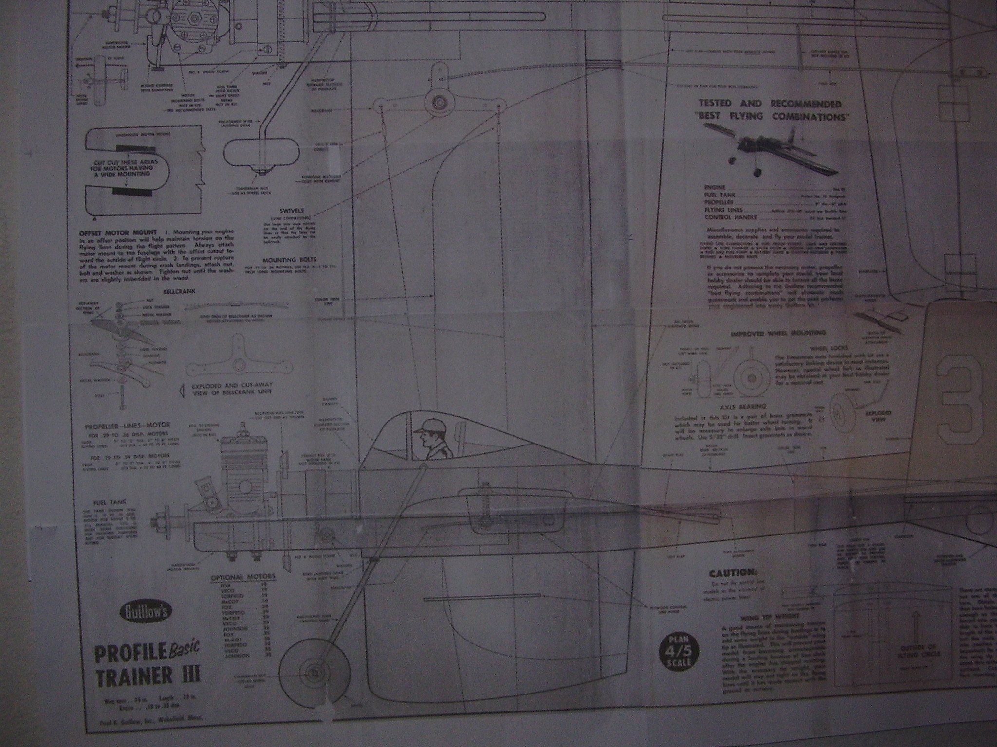

This is the #3.

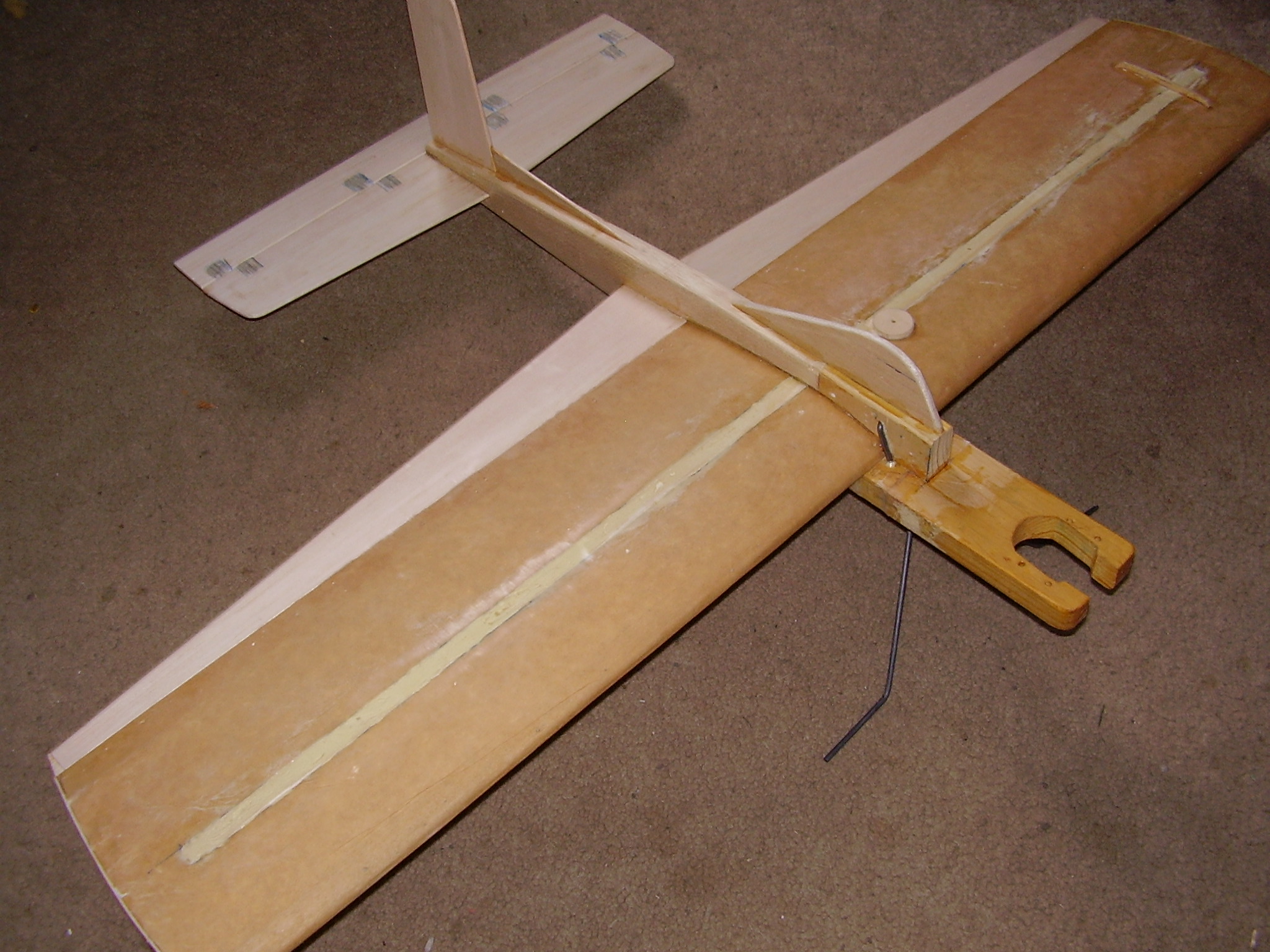

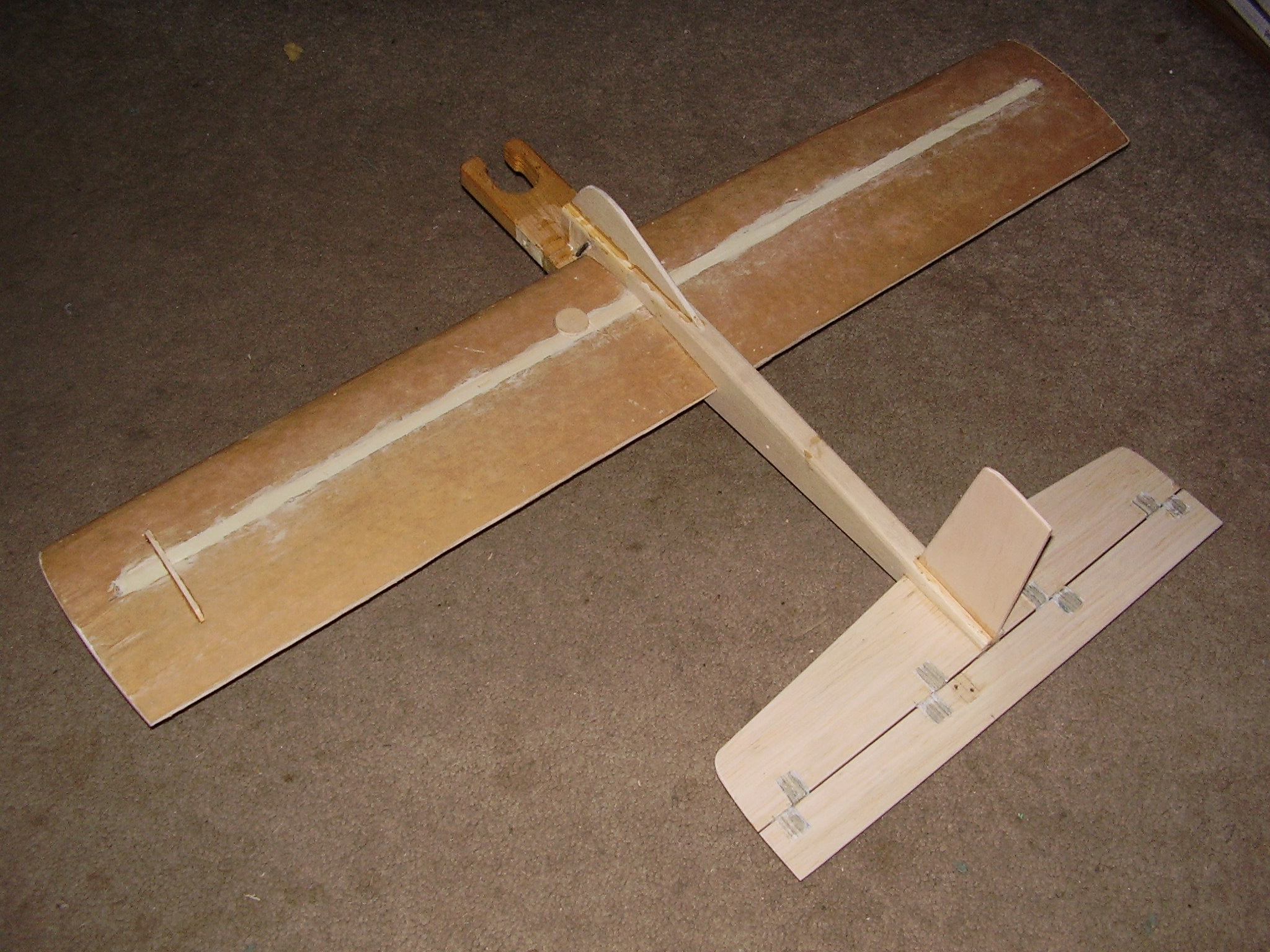

Old 11-14-2014 | 10:21 AM
  #31
Joined: Nov 2005
Posts: 167
From: Lincoln, NE
Here are a couple of pics. of the progress on my Ringmaster. When Harry Williamson designed this way back in 1947 he probably could never have imagined that someone would build it in 2014. It's such a wonderful thing that all these plans have been preserved on the net. Maybe someone will build it in 2064.

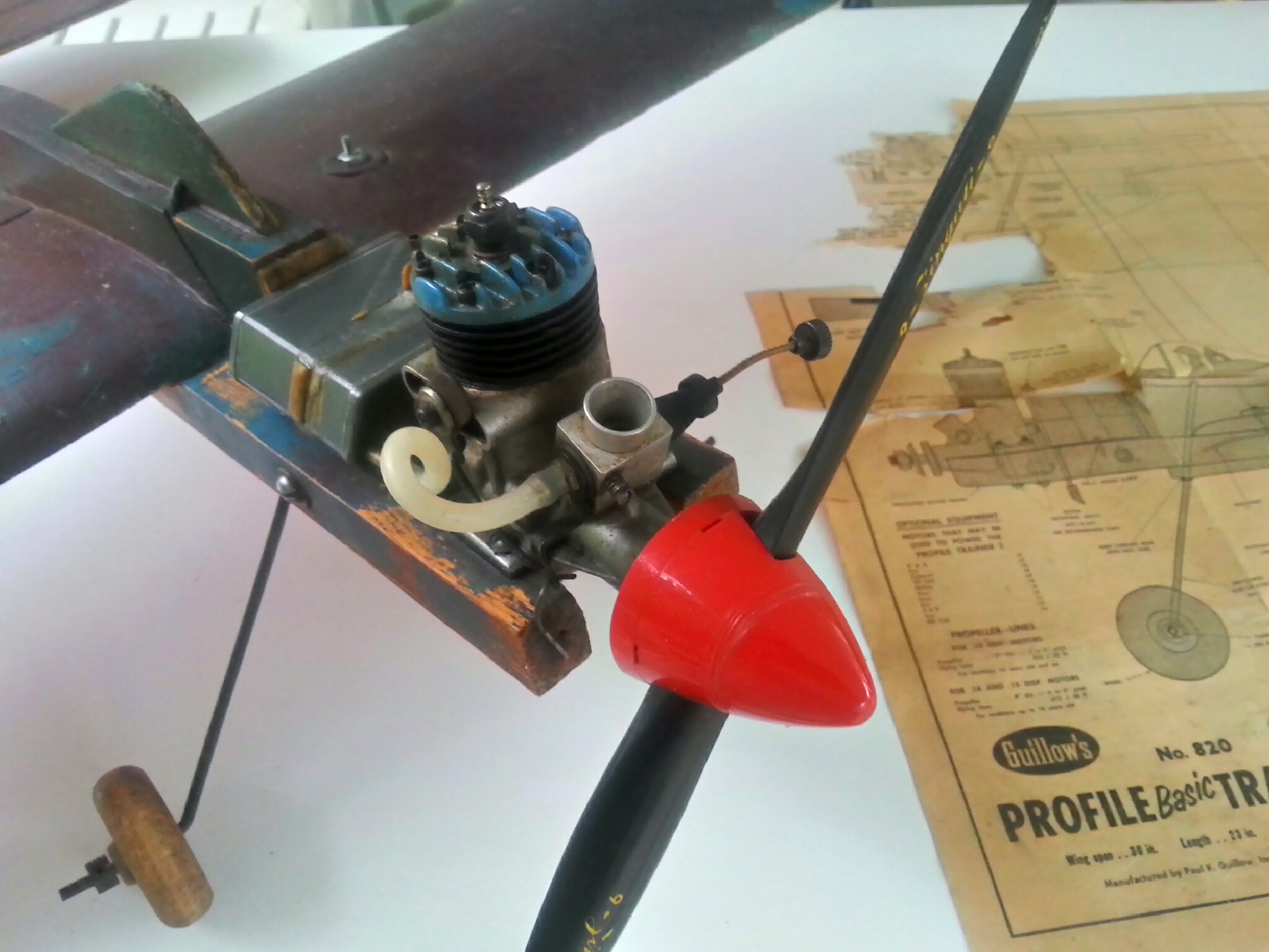

Old 11-23-2014 | 03:33 PM
  #39
BrightGarden's Avatar
Joined: Jun 2014
Posts: 283
From: Hudson Valley. New York. USA

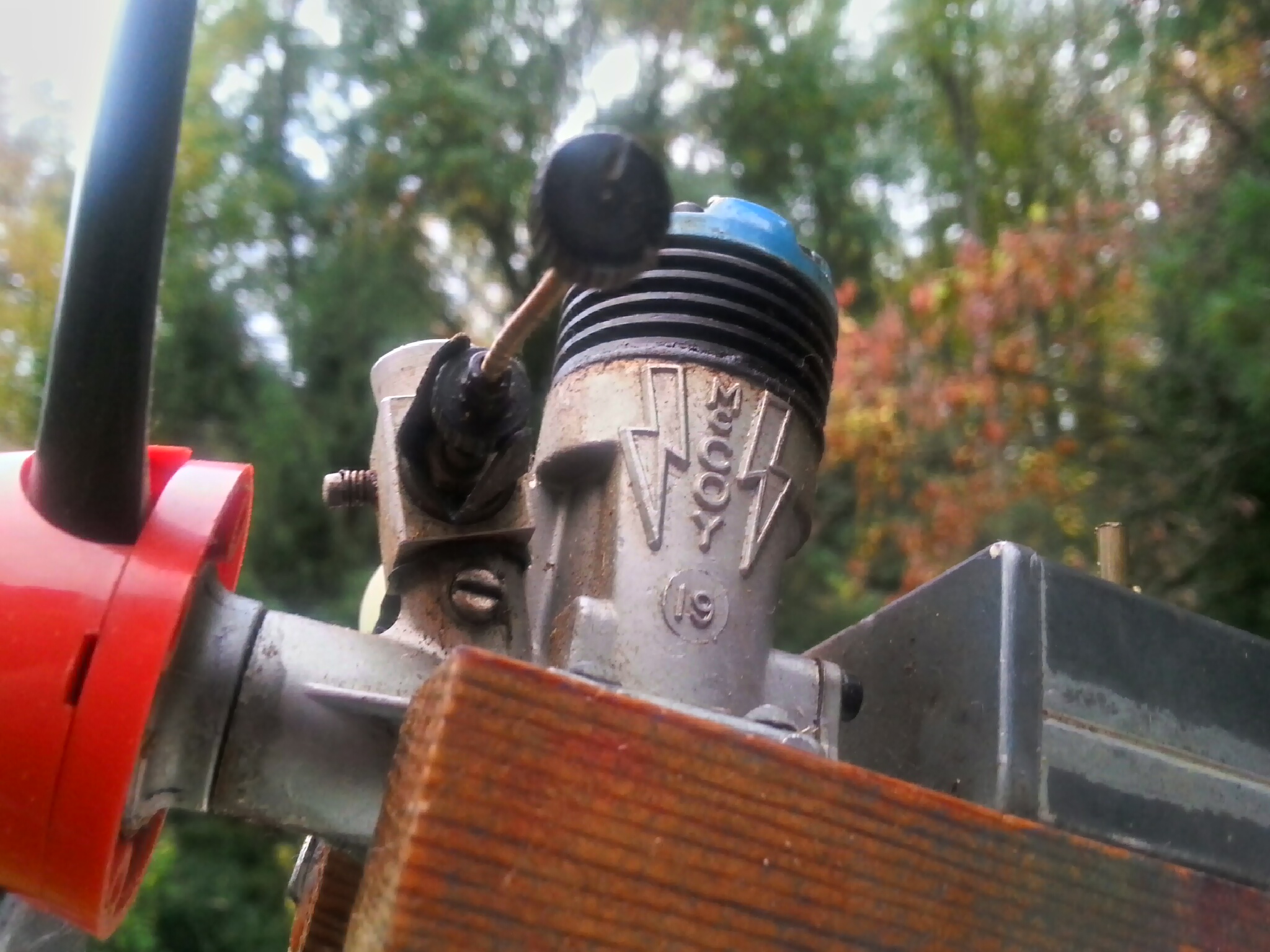

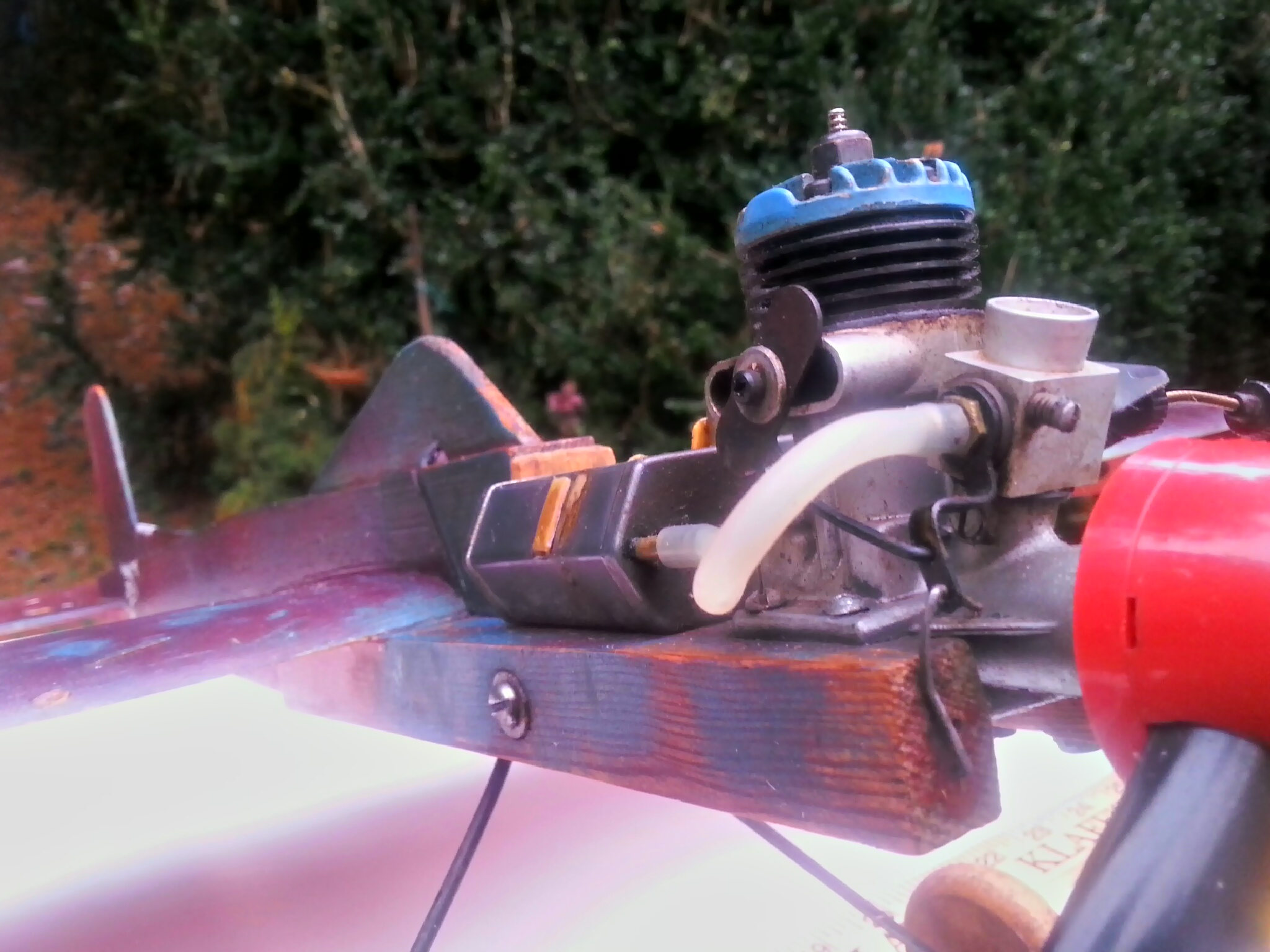

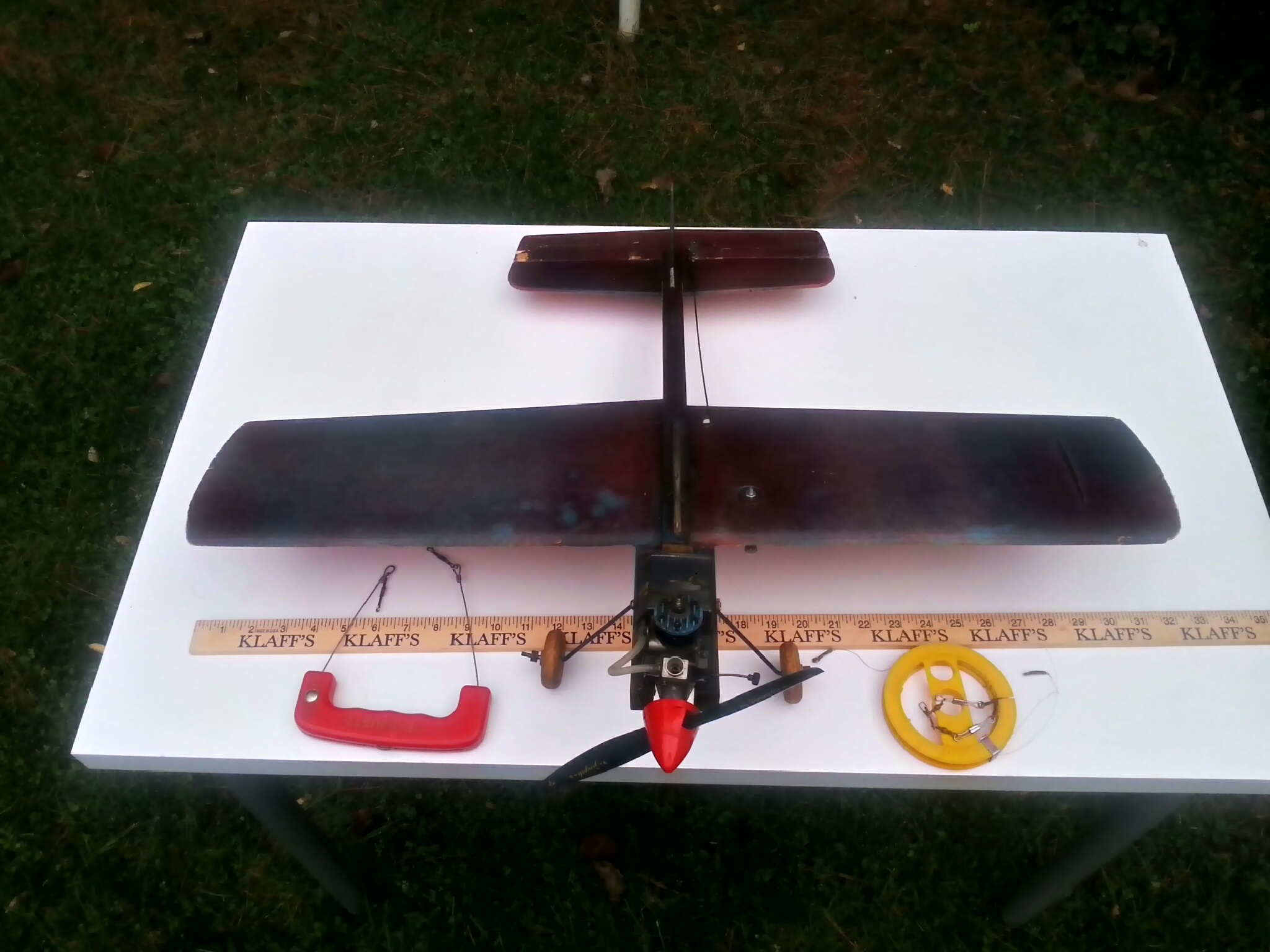

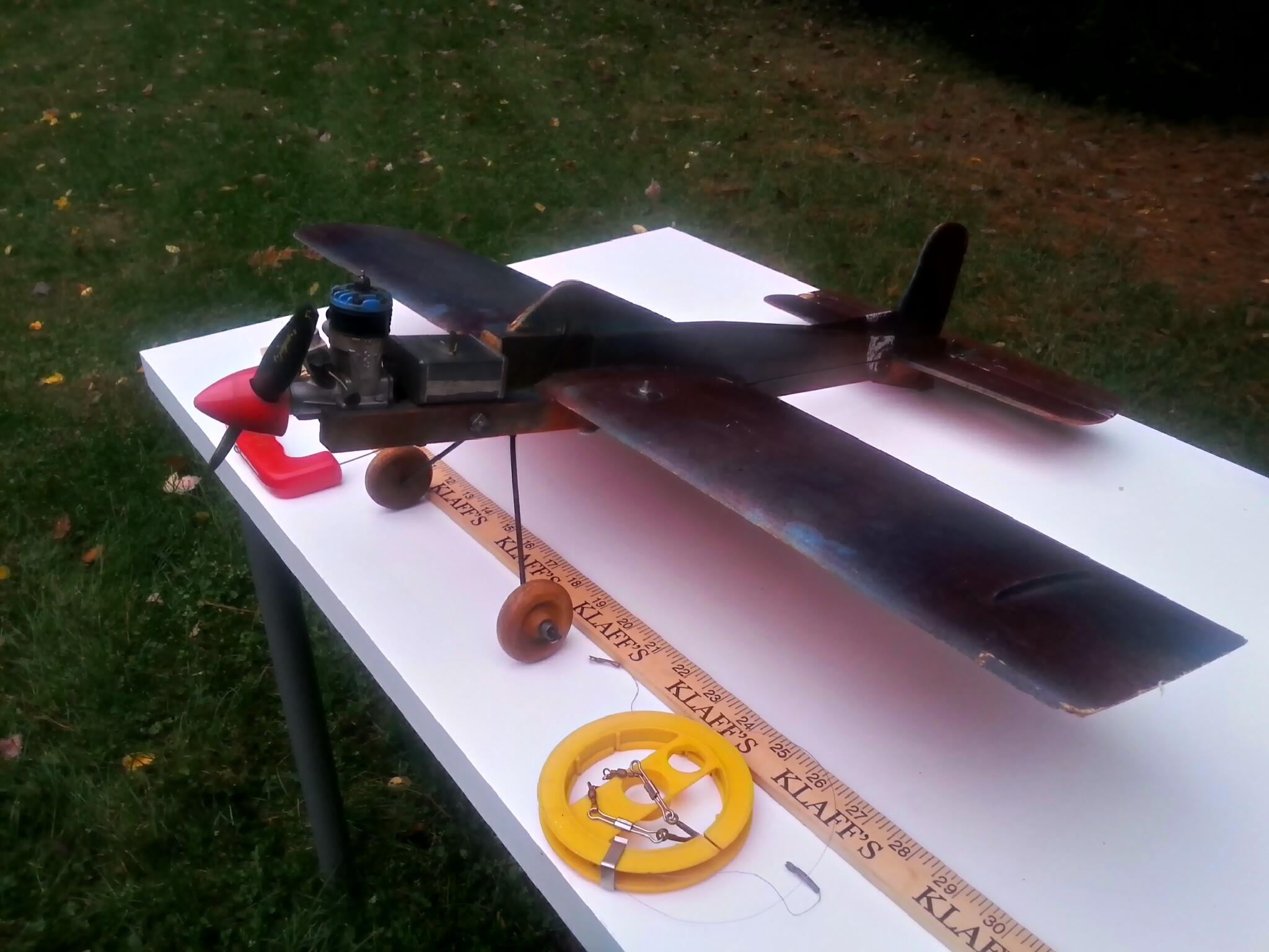

Great Thread. I picked up a #2 in a lot sale, bought it from a genuine NASA engineer, so it has to be good. If anyone wants me to take dimensions and post a digital file from the tattered original plans. The plans were not in good enough shape to meet Outerzone standards, I think.
My #2 has a McCoy Blue Head .19, looks to be in good condition - carburetor RC model with exhaust baffle.
Wood finished in the finest deck stain, I think.
Cheers,
Peter

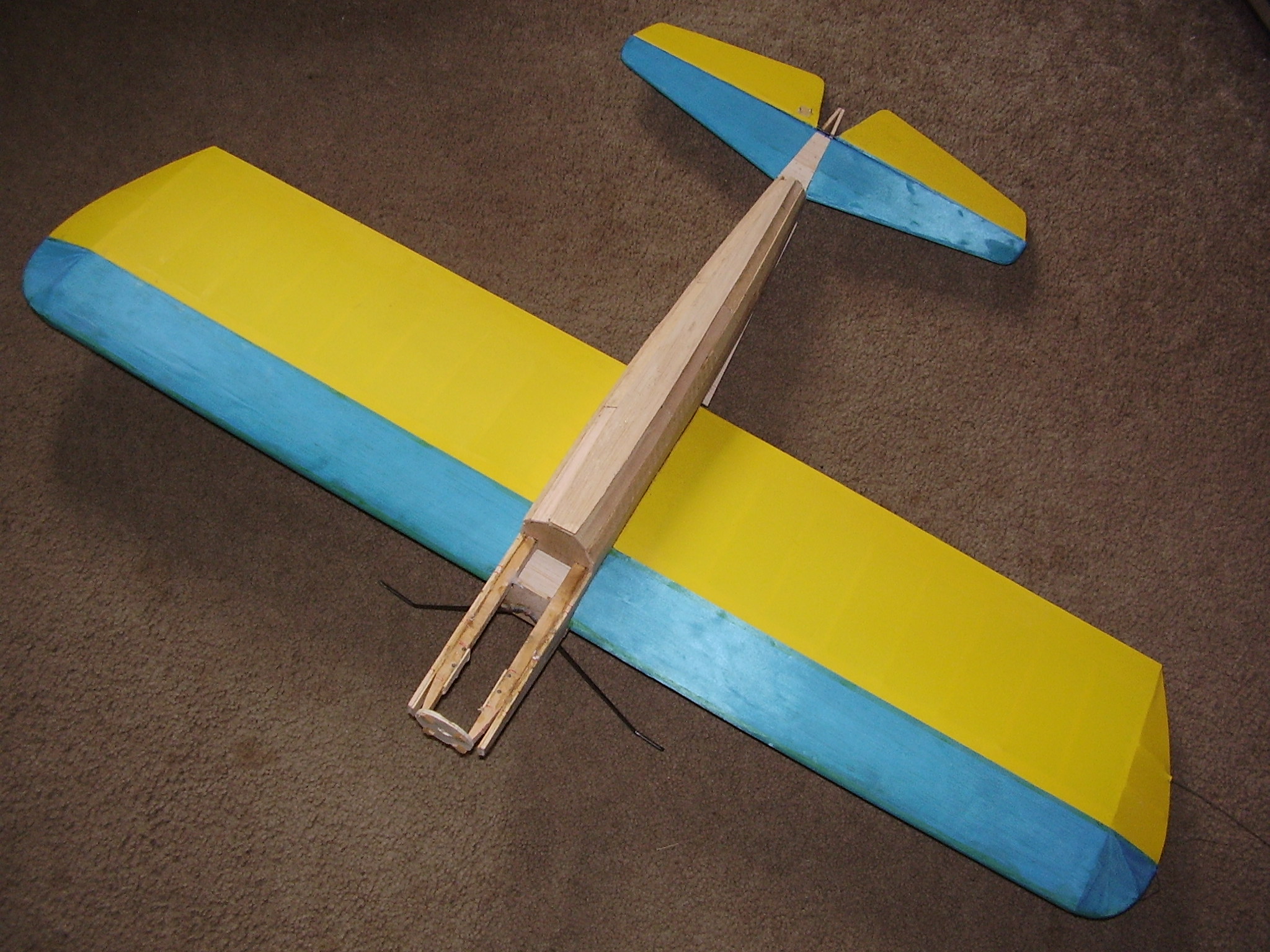

Does anyone know the function of the down oriented fixed flaps? It looks as if they level the wings, add lift, and slow the plane. The left flap is lower than the right.
There is a Guillow's Rat Racer kit on ebay for $300, it is very similar to this plane.
Name:	No. 3 Flaps 002.JPG

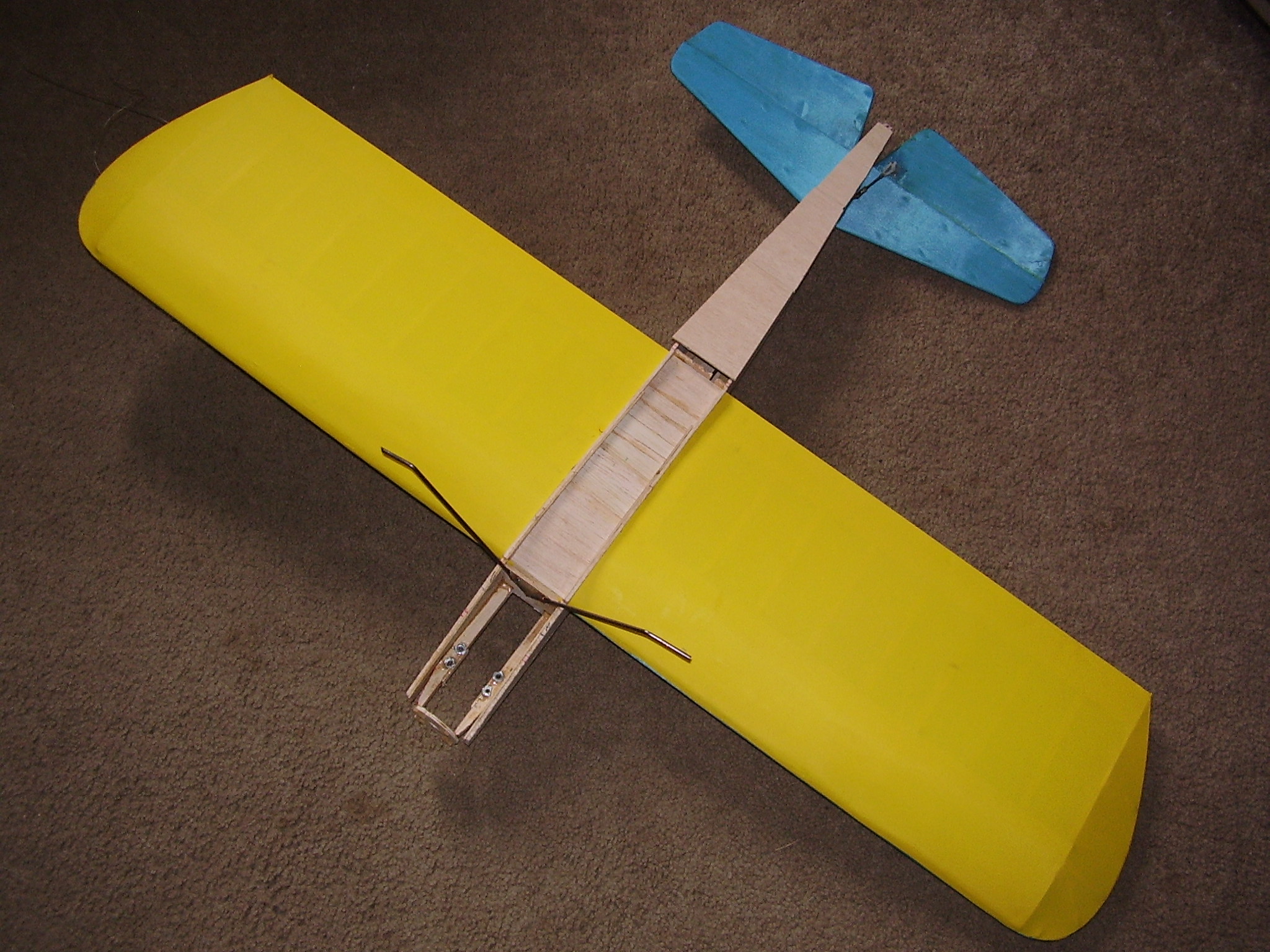

Old 11-24-2014 | 02:37 PM
  #43
Joined: May 2006
Posts: 713
Received 6 Likes on 5 Posts
From: Sierra Vista, AZ
I'd be surprised if that's how the plans show it, but could be. Left wing would tend to roll up when you fly right to left: counter-clockwise. It tends to roll the model away from you.
We use tipweight to do the same thing, in effect. It balances the half of the weight of the lines that hangs from the inboard tip guides, and gives a slight tendency to roll away.
For a trainer, it is safe to do it that way, but it works against you when the model is inverted. Tipweight, or a slightly longer inboard wing panel, or some of both is much more useful for a model that can stunt.
Besta luk!

The flaps add a good bit of lift. The orientation of the flaps is to give more lift on the inside wing to help the model roll outward a little to keep lines tight. Tip weight in the outboard wing is needed as well. Couldn't say how much.

It is exactly how it is on the plans. In level flight you want it to roll to the outside, for a trainer. That plane is designed for learning how to fly controline, only level flight and not much more. It's not meant to do much more than climb and dive. Loops, inverted, lazy eights, you shouldn't even try. You take off, you fly level laps, the engine cuts out and you land. When I think about it, that actually is fun. Do that a hundred times and you're ready for nice stunt trainer like a Ringmaster or Skyray 35. I learned on Cox Pt 19, it was a dog, but I learned how to fly controline. Best suggestion I've heard yet is if you can find someone who knows how to fly Controline who can help you with those first flights. Smaller tanks which give shorter flights are a good idea until you get used to it.
Tip weight is 2 ten penny nails as per the plans.

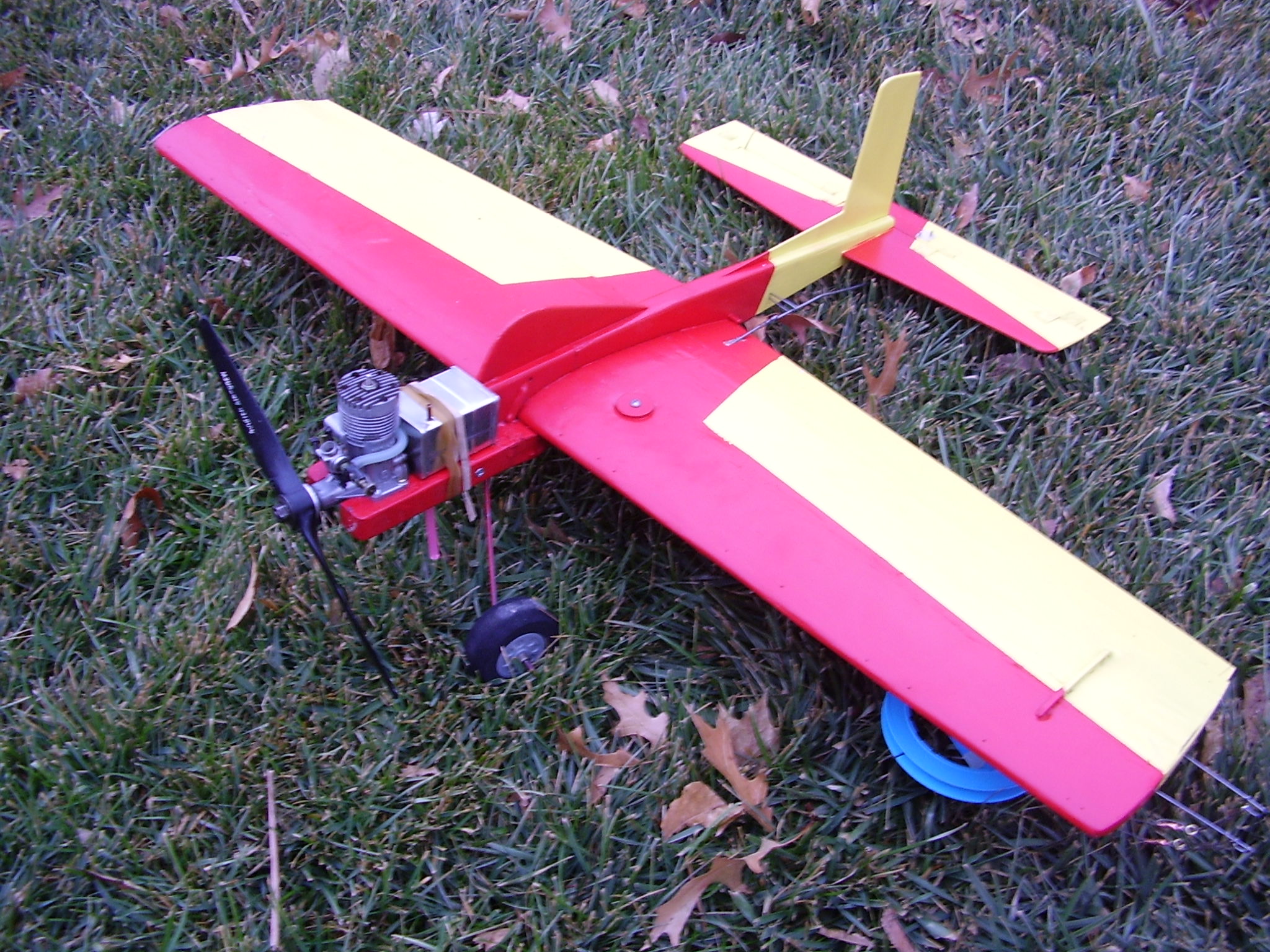

Old 12-07-2014 | 08:06 PM
  #47
Joined: Nov 2005
Posts: 167
From: Lincoln, NE

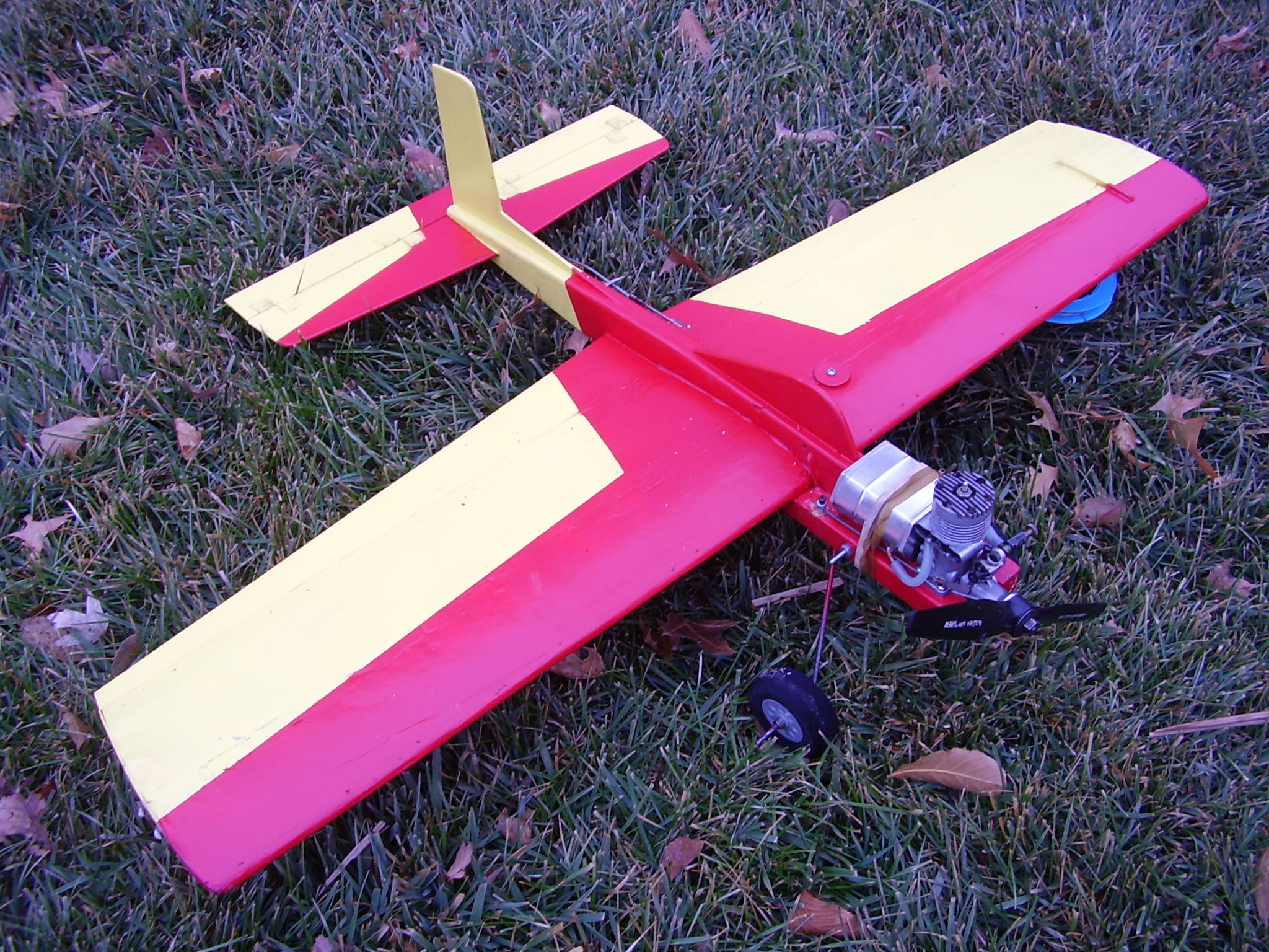

Here is my completed Guillow's trainer 3. Power is an OS Max 35s bushing RC. Finish is balsa filler, Rustoleum color coat and clear coated with polyurethane.

Old 12-08-2014 | 06:39 AM
  #48
Tom Nied's Avatar
Posts: 2,233
Received 22 Likes on 21 Posts
From: Queen Creek, Arizona
That looks pretty good. It's got a nice "sporty" paint job eager to get into the air. Should make for a good trainer. Have fun with it.
