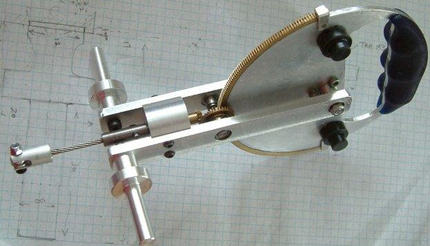

Modern monoline handle

I heard they were only good for larger models. Looks like it would be hard to use in the forks with the pivot so far behind. Nice machining, a bit of engineering there. Is Nightingale still around? I think an electric one may be the next hurdle. Like a servo at the handle with no transmitter?
