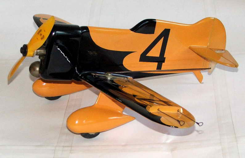

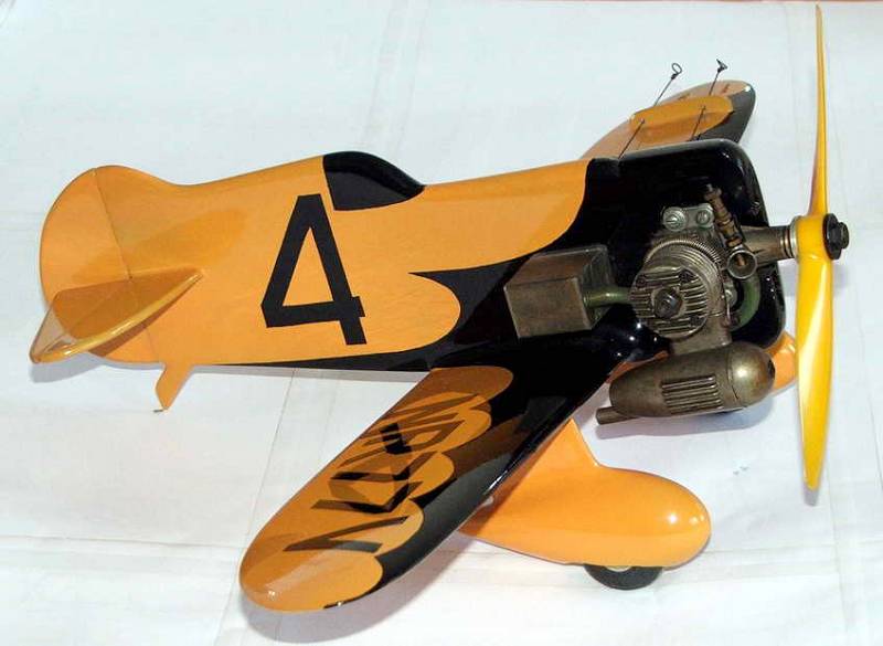

You know what ? It's quiet in here!
So.......here's some shots of one of my more dinky control liners, the Areomodeller GeeBee. I never flew it, mainly because it weighs a ton and is also nose heavy. Grass field flying here and I doubt I would get it of the ground. Os Pet 099. Wingspan, 17.5 inches.
I intend to add some more pictures as I go, sort of a scrap album, if no one minds. Please feel free to add to the thread. The dinkier the better, you know, Musciano/Scientific logs, Aeromodeller oddities, that sort of thing.............
Luke.

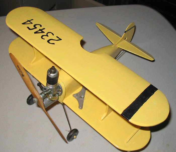

Well Luke, here goes:
Two Scientific (Musciano) hollow log Little Bipes. The white/red one is powered by an old Cox Babe Bee, and the yellow one is powered by an Anderson Spitzy .045. Note the ancient wood prop on the Spitzy.
George

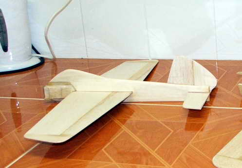

Work in progress. Dick Sarpolus Flip and Nobler. These two are for some potentially fast production Cox engines I have. They were designed for Tee Dees or Black Widows but I think the std reedies might just pull it of, with some mods.
Approx. wingspan 27 inches.

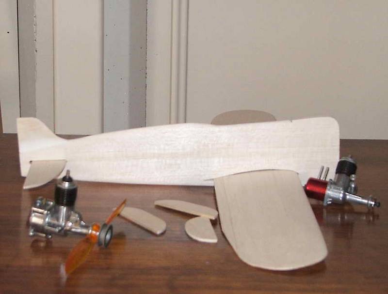

Another work in progress, Walt Musciano's diminutive Wedell Williams racer for OK Cub B. Engine bearers yet to be fitted. Wingspan is 16.5 inches.
George, if you happen to view this then the cub to the left is the one I was trying to identify some time back in the 1/2 A forum. A new old stock Cub 049 with kaysun prop and weird "startup pulley"on the nose.

Luke,
The Cub on the left was just referred to as the "OK Cub". Its displacement is .049, although it does not say so like the later engines. They also made an .074 version, but it has .074 stamped on the bottom of the crankcase. The tanks, by the way, were for FF.
My first engine powered model was a Scientific Little Bipe, powered by an OK Cub. It got a few laps on that small tank. BTW, I did not build that first Little Bipe, I traded my BB gun for it, ready to fly.
My first Cub .049B had the type string starter you show on the OK Cub, but it was fitted behind the prop and facing the other direction. It came on a Comet Sabre44.
As to the reedie. When Dick Sarpolus designed most of those planes, I think all the current reedies except the Black Widow used single bypass porting and a low compression glow head, so they put out much less power than the BW.

The plane in the first post looks like it's the same as I built a while ago.
I'm not sure if I used the Aeromodeller's plan (........that's before I started to change things )
BTW the pipe is to get the CG in the right place
Supagloo, how well does it fly ? BTW, isn't that one of those UCTKAM 1.5's on the nose ? They can reach 22,000 rpm or more, with a pipe and the correct prop!
