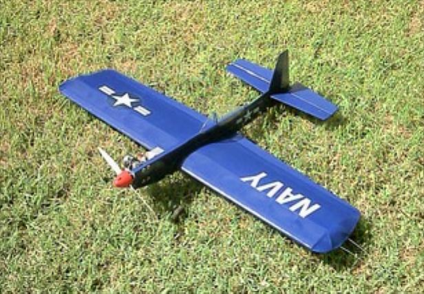

I fly a SIG Akromaster, without flaps. It's performance never ceases to amaze me. Great little plane with only 34" span, powered by an OS.15FP, 8x5 prop and 50' lines.
