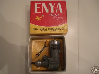

Anyone have any comments (positive or negative) on this engine? I was considering using one on a very light full size flite streak.

Looks like an older box?
As with all ENYA iron piston/steel sleeve engines, make sure you get a good break-in, per mfr recommendations, first.
The 19s can turn some pretty good RPM, so don't prop-load it down to a weaker part of its performance curve.
Should serve well and reliably for a long time...
A Flite Streak, light or not, may be toward the large end of an ENYa 19s potential, but if you can wind it up to somewhat nearer its peak RPM range, it should handle it. I'm thinking launch RPM, in rich 2-cycle, somewhere like 10,500 to 11,500. NOT peaked hard, but with a good cushion of several clicks before it won't gain RPM.
You may be involved with this engine for a long time! Enjoy!

What Lou says about the break-in is important to do. The engines back then often took what today we consider a very long break-in. They do not break-in with just a couple of runs. And if the recommendation is for a certain percentage of oil, and type of oil, follow that if you can.

Bass1,
I have a few of the Enya .15 and .19 engines. These engines will last forever if treated properly,. Lou's advice on the prop loading is right on the money. Break the engine in with 5%-10% fuel that you've added some axtra castor oil to. I usualy add 3-5 oz to a gallon. Castor oil is the key to keeping these engines alive. After you've run a gallon or more of fuel through the engine you can get some extra power by uping the nitro content. I run a my Enyas with up to 30% nitro (with added castor oil) with no ill effects.
Good luck and plan on running that engine the rest of you life.

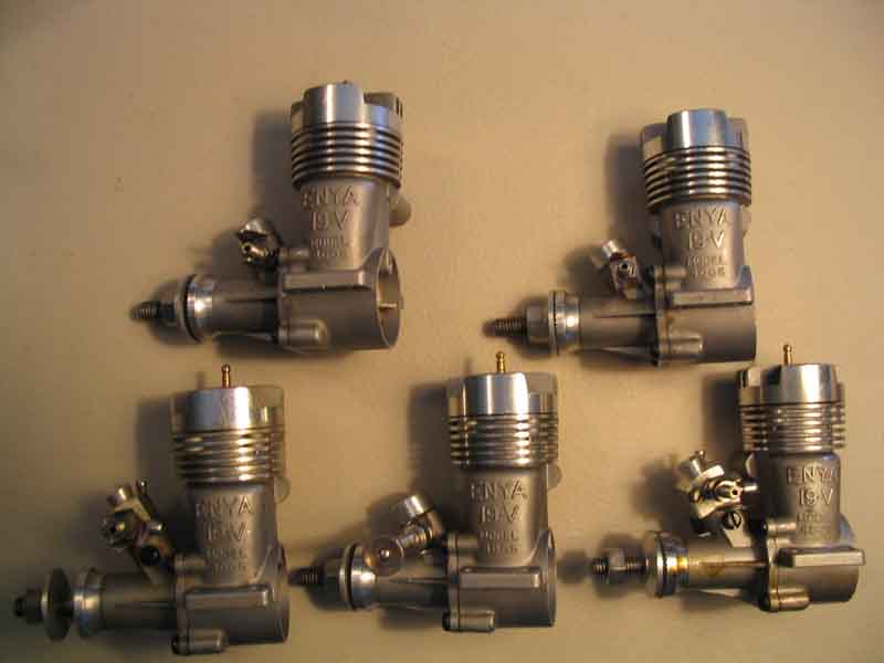

I like ENYA engines. My experience with the .19 is limited to the 19-V:
